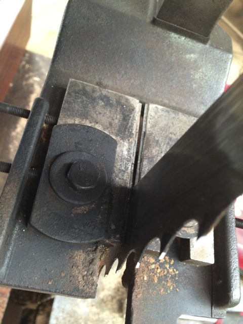

So firstly, I looked at one of the original, what is now the Laguna SUV 14's, about 10 years ago shipped direct from the manufacturer in Asia. Yes, despite it being branded Laguna, it is made in Asia, as are most in the price bracket. At the time, it was a new unit and left a lot to be desired in build quality, features and performance. This though is not unusual for new model machines. Often an importer such as Laguna, will test a sample, then work with the manufacturer to make improvements, select optional extras or have their own design features added. This takes time, further samples, re-engineering to some degree and comes at a cost of course. I'm happy to say that when I checked the latest incarnation at the most recent Working with Wood show in Melbourne, I was pleasantly surprised. They have put some effort in and the result, for the machine's intended market, is very reasonable. I'm sure you'll be happy with it - particularly as an upgrade from the standard 1hp C-Tec unit.
As to the guides, these are what Pete was referencing above. This is on a Hitachi CB100, the 100 standing for 100mm or ~4" of wheel depth and therefore blade depth potential. As you can see, the blade edge guides are solid pieces, about 2mm thick (x 8mm x 19mm) of tungsten carbide. Four have been brazed side by side on steel, then machined flat. These particular guides will work for up to 3" blades. They provide a great amount of blade support, accuracy, longevity and run reasonably cool. These were custom manufactured. The ceramic guides some manufacturers offer are simply cheaper versions of the same idea. The benefit of ceramic is it's cool running ability, but of course, the longevity is not as high. They are however available and reasonably priced. I prefer this style of guide for the extra support it provides over the bearing type systems that have smaller contact points, but each to their own and both can be coaxed to work.

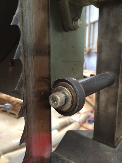

The original thrust bearing however, looked like this. This is a common arrangement but limits the point of contact and support of the blade in thrust, to the radius of the bearing - what, 0.25mm of contact? As you can see, it also wants to cut it's own groove over time. The width of that bearing also dictates the amount of play the blade has before it will drop off the support and cause problems. This ideally should not occur anyway, but we discovered it can for various reasons.

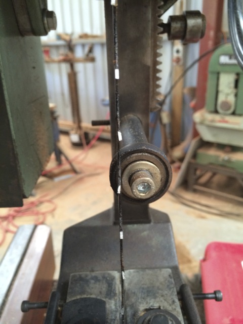

The solution I came up with, was this. The bearing is a standard size, so easily replaceable and the holding hex bolt is drilled and tapped off centre, so it works like a cam - the shaft can be rotated to adjust where on the bearing you want the blade to sit. It provides a far greater point of contact and support and as the bearing is constantly running when under load, it does not wear a groove in one spot with the whole bearing wearing evenly. The washer also adds a guiding edge on one side, should it try to drift at all. In practice, all this has actually turned out rather well. We've had no issue since I installed it (the previous system ruined two very expensive tungsten carbide blades in alarming fashion!) and it's still going strong despite what could be considered fairly heavy, industrial use.

Bit slow on the old forum these days I'm afraid. Find myself very time poor... With respect to your original question, I realise it's a little too late now but figured for info sake I'd chime in all the same.

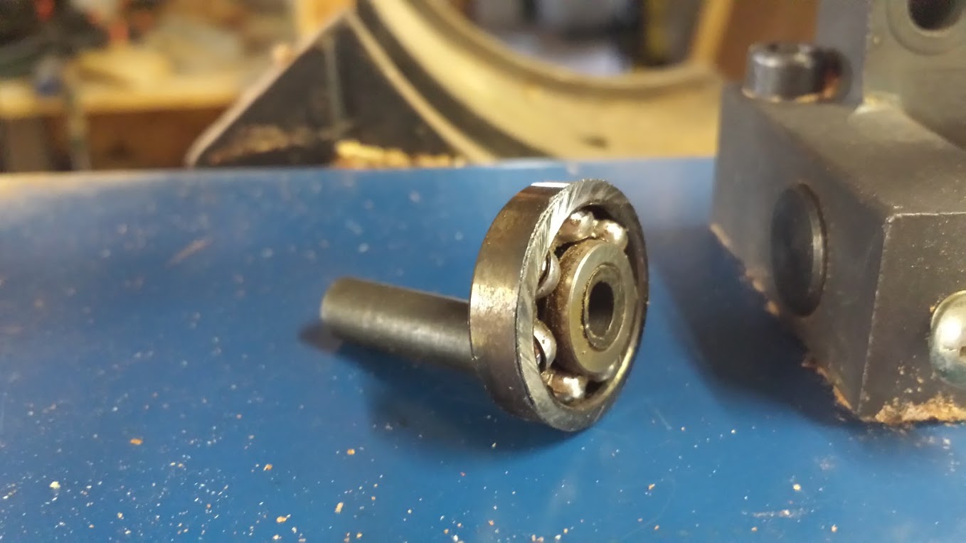

Mine (a Hare & Forbes model that I've had for about 10 years... and wanted to get rid of for most of that time) came with a similar style system out of the box on its lower guides. Except the bearing is firmly attached to the bolt, and I've never gotten around to ordering in the replacement part.J.F. Custom wrote: The solution I came up with, was this. The bearing is a standard size, so easily replaceable and the holding hex bolt is drilled and tapped off centre, so it works like a cam - the shaft can be rotated to adjust where on the bearing you want the blade to sit.
This is how the "enclosed" bearing now looks after a decade of use:
