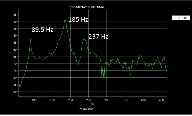

The gain on my mic was cranked too high. there is a new spectrum in the post.

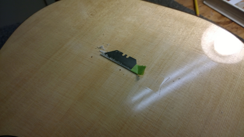

I use a scalpel with a brand new blade to outline the bridge. It is so sharp that a light cut cleanly cuts through the finish.
I use a heavy duty utility blade to scrape the finish off the wood. I tape the back end so I only need to keep track of one end.
To get ready for the vacuum clamp I taped some appropriate sized blocks on the wings, I just find it does a better job of clamping the wings, I leave the pins end but I duck taped the slot to get rid of leaks. I applied the vacuum clamp for about 8 minutes, cleaned up the squeeze out and am keeping it clamped for an hour or two.

I also liked to see the numbers for closed box resonances vs. finished guitar resonances:
87Hz T(1,1)1 => 88.6 hz,
187Hz T(1,1)2 => 178.3 hz
and
238Hz T (1,1)3 => 224 hz
If I didn't miss something in your thread here this is due to binding the box, gluing on the bridge, and maybe a bit to bolting on the neck and varnishing (you know that magic Stradivarius-varnish that improves everything :lol:), but without thinning the rims of the top or adding side mass (I guess that, given the fact that you already were a hair below your targeted T(1,1)2, this wouldn't have made sense to you unless trying to achieve a different balance between two or mode resonance frequencies).
Most interesting to see go up the air resonance, I would not have expected that, on the other hand it is not by much.

Thank you Markus,
I was surprised by the change to the top value from before strings and lowering the back resonance.
and
johnparchem

Thank you Markus,
The guitar has really opend up since I originally posted. It is a very good sounding classical, with the positive falcate characteristics I hoped for. My classical guitar instructor really liked it. He said that it has a great voice, is very quick to follow dynamic changes, great sustain, very consistent across the strings with good separation. The guitar has concert level projection. He also really like the the 20" radius on the fret board He is around 80 years old and has the start of arthritis in his fretting hand index finger. He said for the first time in months his bars sound good.
I was surprised by the change to the top value from before strings and lowering the back resonance to the value with the strings on.
closed => no strings => final
87Hz T(1,1)1 => 89.5Hz => 88.6Hz,
187Hz T(1,1)2 => 185Hz = 178.3Hz
and
238Hz T (1,1)3 => 237Hz => 224Hz (this was me shaving the lower bout brace)
Spectrum right before strings
no strings.jpg (63.32 KiB) Viewed 26189 times
