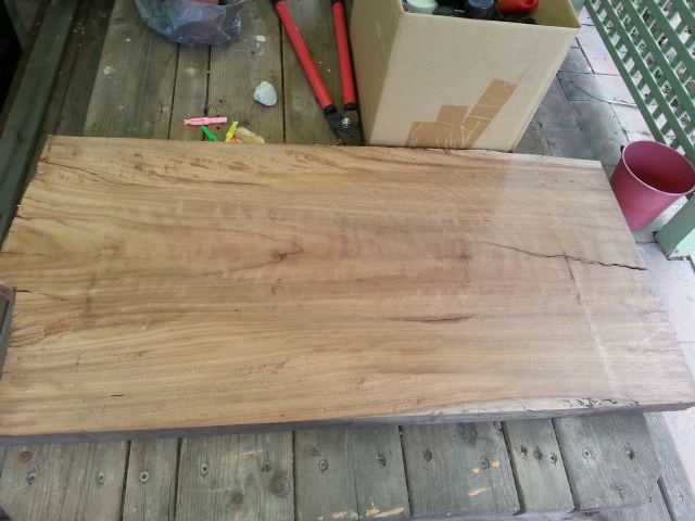

Propped up against the post was a slab of very nice spotted gum. I like how the receipt says Approximately 400mm x 500mm x 45mm. It turned out to be 500 wide by 45 thick all right but nearly 1 meter long.
I will get 2 good bodies and maybe another 1 it I can work out how to stabilize the crack running through the middle of the last piece.

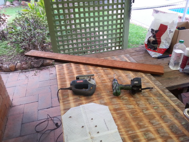

So to recap my day. I now have enough spotted gum hardwood for 3 bodies. a plank of hardwood for 2 necks and a 2 meter sheet of mdf for templates.

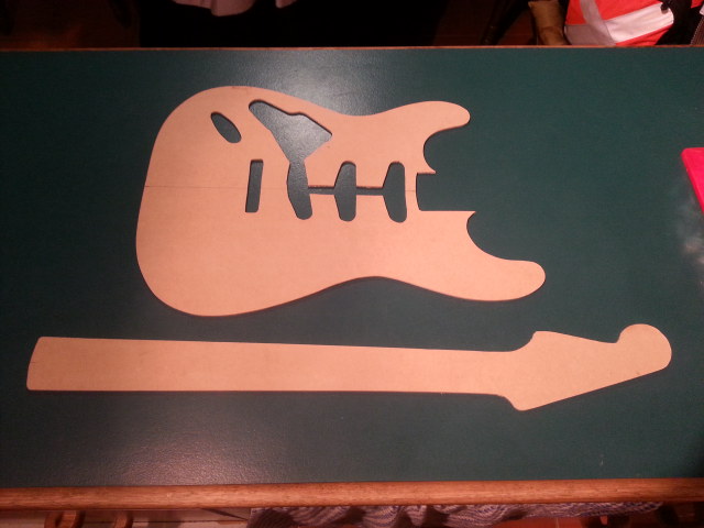

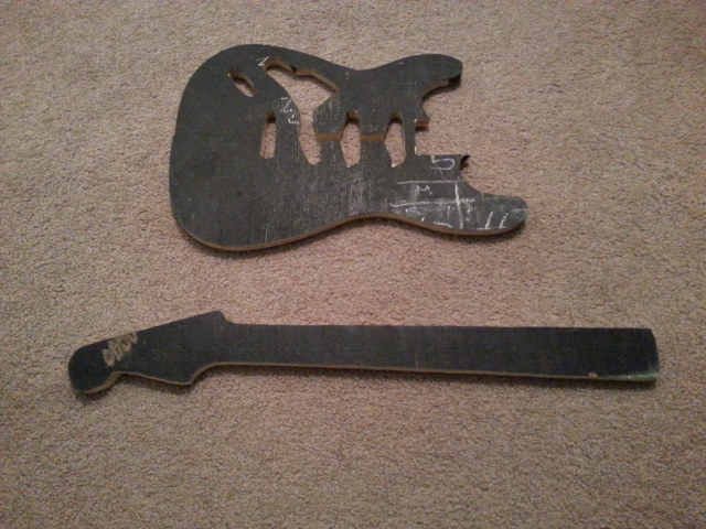

I have cut out my templates and sanded them to fit nicely together. I followed the specs from the original vintage 62 fender blueprint I found somewhere on line. I am really happy with my first day. I got a bit over zealous with my sanding and I know the pocket is not perfect but I figure I will have a pencil thickness inside the neck pocket and outside the neck so I can sand them both to fit better.

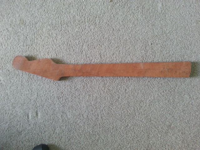

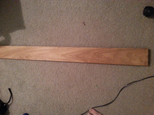

Here is a neck cut out of my 4x1 plank. It turned out to be more spotted gum but a slightly different colour. I just have to now get my head around the fact that the hardwood I will be practicing on is cheaper than ply or pine. Weird, hey.

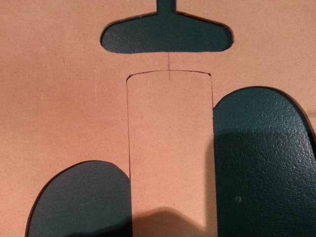

Just a note, the neck pocket appears to fit fairly nicely.
But you really need to run a centreline down the length of the neck and across the body, match these up to make sure they are aligned and then check the alignment against the neck socket and tweak adjust accordingly.
Otherwise you may find the neck is heading of in another direction, and when strings get fitted, not good.

Thanks for the advice. I will definitely do that before I finish sanding the final piece of gum. I'm pretty happy with that neck fit as well. Just the gaps in the corners could do with some tweaking. These are just the first attempts at a template. It is only 3mm mdf so might not last too long anyway but it was free and I'm really happy with how it turned out.
I just noticed the edge of the neck is not perfectly flat so might have to make another template. No biggy. I have the original paper template saved and worked out how much to blow it up to get the right measurements so I can print out as many as I want.
I have some 18mm ply for the routing template so I will make sure this is a perfect fit before I touch the spotted gum.

I knew it was a good idea to post my build on here to head off any possible problems. I hadn't thought about the thickness of the clear lacquer. And that brings up an interesting question. How do I make the neck and body a good fit and allow for the finish paint.seeaxe wrote:Hi Greg, looks like that will make a nice body.
+1 for the centreline idea, that should also help to align your truss rod slot, assuming you are going to put one in the neck.
Also, you could make your fretboard a few mms longer than the neck itself, then it will over hang the join and you wont see it. You will need to check the fit with the pickguard of course.
And depending on the paint/lacquer finish thickness on the neck and the body, you may find your neck pocket is actually a tight fit.
If you ever need another copy, there's a neck template on the Grellier website if you have a plotter or print shop close
Good luck with your build and enjoy the ride!
If I make it a perfect fit now, it will not fit after the finish has been applied. At that point, I will have to sand off my perfect finish to make it fit. If I try and allow for paint, it may be loose. The easiest solution is to not paint the bottom of the neck and the neck pocket but this sounds a bit rough. I understand it would be difficult to allow for all finishes as each application of paint may vary.
What I might do is make it a good fit all through the build and then final sand the bottom of the neck as the finish is applied. Trial and error i guess. Painful to fit, paint, test, sand and repeat. All part of the fun i guess.
I could always make a dummy neck base and neck pocket at the exact dimensions of the original and test these until I get the right allowances.
How to all of you allow for this?
Re: Enough lurking. Time to start building.
I can be only talk about what I do
I fit a neck to the socket so the friction alone allows me to lift the body of the bench with just the neck.
When painting I apply 2 colour or clear coats in the neck socket, and 4 coats usually to the neck.
When assembling I sand the sides of the neck until it's a drop fit in, I follow up with a single coat on the sanded areas and fit glue bolt the neck in place

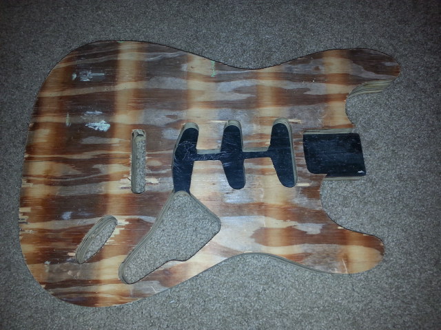

Cut out some routing templates today. Gotta buy a bearing for the shaft of my router bits tomorrow and then I can follow the 3mm mdf templates to tidy up the 18mm ply templates. Hope the router doesn't slip off the 3mm mdf. Could get ugly.
Time for todays update.
Got used to the router again and found it wasn't too bad.

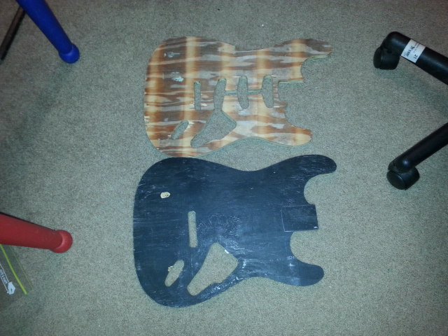

Routered out some top layers and 1 neck and 1 second layer. The black layer is the second layer. I don't have a template router bit so I had to improvise. I made a 6mm router template and mounted it on the bottom of the ply and then I could follow it with the bit I had with a top bearing. This worked out ok as I haven't glued my ply layers together yet.
The idea is to rout all cavities from the top layer of 17mm ply and then only the control and jack cavity from the second 17mm. Finally, I will add a 10mm layer and router only the tromolo spring cavity from this one. I know this gives me 17mm as the neck and pup cavities but I am hoping the extra 1mm won't be a problem. Time will tell and by then I can add a 1mm shim if needed.
I haven't worked out how to get another 6mm from the bottom of the second layer yet to get the full 16mm needed for the spring cavity. Might have to bite the bullet and buy the proper router bit yet. Still haven't worked out if routing the spring cavity up to the pup level is a bad thing.
To hold the router template on the ply, I used an idea I saw online if you don't have any double sided tape. You put some ordinary masking tape on each piece and put some superglue on the back of the tape and press them together. Holds really well and comes off easy.

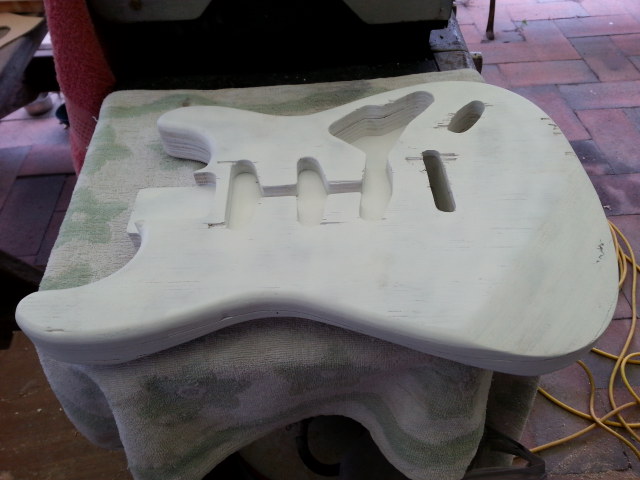

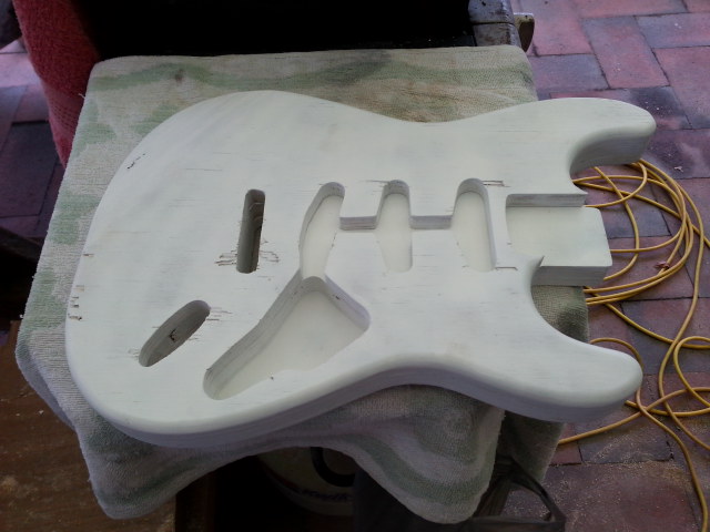

Here is how they look together. It looks like they have been routered to different depths.
Notice the pieces chipped out around the edges. That's the reason my jigsaw nearly went swimming. Not happy, Jan. Might have to redo that layer yet. All a learning curve and better on the ply than the spotted gum.
Not an ideal fix by any means. It gives me 17mm for the neck cavity and only 34mm for the control cavity. All this because I'm trying to avoid buying another template following bit at $35. Might buy it yet. We'll see.Notice the pieces chipped out around the edges. That's the reason my jigsaw nearly went swimming. Not happy, Jan. Might have to redo that layer yet. All a learning curve and better on the ply than the spotted gum.

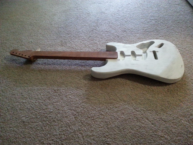

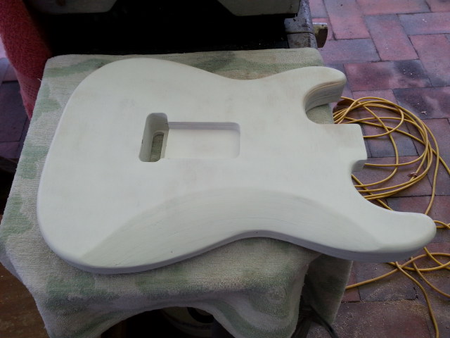

Gave in today and bought the proper template bit for the router. Glued up the 3 pieces of ply so I can router them properly tomorrow.
The finished thickness should be close to 45mm. 17+17+12=46.
Made a jig to router the tromolo cavity for the back. Routered the top of the neck and drilled and test fitted the tuners. Looking more like a guitar everyday. If you look closely you can see where I slipped with the router and dug too deep near the second tuner from the right. Not sure what to do about that yet. The router also chipped out a piece near the far right ( low e ) tuner. That should sand out when I blend the headstock into the nut area.
Making some rookie mistakes but so far nothing major. The 4x1 was rough sawn so the minimal sanding I have done so far has taken it down to 23mm in places. Note to future self... Make sure the neck is slightly larger than 25 or dressed to that thickness.
Still, 23mm of spotted gum should be plenty strong enough. As long as the fretboard is level and radiused properly, all should be good in the end.
May decide to not install a truss rod as the spotted gum is heavy and solid. I can always install one later. Just saw some posts where some pine necks don't have truss rods and haven't bowed.
I might leave the neck fairly thick to start with and I can shape it again later.

Todays' update.
Routed all cavities and curves. Carved front and back. Primed and trial assembly.
Really happy with the job so far. Learned lots. No1 is not to use crappy free ply. You can see all the chip outs on the front that will take some bog to repair but should look ok when done. The back piece was top grade ply and turned out perfect.
The new template following bit for the router worked out like a dream. Should make the next one much quicker.
Maybe a tele. Already bought the combo bridge/pup and another set of tuners.

Thanks for the reply and positive feedback. I am really happy with the progress. Amazing what a couple days off work, the right tools and 6 months lurking around these forums can achieve.
It really flew when I stopped trying to cut corners using the wrong bit and bought the template following bit.
Now I have all the templates made, the next one should take a day or less to get to this stage. I know i have lots ahead of me with the neck levelling, sawing and fitting and levelling frets and fitting a truss rod and skunk strip but feel I am ready to attack those after my success so far.

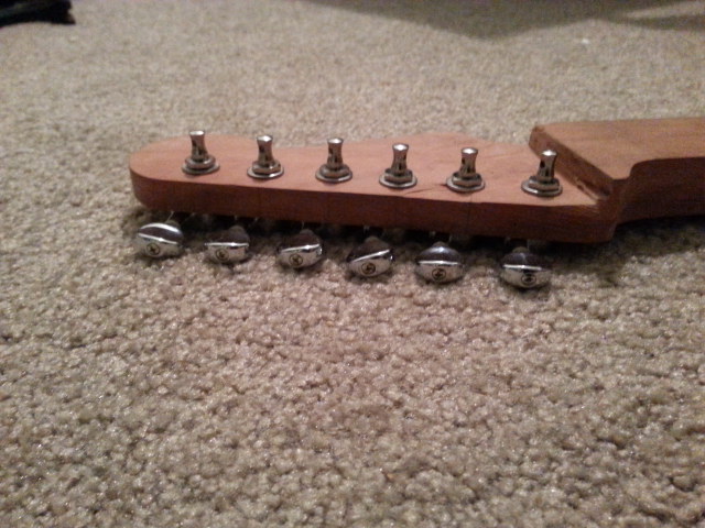

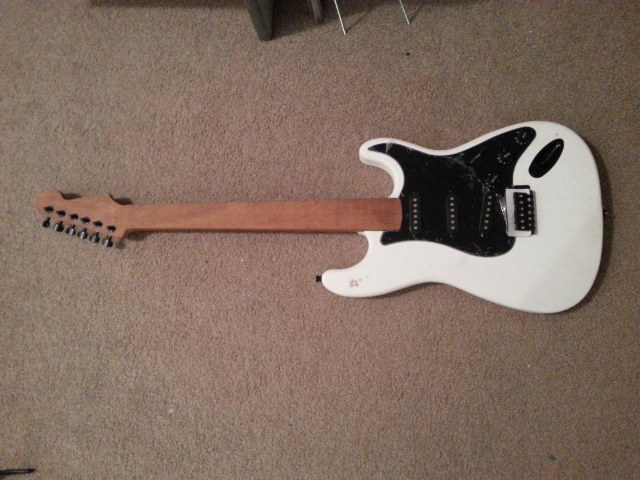

Big day today. Parts arrived and trial fitted. Found out I didn't route the pup cavities deep enough and the jack cavity needed some widening. Of course when I fitted the template to re route the pup cavities, some tape lifted some of the paint near the top horn. My fault for not waiting until I had all the parts before I finished the primer. Won't happen again. I fixed the template and now know when the instructions say pup cavities at 19mm, it is for a reason. Apart from that all fitted ok.
Also found a source of nice woods for the next build. Picked up some rosewood. They told me they can get many types of wood so might use Jarah for the fret board. Also read Make Your Own Electric Guitar by Melvin Hiscock. Interesting stuff.
Neck fitted also. Lined up dead centre with a piece of cotton as a guide. Still waiting for delivery of fret wire and nut so the neck is not finished.Also found a source of nice woods for the next build. Picked up some rosewood. They told me they can get many types of wood so might use Jarah for the fret board. Also read Make Your Own Electric Guitar by Melvin Hiscock. Interesting stuff.
