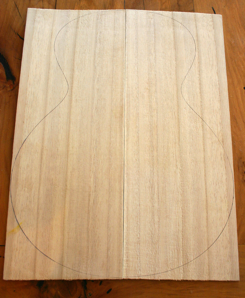

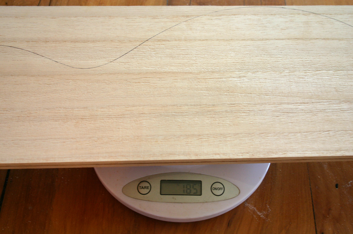

I machined up a couple of sets and stuck them in my dry room over night.
at 4mm thick this set is 185grams.
I compared it against some WRC and it definetely isn't as stiff. But that isn't necessarily a bad thing, it taps like a gong!
The spring wood lines are really stiff it's almost like a built in bracing across the board. The summer wood is essentially dry pulp. :lol: As for softness I don't think it really matters as it will be pore filled and with modern polyurethanes it can only make it more durable.
Either way I will definitely give it a go.

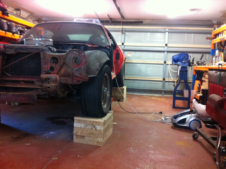

Here is some paulownia put to good use in my shed at home, I bought a pile of it a year or two back, now I use it for steps for my old dog to climb into its kennel and for raising my car of the ground so I can work on it without crawling on the floor.
