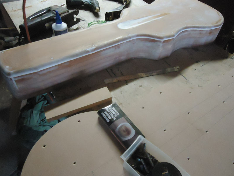

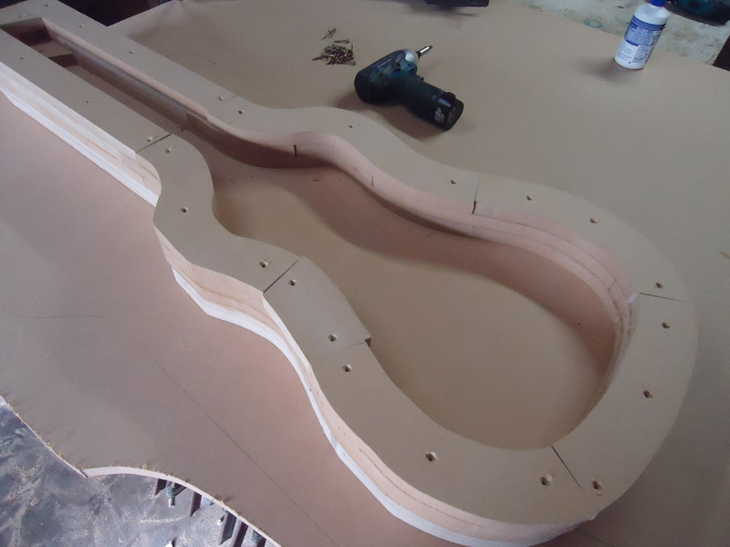

Building up the MDF plug
fibreglass guitar case 1.JPG (91.11 KiB) Viewed 36449 times

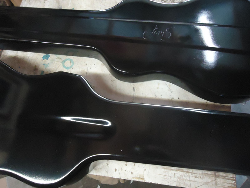

I used black so I could see and bad bits of shape then filleted till the black looked okay.
fibreglass guitar case 3.JPG (88.91 KiB) Viewed 36449 times

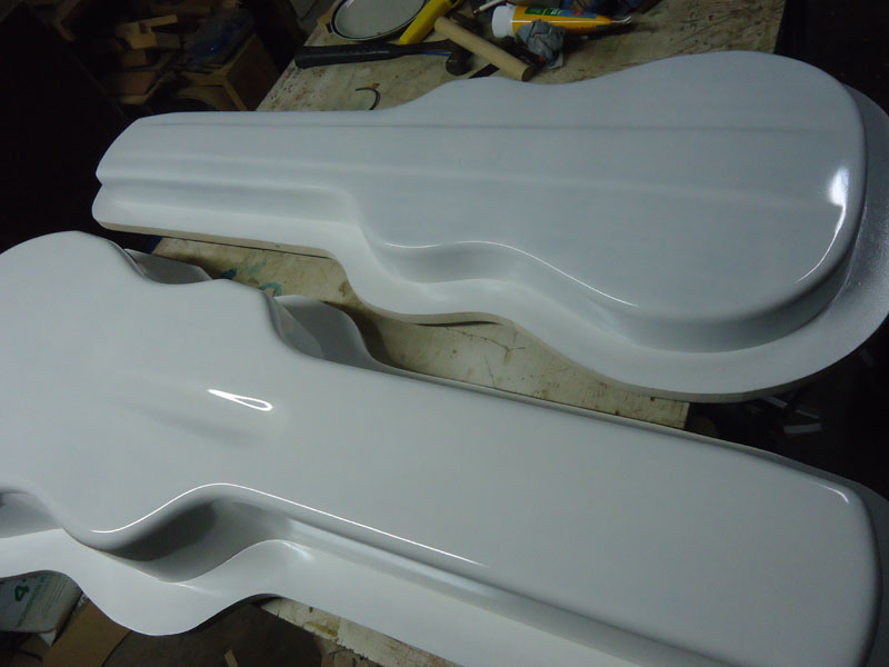

Then painted them white so I could see the blue PVA bond break going on. It is water thin stuff to spray so I wanted to see it clearly to avoid runs.
fibreglass guitar case 4.JPG (70.83 KiB) Viewed 36449 times

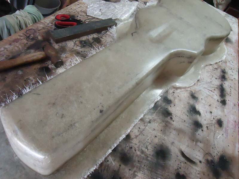

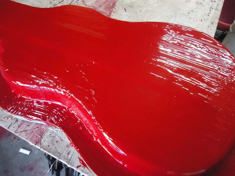

I tossed up between doing the right thing and buying a gelcoat gun and hand brushing. In the end I went El Cheapo and brushed the stuff on which is a bit tricky but it worked in the end.
fibreglass guitar case 6.JPG (87.24 KiB) Viewed 36449 times

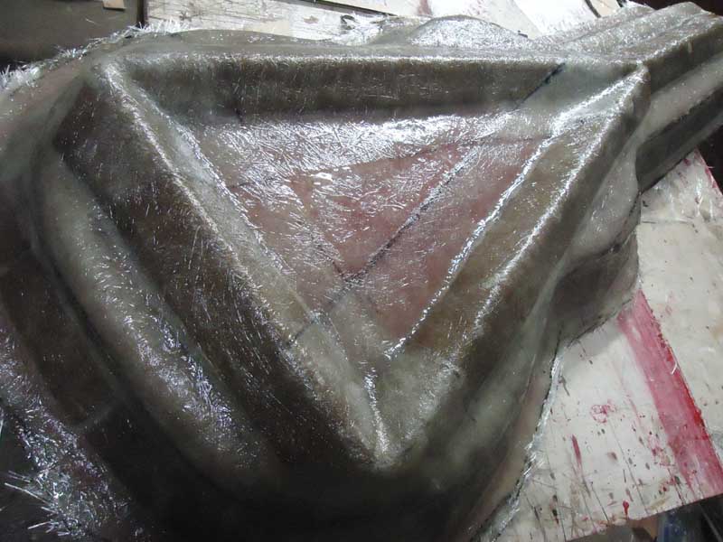

That is the glass finished with bracing applied to keep the mold as rigid as possible
fibreglass guitar case 7.JPG (86.96 KiB) Viewed 36449 times

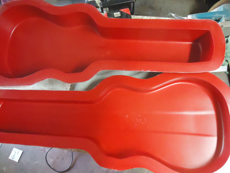

The two molds finished in Ferrari red tooling gelcoat
fibreglass guitar case 8.JPG (91.69 KiB) Viewed 36449 times

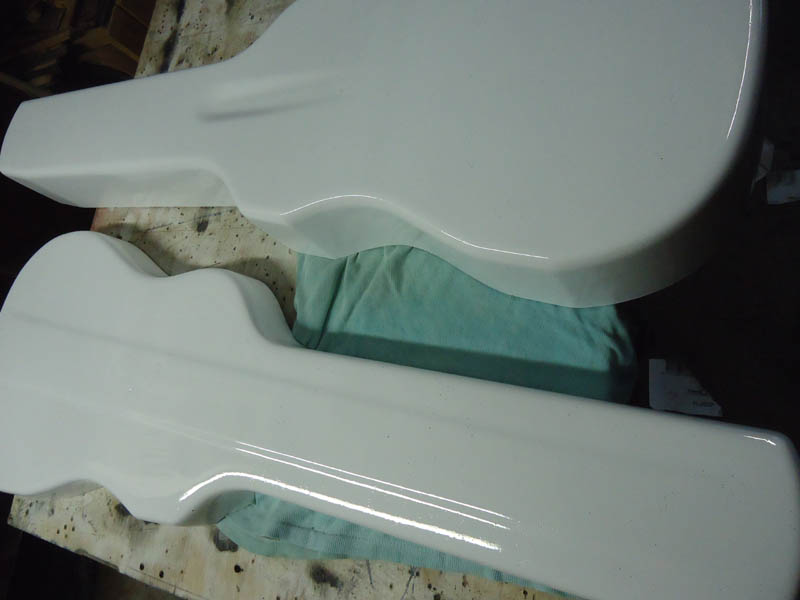

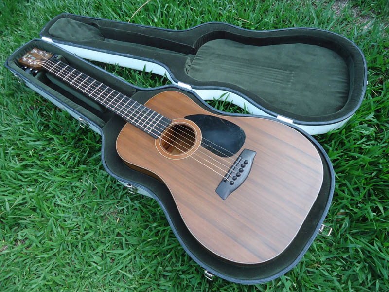

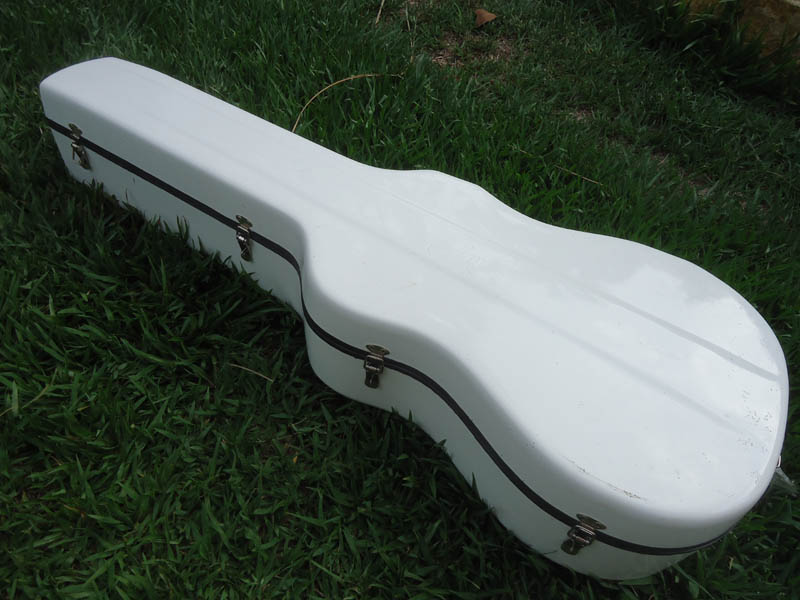

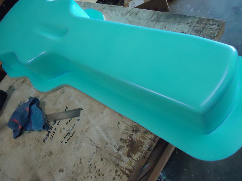

G'day ANZLFers. Finally got around to using those moulds I spent all that time on, bad decision. Bad decision in the middle of the 'build up to start fibreglassing, what a shit fight. Almost done though just need some feet and a handle. I went okay but its a bit rough, good enough for me but will do a few different things next time.
blank case.JPG (76.53 KiB) Viewed 35745 times
painted blank.jpg (55.05 KiB) Viewed 35745 times
case almost.jpg (91.71 KiB) Viewed 35745 times
interior case.jpg (153.71 KiB) Viewed 35745 times

Nice work! Hope they don't weigh too much! I have some opinions to here. Cases should not be black, particularly in Australian climate.The reason is that many people unconsciously leave guitar cases in windows, cars,etc. Black cases are heat banks, white reflects heat.A case left in a window or in the shade can end in full sun later in the day. I have seen and repaired many instruments that have suffered heat and humidity damage this way.One example was a high cost Lowden which was purchased with a Hiscox case. The liner of the case was polystyrene foam moulded into the case with synthetic felt of some sort on the inside.In the centre of the back the polystyrene had not bonded well with the plastic of the case but was well bonded around the sides, resulting in an air cavity, which when heated in the sun or near a fire in winter or whatever, expanded and seriously deformed the back in a concave, both deforming and splitting back braces as well. The back became permanently concave from its normal (estimated) 15 ft raduis to a concave that was 8mm deep when a straight edge was placed across. The concave was in the centre of the back only.The foam inside the case was also permanently concave, so in effect the instrument was being placed in a press everytime the case was closed, and going through regular heat and humidity cycles as the guitar was moved from location to location.
g 018r.jpg (46.56 KiB) Viewed 35722 times

A mate told me I should not have made it white cause it will show dirt and marks but I'd rather have it a bit grotty and cool. Also to me it is the case that takes all the grot and bumps to protect the instrument and a case just looks better if it has a few miles on it, that's what it's there for.
I guess how much it weighs was not a big concern for me Ross as it is supposed to be a flight case and my main concern is protection against baggage handlers that are having a bad day at work. I will weigh it when it is finished to see how I went as my aim was to be less than 6 Kg.
Thanks all for the remarks and to be honest Allan it is not so pro up close as I had a bit of wax trouble with the PU paint also I will be able to do a much better upholstery job on the second as the experience with the first helps.

So I just weighed it Ross and once I add a handle and feet it will come in a handful of grams over 5Kg so I am very happy with the toughness to weight ratio.
Yep Pete people drive black cars up here too so either they suffer for their style or they always leave the car and its aircon running when they park in the sun.

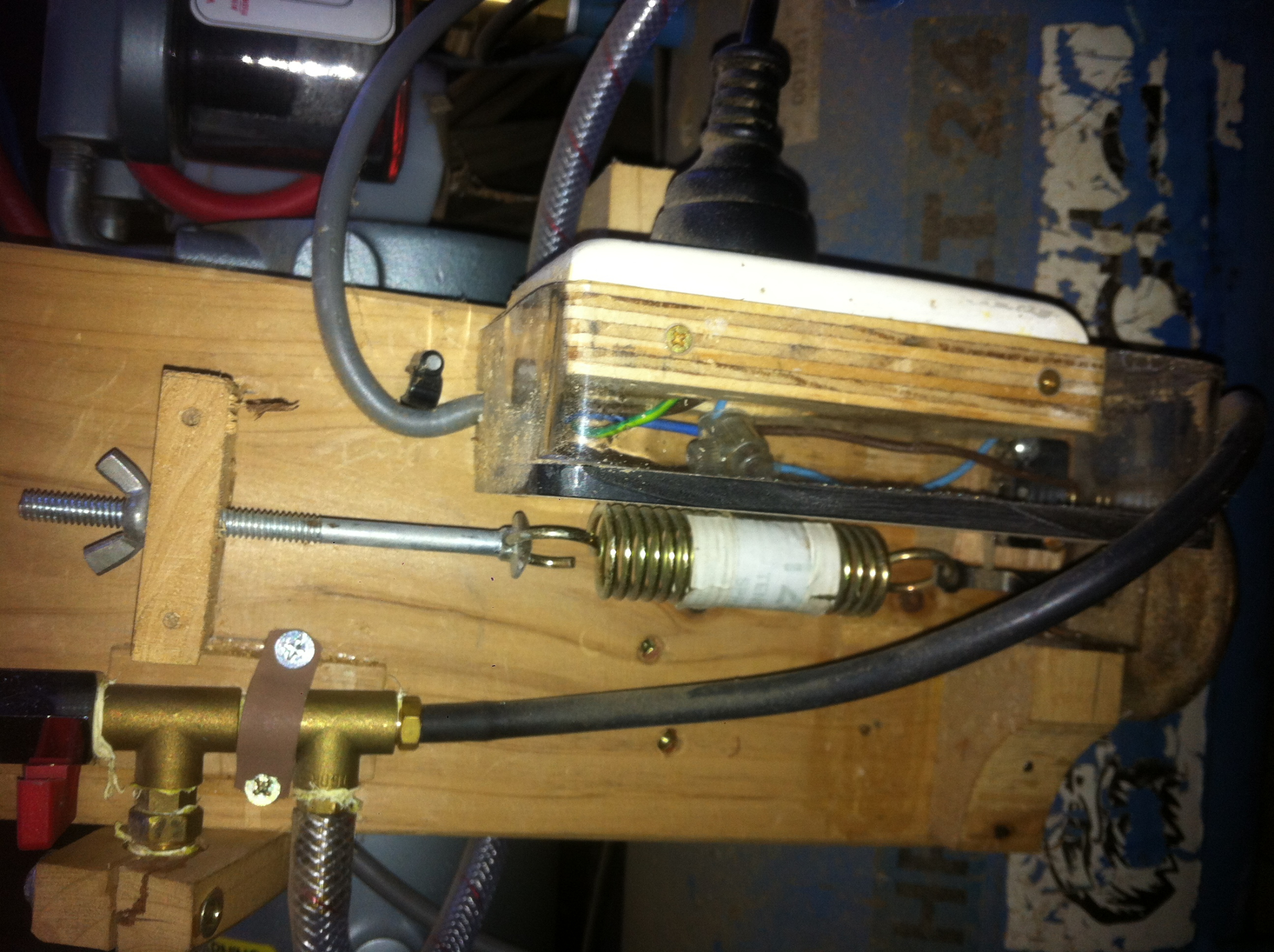

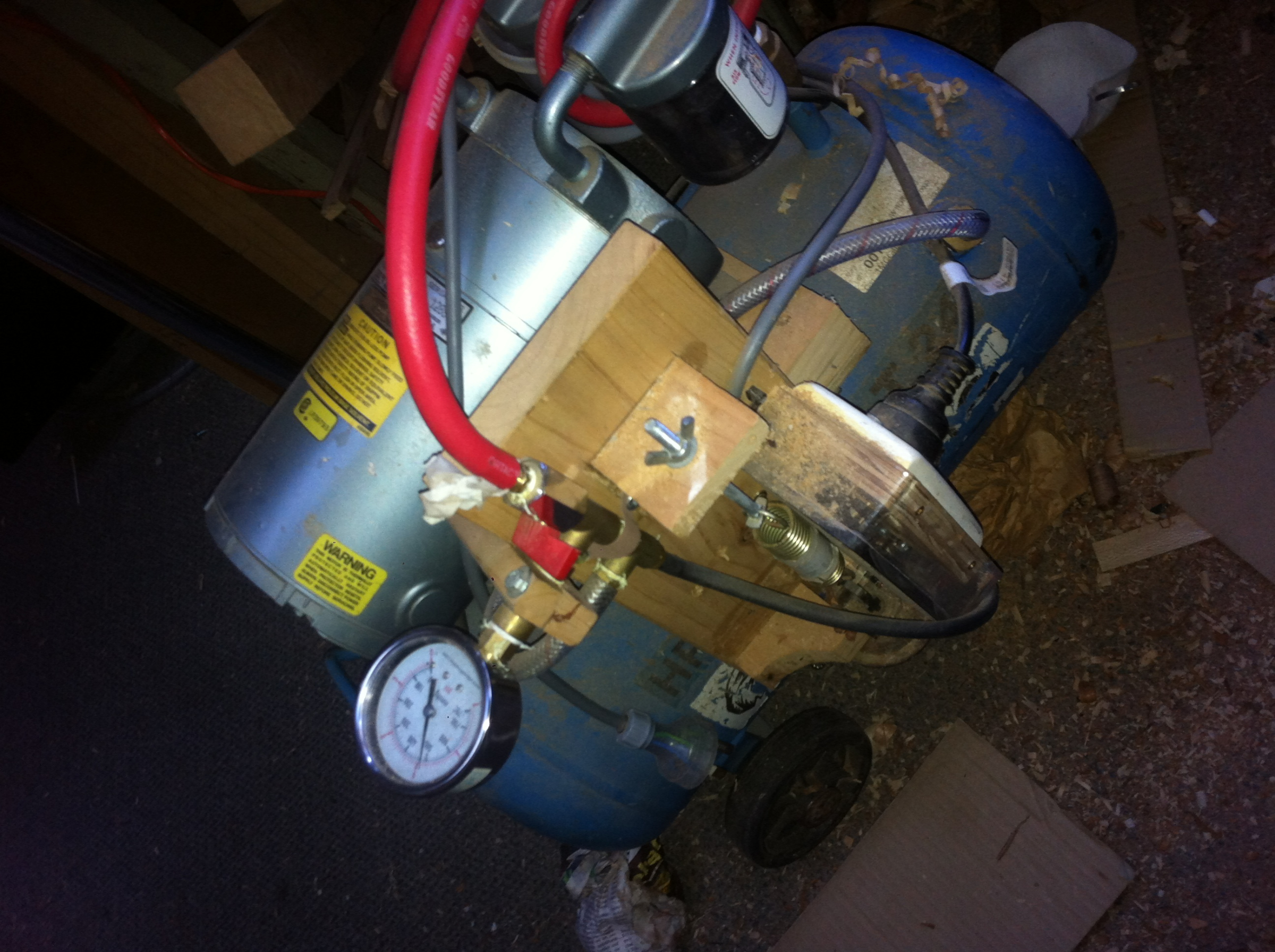

Next project--CF cases....?I made a vacuum system for around $150 after a lucky score on ebay of a vacuum pump, brand new. It was left over from a large laboratory that closed down. But an ebay alert will turn up items that one is seeking...I just visualised a bargain and there it was. The pressure cylinder is from a burnt out el cheapo compressor from the local tip, along with a distributor diaphragm from an old holden. The diaphragm is balanced by a spring and a wing nut -this activates a Jaycar microswitch. The purchases were non return valve, vacuum guage, brass fittings.The rest was lying around the shed.Works fine.I use it for veneering backs and sides and bridge glueing etc. But down the track I want to try working with some CF-budget and other projects permitting...The most important issue is to make sure the vacuum bagging used doesn't leak so that the pump doesn't cycle continuously during long glue/resin hardening times. That causes overheating and risks damaging the pump.
