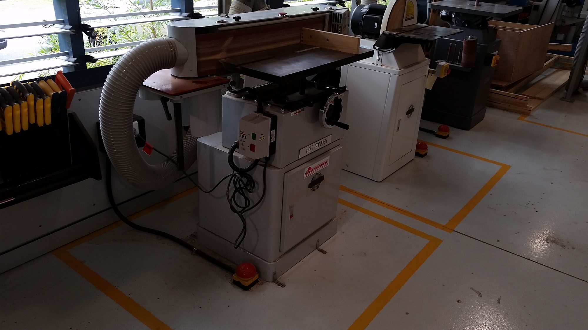

We have one at work - high school, that kevin 07 bought us a few years ago. Great machine, so much grunt, only slight issue is the gap of 5 mm or so between belt and work table though I'm sure in can be adjusted, low on the to do list in the workshop, havnt looked at it. Also dust collection is not 100% but that is par for the course.
Sure is nice to sand a bit of wood a few feet long!!! It eats it up

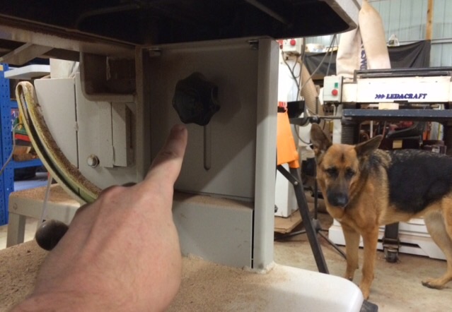

Height adjustment of table, there is one of these either side:
If the other brands don't have this, I suggest you shop around for one that does.

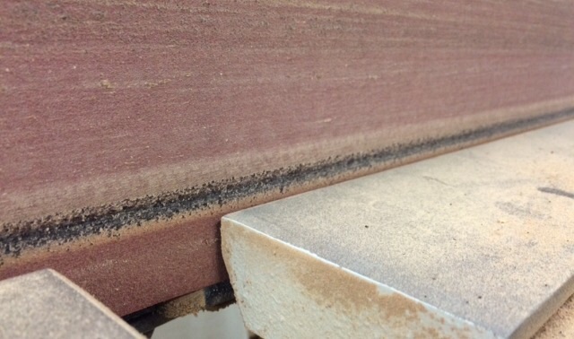

Sleake - Like many tools, I'd address this issue by using a 'sub/false table base' (waste board) with near zero clearance for smaller or more delicate work. The mitre track allows you to lock one in place. Note, not 'zero' clearance given you need somewhere for the dust to go. But the same problem can be said for bandsaw table inserts, tablesaw inserts and things like thickness sanders, where sleds are often required for sanding to the thicknesses we require. The 'safety' margins and tolerances provided on machines is often larger than we'd like, hence the customised jigs or fittings required.

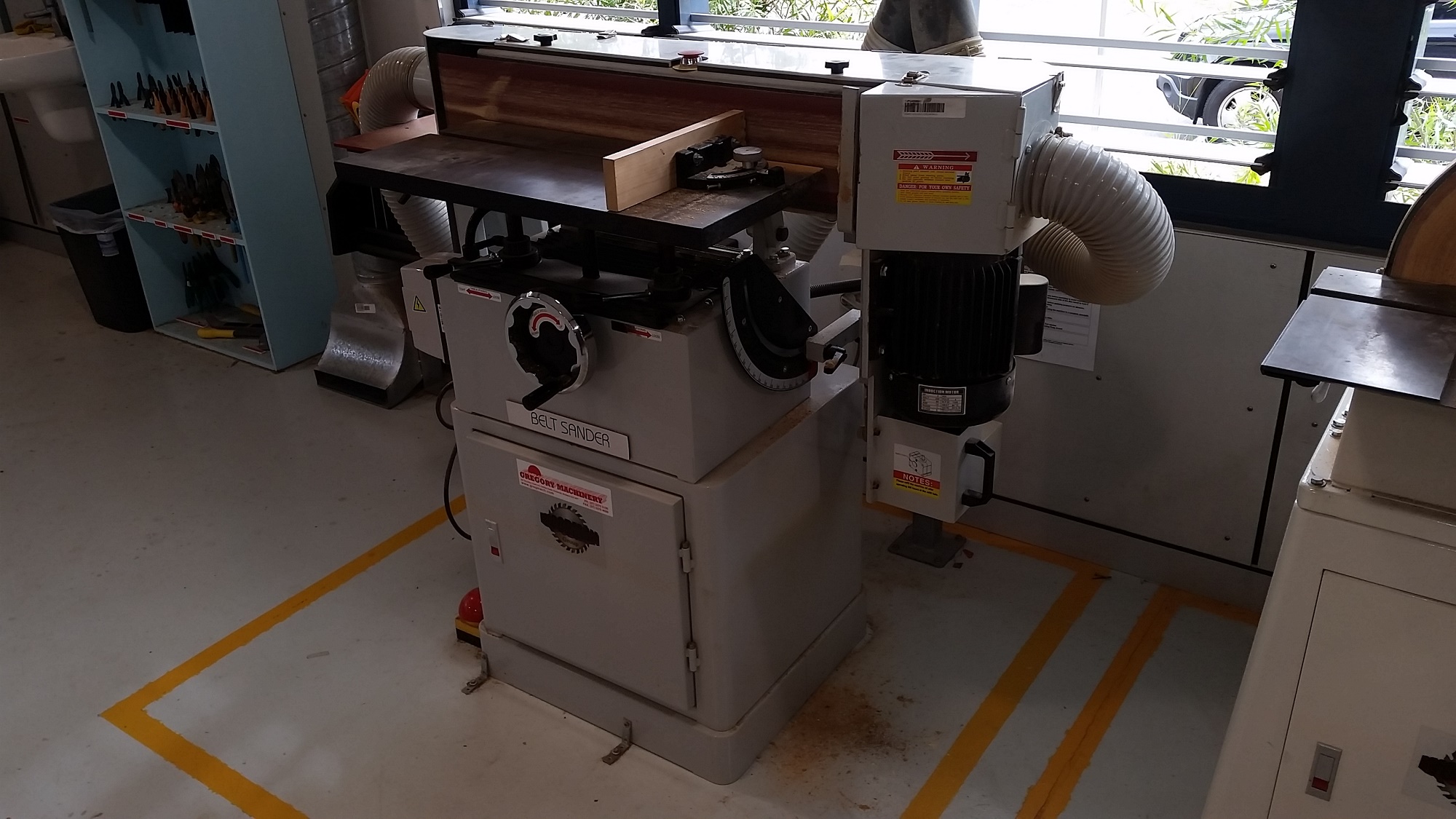

We have this one at school from Gregories. Does everything you need. Motor and belt assembly tilt if you need an angle. The left hand end has an adjustable height table. You can swing the guard out of the way and use it like a bobbin sander. The dial wheel on the front is for adjusting table up and down.
Have fun shopping.
