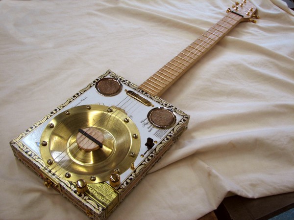

Here's a couple I've made. A four string tuned open G

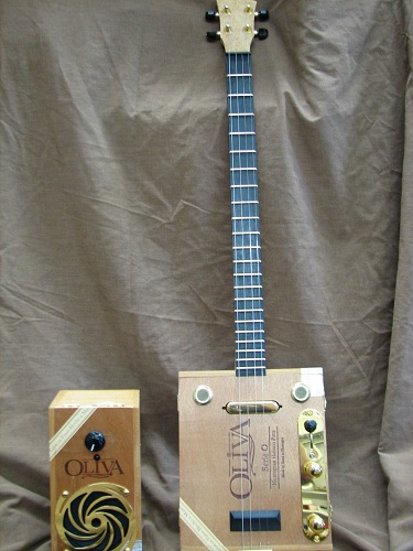

and a five string reso tuned to an open A
