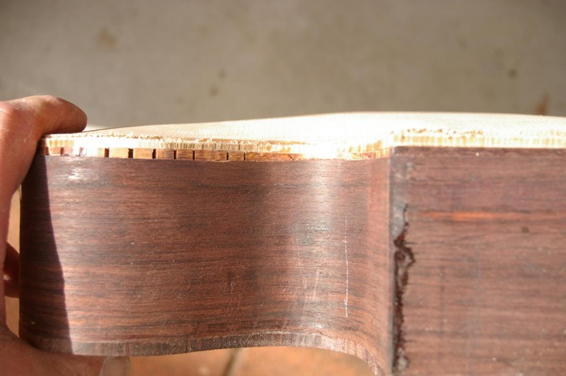

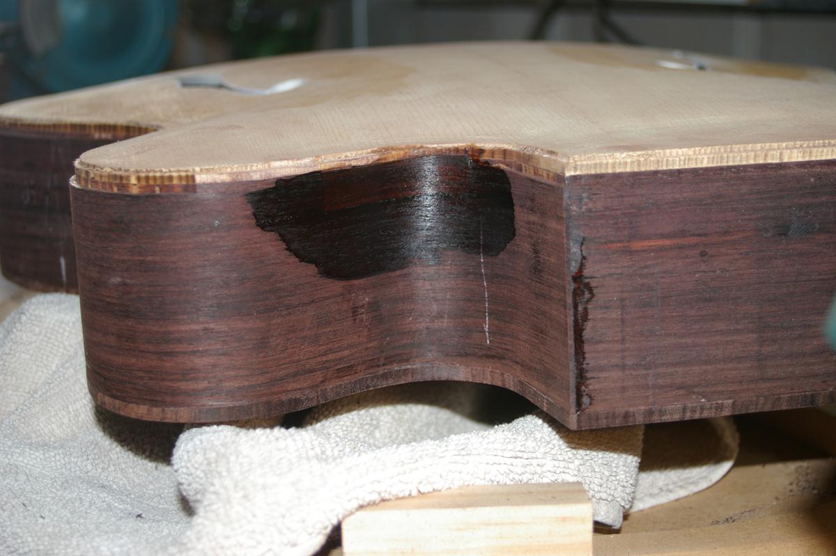

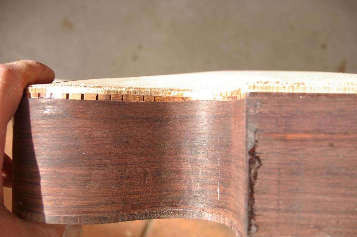

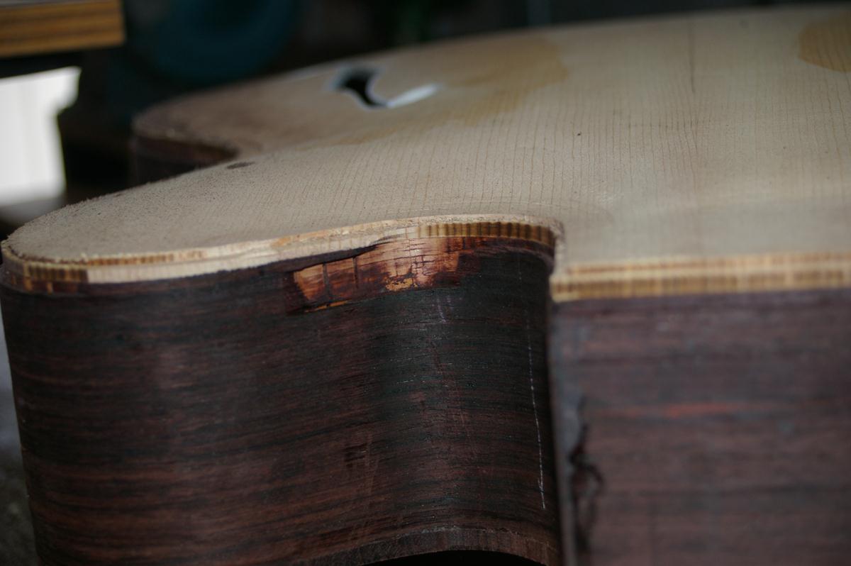

I had one of those router events today. I was cutting the binding channel on the top of the archtop i'm building and because of the shape i had the router bit as low as i could get it in the router so i could make the cut. All the way around i was thinking it's going to slip down,and sure enough about 100mm from the end it did, and of course it was in the hardest to get at part of the guitar. As soon as i realised there was way more chips spitting out than should be i turned it off, i had a section about 40mm long where it chewed out. I've made a repair and finished the channels, so hopefully it'll be nearly invisible under a finish. I guess the moral is don't take shortcuts, after that happened i modified my jig so i could have more bite on the bit and it worked fine. I hope this post will help stop it happening to someone else.

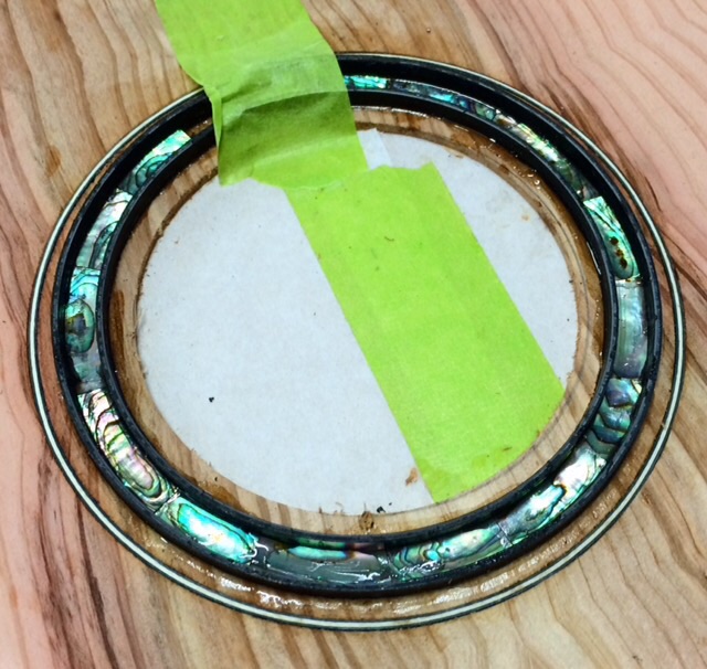

I opened the post half expecting to read about mince meat fingers or something, so in comparison your post is good news! From the pics your repair does look invisible.

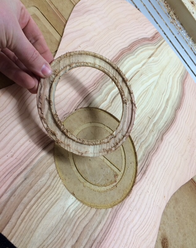

Must be the day for it. I had a router height whoops today myself. Started with the rosette ring and when it lifted up it tripped out a limit, when it continued it was out by a couple millimeters and cut the outer purf channel straight through the top!
Just like you I moved on and dealt with it. When I get to the bracing I'll maybe add a ring or something around that area for extra support. I've seen this done in some guitars as standard anyway instead of the linear sound hole reinforcements

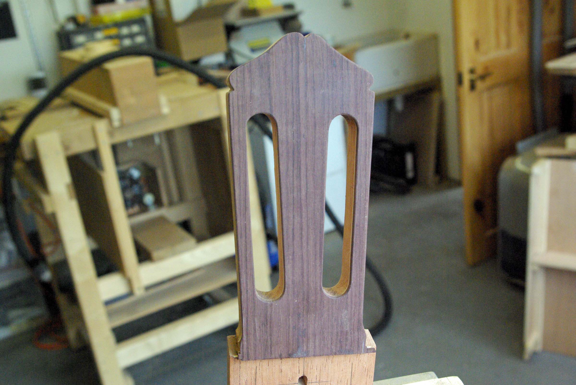

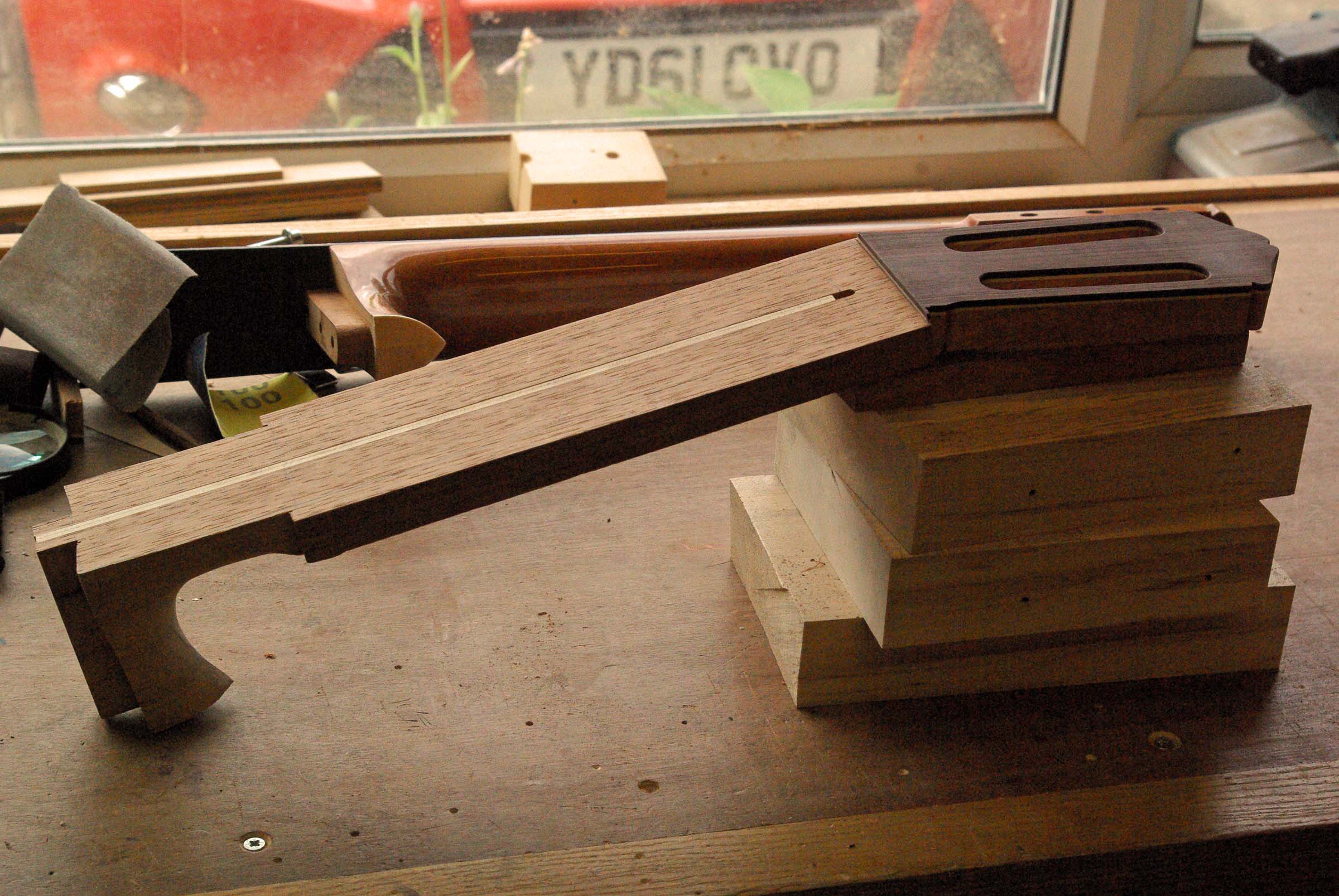

I obviously tried to take too big a bite with my pattern following routing. It is also an illustration of just how soft the 'cedrela', probably a mahogany (?) that is sold for necks in the UK.
I spent ages getting the geometry right on the mortice and tenon joint so no way am I ditching this neck. I guess I can split the scarf joint and replace the headstock piece.
I've got to find a way of reducing the risk of this. Maybe roughing out to much closer to the pattern. Maybe burying the router cutter in a fence so it can't take a deep cut...?
Seriously cross Dave

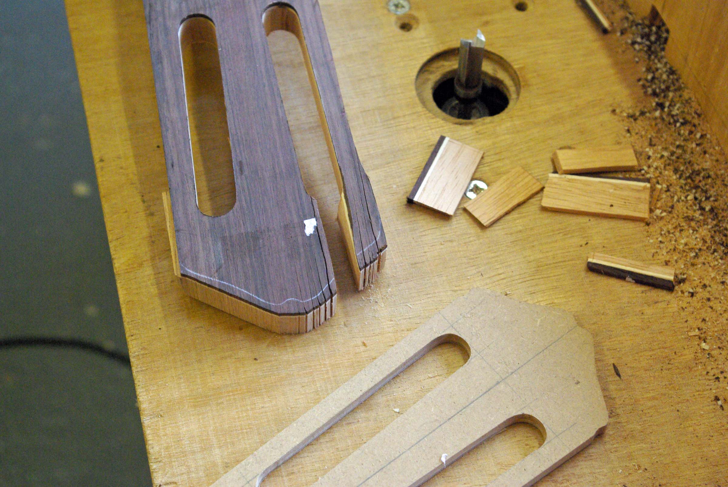

By the look of it, your first mistake is trying to take it all out in one pass. That is asking for trouble.
Try this: get a router bit machined back to 5 or 6mm for this type of cut. Instead of doing one pass, do about four passes to cut through the headstock thickness. Much, much safer.
Use your template for the first pass, then remove the template and use your first pass as the new cutting template. This removes the risk of the template moving and it also helps get the short cutting bit to the depth you need.

Well I decided that I wasn't sure I could retrieve the neck with the broken headstock so decided to start again.
It's all good practice yes...?
And indeed the new neck didn't take too long to build. Having more confidence in the process I am willing to cut closer to final dimensions rather that leaving lots of spare wood which then takes a long time to pare off.
I took all the advice offered. Note that the damage occurred routing the outside of the top of the head where it is really vulnerable on that corner.
I took the rough cutting pretty close to the line so there was not too much material left to cut with the router. I doubled up on the template so I wasn't cutting the full depth on the first pass, removing the second layer to complete. And I nibbled at it in thin passes.

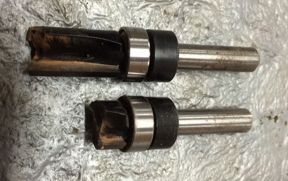

I was never able to find one I was happy with, so I bought the closest thing to it and had the tool shop machine it back to 5mm cutting depth. Costs only $80 (ish) for the bit and labor, but you get a router bit that is purposed for the job. Them you can move onto the longer bits to get the depth after the first couple of passes.

I finally remembered to snap a pic of the router bits I was talking about. These are both 1" bits, however one of them I had machined no 5mm long. Very handy.
