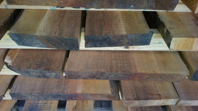

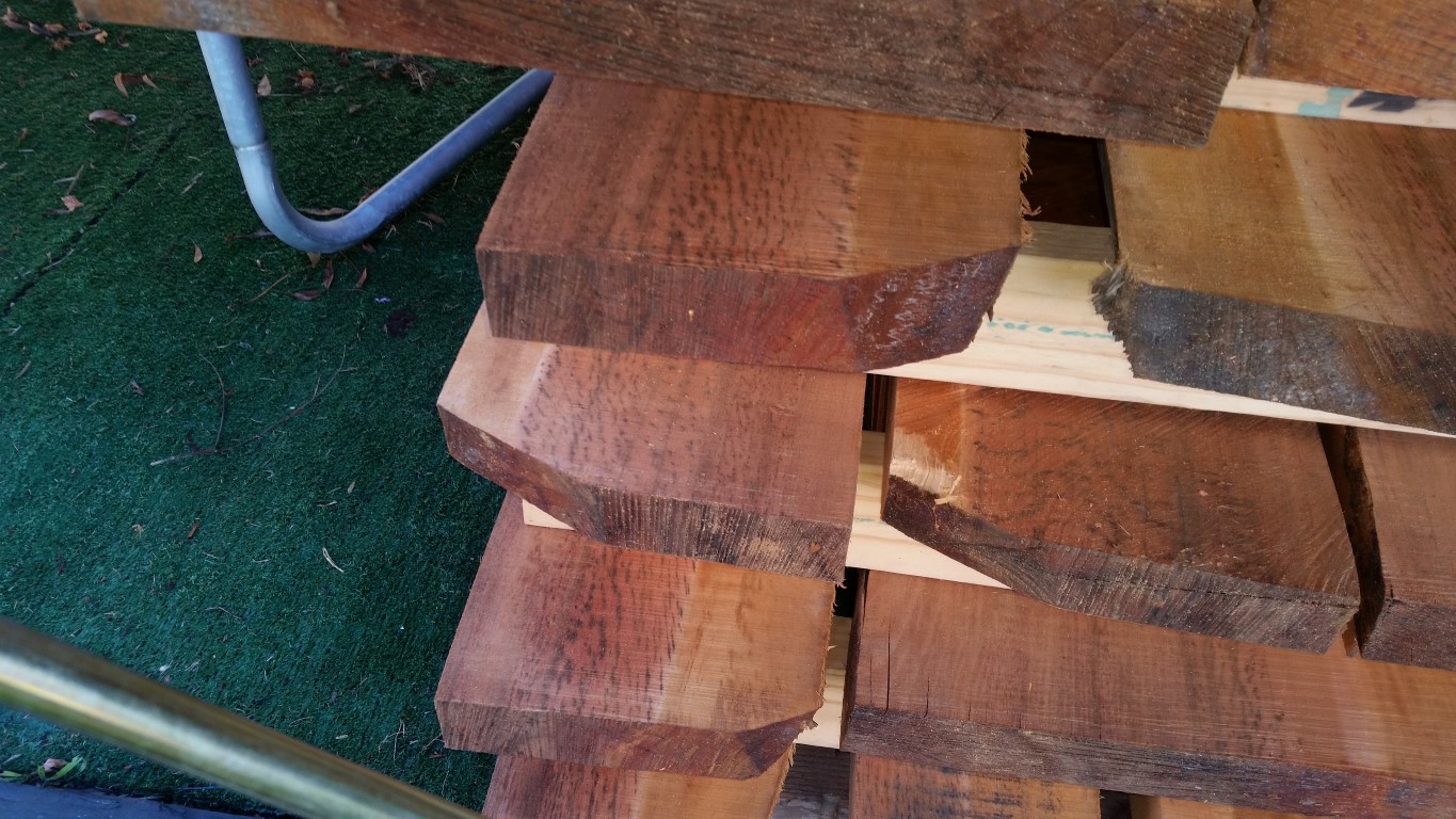

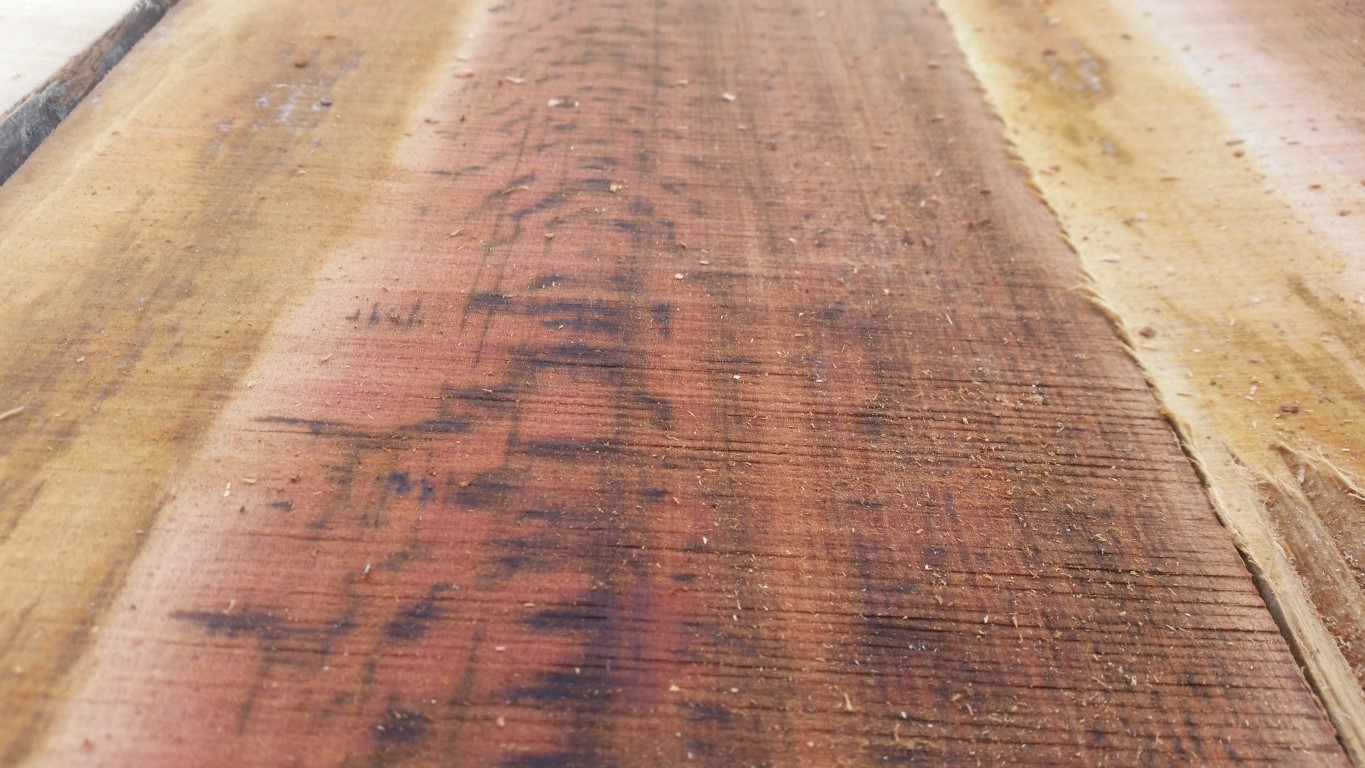

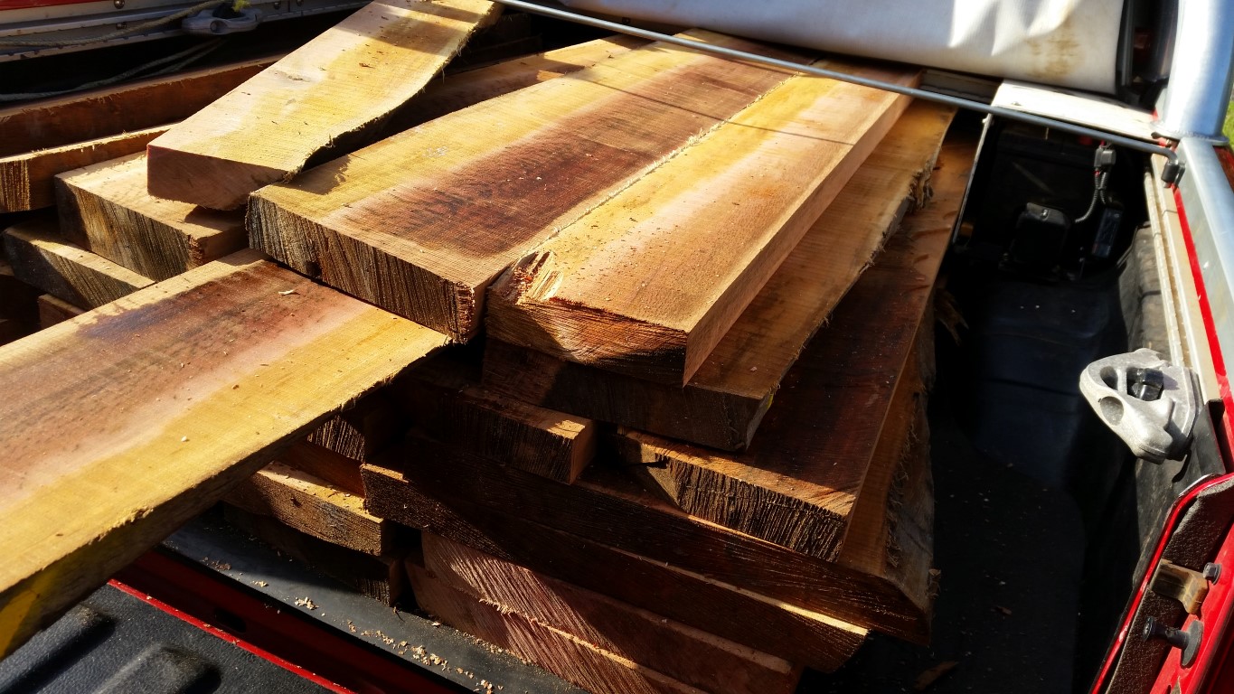

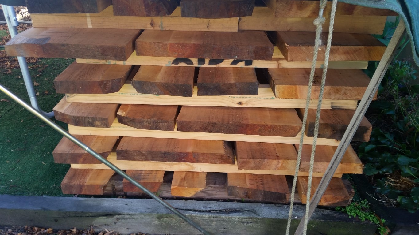

Post by Bob Connor » Tue Jun 09, 2015 8:22 am
Bought meself a log of very green Tiger Myrtle a few weeks back.
Looks like it'll yield a few sets.
This will take about 2 years to dry before I can re-saw, rack and store for a further 6-12 months.
At present it's sitting outside with a tarp over it. It'll get moved inside before the end of the winter.

Post by auscab » Tue Jun 09, 2015 10:26 am
That stuff makes the sexiest guitars !!
What are you going to paint the ends with ?

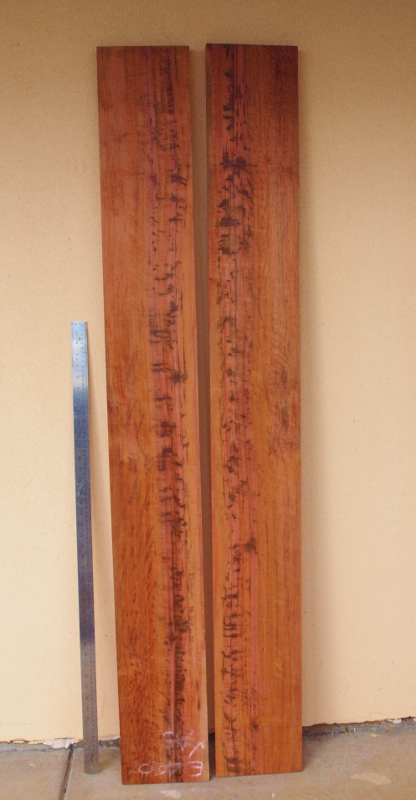

Post by peter.coombe » Tue Jun 09, 2015 1:49 pm
Yes Myrtle can be tricky to dry. Slow and careful is the go.
Must be Tiger Myrtle week this week. This arrived on the truck from Tassie today. 200mm wide and 25mm thick, and dry. Should keep me busy for a while. I'm a lucky boy too.

Post by Bob Connor » Tue Jun 09, 2015 3:43 pm
auscab wrote:That stuff makes the sexiest guitars !!
Titebond thinned 50%

Post by Bob Connor » Tue Jun 09, 2015 3:45 pm
Myrtle doesn't give up it's moisture too quickly so I agree slow air drying is definitely the way to go.
If that lot were Blackwood I'd be re-sawing tomorrow.

Post by curly » Tue Jun 09, 2015 7:33 pm
Sounds like you've got it well covered there Bob . I agree with not resawing from green in Myrtle , it's fairly volatile in drying . Other thing I'd add is don't retard the drying too far though . Tiger is fungal and whilst the timber is wet the mushrooms alive .
