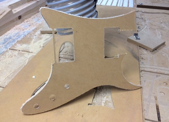

I've drawn the CAD & CAM, I'm just waiting on material to arrive. Being I don't use pickguard it's not something I keep in stock. In saying that though I probably should spit out a test one in MDF first before chewing up expensive plastic

Post by demonx » Sat Jun 27, 2015 2:54 pm
Looks like it'll do the trick:
