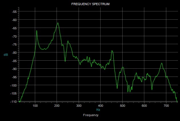

I did a tap test with the finish and the bridge on, although I know in a classical the extra stiffness can actually raise the resonance of the top I was surprised that it went up nearly 10 Hz. With this tap test I ended up with 203.6 Hz for T(1,1)2 up fro 194Hz; T(1,1)1 = 107Hz and T(1,1)3= 149Hz.
I need to wait a few days for the finish to cure and I have a set of strings on the way. I am excited to hear how it sounds.

T(1,1)3 249 rather than 149Hz?
The bridge patch plus the CF in the bridge would be adding a fair bit of stiffness to the top.

Post by johnparchem » Wed Jul 15, 2015 8:59 am
Yes thanks for the correction; 249 for the back.

I strung her up and she sounds pretty good. So far I am using the original nut and saddle unchanged. I need to take about a MM off of the saddle, to nail the action. I think my bridge slot was not quite as deep as the original bridge. I also need to take a bit off of the nut slots. I am going to wait a few day to let the top settle in on a tonerite before I finish the setup.
With strings, T(1,1)1 ended up at 101 Hz T(1,1)2 is at 193 Hz and T(1,1)3 is at 243 Hz pretty close to my target.
