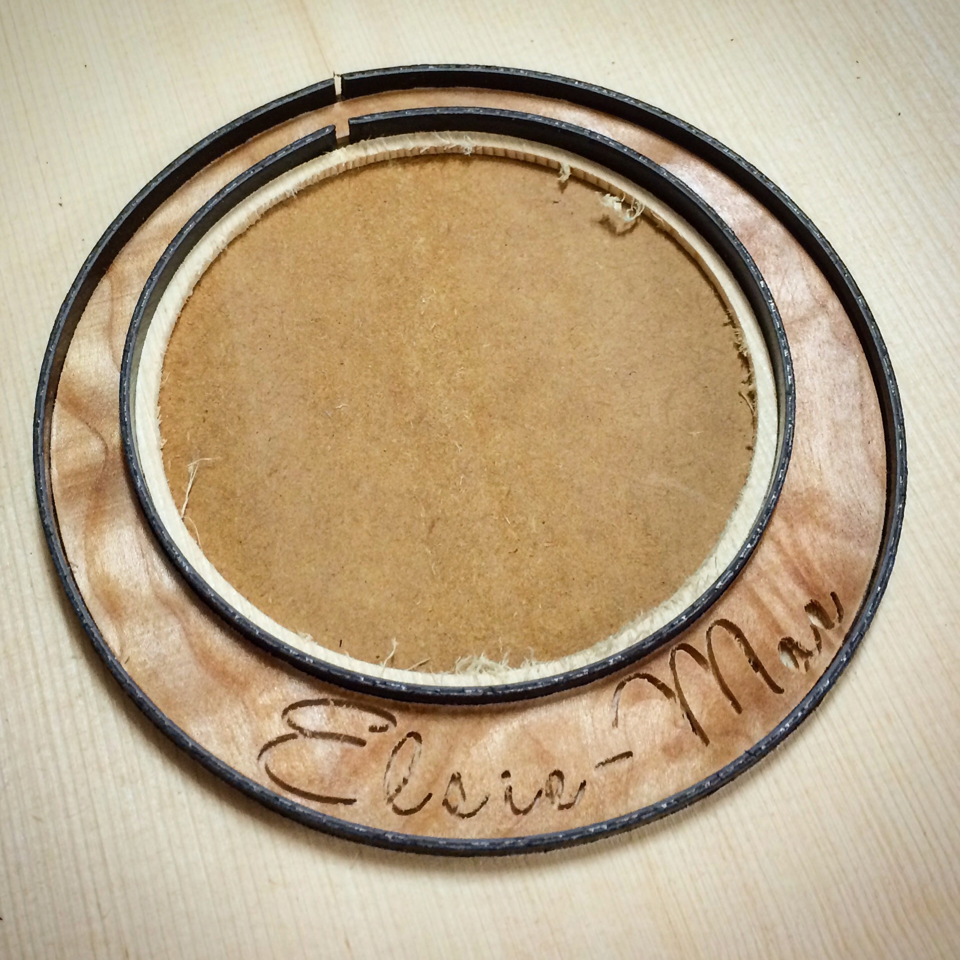

So far my focus has been the rosette and inlay as the customer want's his daughters name in the rosette, hence "Elsie-May". When I was drawing up the inlay I was wishing she was named bob or something that had nice big round letters! But, here it is so far:

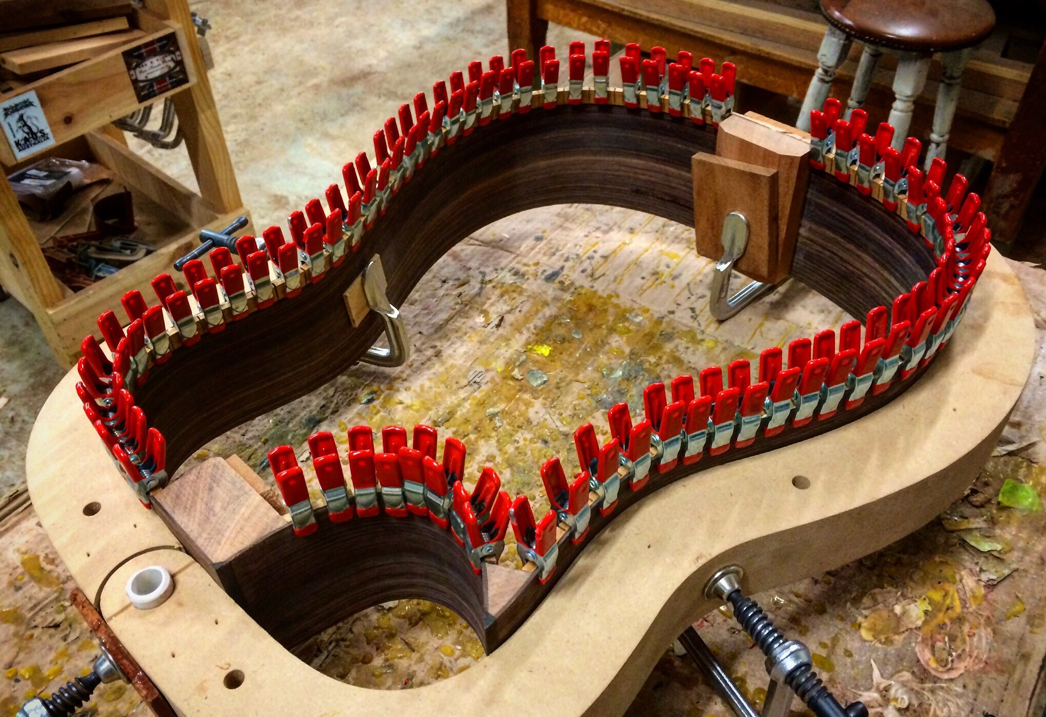

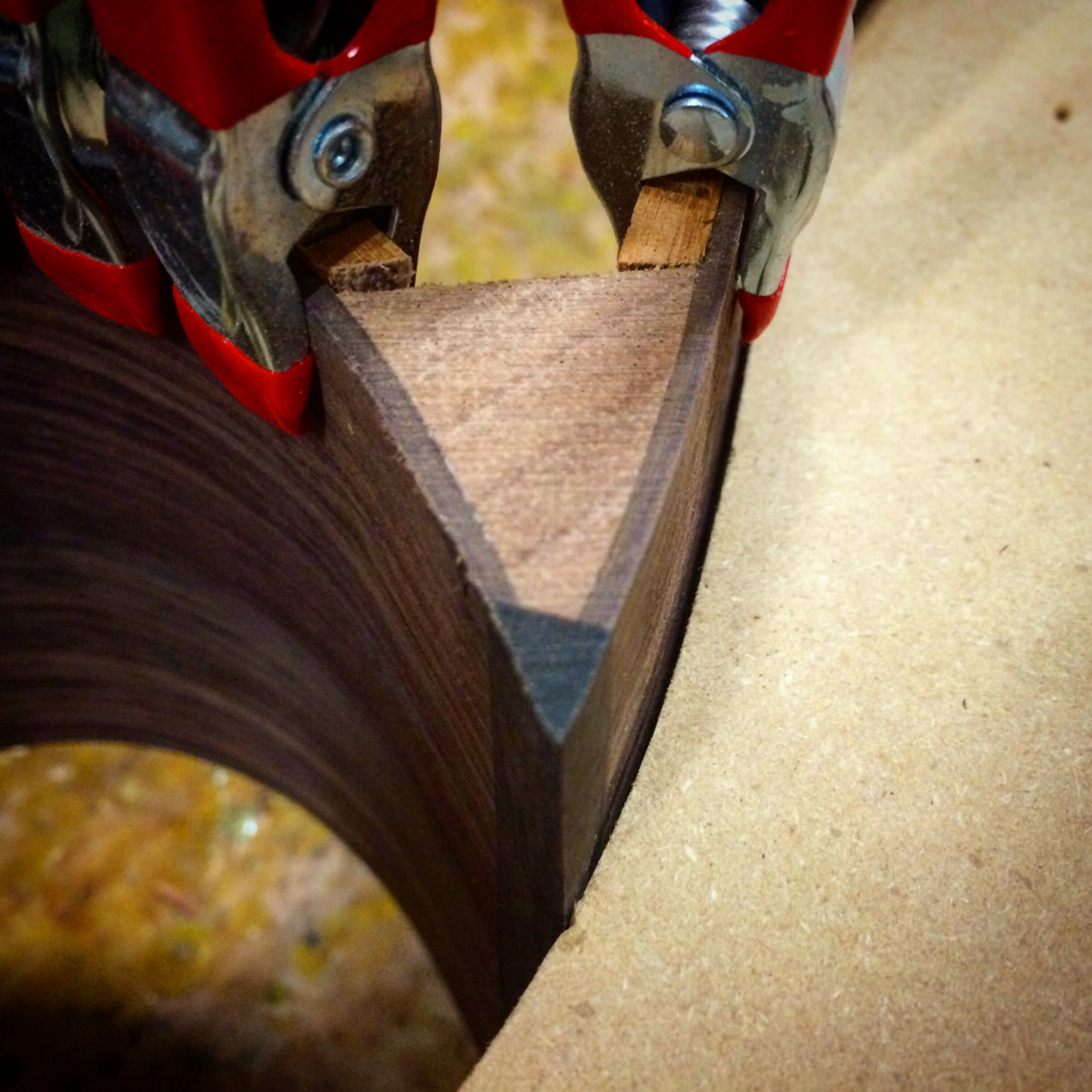

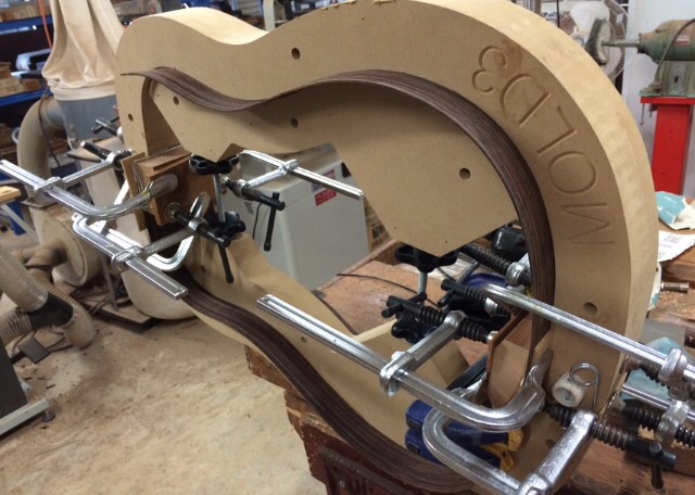

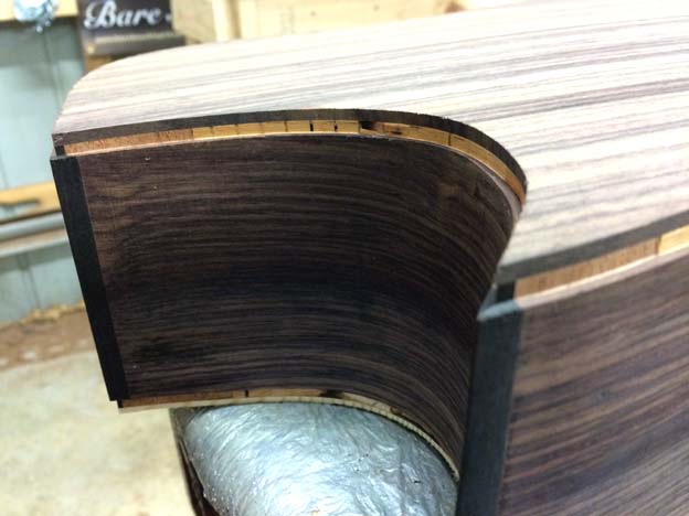

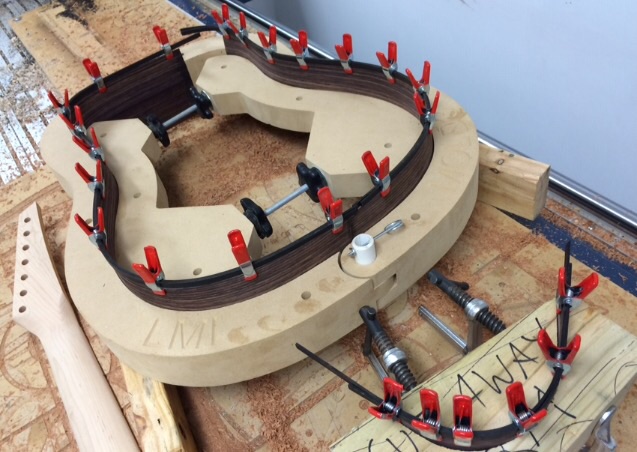

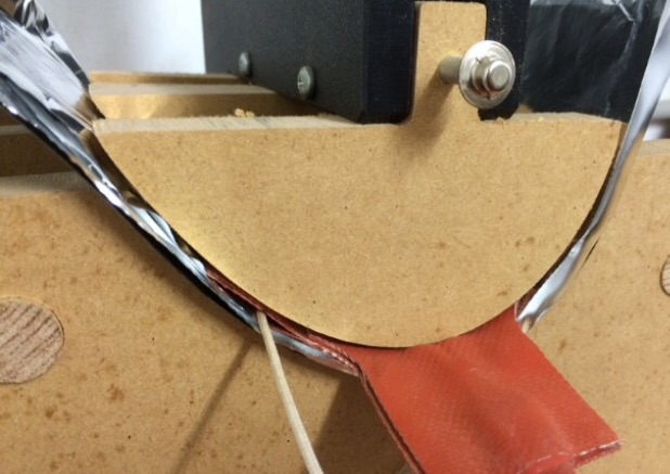

I've also joined the back and bent the sides and binding.
The cutaway was bent on the LMI bender and I threw some ebony binding strips either side. All went pretty smooth.
- image.jpg (63.65 KiB) Viewed 23299 times
- image.jpg (96.96 KiB) Viewed 23299 times
- image.jpg (66.62 KiB) Viewed 23299 times

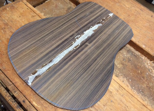

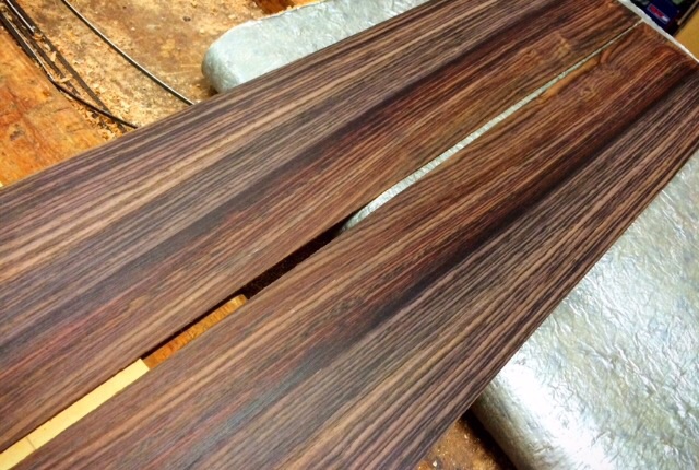

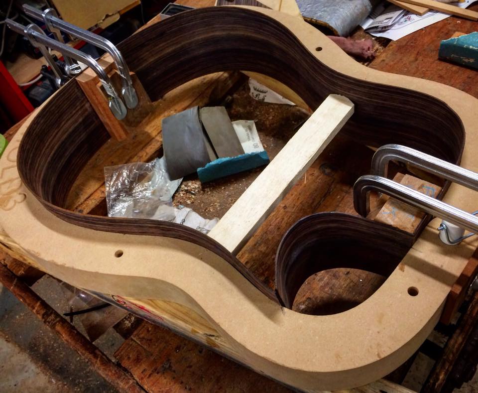

I should probably show the back and sides before I went messing with them!
It's a set I bought from a retired luthier who has had them sitting around for over thirty years. Dead straight and beautiful timber.
The sides cupped a bit with the heat of the drum sander, so I had them under weight for a week before I finished taking them back to thickness as seen in this pic. They're nice and flat again thankfully.
- image.jpg (117.43 KiB) Viewed 23298 times
- image.jpg (103.48 KiB) Viewed 23298 times

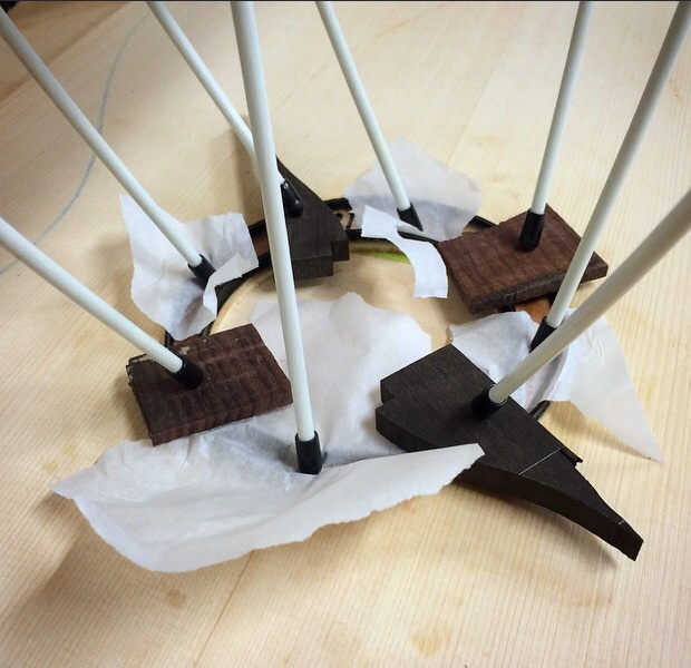

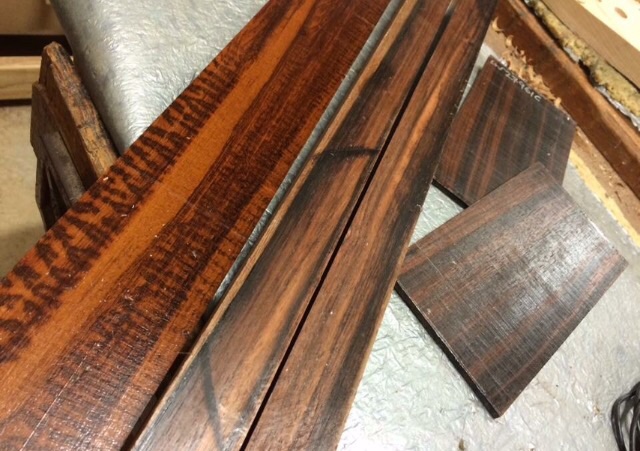

The snakewood board blank and two piece ebony neck blank with a couple of ebony head caps that I'll make a sandwich out of
- image.jpg (107.88 KiB) Viewed 23294 times

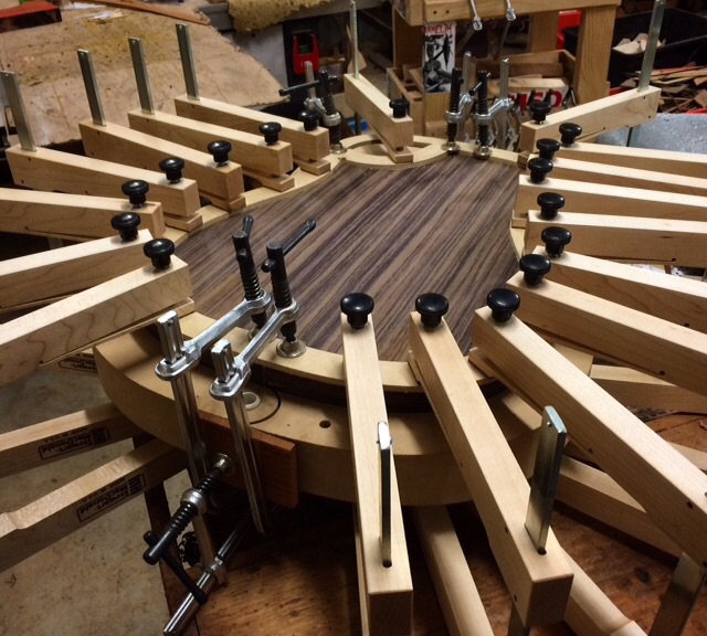

Rosette glue up using epoxy and the go bar:
- image.jpg (92.27 KiB) Viewed 23273 times

Re: Elsie-May dread cutaway build
Hi Allan, in the heading you've spelt May with a y and on the rosette it looks like an e. Is it just the camera angle?
That would be spell check giving me a hand I did not ask for and myself not proof reading before posting. It is supposed to be Mae. With the forum setting not supporting "edit" after a short time I cannot fix the err.56nortondomy wrote:Hi Allan, in the heading you've spelt May with a y and on the rosette it looks like an e. Is it just the camera angle?
In the rosette, the center of the last two letters is supposed to be there, but it broke out and went up the dust extractor, so I'll add them later by hand once it's all together and sanded back.

Well I'm glad the rosette's right Allan, be a pain to have to fix.

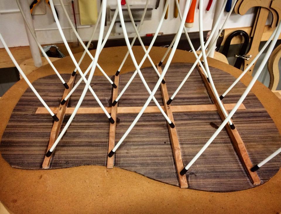

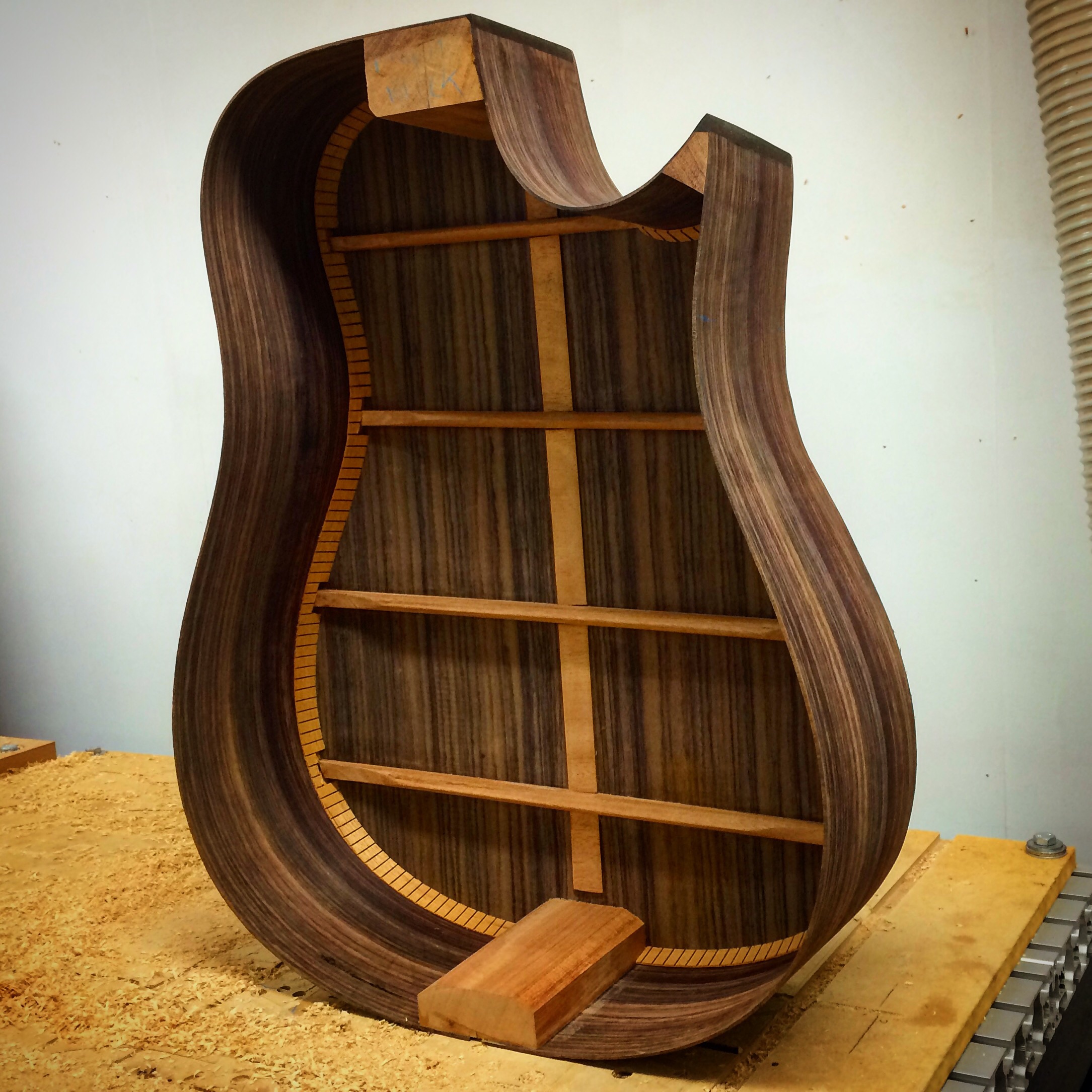

Moving along to back bracing and getting the cutaway all joined up.

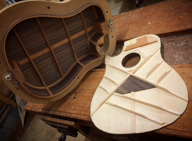

A bit more progress on "Elsie-Mae"
Ebony tip for the cutaway, also rear Kerf is now on.

Did you shape side linings prior to fitting back.....no pics of this but I assume you did same??
Yes, using a dish before the linings went in and again after the linings were in.

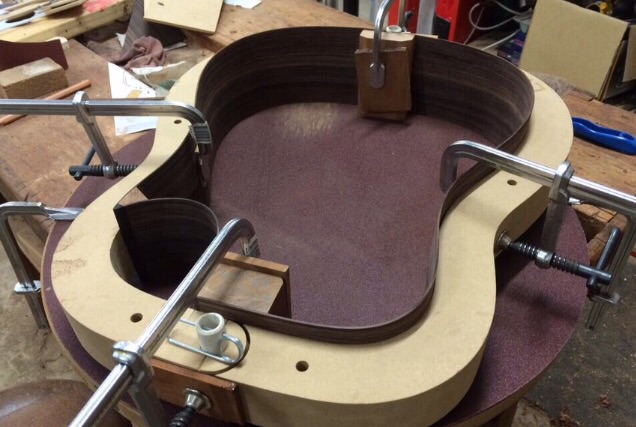

Spent a bit of time getting the back flush with the sides tonight. In happy with the result.
The combination of radius dish and the new clamping caul I made up have provided a join that is more than satisfactory.

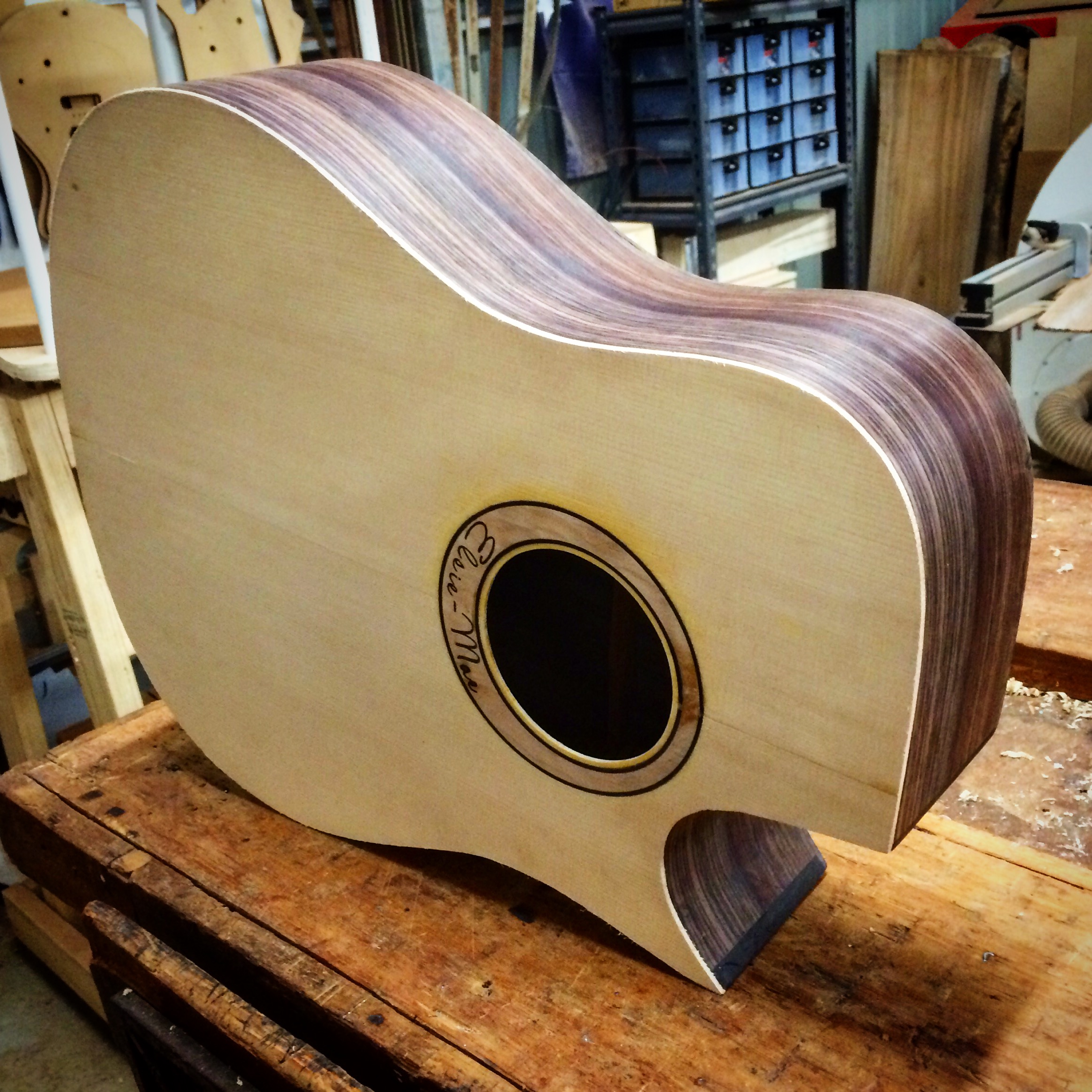

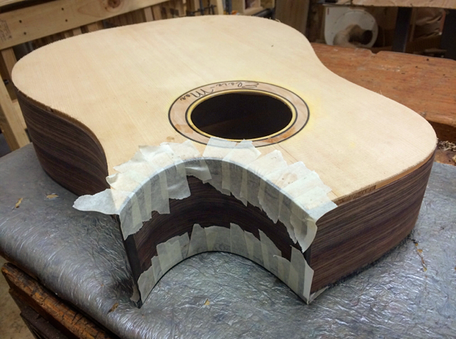

It's been a while since this one was updates but over the last week or so I've tinkered with it a few times so here are a couple more pics:
Please tell me that yellow stain around the rosette is nothing to do with using CA glue...
Hopefully it's just shellac Allen brushed on to stiffen up the spruce prior to cutting the rosette channel?Trevor Gore wrote:Please tell me that yellow stain around the rosette is nothing to do with using CA glue...
Yes, unfortunately there was a bit of spillage when I was doing the rosette. I've given it a light sand but left it there for now and will scrape it later on and hopefully the stain will go. The rosette is still not sanded back yet, I tend to leave everything pretty raw until just before final sanding/paint stages, something I do when building electrics, BUT, I didn't exactly rub CA everywhere, that WAS a screw up!Trevor Gore wrote:Please tell me that yellow stain around the rosette is nothing to do with using CA glue...
- Posts: 558
- Location: Seattle
I hope it is just a top stain. I learned that CA can wick into end grain in spruce and redwood and stain yellow or green. In my case the stain was about as deep as my unsealed channel.
