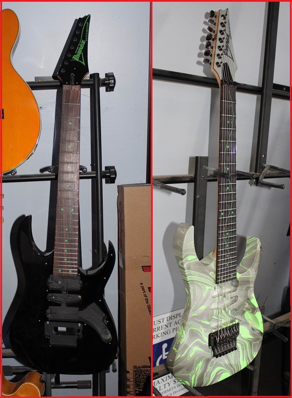

I took some photos for our facebook page
Thought some others here may be interested
as it left our shop yesterday, customer to fit his custrom made electronics into it
On the left how it came in on the right how it went out

Hopefully the owner wont notice the pickups missing :D

Post by simso » Sat Aug 08, 2015 3:12 pm
Hes fitting his own custom made electronics

Wow, amazing paint job.

Looks good from here!

The paint was actually the easy stuff

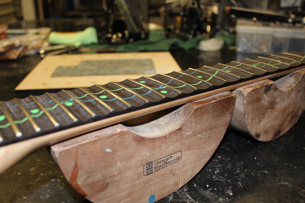

Here is a close up of the fretboard, fluorescent blue and green dna chain routed and fitted, paua shell dna markers, fluorescent fret markers, fluorescent side markers, full scalloped fretboard 1.5mm deep, and of course a new fretboard and a refret

A scalloped fretboard......I would have gone the whole hog and added TT frets :mrgreen:
Scalloped frets intrigue me....
