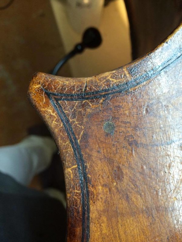

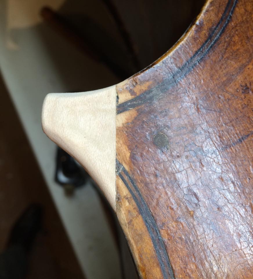

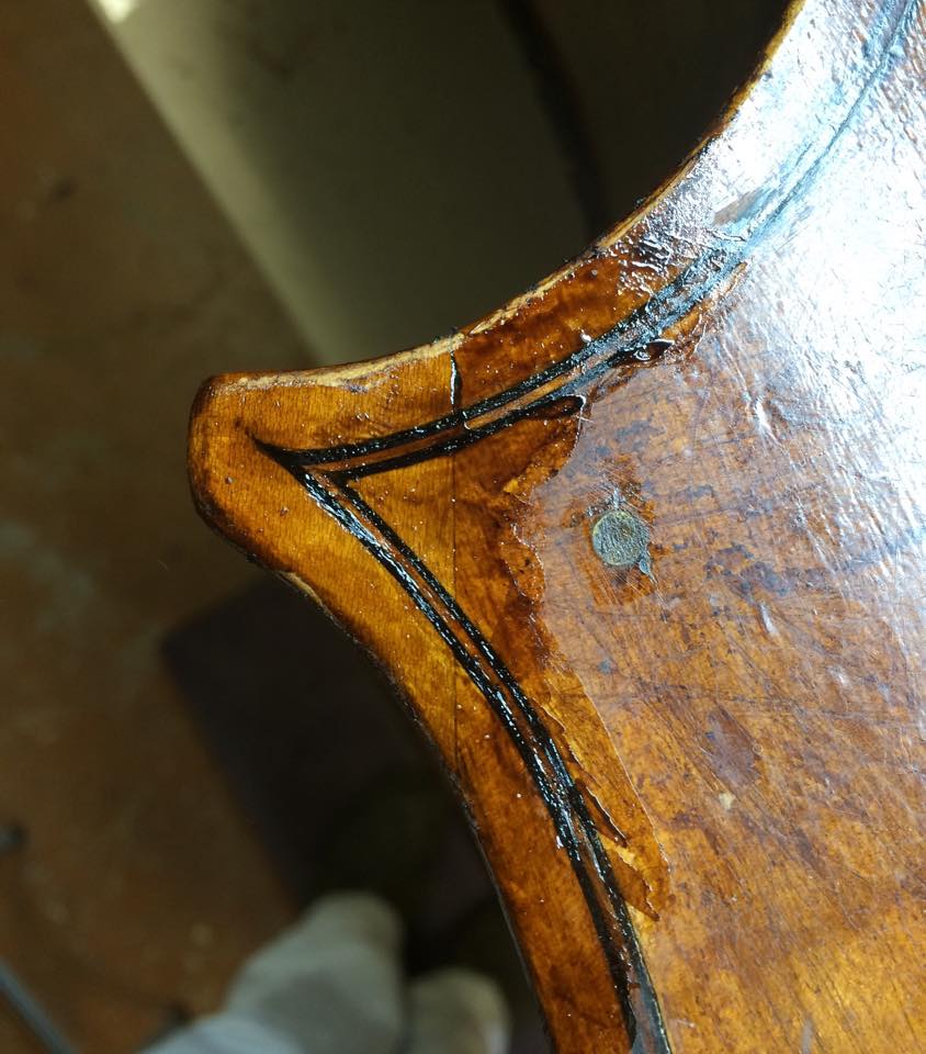

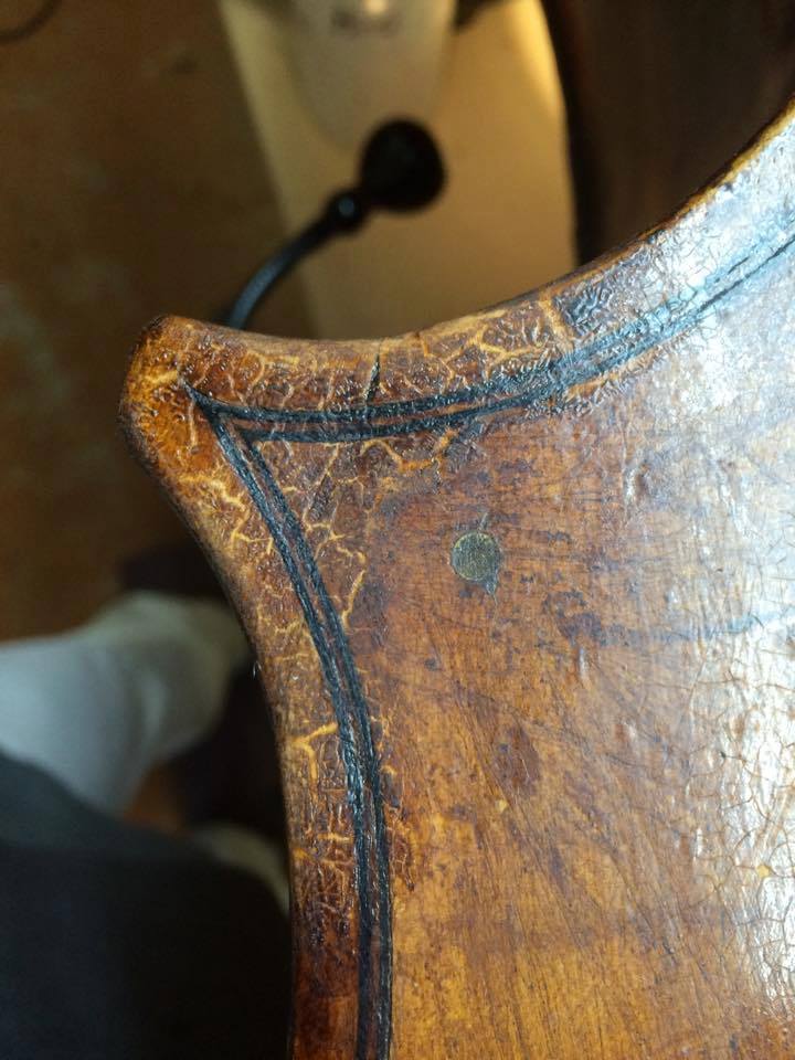

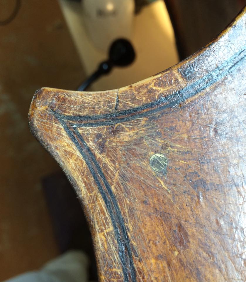

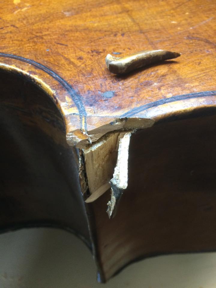

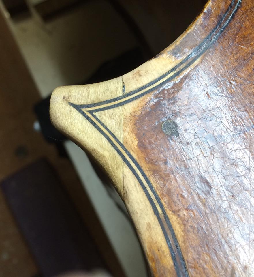

Here's a quick recap of a corner replacement on an approx 150 year old double bass.
The corner had already been chopped off diagonally by another repairer, but it was shoddily done, and it crumbled apart. If I had been replacing the corner for the first time, I would probably have tried to cut the damaged corner off in sections along the wood grain lines,instead of one diagonal saw cut. But as you can see, I think I hid the repair quite well.
Hide glue, shellac and custom made purfling ...

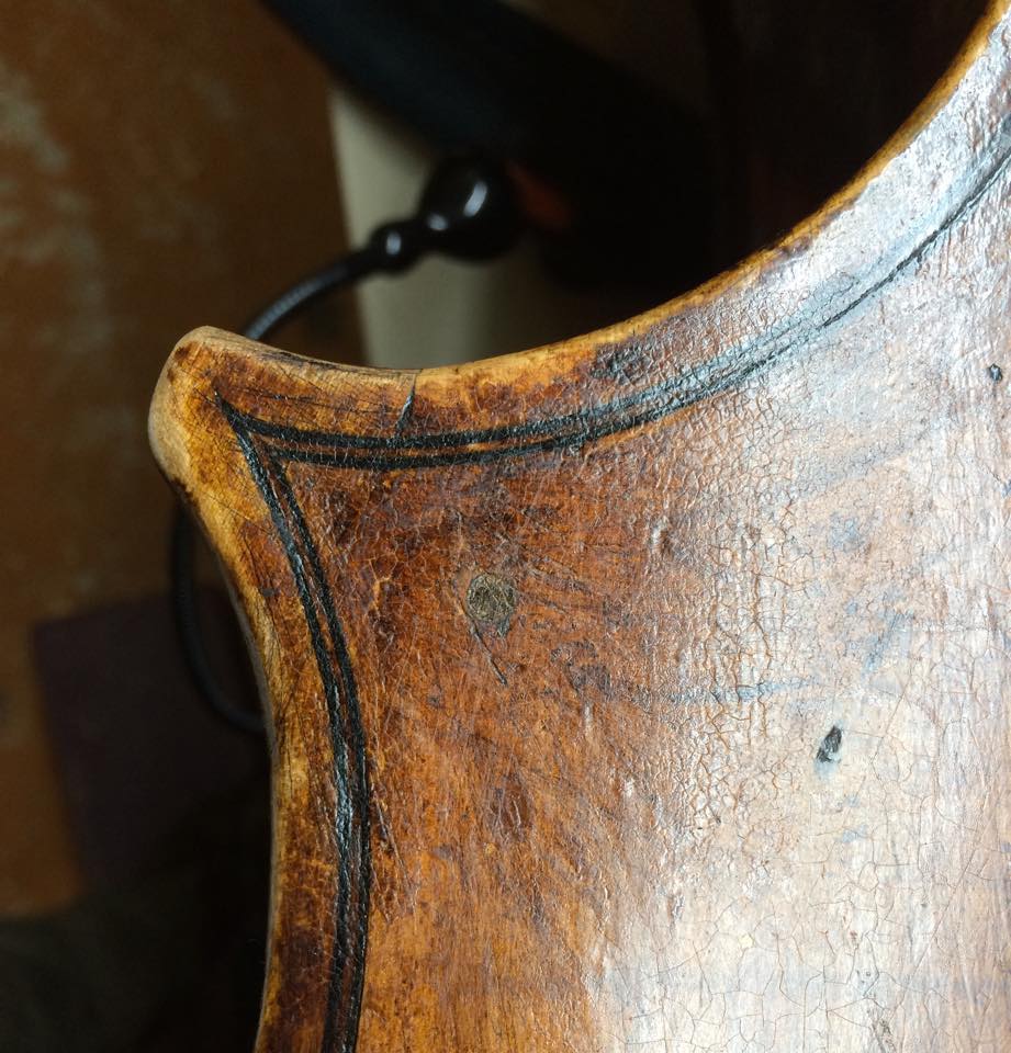

Getting the wear and cracquelure looking nice is quite a challenge.

matthew wrote:Getting the wear and cracquelure looking nice is quite a challenge.
And you mastered it very well! :cl :cl :cl
May I ask how did you achieve that cracquelure?

you have to use something that shrinks as it dries - like a clay pan - over a soft varnish layer. it's hard to control. too thick and you get massive cracks, too fast and it pulls away, too soft ditto, too thin or too slow the cracquelure doesn't work at all or it is too fine. too hard ditto ... a lot of trial and error.
I use a mud made of van dyke brown crystals. it washes off after. experimenting with other things ... fine clay might work well.

Thank you Matthew for describing this most interesting technique. I didn't even know what van dyke brown crystals are or that they existed. It would not be you if you hadn't experimented until getting this technique down to perfection. Congrats again!

Post by matthew » Tue Aug 11, 2015 10:23 pm
i didn't invent the technique; I heard about it ... but there is very little published information on it. it's one of those things you either have to learn by watching someone else - or experimenting!
Oh and ... I haven't "perfected" it ... but I'm getting better at it.

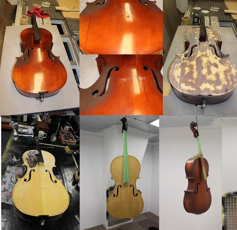

Here is a cello top I painted yesterday.
Before I did the work, there was 17 repaired cracks, and a graft of new wood.

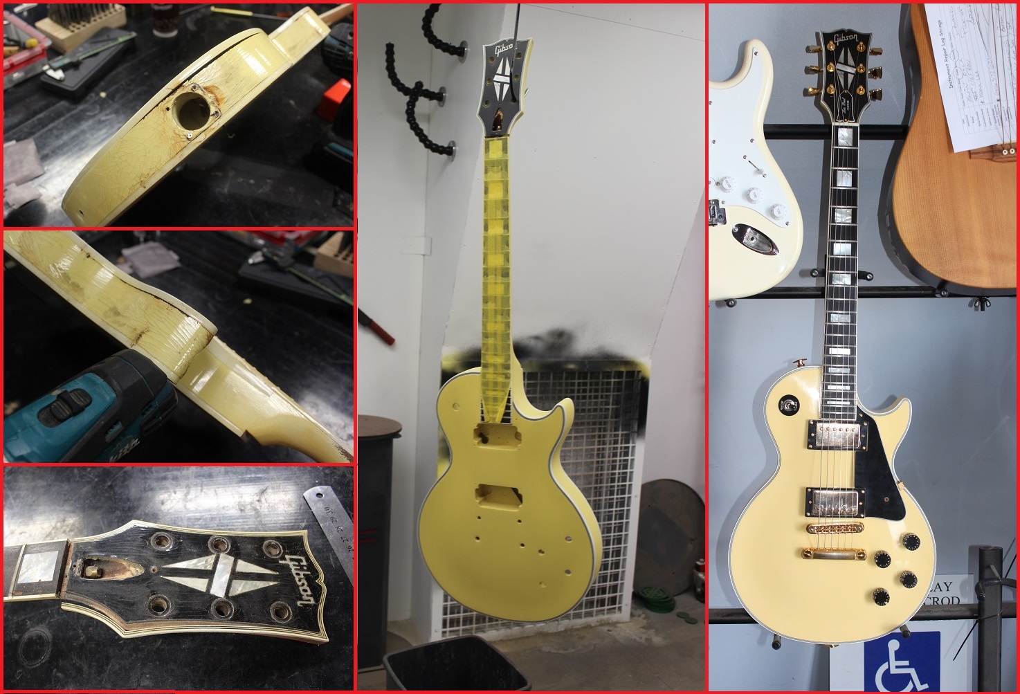

Here is a restoration, be that a guitar, under the scenario you offer, the instrument should be left in its daggy broken state and just continue to be patched up, or it could be made into a thing of beauty again as per customers wishes.
Its not our right to say this is the only way something should be repaired or restored, its up to the owner, our job is to facilitate that process with the skills we possess.

simso wrote:Here is a restoration, be that a guitar, under the scenario you offer, the instrument should be left in its daggy broken state and just continue to be patched up, or it could be made into a thing of beauty again as per customers wishes.
On a guitar like that you are adding value to it because it was probably only worth a couple of hundred before the repair, it had no history or provenance

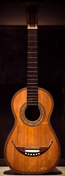

In 2008 I was approached via an Internet forum by the owner of this guitar (here in its restored state in 2014) he discovered in 2007, and because he had seen some pictures of some flawless crack repairs on instrument tops I had performed around that time he asked me to repair it.
I instantly declined because I guessed by the photos he provided of the rather deteriorated instrument, who was its builder. But of course I was far from being sure I was right, and I recommended him to leave the instrument alone while he wasn't sure what it really was or he had not the money to get it properly restored, and to get some advice by experts who could see the guitar "in flesh". I provided him with a few phone numbers, directions and email addresses of capable and internationally acknowledged musicologists and master luthiers.
Now I'm letting you have a guess if you like:
Steve, what's the name of the luthier who built this guitar?
P.S.
IMHO the restoration turned out less than perfect. But at least it is 100% reversible, which was one of the main goals of the restorer.
