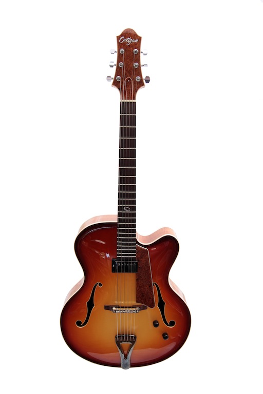

Post by rocket » Tue Aug 11, 2015 7:27 pm
Just a bit of a post script, the full body with the oval sound hole is designed as being purely an acoustic instrument the cutaway model has solid carved plates but has been designed to be played on stage having slightly longer bracing, slightly thicker soundboard and top mounted pup and controls but still enjoys the resonance, flavours and tones of the carved Blackwood and Engleman Spruce.
