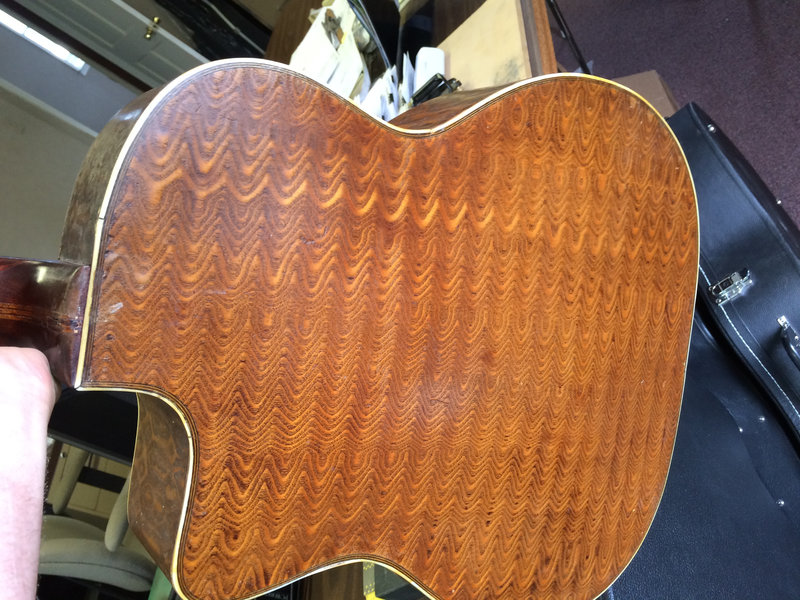

Anyone know what in the world this might be? The guitar is 70 years old, built in Paris. The rumor is it came from an Island in the Pacific Northeast, ala British Columbia (US East Coasters call this the Pacific Northwest) The finish on the back and sides are probably newer, no stain apparent. The back and sides are laminated as is typical of this style guitar, what you see is a veneer and probably some of the crazy pattern is the way the veneer is cut. Would love to find some of this for a replica. The guitar btw is a 1940s Busato.

Another pic (yeah the side is cracked all the way across at the waist, crudely repaired, but solid)

I couldn't say species but what I'm seeing is a man made veneer . The process by which it is made is pressing a stack of variously coloured veneers into a corrugated form and then rift slicing the flitch . A similar effect can be gotten by flat sawing timbers with a pronounced growth ring when the log has a rippled surface but the effect is more irregular .

Yeah, it is mesmerizing. If you look at it for a bit it takes on a 3D quality.kiwigeo wrote:Looking at that back is making me dizzy
Curly, I can see why you say it looks man-made, but taking a close look at it now, I don't think so, no evidence at all of glue lines which are readily seen in even modern composite veneers.
I've had three guesses elsewhere: 1) Olive 2) Quilted Cypress and 3) a wood that only grows on an island off the coast of British Columbia, but the name has been lost. I'm skeptical about the first two and have way too little information to judge the third one. I'd love to get some of this and this step is identifying it.

If you look at the timber in the back with a mind as to what would need to be going on in the tree it's pretty well impossible that it is not constructed .
Across the entire width of the back the pattern is consistently rift . At no point does it roll either to quarter or flat sawn . It's a single piece , not book matched . There is no evidence of sap , heart faults or roll from flat to quarter which is inevitable on a wide board . The tree would have to have been enormous ! When sawing out such a wide cant it's very unusual for the figure to not vary within the stem . Usually figure gets stronger to the outside of the tree . Trees trend toward stronger figure with age .
The sides on the other hand look more possibly natural as the figure is flat sawn with a crown wash figure often seen in conifers and ring porous hardwoods like the fraxinus genus ashes . I milled a satin box ( Phebalium squameum ) a year or so back with a very similar figure to the sides . It was a radical looking log , it had even concentric bands ever two inches or so .
Suggesting the veneer is constructed is not to put the instrument down . The effect is spectacular .

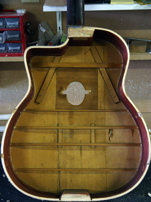

I have always wanted to examine and play a Busato...apparently they vary considerably. I have also read that some had back bracing, and that the neck to body join had no dovetail, mortice or dowels...only held by casein glue, and I have never heard of a Busato neck to body join glue failure! I am interested in how Busato formed his "Bombe" in the soundboard...I have my theories and speculations although I have never seen one, my research is mainly internet based...I read that his soundboards were made from multiple pieces of spruce. My theory is that each piece is bent, the centre one more than the side pieces, then they are shot and joined thus forming both a pliage, not so sharp a curve, and a cross ways domed effect=thus the "bombe". Interested in your ideas?

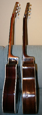

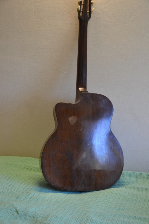

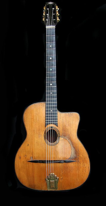

Some Busato shots from the internet.

- Busato sides.jpg (17.17 KiB) Viewed 25543 times

Yeah, Busato's are cool. And as you say, quite a lot of variation, hard to make generalizations. Good to see the pictures. I took the 4th on down, on the green blanket, while studying that guitar. And thanks for the model specs, the Busato I have here has a 12" radius fingerboard which is unusual among gypsy guitars. They are usually 20" or flat. Interesting to see 12" on others. I'm replacing the fingerboard which is not original and wondered if the 12" was a rock-n-roller's vision of what a good neck should be. Looks like it might have been Bartolo's idea from the start.

Curly has it right. There is no chance that that is a natural figure. Man-made with veneers, and nicely done.

If it were natural then Fir ( pseudotsuga menseisii ) would produce the right proportion of early / late wood bands that the instrument shows . And they certainly do get big .
It's the consistently rift sawn thing that's got me . Sawmillers , speciality or otherwise don't rift saw by preference . A veneer flitch that could produce that degree of figure would be recognised as precious . It would be an even stronger figure flat or crown cut as the sides are . Why wouln't they ?
It's hard to put the visual into words . I'll try . For a natural tree to cut that figure you have a stem with very regular bands or raised ridges horizontally . Fiddleback is produced by corrugations in the fibre in the radial plane . The sample would have to be in the tangential plane . Horizontal corrugations can show up in buttress curl reaction wood though I've never seen anything nearly so regular .

Hi Craig, how´s it going? i´ve been intrigued by that same guitar... indeed the figure seems to good to be true. Could it beTamo ash?
