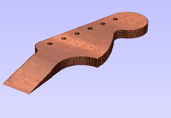

Folks,
Wonder if someone out there has done this or knows of others that already do this.
Currently when I need to make a neck that is angled, I simply do the scarf on a table saw, and glue the joint up.
To turn that into a neck, I either do it by hand or I strap the whole assembled unit and cnc machine it using a long cutter.
Necks like teles and strats and so forth, I can draw up in cad and have the cnc punch them out in about 15 minutes a unit, that is shaped, slotted for truss rod and rear contour profiled, we use these in our kits that we supply to others to "assemble"
I wish to make a joint system like a lego click together, that allows me to create a scarfed neck on the cnc, clearly it would be in two pieces, but ideally, it would click together. Taylor used a fingerjoint option and so do deering banjos, so that is an idea
I have been over thinking this one for quite some time and just cannot get my head around it, anyone doing it at the momment or have ideas or seen something similiar
Ideally I do not want to simply machine a slip joint, I can do that now if necessary, but think it could be way better than that
Thanks in advance

Re: Advice sought, cnc a joint for scarfing
Post by simso » Sun Aug 23, 2015 2:40 pm
For those that may be interested
We currently supply scarfed heads to any supplied drawing, ready to go for other builders / repairers at 12 or 14 degrees normally
This however is not what Im trying to achieve here, and it has me stumped to an idea
I want to make a better system for our in house complete necks that are scarfed
