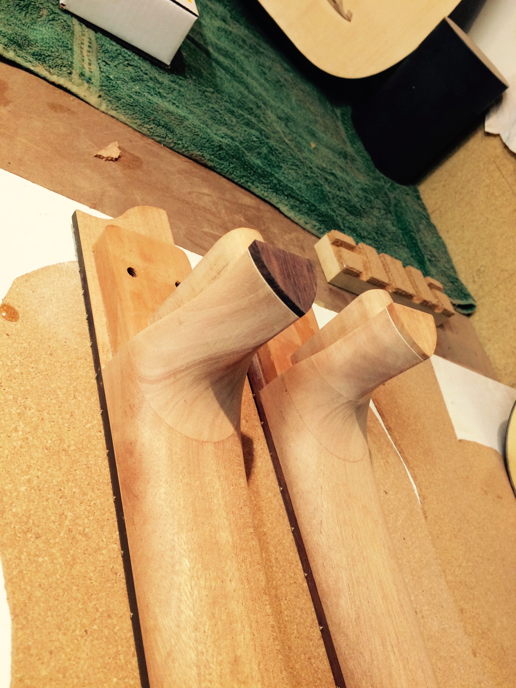

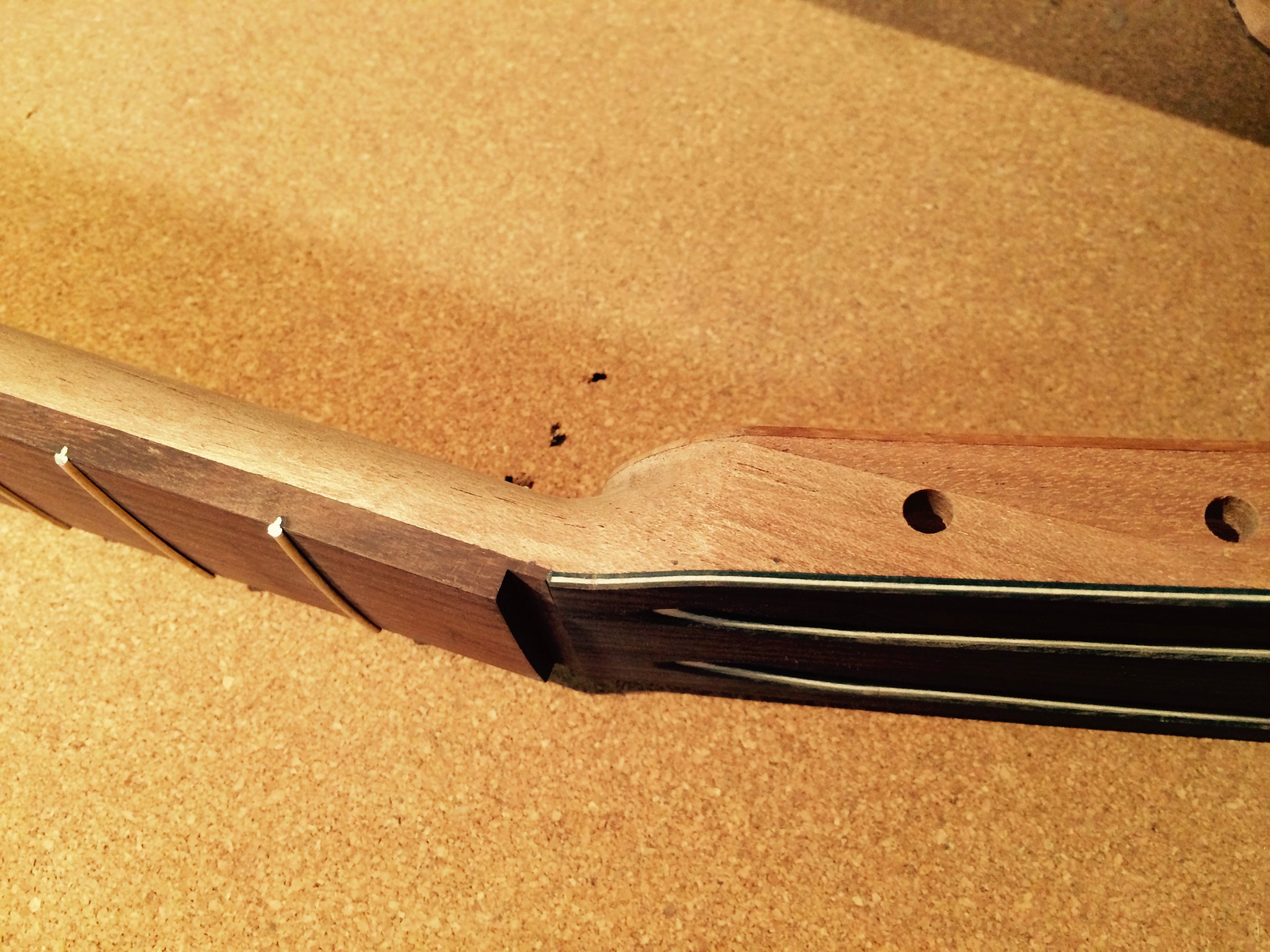

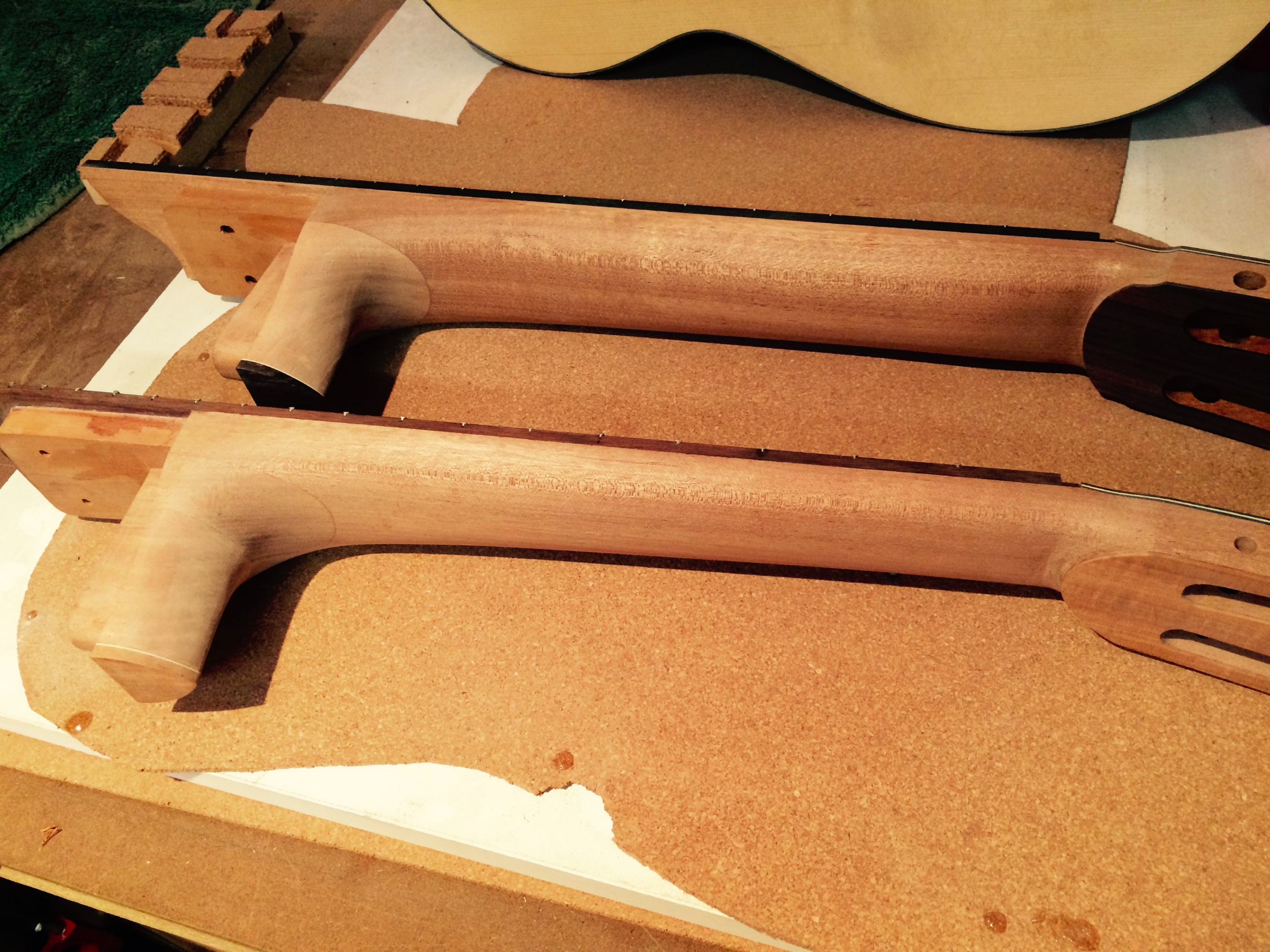

Queensland Maple necks for Parlour and Classical builds currently under way. The classical neck has a thin wedge glued in between the neck and fretboard in order to achieve the positive neck rake required on a classical.Cloverfield wrote:Interesting. Do you have any photos of your builds with Queensland Maple?
