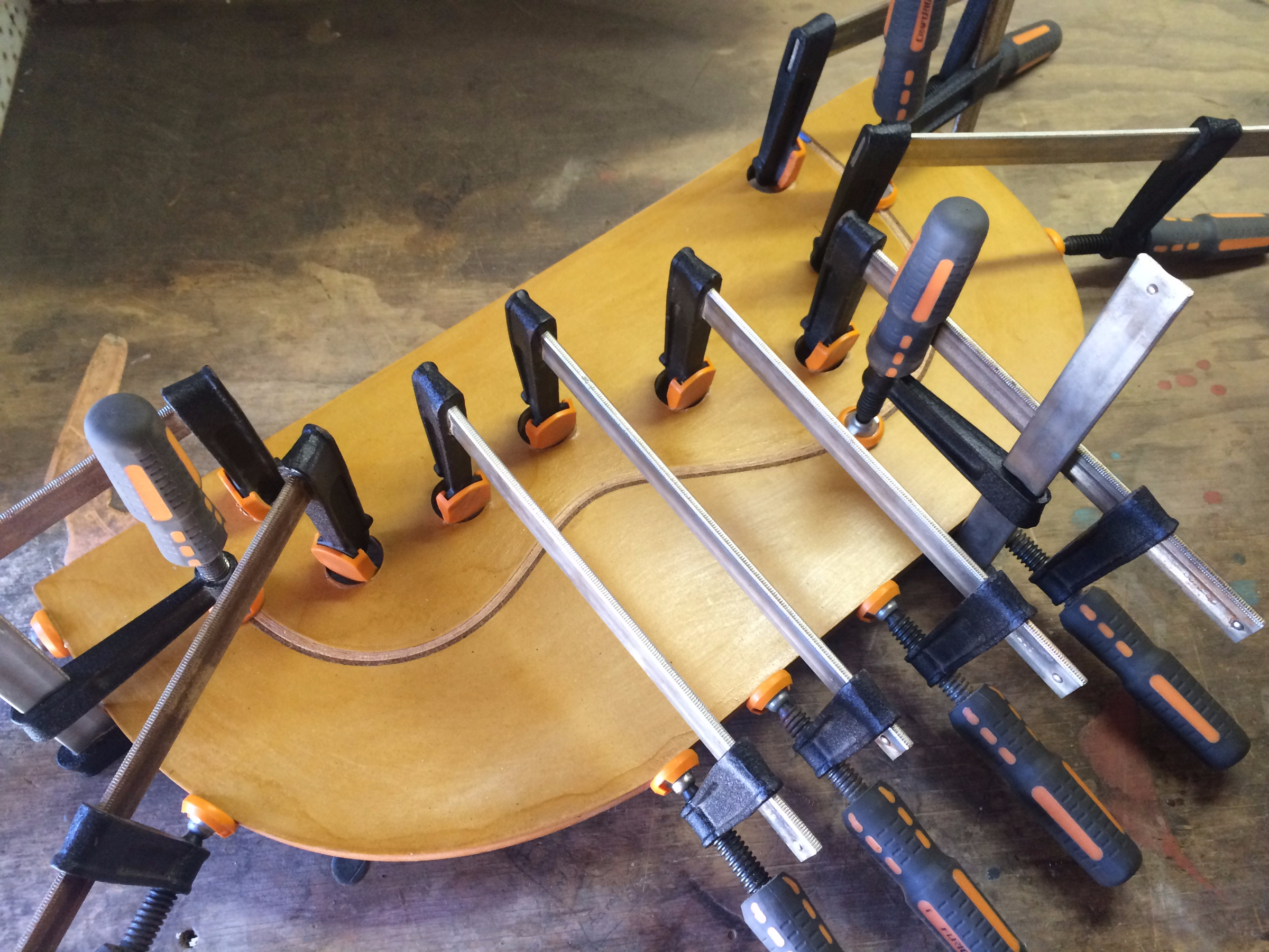

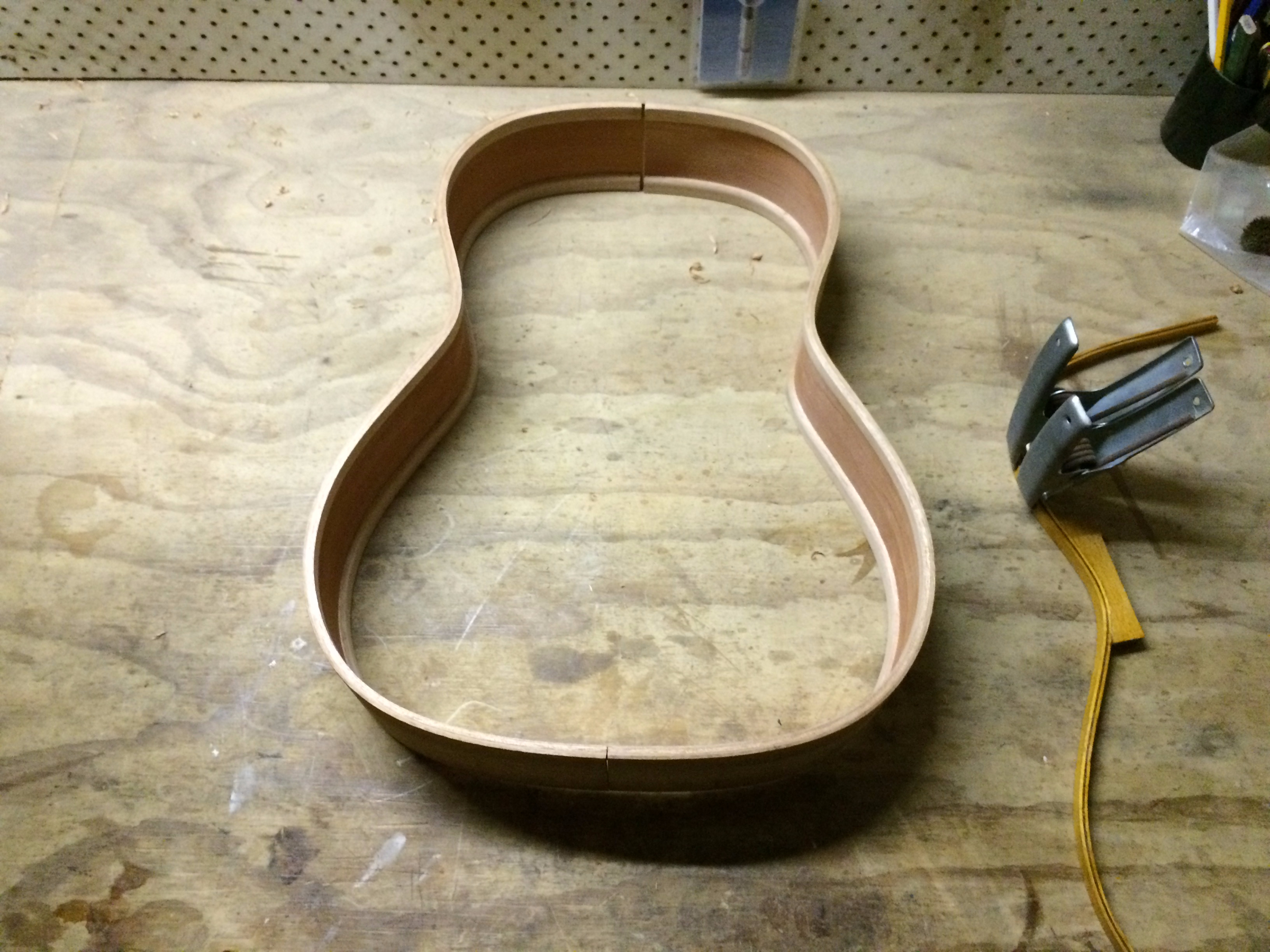

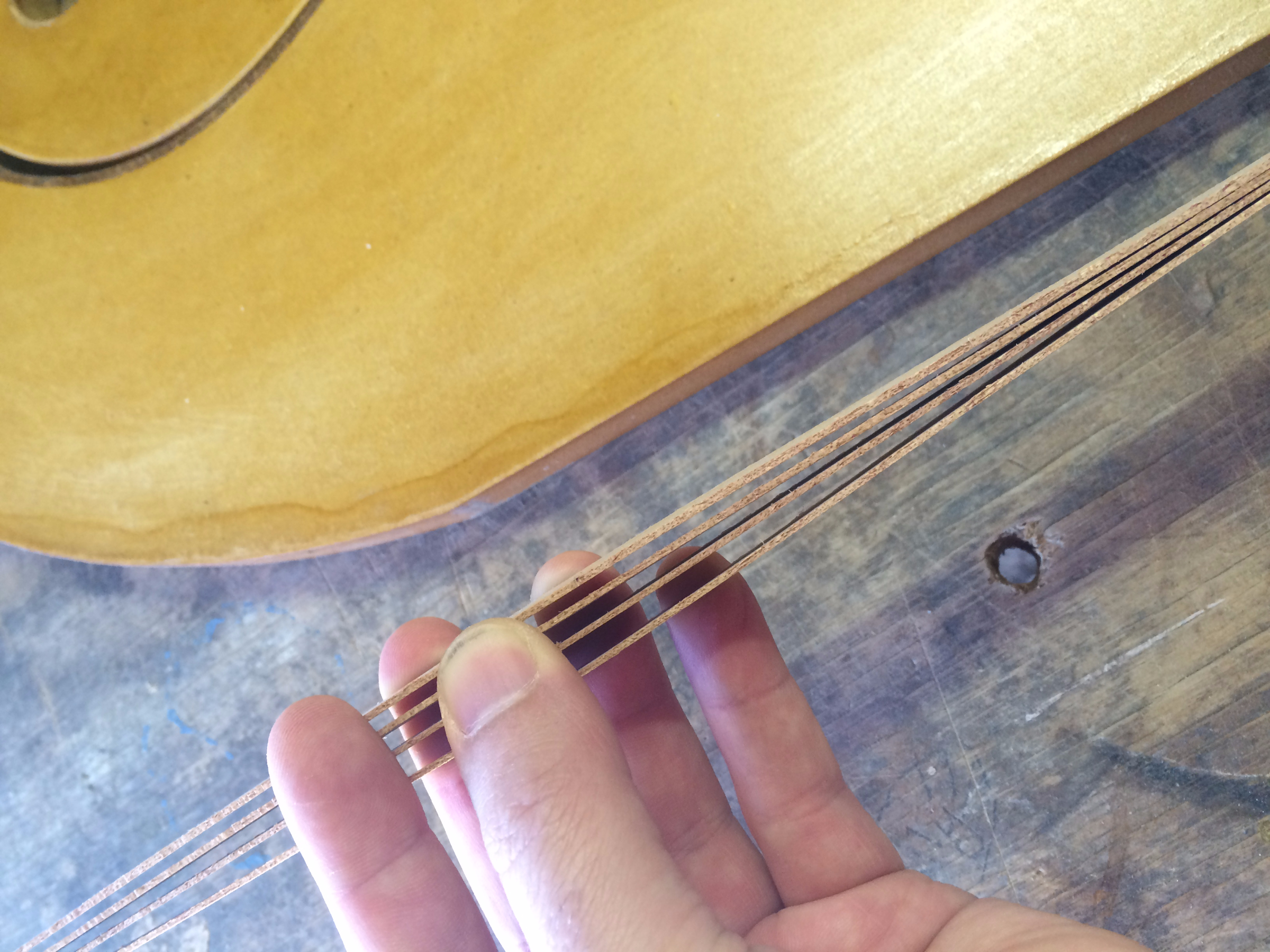

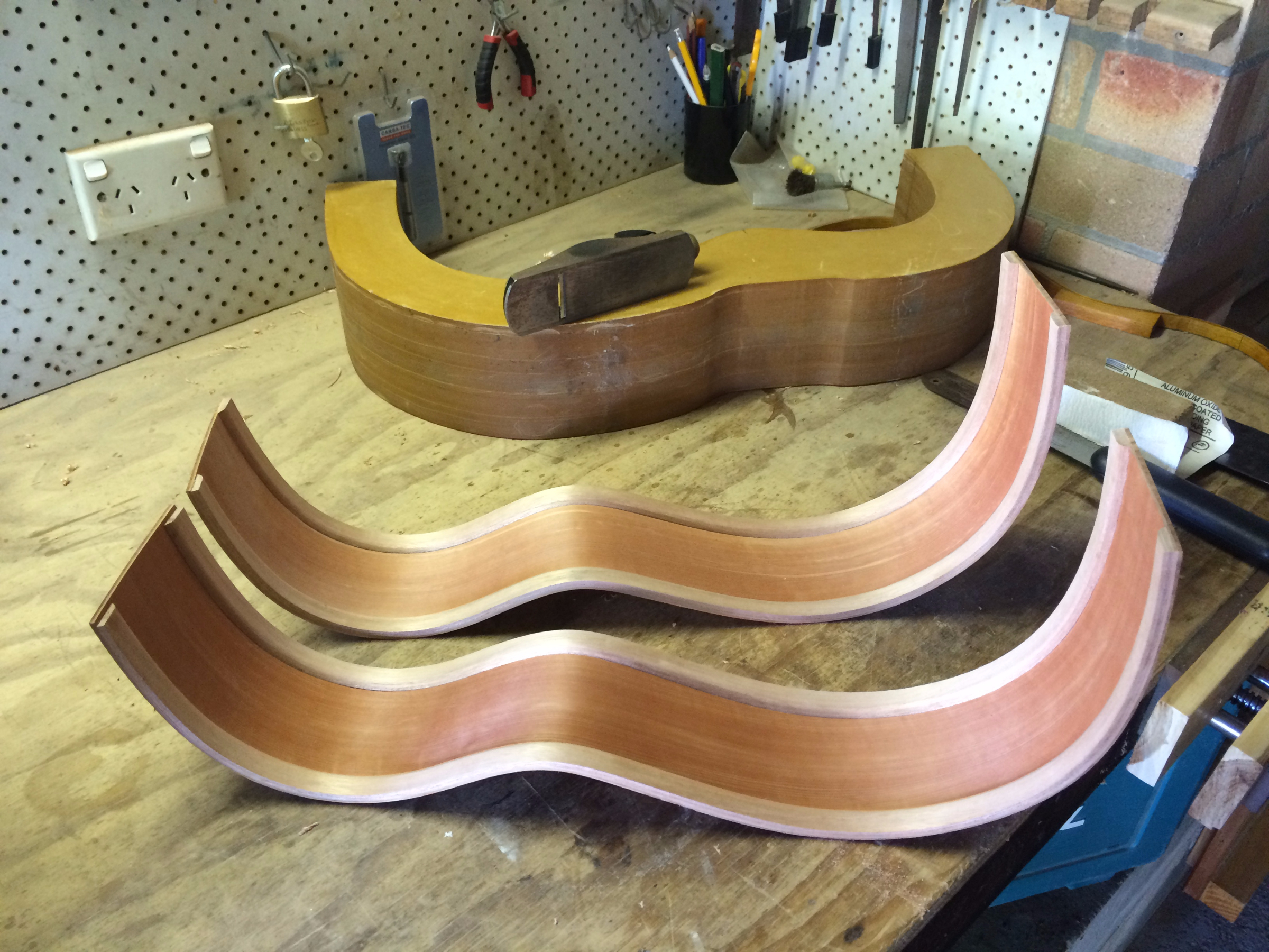

I would think that kerfing would be one of the less exacting timbers in the build . Ideally though it's about bend ability ( obviously ) , which links in to long fibres. But then I'd add the species not being too fissile ( easy split along the grain ) as that would help the timber between the kerf from popping out . I like to bend and laminate mine so that's not so crucial as if it's kerfed .
My favourites are the quandongs , silver quandong ( or blue fig ) which is my favourite bracing also . Hard quandong or black olive plum are good too . Anything eleocarpus has been good . Most of the flindersias would suit ( including the qld maple and silver ash mentioned ) Blackwood or silver wattle are just fine too though a bit more fissile .
