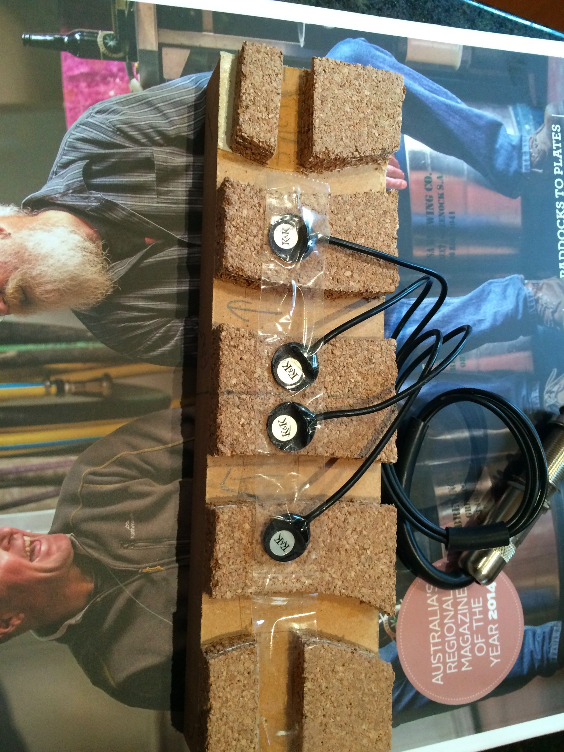

One of my current builds is a falcate braced classical (currently being french polished) without a bridge plate and it'll have a K and K western classical pickup system. There are 4 piezeo pads. Ive test fitted the pads and they just fit.....two between the two primary braces and the remaining two squeeze in between the primary and secondary braces. Ill be making up my own template to use for securing the pads rather than the method in the K and K instructions.
I don't know if anyone has fitted a 3 pad steel string system to a classical but I think the falcate bracing would create issues.....4 pads would be the way to go.
The easiest way to fit the pads is to do it while the box is open but you need to design your bridge gluing caul with recesses that clear the pads so you don't crush them during glue up. Ive opted to fit my pads after the bridge goes on....more of a juggle but shouldn't be too many issues.
Here's a pic of my bridge caul with the K and K classical pads laid out. The important thing is to ensure there's enough space between the two primary braces to fit two of the pads.

1. Hard to tell from the outside but transducers look the same physically for both classical and steel string kits.
2. Diameter of transducers on both kits is around 12.5mm
3. My understanding is there are 4 pads on the classical kit to get sufficient saddle coverage due to central fan brace. ie the extra pad is purely to allow for the central fan brace.
4. You shouldn't need to cut off a pad from the classical kit.....4 pads will fit a falcate braced classical as per my photo above. The pads are wired direct to the output jack on both kits.....parallel wired. I assume there'd be a slight difference in total impedance. Professor Trevor can enlighten us on this one.

Thanks Martin & Bob
I will follow Martin's plan of having 2 transducers in the centre, and will also get the pre-amp.
