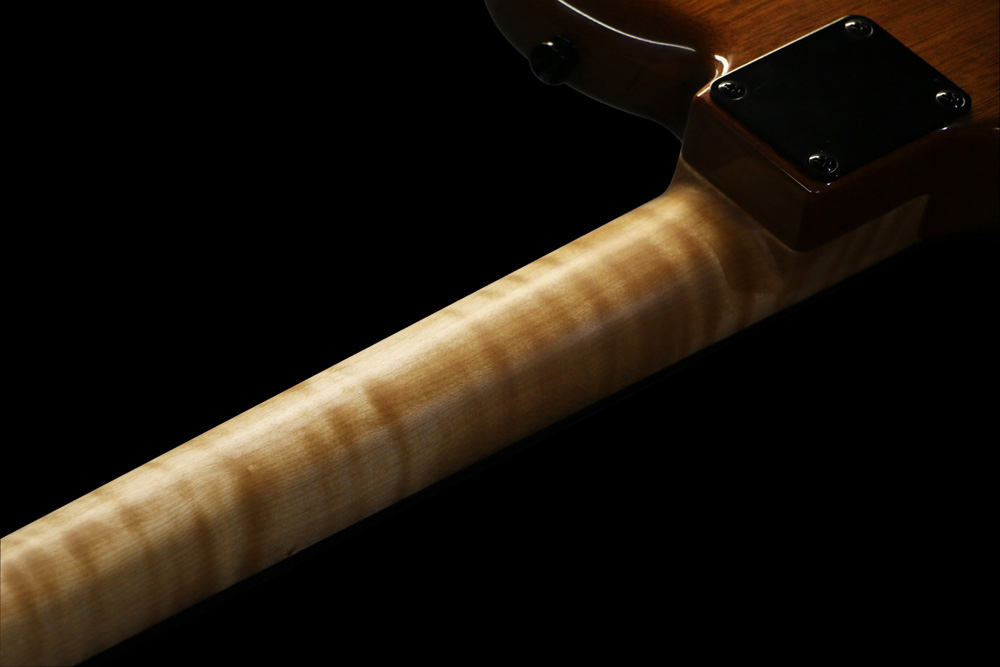

If the neck itself (not the fretboard) needs an oil, the hard burnishing oil mentioned is what I use on oiled necks - it gives good protection, wear and feel. This is it in use actually -

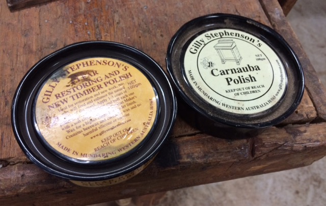

I'll have to check the exact name next time I'm in the workshop as there are a few very similar named & labelled in the range and I've picked up the wrong one by mistake at the store myself and I've been using it for years!mickeyj4j wrote: So what is this wax product you speak of.

The one on the left
The one on the right had no place anywhere near a guitar!
