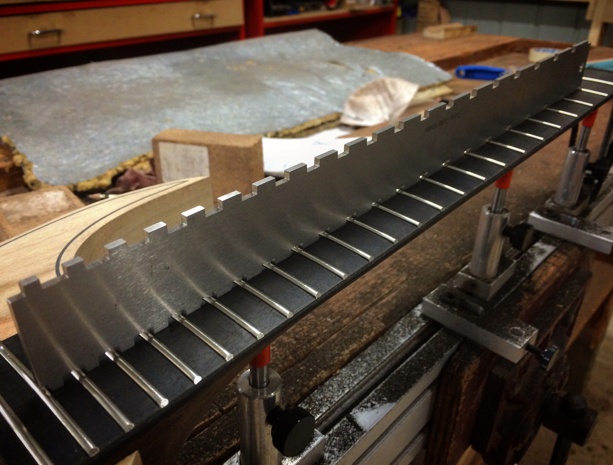

As for straight edges, this is the ONLY straight edge I use these days during fretwork. Apart from levelling tools etc.
Also take note of the jig it is on. Over the years I've macguivered many temp jigs for clamping the neck for fretwork and none of them were as good as this stewmac jig. Sure it's rip off, but my fretwork is better now than before I owned it so I'd say it was worth the purchase.
