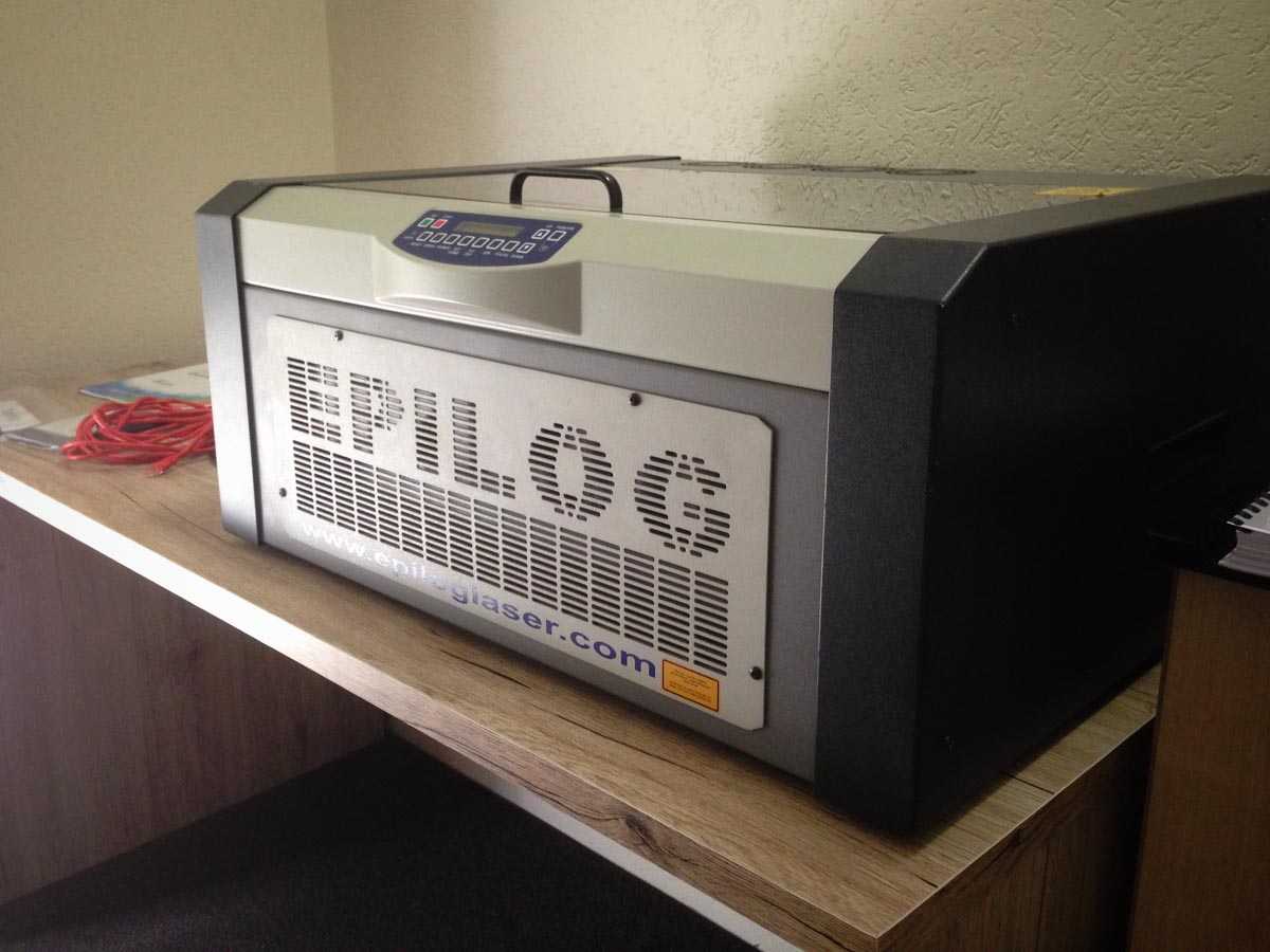

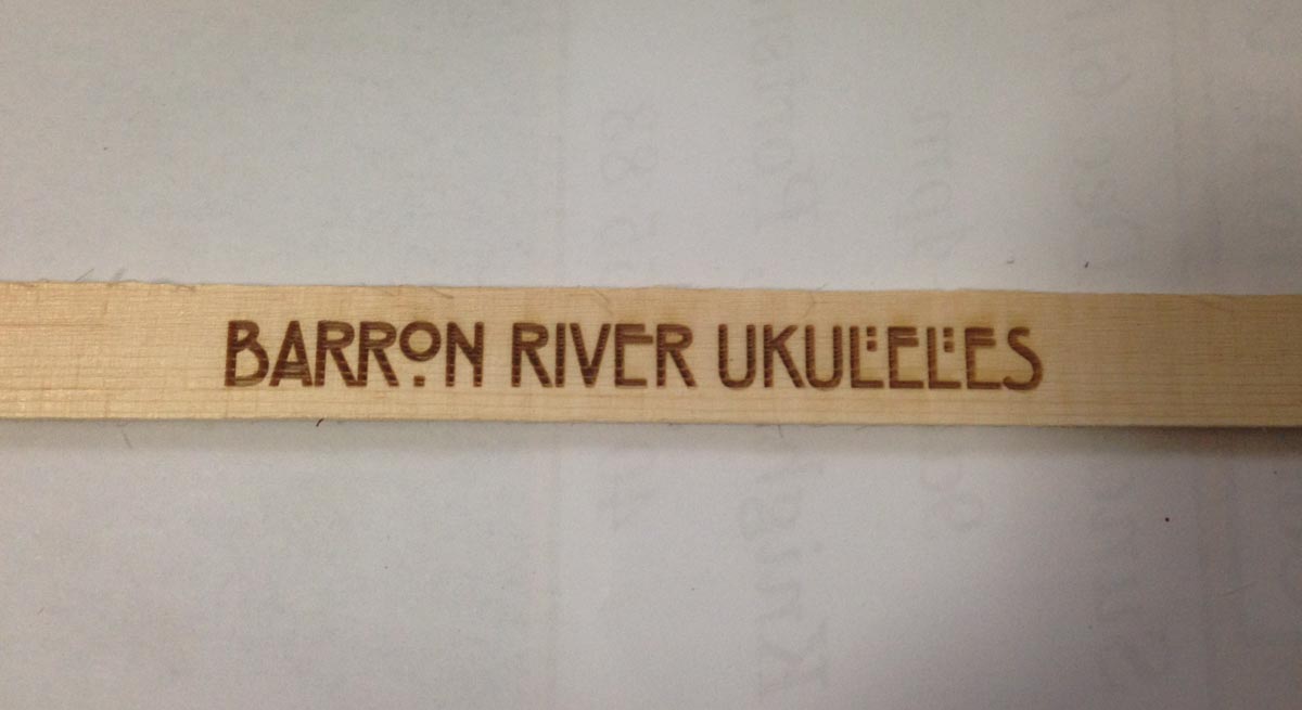

I just got the latest piece of equipment installed into my office over the last couple of days, and have been playing around with it. First up I needed some back reinforcement strips engraved for a couple of commissions I'm starting this week. The engraving on the strip takes 20 seconds.

Allen...I am wondering what is the maximum size piece of material that your machine could accommodate? Also, the ball park figure for the cost of that machine?
Re: Laser Engraver added to the office
Post by Allen » Mon Nov 09, 2015 6:32 am
It's a 18" x 12" cutting area.
Refurbished machine with new 40watt laser tube. North of $10K. If you are looking at new for one made in the USA (Epilog or Universal) then north of $20K gets you a look. My mate that has a larger Universal Laser in his business was just shy of $30K.
