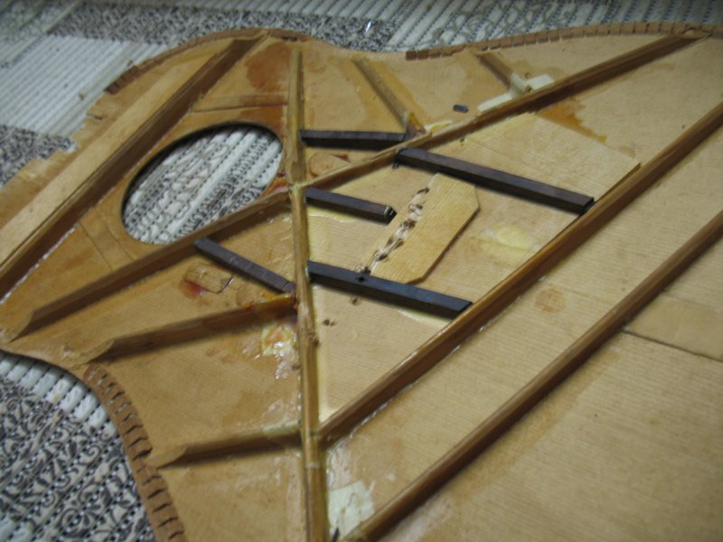

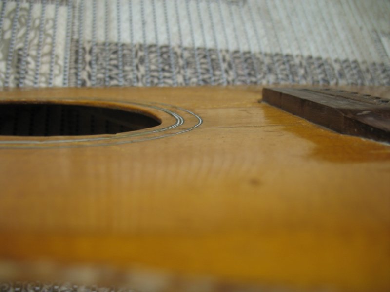

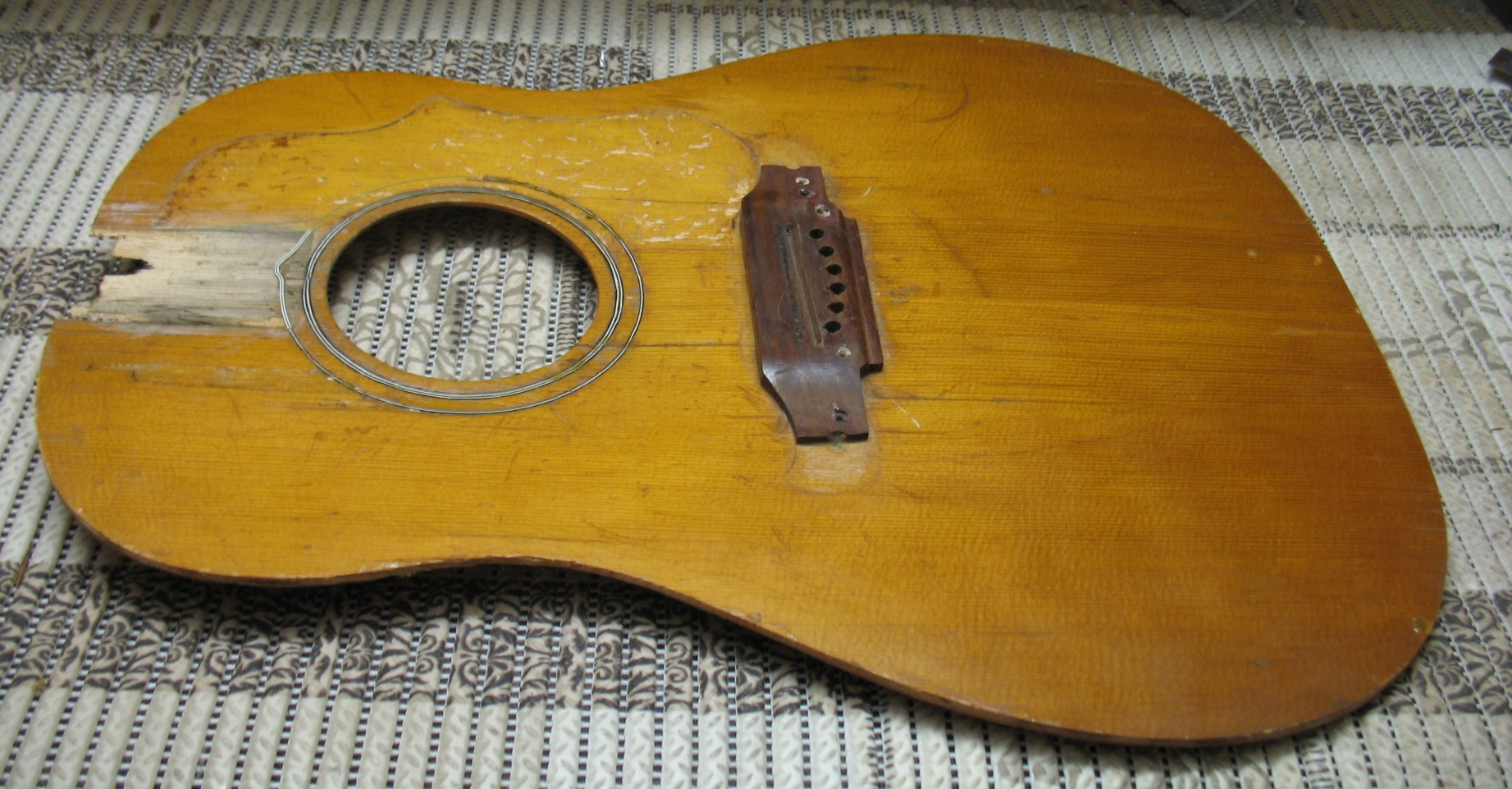

this is what I discovered by removing the top:
- The top is bent toward the soundhole and has several cracks
- The bridge has been replaced several times;
- The original bridge plate was removed and replaced with large pieces of spruce (total plate thickness: 12 mm);
- The X bracings were ruined and broken; They were added over time various pieces of Brazilian rosewood to reinforce the structure.

That guitar has had a hard life......the underside of the top looks like a donkey's breakfast
The bridge plate area is a war zone....12mm thick spruce has been stuck in this area? With that heavy looking bridge that top must be as stiff as a dead dingo's dinger
Im wondering whats going on with all the extra holes in the bridge plate(s)? Looks someone had a spasm while they were drilling the bridge pin holes and ended up drilling a few extra holes.
If it was me I'd probably be making a new top......the rosette doesn't look like it's worth saving.

I wouldn't replace that top. Bit of work to get it functional, but worth it

thanks guys for the advice,
the guitar was in good condition except the top.
the nitrocellulose is cracked but is easily solved by wetting the paint with a bit of nitrocellulose diluted (I tried it on my '62 Gibson ES 125 and returned new).
The neck is ok!
My idea of the flying buttress was only to strengthen the guitar and reduce the stress of the top.
I've already installed on other guitars, and it is not so difficult, and really create a solid structure that does not deform absolutely.
I do not know, however, whether and how to change the original sound of the guitar.
I know that in terms of vintage is not correct ... but ... I'm curious about the result !!
I was also considering to keep the top and remove only bracings but there are many cracks here and there on the top ... and under the bridge are missing pieces of top spuce. So it's worth it to keep it and restore it? I think not ..
