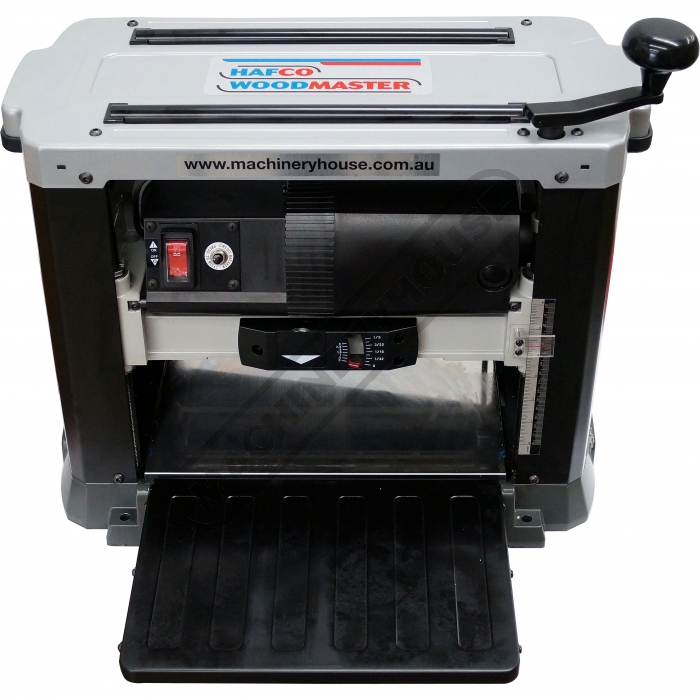

Hare and Forbes have a sale on this weekend so I thought it opportune to throw up some pics of what the T-13S Thicknesser can do. If you sign up for their newsletter you can get $50 off so this ended up costing roughly $630 plus $25 delivery to Geelong.
It's got a helical cutter head that has 26 HSS inserts but can also be fitted with Carbide inserts for around $90 per 10.
I got this earlier in the week. Rod Octigan also bought one so I'd be interested to see how he's faring with it.

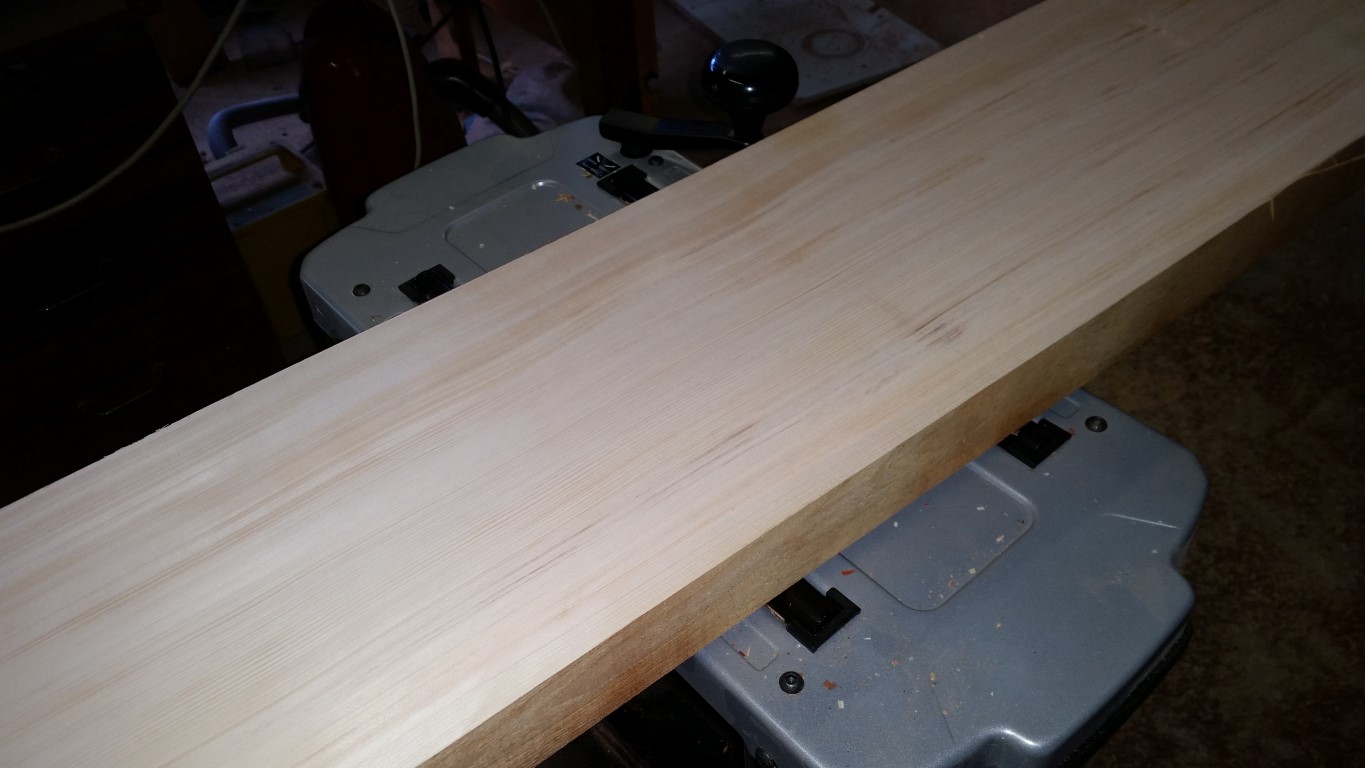

I ran a piece of Celery top through first just to get a feel for the machine. No figure in this so it went through as you'd expect.

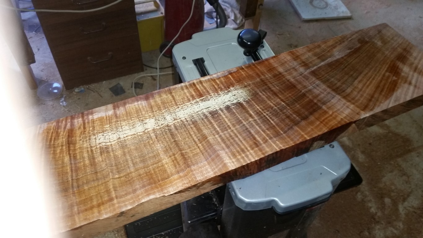

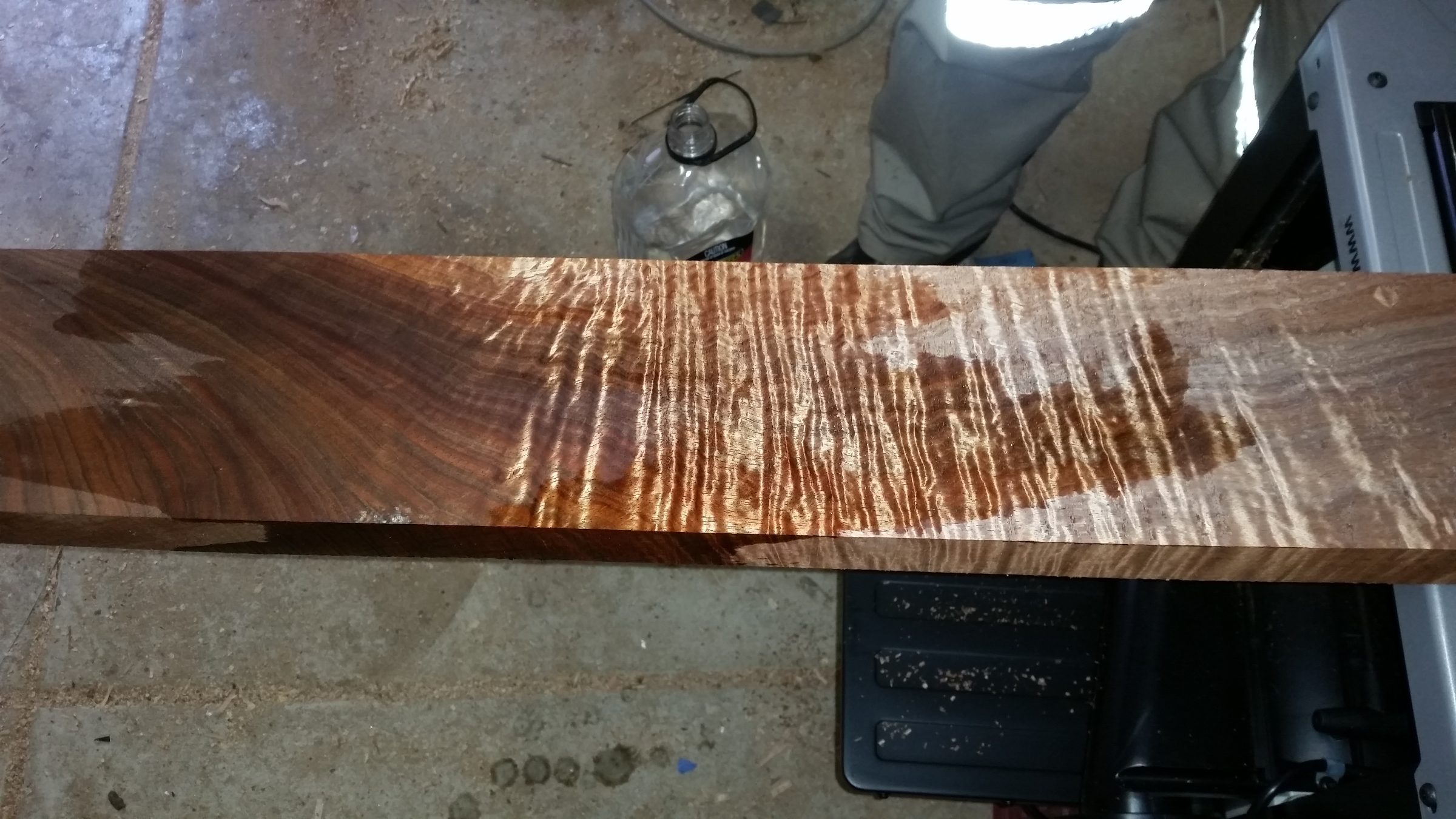

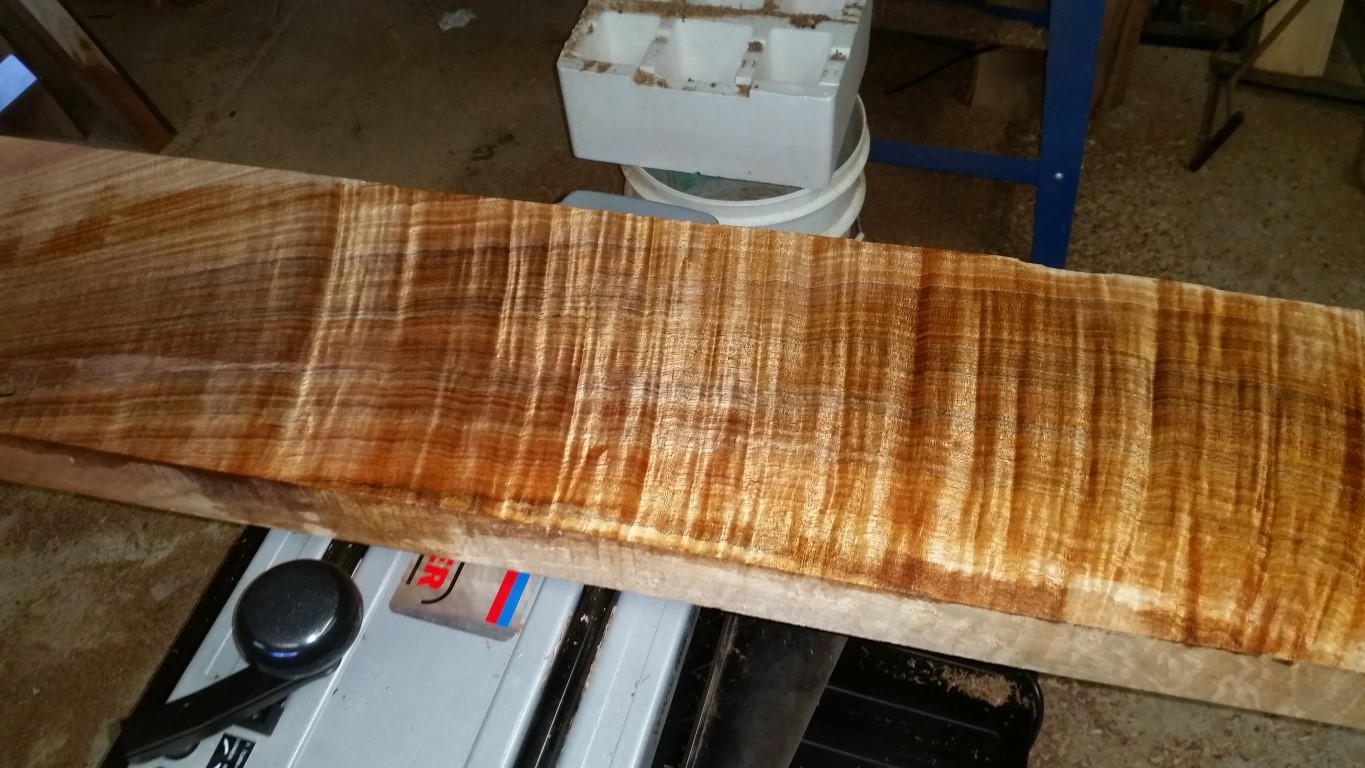

Next I tried some highly figured Blackwood. The first time I ran it through their was some chip out but I found if you run it through taking only a minimum off each time that it doesn't chip out even highly figured stuff like this.
Very impressed with the new piece of kit. :cl

Very good results from a reasonably priced shop machine.

looks like you did well with that purchase.
Spiral cutters really do make a massive difference. Also much, much quieter as well.
Still will get a bit of tear out but not as much. Certainly no replacement for a drum sander, but I am very glad I upgraded my jointer to the spiral heads.
