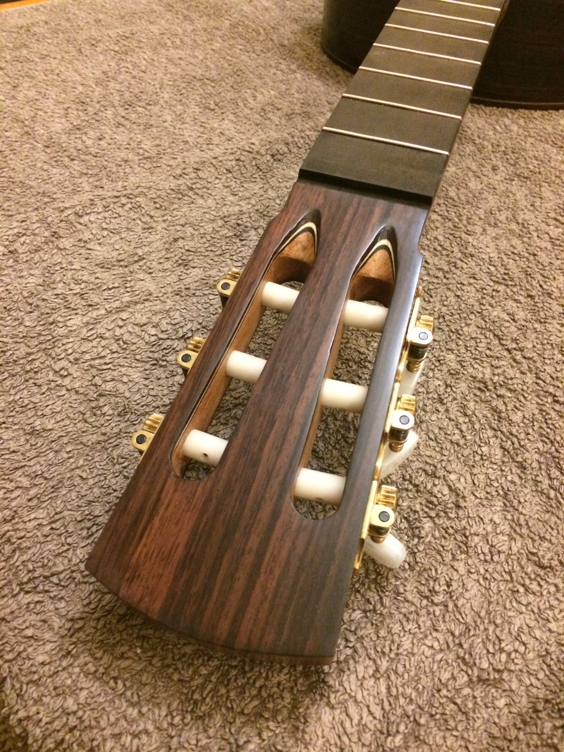

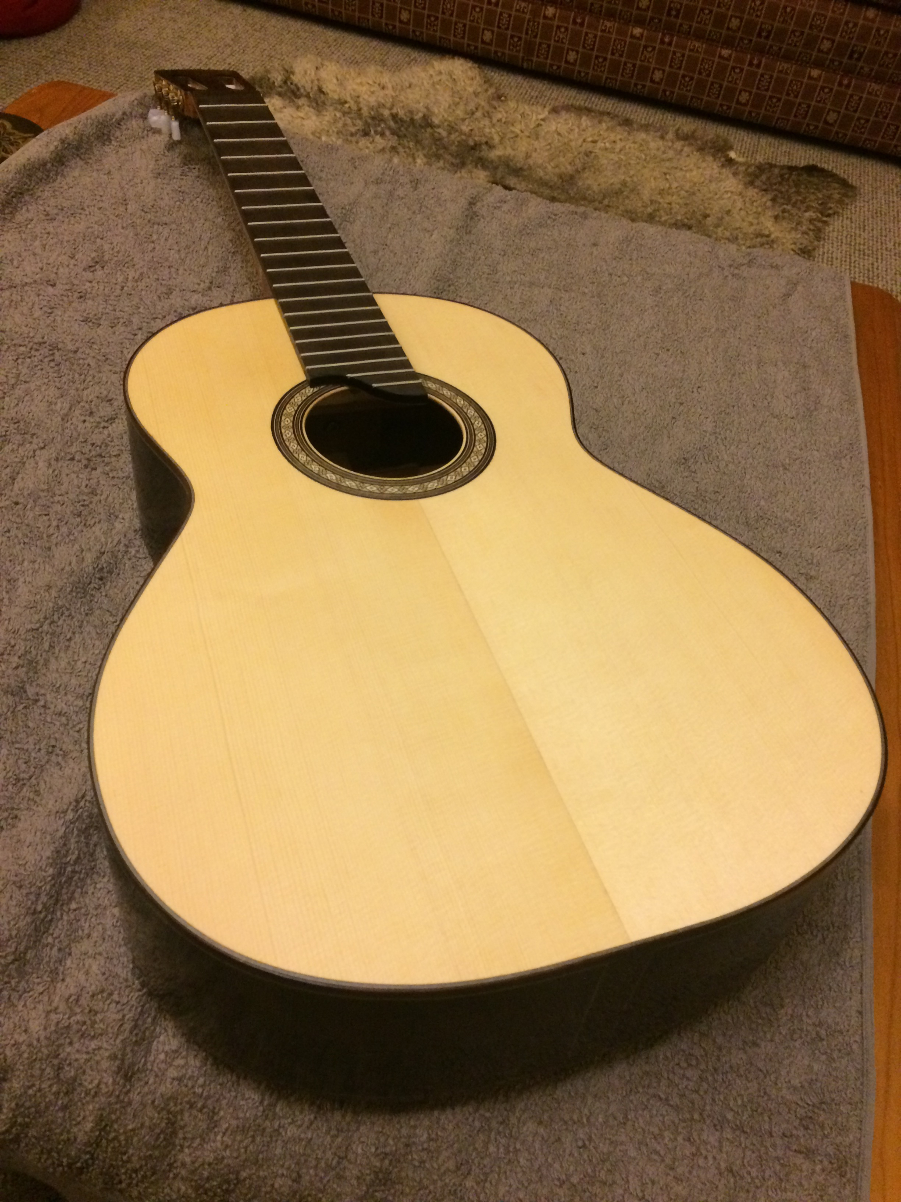

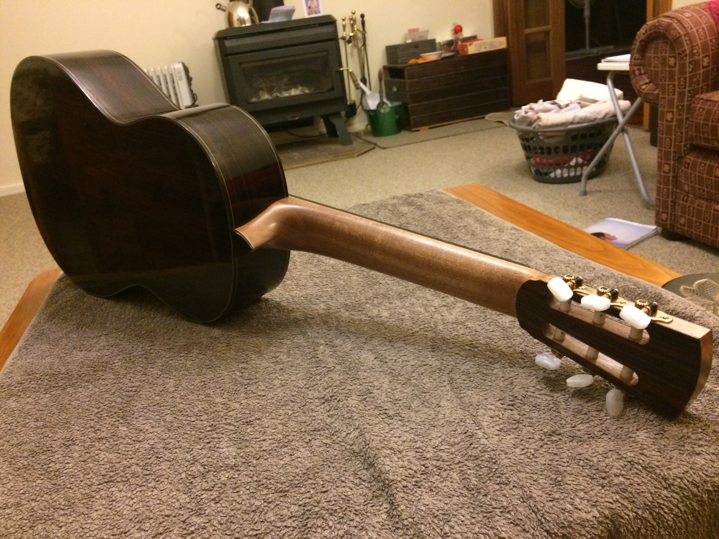

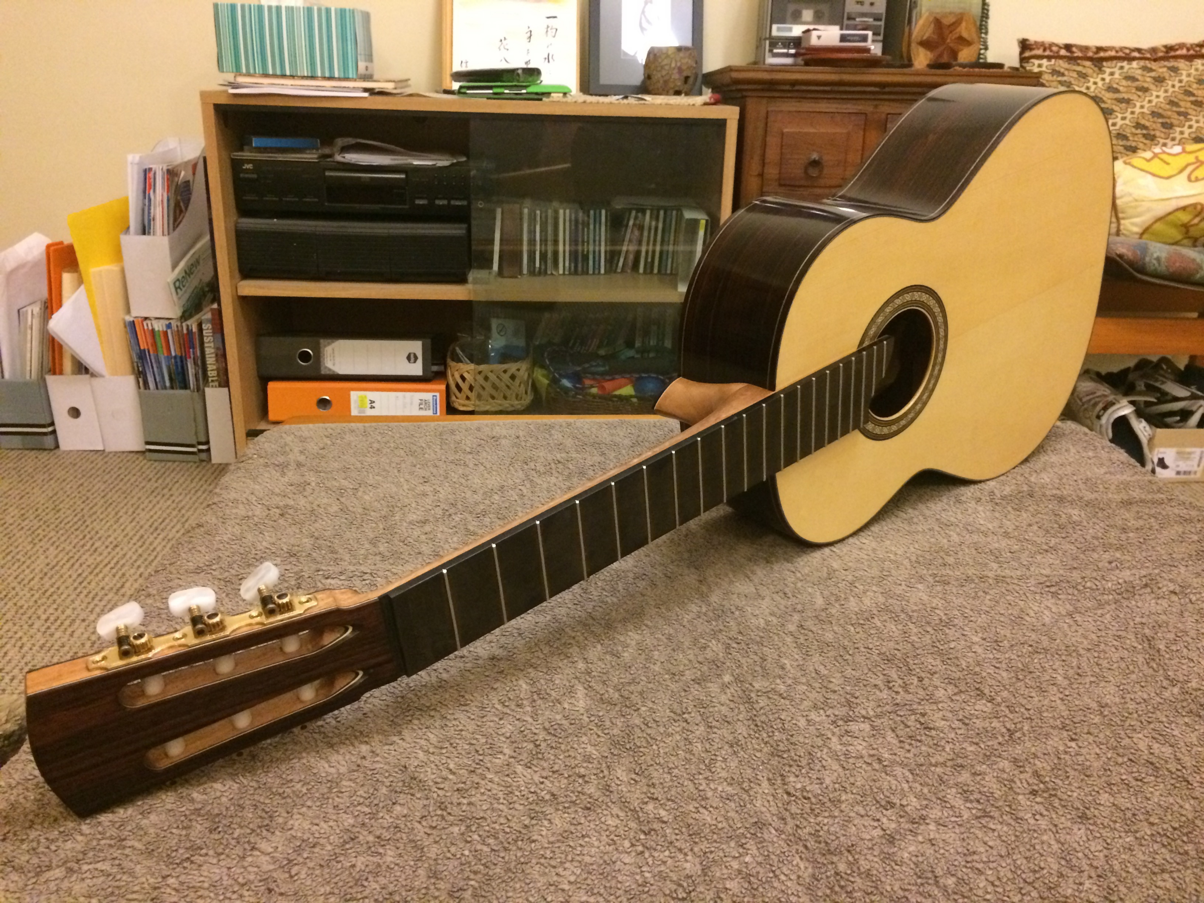

This ones been on the bench for a couple of years now. In between working on the Gore OM Ive been French Polishing the classical and today the final body session got done on the top. The neck is on and the instrument will sit for a few weeks while the top cures. The finish is hard shellac all over. The bridge will then go on and once Ive finished the Godzilla spreadsheet for working out nut/saddle compensation the nut and saddle will get done.
Specs:
Back and sides - EIR
Top: Englemann
Neck: Queensland Maple. Bolt on/Bolt down.
Bracing: falcate (king billy pine)
Will post up VA plots in the near future.

That satin finish on the neck/headstock looks great Martin. Is that shellac straight off the rag, or did you do something more?
Re: Falcate Braced Classical (No 13)
It's hard shellac from Robert....it's pretty much straight from the bottle as used on the rest of the instrument.Trevor Gore wrote:That satin finish on the neck/headstock looks great Martin. Is that shellac straight off the rag, or did you do something more?
- Posts: 1641
Thanks, Martin. Did you do a separate grain fill or just go with the shellac?
No grain fill Trevor.....the Queensland Maple wasn't that "porey". The grain fill on the back and sides is west systems epoxy applied with a squeegee. It took four sessions to get all the pores filled.Trevor Gore wrote:Thanks, Martin. Did you do a separate grain fill or just go with the shellac?
The hard shellac is 2lb cut straight from the bottle. Robert made up a standard mix rather than the one that you normally use.
