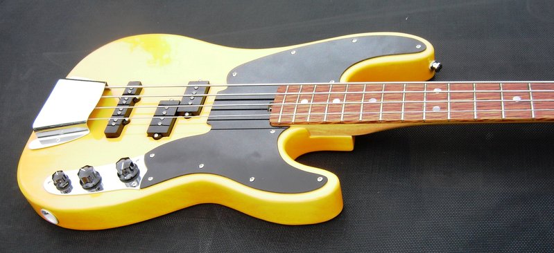

I've only built one bass, the "Telecision Bass", my take on Fender's slab body '51 Precision/Telecaster reissue but with PJ pickups & electrics.
The body is Cape Lilac with a Fiddlewood neck and Sheoak fretboard, all grown locally to Perth.
I love the sound of this bass. It's exactly what I wanted but I find the Cape Lilac to be a bit on the heavy side, more like my old late '70s ash Strat.
I also believe the sound is from my choice of electrics, not so much from the woods.

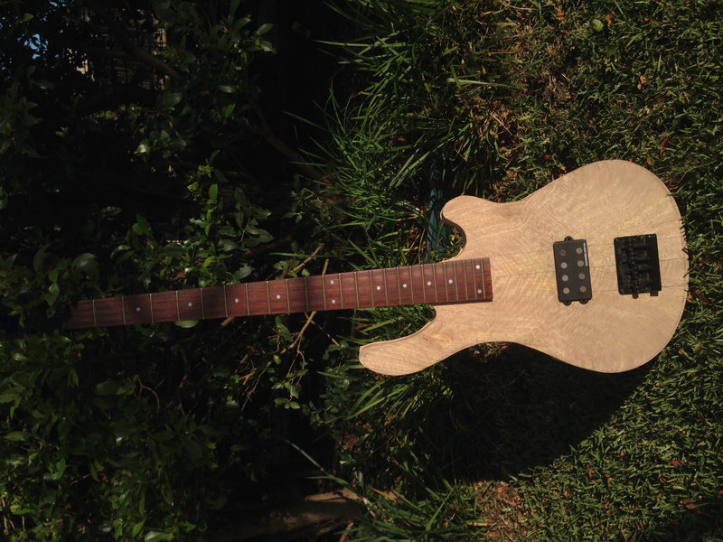

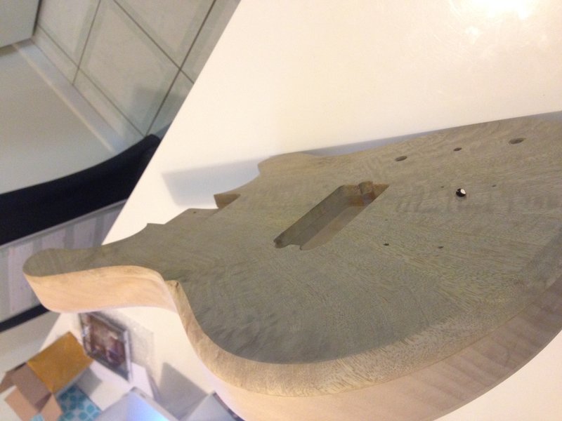

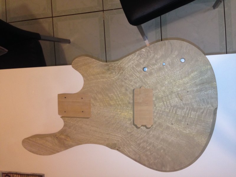

Here is the first bass. It's a figured mango top on a bunya back. I've rough shaped it and have done the neck pocket, pickup hole and added the bridge. After taking the last photo I drilled the holes for the pots.

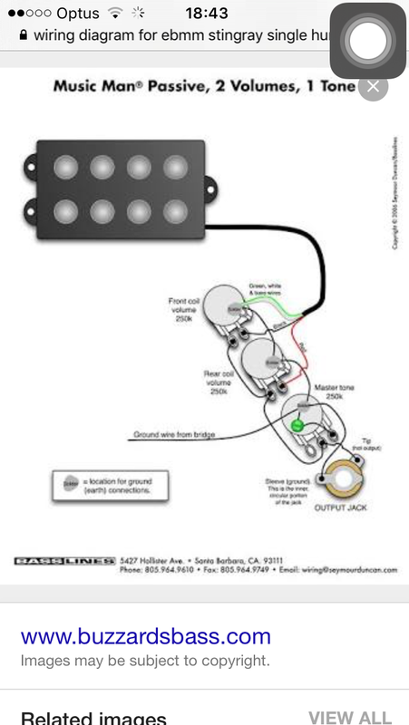

Speaking of pots does anyone have any tips for 250k vs 500k? I'll be doing a setup like below

Looking good! Have used the 5 string version of that pickup both alnico and ceramic a number of times and always been happy. In theory a 500k pot will retain more of the high frequencies and are commonly used with humbuckers. In the configuration you have shown the pots are wired to each single coils then blended. Blending passive pickups through pots doesn't work all that well, the pickup seems to be either in or out as you roll the knob. I'm sure someone else can explain the reason, impedances etc. Perhaps a series / parallel or series / split / parallel switch with master volume and tone will be more user friendly and give a good range of sounds.

Thanks for the heads up about the pots on a passive pickup, I understand what you're saying. I'll be back in the shed tomorrow so hopefully will have everything finished and ready for the paint shop (A.K.A. dad with 40 years of polishing experience!)

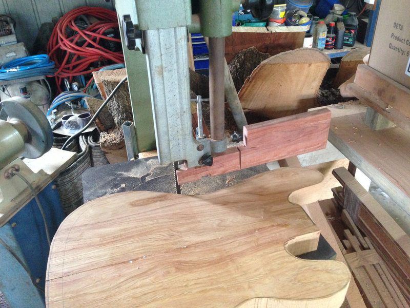

My bandsaw, which is maybe from the 80's, decided to not need its guides anymore so I made this sweet as timber one and clamped it on!

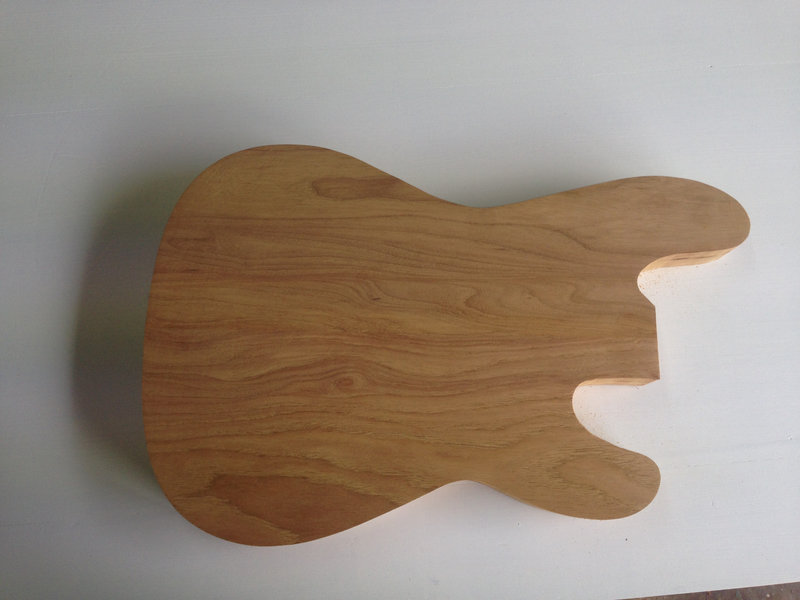

However, I still managed to cut out this P bass body today. Made from two pieces of New Guinea Rosewood I picked up a few years back. I love NGR when it's sanded to over 1600g then polished. Something about it just appeals to me. But like everything it's all subjective.

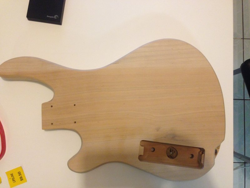

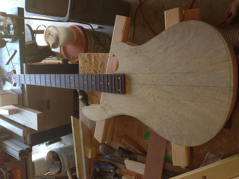

More sanding and more routing, starting to shape up. I noticed that I have a glue line between the top timber and the back. Any advice out there to ensure this doesn't happen again? More clamping, better thicknessing? Happy to hear any advice.
