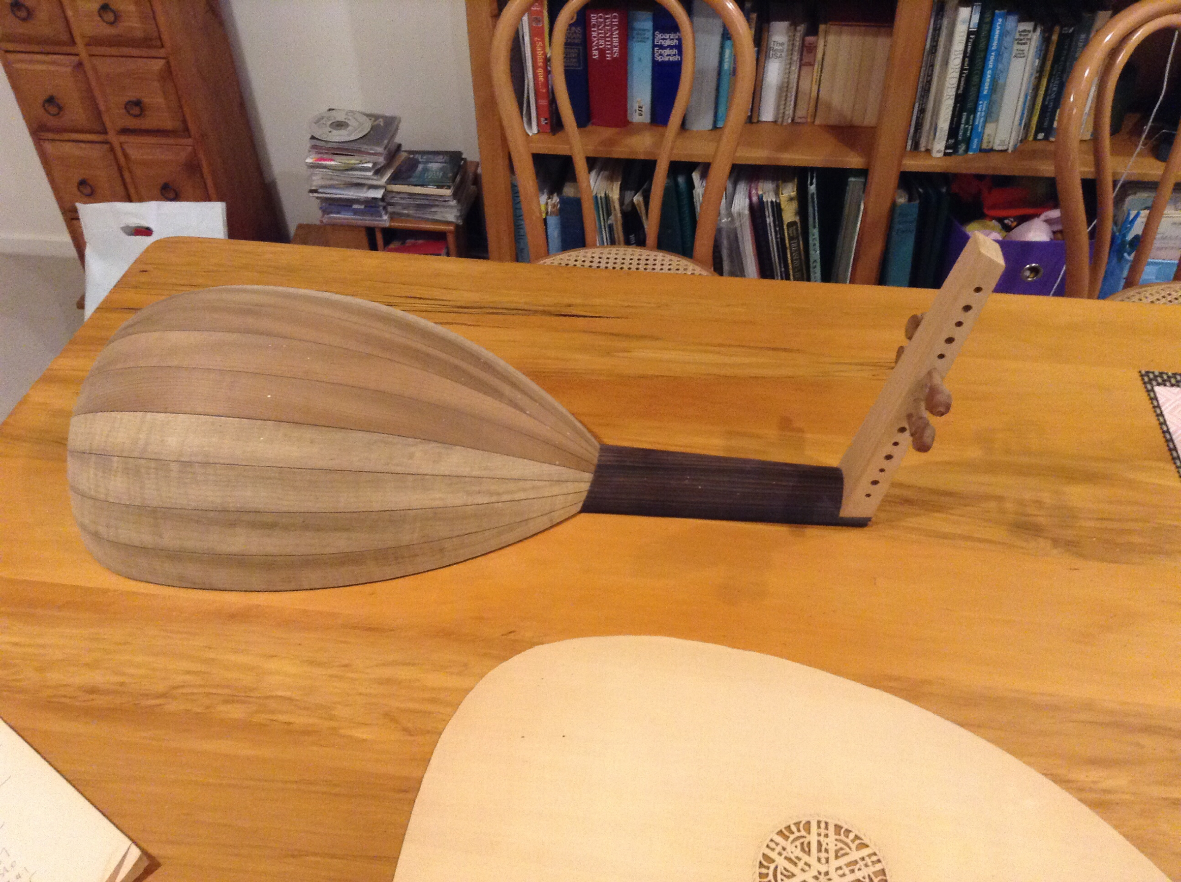

So my mate who passed away last Christmas, like most of us had more than one unfinished project. He also had this
On the basis that I can't do a worse job than something that isn't finished I said I would have a go at finishing it. To my untrained eye it seems most of the hard work is done. Back is built, rosette is cut, neck is on.

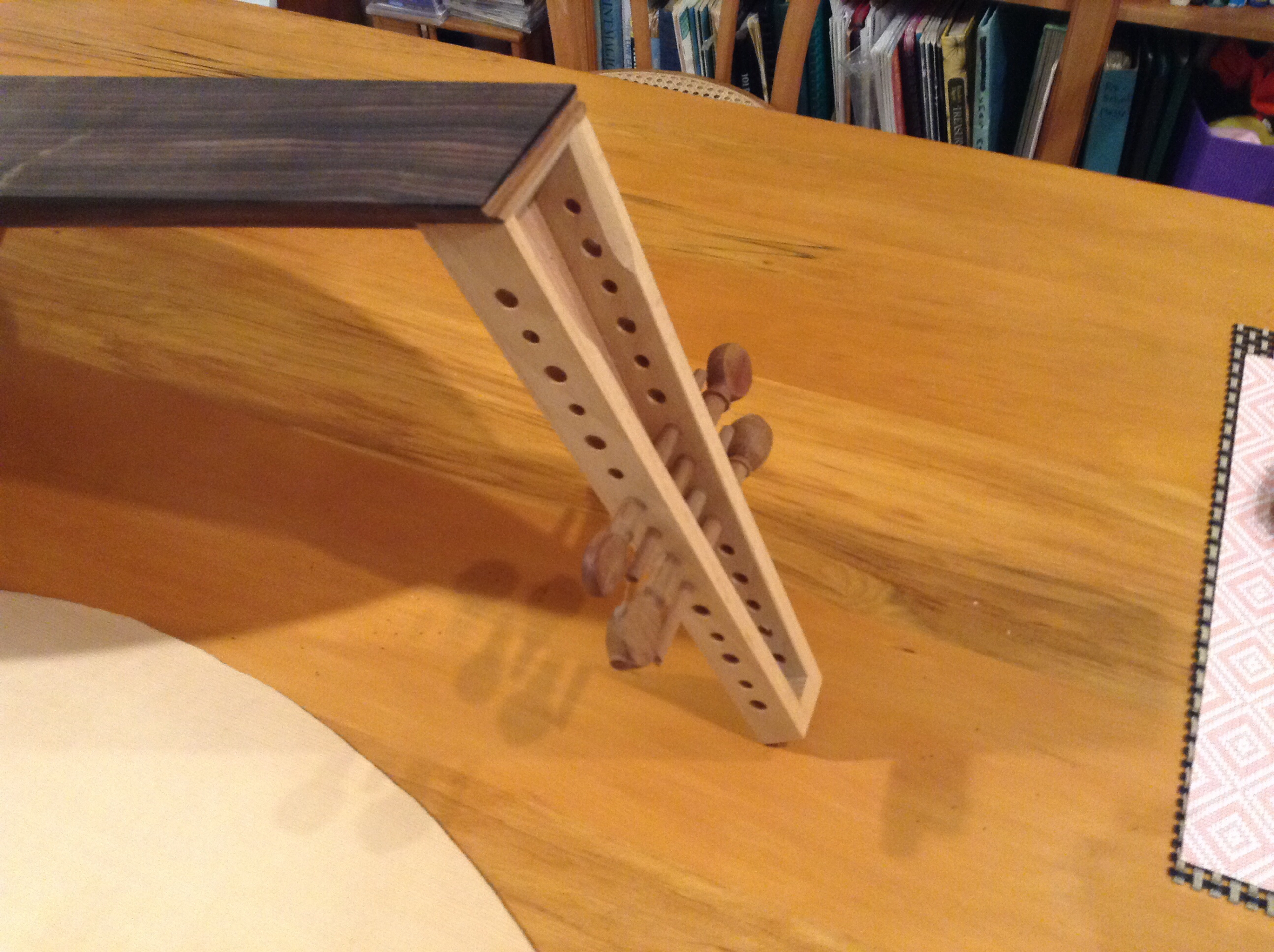

A few challenges remain but... Such as the tuning pegs. Rob apparently turned these by hand on his lathe :?: ...and there are no plans. :shock:
There are 15 holes for pegs... How many sets of strings would that be?
I picked this up tonight so yet to do any research but if anyone wants to chime in with suggestions please fire away! :D :D

15 pegs...15 strings. 7 double strings (courses) and a single chanterelle (top) string.

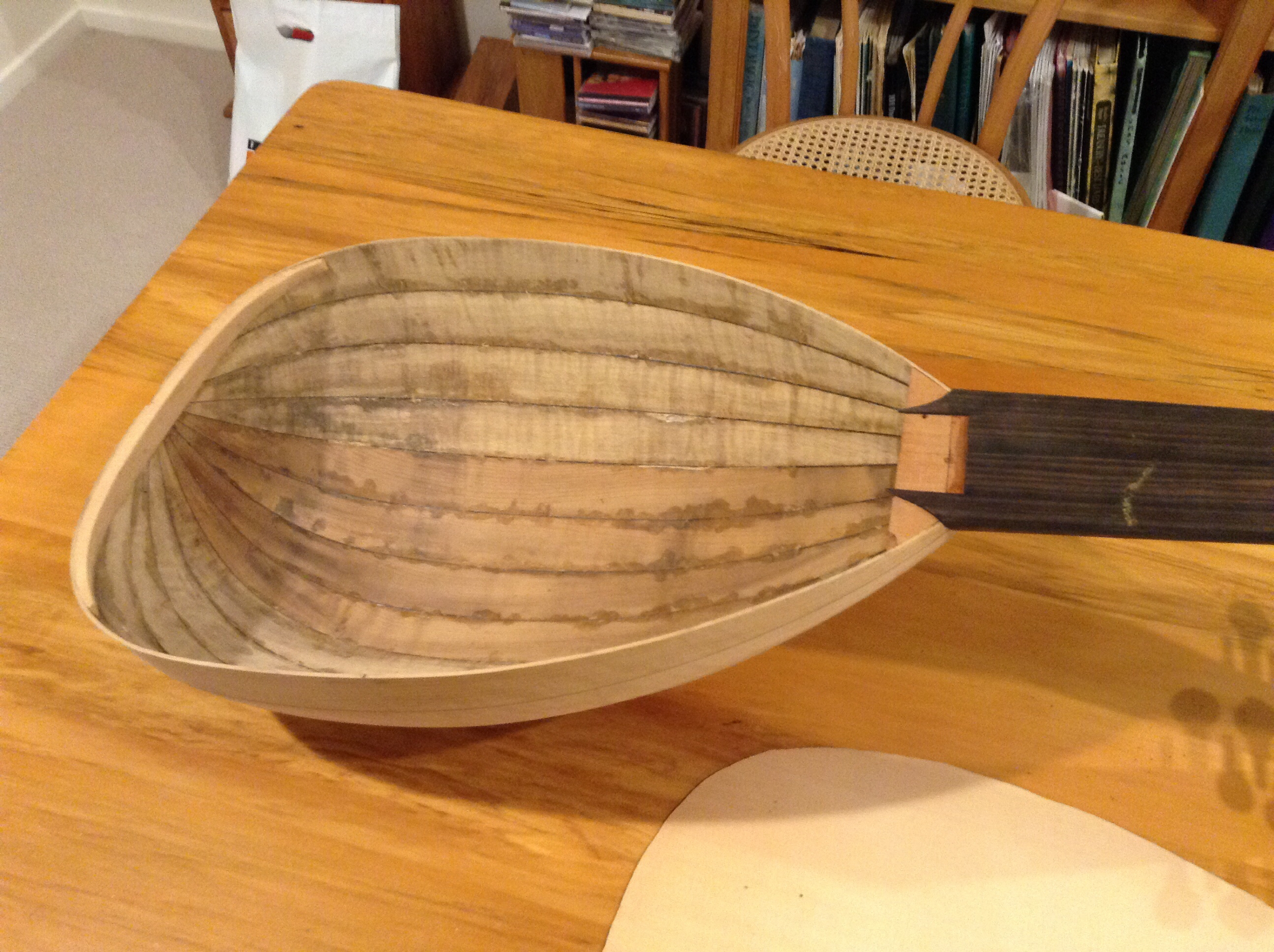

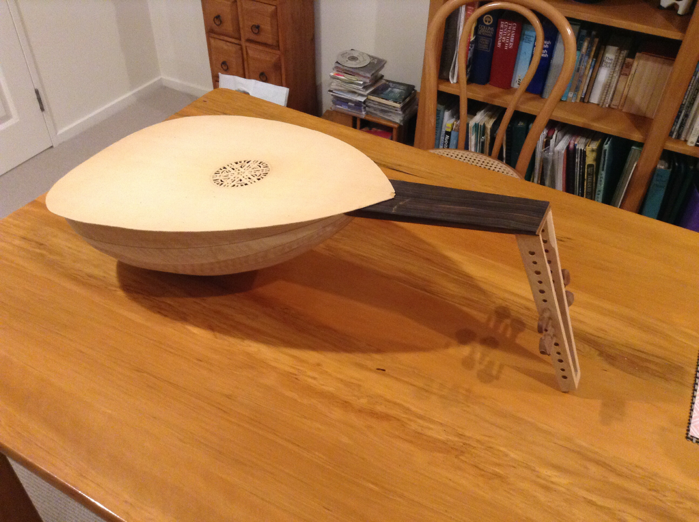

Now that Ive had a closer look at the photos...there's actually quite alot left to do. So far I can see the following jobs that need doing:
1. parchment paper reinforcing strips on inside of rib joints.
2. Is the top bracing in place? Judging by the way the top is laying flat on the table it looks like bracing hasn't been done yet. You definitely need the plans for this...especially important for placement of the "J brace" near the bridge.
3. top needs to by shaped to fit fretboard "tips".
4. bridge to be made up and fitted. I used pear wood for mine. Scale length on my lute was around 606mm from memory.
5. Top to be glued on.
6. Optional ebony half binding to go in.
7. Nut to be made up.
8 Finishing. On my lute French Polish for the body and burnished coats of Restorer's wax on the top.

You need to also check if the sides of the belly have been "scooped" to provide the relief in the top when it's fitted. because the neck is soi short on a lute the relief is attained by varying fret height and also scooping the top. Important if you dont want 15 strings buzzing and driving you nuts :D
