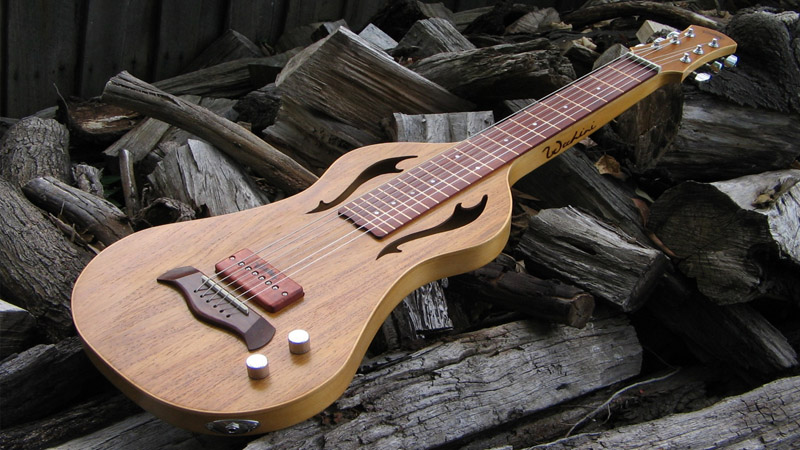

Made a look and see lap steel carved the guts out then popped a top on she went well soft though. :)
cheers John.
