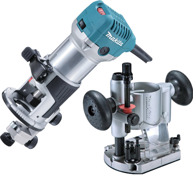

Pete I recommend this trimmer, I have one and also the plunge base. Solid as, variable speed, soft start metal body and even the height adjustment pinion is metal. RTO700C $179AU and with the plunge base $269AU
I use it for just about everything, neck pockets, truss rods, soundholes, cf neck reo, saddles and bridges, templates, edge trimming, brace jigs, bindings. Hope you have been a good boy and Santa hears your prayers!

Thanks for the recommendation - sounds like a pretty versatile tool.
The wife did say one tool for Christmas, but if one fits into the other and it really is a package set ...

Seriously though, the set comes as a set from Sydney Tools, online store also. If you are in Australia. The one I got I bought when they were first available here and the accessories were only available overseas so I had to get the router base from UK. The plunge base is really well made. It came in a nice aluminium case without the bearing guide. but with the dust extractor fitting and the straight edge guide. Plenty of fancy attachments available now if you do other things than luthiery. http://justtools.com.au/makita-635mm1a4 ... 0-rt0700cx

The soft start on that Makita trimmer is a definite plus...nothing worse than reactive start up torque from a trimmer flexing the whole jig and ending up chopping a big gouge in your top.
