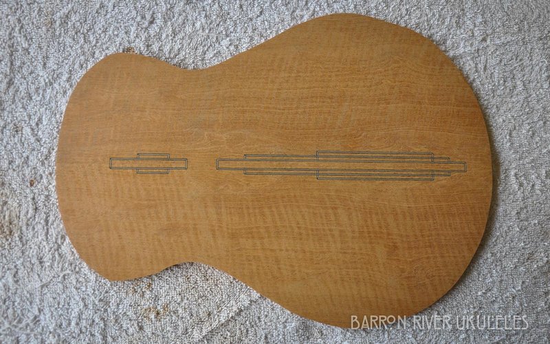

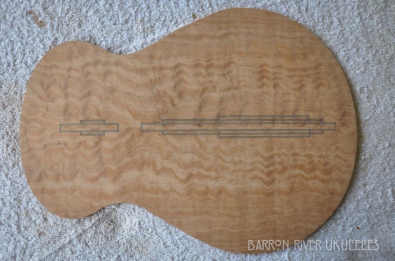

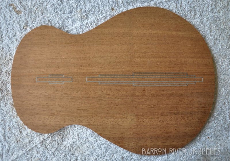

I made a concert with a similar design to this a couple of years ago, and really wanted to do another. But it will be 3 this time around in the next batch of instruments. One in Curly Honduran is a commission, the others two are Brazilian Mahogany and Quilted Maple and are spec instruments.
I'm calling it my Empire Design.

Lovely style and detail Allen. Two questions if I may, is the black white black inlay
a stock product or do you make it yourself and are the channels cut by CNC?
Bruce Mc.
Re: Something I've been working on.
Post by Allen » Sun Dec 20, 2015 3:31 pm
I'ts black/maple/black purfling that I buy in bulk from Gurian Instruments out of Seattle.
The first one I did a couple of years ago was on my milling machine. These ones were cut on my CNC. Actually more or less the first thing I did other than machine up some locating holes for a spoil board and making some jigs.
You could do the same thing with fences, lot's of pencil layout lines, and a laminate trimmer or Dremel, but I don't like Dremel's for precise work.
To get the pattern to work out, you need to plan what's going to get inlaid first. Get it glued and dry before moving onto the next part. It's also one of the very few details that I use CA glue on. The first instrument I did I used HHG and the board swelled up so much with the extra moisture in so many lines made the entire ordeal a complete pain in the arse.
