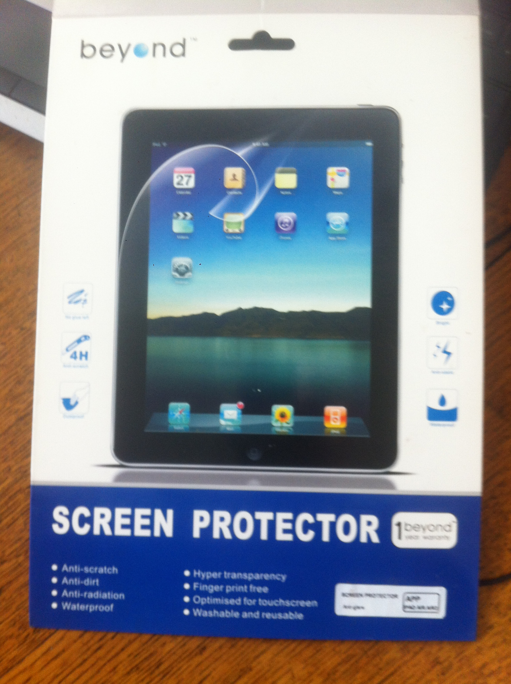

A friend visited me overnight and had an interesting pickguard. LMI among others sell these, but by the time one gets one from the US here to Aus, the cost is high. These style pick guards are removable, and it is not recommended that they be left on Nitrocellulose finishes, but rather be removed and replaced each time the instrument is played. Ok to leave on a polyeurethane two pak and others. Will even stick to French Polish and semi gloss finishes, but any finish that breathes or off gasses it is recommended to remove/replace each use.They can be washed, and cling on to the guitar electrostatically. It occured to me that the same or similar material is used on iPad, tablet and phone screens, so today I bought an iPad screen protector, which was big enough to make three pickguards, around $19 from a Telstra shop. Works a treat, the thickness of the film is 0.11mm on my thickness guage.

The only problem with them are the bubbles that are hard to smooth out, but from a distance you don't notice them.The advantage is you can cut custom shapes from the iPad ones. If you have ever removed a stuck pick guard from a guitar there is always discoloration, or the wood/finish underneath is lighter...probably due to two things, a reaction of some sort, and the fact that uv isn't getting through, so the finish would tend to darken slower with age, I suspect.. Also many finishes breathe, nitro off gasses for years as well. I have noticed two things re the iPad plastic-incredibly thin but still quite good scratch protection. I put the whole uncut iPad screen protector on the lower bout of my soundboard, and didn't notice a radical change in the tone. So a small pickguard made of the same material has a negligible acoustic effect in my opinion. I also feel that with a lot of modern creative rosette designs, a traditional tortoise, black, wood veneer or coloured pickguard detracts from the aesthetic of the rosette design. Clear and simple looks good in many cases. I have used the clear stick on permanent guards that are available, but it isn't easy to get a good clean edge on the guard for some reason due to the glue used. I have heard of people using thinners to glue clear pickguards on but have never done it.
Unfortunately, I didn't measure the thickness of the commercial electrostatic guard when my friend had it here...we were too busy playing our guitars!
The one he had can be purchased from LMI and was called a "Klingon"...there are other brands available as well. Good on a classical when using a pick..eg for some jazz styles. They also make one for flamenco players with two guards either side of the strings. The iPad material I bought is a matt finish, which I also like.

I have found out that the Klingon guards are a product called PEK (Polyetherketone) with a silicone coating on the adhesive side-so they should be inert. I suspect that the iPad ones are the same technology, but haven't been able to research yet.Off gassing and any moisture breathing out through a thin shellac finish would probably be the issue with finish damage if the guards were left in place. That could possibly happen with glued on guards as well.

Well this is great I was needing something I could make a custom pick guard from. Was thinking of using an old thin ohp (overhead projector) sheet. The tablet protector will work a treat for my purpose see my post pick guard glue. Thanks for sharing the idea.
Note: With the tablet protectors (ipad,android etc) you can get thicker glass like ones that I use on my tablet they apply the same as the thinner ones. They tend to crack when removed (may crack when cutting these). I assume you used the thinner regular type. I have seen people at the mobile shop apply screen protectors without air bubbles in them. It's all in the way you apply them and using the right tools. There are videos showing how to do this. May apply to using them on a guitar surface too.

blackalex1952 wrote:It occured to me that the same or similar material is used on iPad, tablet and phone screens, so today I bought an iPad screen protector, which was big enough to make three pickguards, around $19 from a Telstra shop. Works a treat, the thickness of the film is 0.11mm on my thickness guage.
I brought a phone screen the back was not sticky so did not work. Asked at local mobile shop for sticky backed screen protector said they don't sell them. Maybe she did not understand what I meant?
Where did you get your stuff and what brand would help thanks.

I think I bought mine at Harvey Norman or Officeworks. For a more permanent solution, you can get clear self adhesive polycarb from Wheeler Custom Luthierie.
https://guitarwoods.com.au/catalog/prod ... o77n7qtc12
I recommend that you get the shape right if you use the self adhesive stuff before sticking it on. It's tricky to remove.

Noticed allot of tablet and phone screen protectors don't have a sticky surface. Tried some not good results reluctant on trying more.
