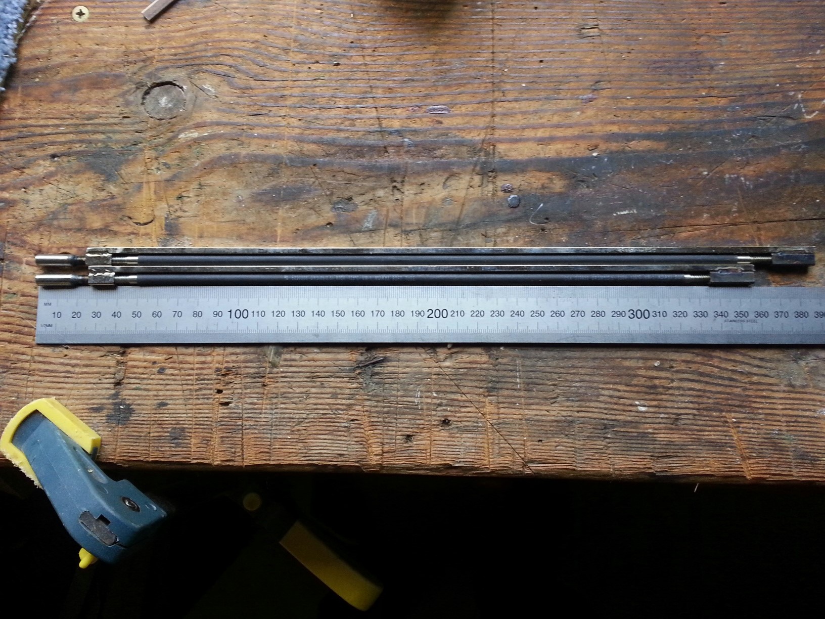

I am down to the last couple from the last group buy that we did from Allied a few years ago. I don't use many, so I would only by in for maybe 10. I don't know if that few is worth your while? Regarding size - I make steel string acoustics and the ones I got last time were 2 different lengths, intended for either 12-fret or 14-fret necks. They were about 360mm and 390mm respectively, if you include the adjusting nut, or 30mm shorter for the steel bar (see the picture below).

Most of mine are same size as in Marks post.
