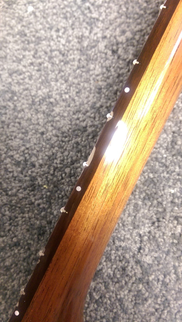

Hi Guys,
I wonder if I could get some advice. I was pulling the masking tape off the fretboard on the guitar I am building and have got some chip out in the finish. I scraped the edges with a razor blade first but I wasn't being careful enough and didn't realise how much finish was on this area. I was considering re-masking that area and trying to drop fill behind the finish that has lifted. I would love to hear your thoughts on how to fix this. The other side came off clearly. go figure.
EDIT: I forgot to add, it is mirotone high gloss lacquer.

To me, that simply looks like what mirotone looks like when it chips, which unfortunately happens quite easily.
When I use Auto 2k I can smash a drill bit into it wrecklessly and it's hard enough that it's still perfect, mirotone you only have to look at it sideways and this will happen.
To answer your fix question, I actually did this a couple of days ago for an invisible fix with epoxy where the mirotone chipped out WAY worse than in your photo.
Just fill the bits with epoxy, block it back, polish it out and remember how you did it so it doesn't happen again!

Thanks heaps for the reply Alan, good to know a fix is possible. What type of epoxy did you use? Did you thin it at all? I have some boatcote I use for pore filling and I have their thinning agent. Thinking that might work well to get down in under the chipping.demonx wrote:To me, that simply looks like what mirotone looks like when it chips, which unfortunately happens quite easily.

I usually just mask the fret board out of the equation spray up to it then it will blend in easy ,fret board is hard so it will have a nice sheen anyway

I've had this happen a couple of times too and my fix is to wick in some thin superglue under the chips that have lifted using a tiny amount of glue on the tip of a toothpick, let it cure then re do the buff out steps from the 600 grit level to re-level the surface. Any 'stray' glue that may have found it's way onto the face of the fingerboard can be scraped and sanded off.

Thanks for the reply. I think that is the strategy that I am going to go with after speaking to a few other people. I had another look at it last night and it is nowhere near as bad as it looks in the photo.

the advice on stabilising the edges with CA is good. if you get lacquer on the fingerboard it usually will scrape off with a razor
I usually leave some lacquer pooled on a waxy bit of paper and once it goes off you have a thickish chunk of it. It can be lifted off and sliced into small pieces that can be sat where the lacquer is chipped. add a little thinners from a flattened out toothpick very carefully and it'll sink into the depression. Once that goes off you can scrape it down with a razor blade, sand and polish.
you'll grow old trying to drop fill that hole

I used Z-Poxy, but only because I've got plenty of it here that I'm using up. Botecoat should do the same job. I'll be buying Botecoat after the Z-Poxy to try it out.Jeremy D wrote:
The real thing is just trying to minimize it happening in the first place, maybe if it's something that happens to you more than once remove the tape while the paint it still tacky and before it cures, then it won't do this. There are a few jobs where I do this myself as the point goes over the tape edge and then when you peel back the tape you're lifting more than what you intended to. Lifting the tape while it's tacky (not wet, but not cured, tacky) lets you pull the tape pull up without wrecking the edge, just dont drag it across the painted part! Also, always peel the tape over itself. Don't lift it straight up, pull it back so the smooth side is close to the opposite smooth side and the sticky part facing up making a V shape.
I've had it happen where the mirotone has built up, then I've drilled through it and then put a screw into the hole and the mirotone cracked with the screw pressure. I've also had it happen when I've re drilled out tuner holes of a guitar with mirotone. On the poly 2k products I've used it's never been an issue, the mirotone just chipped away and I'm talking 1cm long chips! Luckily it was under where the tuners were to mount in and I was able to fill with epoxy, block back and polish and wonderfully it turned out invisible. I did it and I cannot even see where it happened.
These days I over drill the tuner holes ever so slightly so I don't have to clear them out. But not enough that they are sloppy either. I can't tell you the drill bit size, it's an offset I've programmed on the CNC and I cannot recall it off the top of my head.

I've had similar issues when removing the masking tape. I now go along the edge of the fret board with a razor blade and scrape a small chamfer so the finish and the tape separated. Haven't had any problems since.

Thanks everyone. I a managed a respectable fix with CA. I am going to be a lot more careful next time!
