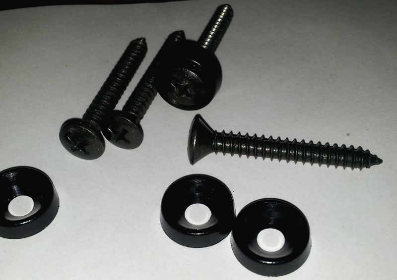

I have 4 that are about 38mm to the top of the pan and the countersunk is a hard plastic insert by the time it's flush with the body you will be just under your fret board depending on the heal and body thickness of course. The washer is about 14.5 dia x 4mm deep I have in the past taken the diameter down with a file a little depending on your counter bore dia .

Easy they are just a flat countersunk ,not a pan or dome or the likes and the washer is easy to make just make a large countersink in some aluminium and a sacrificial cut screw to press in there on the vice bingo cupped washer . :)
