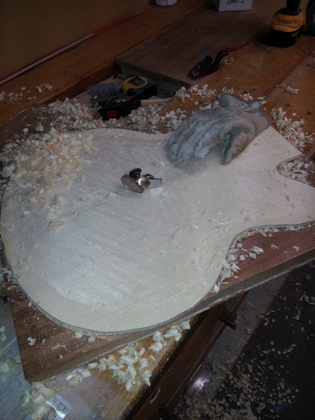

Hi all,, another topic in here asks haow long it takes to build an acoustic guitar, well i might just win the prize for taking the longest time ever!! :lol: :lol: . I started this build over three years ago, then the build was interrupted by a house move, and several commission builds and a few spec builds, anyways i'm back onto it now.

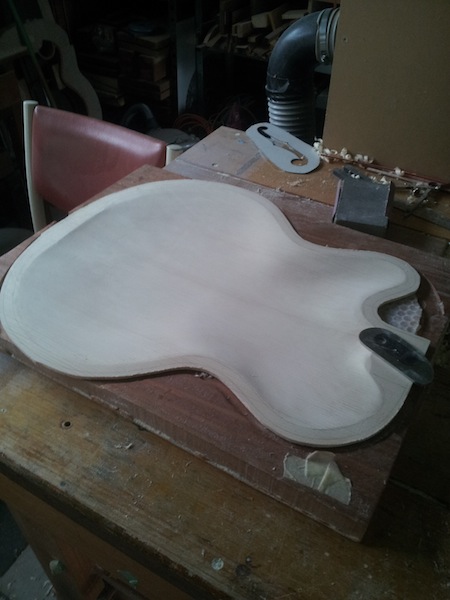

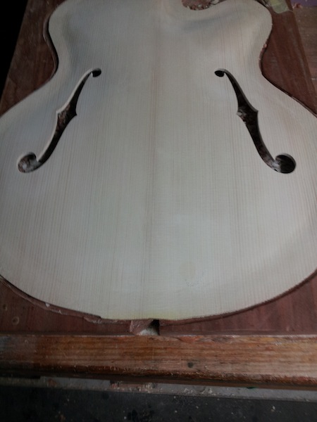

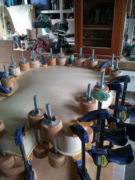

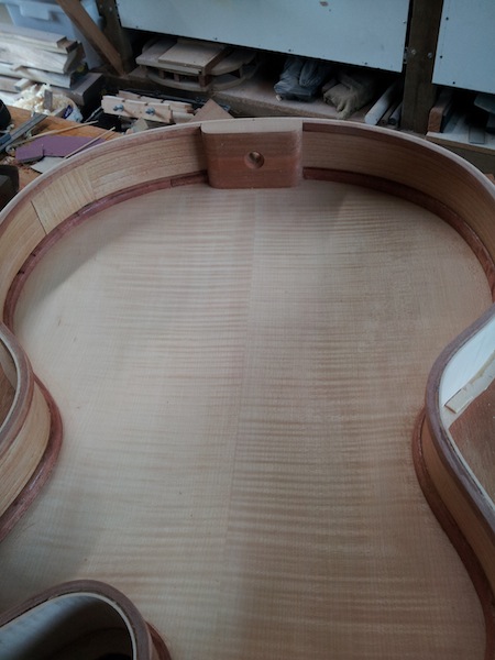

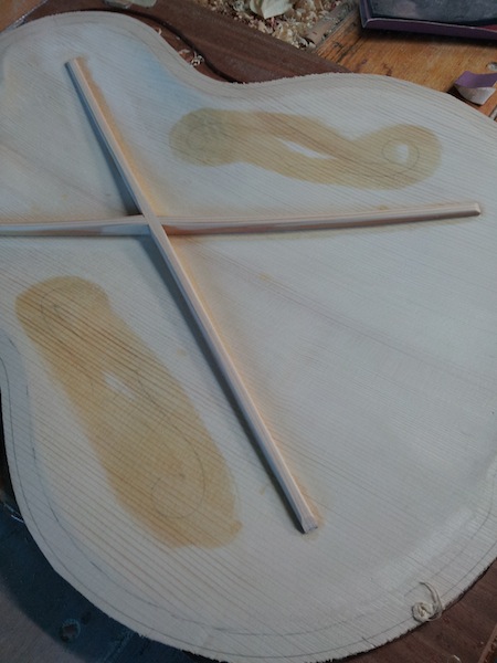

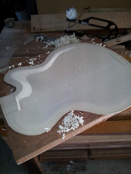

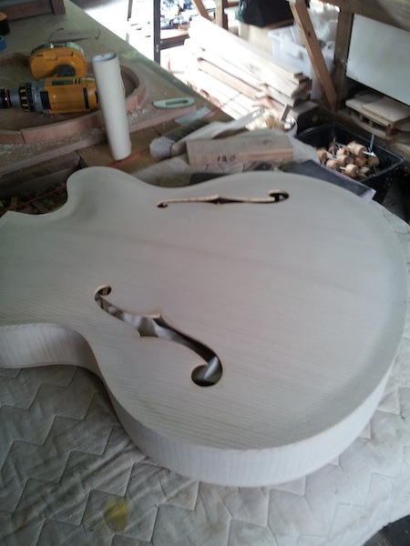

Of course solid carved plates, the back in flamed maple and the top in European spruce, the laminated maple sides have solid linings, the X braced top will have K+K twin spot internal fitted, figured maple lam neck ebony board and headstock, and some pics for your enjoyment :D
inner back carve
outer top carve
top thicknessed

closed box

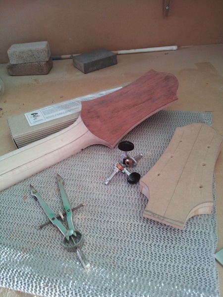

Looking good as ever Rod, is that one of them new fangled finger sized chainsaws in the second pic? :wink:
Re: Maple and Spruce archtop
Post by rocket » Tue Apr 19, 2016 10:49 am
Nick,, nah that's one of the new cnc finger planes,i just couldn't ignore the new fangled technology

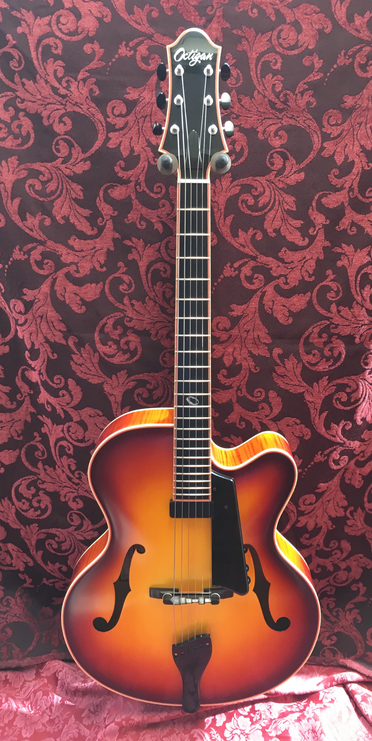

Post by rocket » Wed Dec 28, 2016 10:49 pm

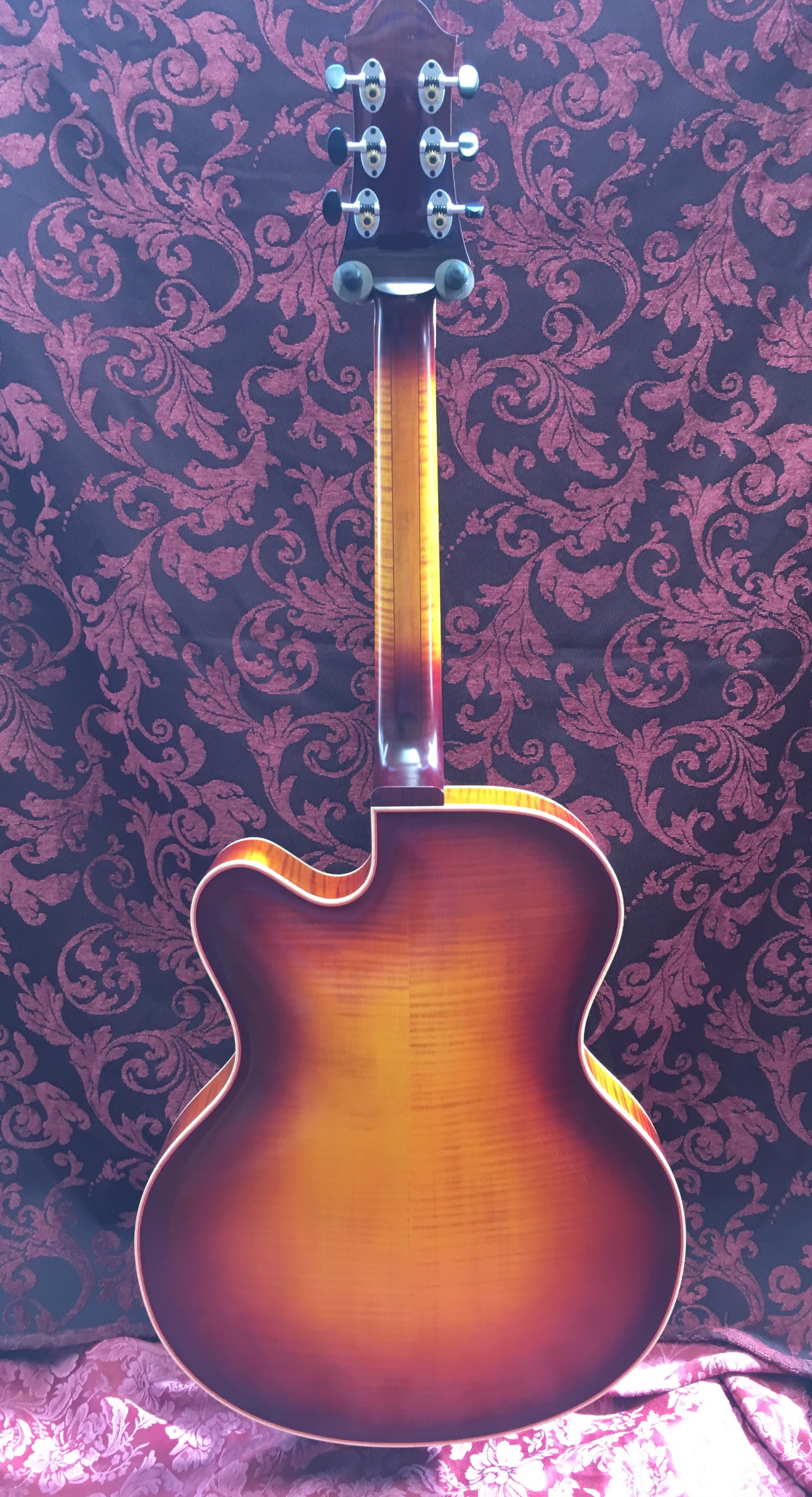

finally finished this one, the finish was a real pain in the neck, but i got there in the end..
Satin finish with K+K twin spot as well as Kent Armstrong cusp. bucket.
Thanks for looking

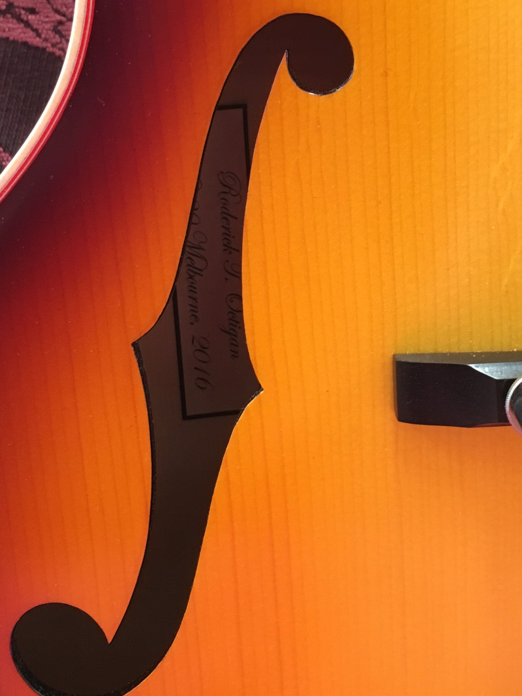

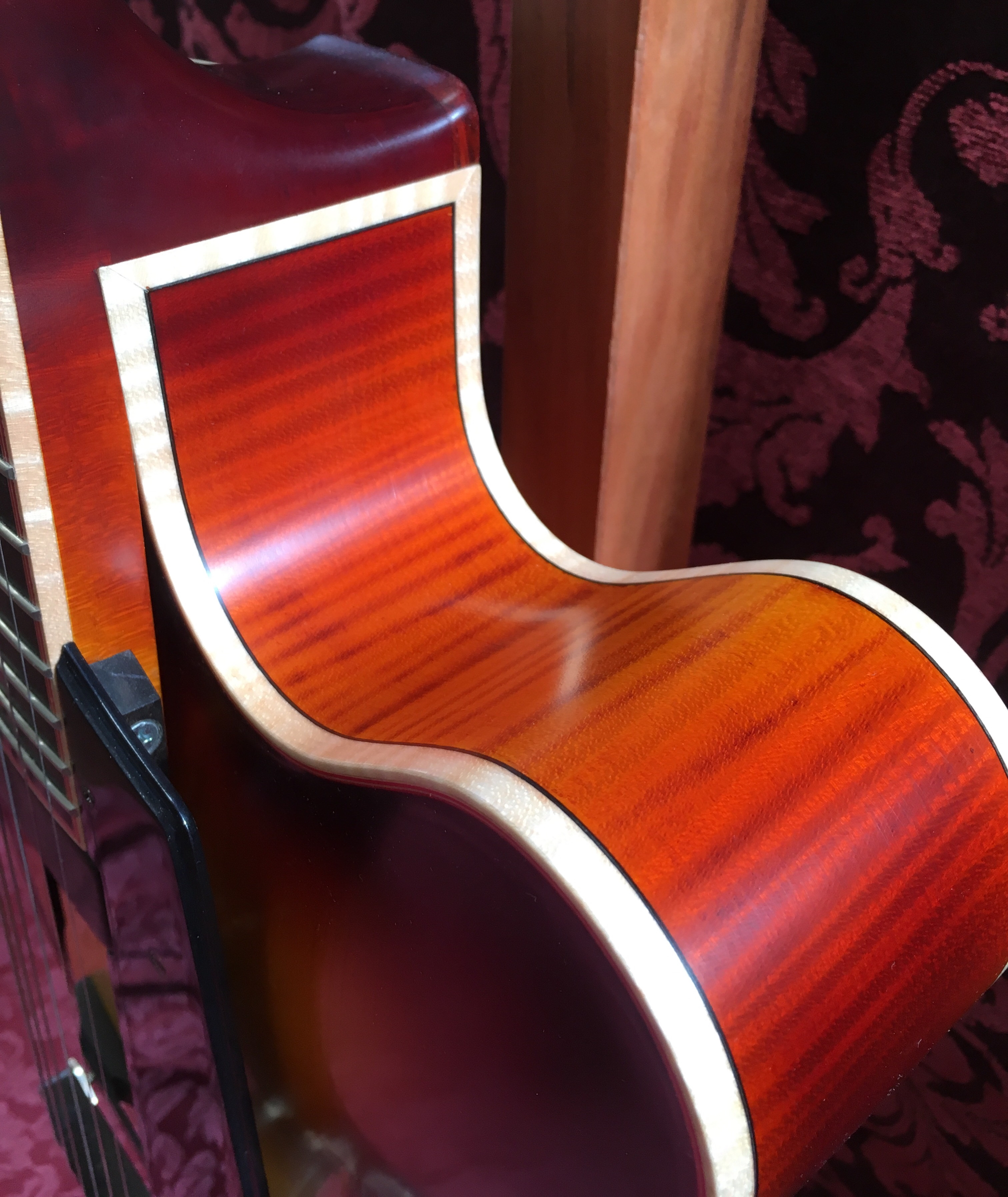

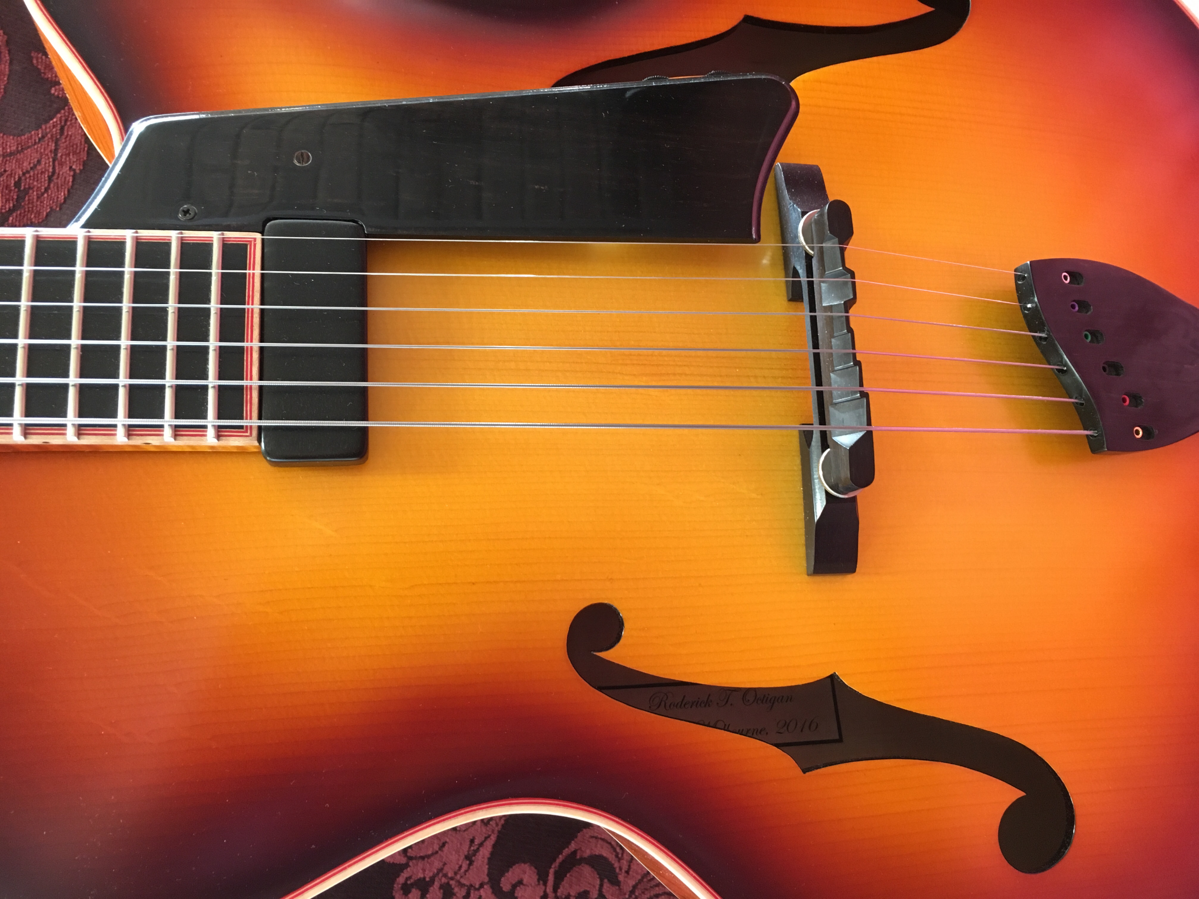

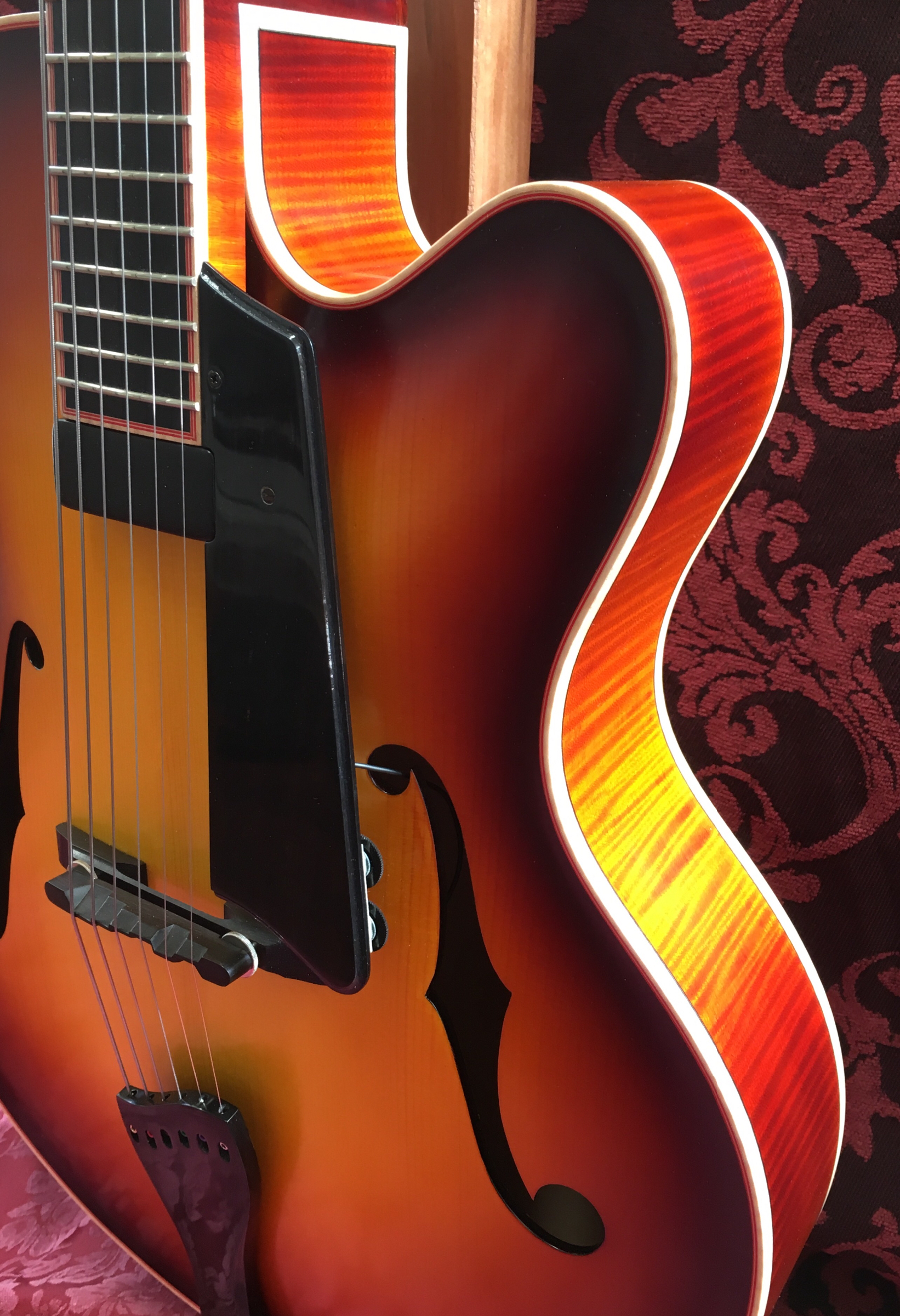

Post by rocket » Tue Jan 24, 2017 2:11 pm
Can't blame me for being a tad proud of this one.
Here's a couple more shots.
Rod

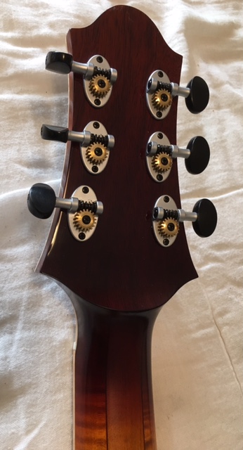

Rod I'm new here but just wanted to say I've been collecting the wood for an archtop and really enjoy your pics. You've set the bar pretty high.
What are the tuners?

Post by rocket » Tue Feb 21, 2017 3:33 pm
Welcome aboard Jon and thanks, but at the same time there's a few posting in here that I'd like to par with ha ha!!
Good luck with your he build, is it your first?
The tuners are Schertler.

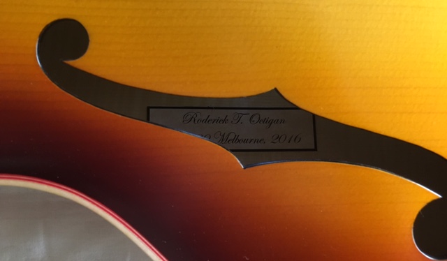

I like your "Octigan" headstock inlay; do you cut them yourself or send off for them? If so where?
My wife reckons they look much better than the ones I cut (I agree) and our graphic designer daughter can design a new logo for me.
Cheers, Ken
