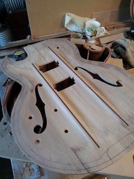

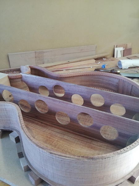

Post by rocket » Thu May 12, 2016 7:46 pm

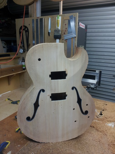

In the past when i've built a hollow body electric arch top i've either carved the plates and left them a lot thicker than i do with an acoustic or used a laminated construction, trouble with the laminated plates i've bought is i don't like the arched profile,,, these two scenarios coupled with heavier bracing and top mounted pups usually deal with the feedback problems arch tops have when high volume is needed.
Some builders use a solid block inside the body to combat the problem and others use heavy bracing and struts between the plates.
On this build I've adopted something from both of those methods and come up with something of much lighter construction but still effective in the anti feedback stakes and hopefully adding some sustain, two full length full width, timber / cf ribs, 4 mm thick .

Re: Hollow body with a difference
Post by jeffhigh » Sat May 14, 2016 4:31 pm
Do the ribs contact the top, or are they just breaking up the air resonance?
Post by rocket » Sat May 14, 2016 4:49 pm
Jeff,, the ribs are glued into a groove in both the plates, when i carved out the plates i left enough meat to run a4.25 groove.
Post by jeffhigh » Sat May 14, 2016 10:00 pm
I was looking at the picture of the soundboard wrong, looked to me like parallel braced capped with CF when it was actually grooves.

I would like to postulate the following speculation. Please note that it is not a judgement or an opinion, it is merely a possibility to be considered...
A laminated soundboard and back would not have the kind of sensitivity to changes in moisture content that solid timber plates would have.
A laminated soundboard and back that has a solid sustian block as in a Gibson 335 which connects the top to to the back will not have the kind of sensitivity to changes in moisture content that solid timber plates would have with the same construction, as in a Gibson 335.
Solid arched plates dome and flatten out as the moisture content varies.
The construction in your photo divides the top and back plates into three separate areas for each plate, which can move with changes in moisture content and fixes the plates at the baffle points lengthways along the grain of the quarter sawn timbers.
Therefore it is possible that the soundboard and back could be subject to cracking at the points where is is glued to the braces and baffle.
I wonder if that is one of the structural reasons why sustain blocks which run the length of a guitar are not often seen in non-laminated guitars? Perhaps you or others reading this thread have seen similar instability in non laminated sustain block construction?
I am also wondering, if this design turns out to be successful, if the timbers and their weight in the baffles can be varied to influence tone attack and sustain? I think there is probably a reason for spruce sustain blocks and not heavier wood, and that the density of the spruce has an effect on the guitars sound...Beautiful precise workmanship, by the way!
Post by rocket » Wed May 18, 2016 8:37 am
All fair comments,i consider that the construction method is similar to the solid block method on regards to parallel to grain connection, I've built several semi hollow/carved jobs and have had no issues with stressing along the grain, i feel that this method will also give the plates a more even exposure to atmospheric conditions than the solid block method so maybe that's a plus!

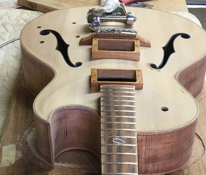

Post by rocket » Mon Jul 18, 2016 7:50 pm

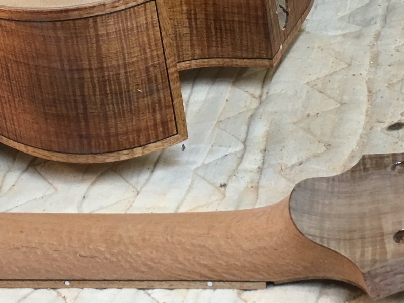

Making a bit of progress with this build, got the neck bolted on, silky oak with bubinga f/b blackwood veneers, bridge base and pup mounts are matching Otways blackwood, have applied the first session of grain fill.
I intend to finish in Mirrotone 3220 but i want to finish the top in an acrylic solid colour, i'll have to do some homework on compatibility because although the two will be done separately the meeting point will be at the purfling line around the belly, not carved in stone yet but that's what i have in mind.

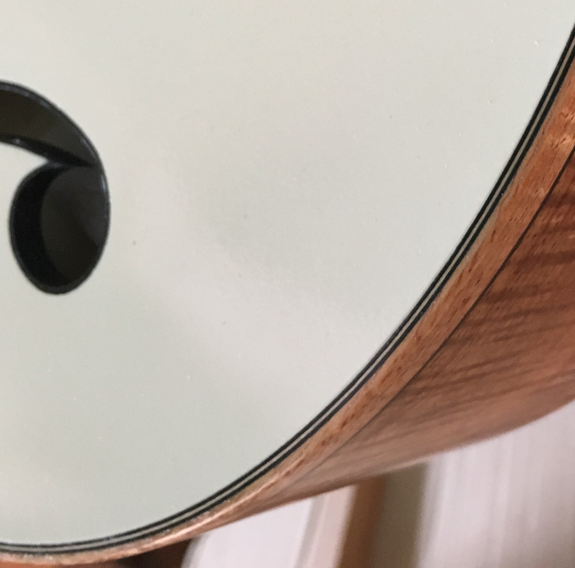

Post by routout » Tue Jul 19, 2016 6:40 am
That's a really nice clean look on the edge binding just the rite amount a nice break from both pieces of wood. :D
Post by Jason Rodgers » Wed Jul 20, 2016 2:18 pm
Super cool all around. The bracing could be seen as a variation on the Gretsch "trestle" bracing. Worked for them.

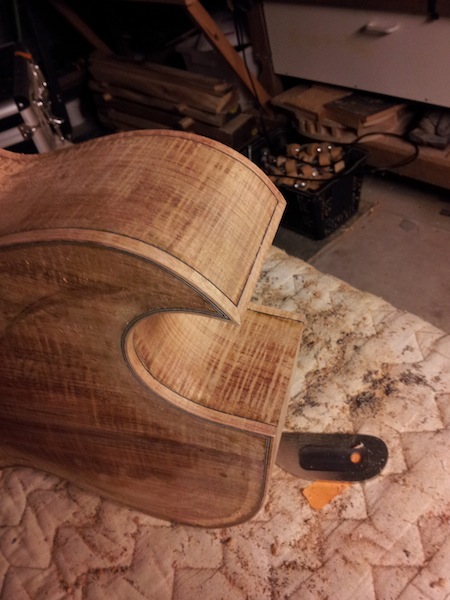

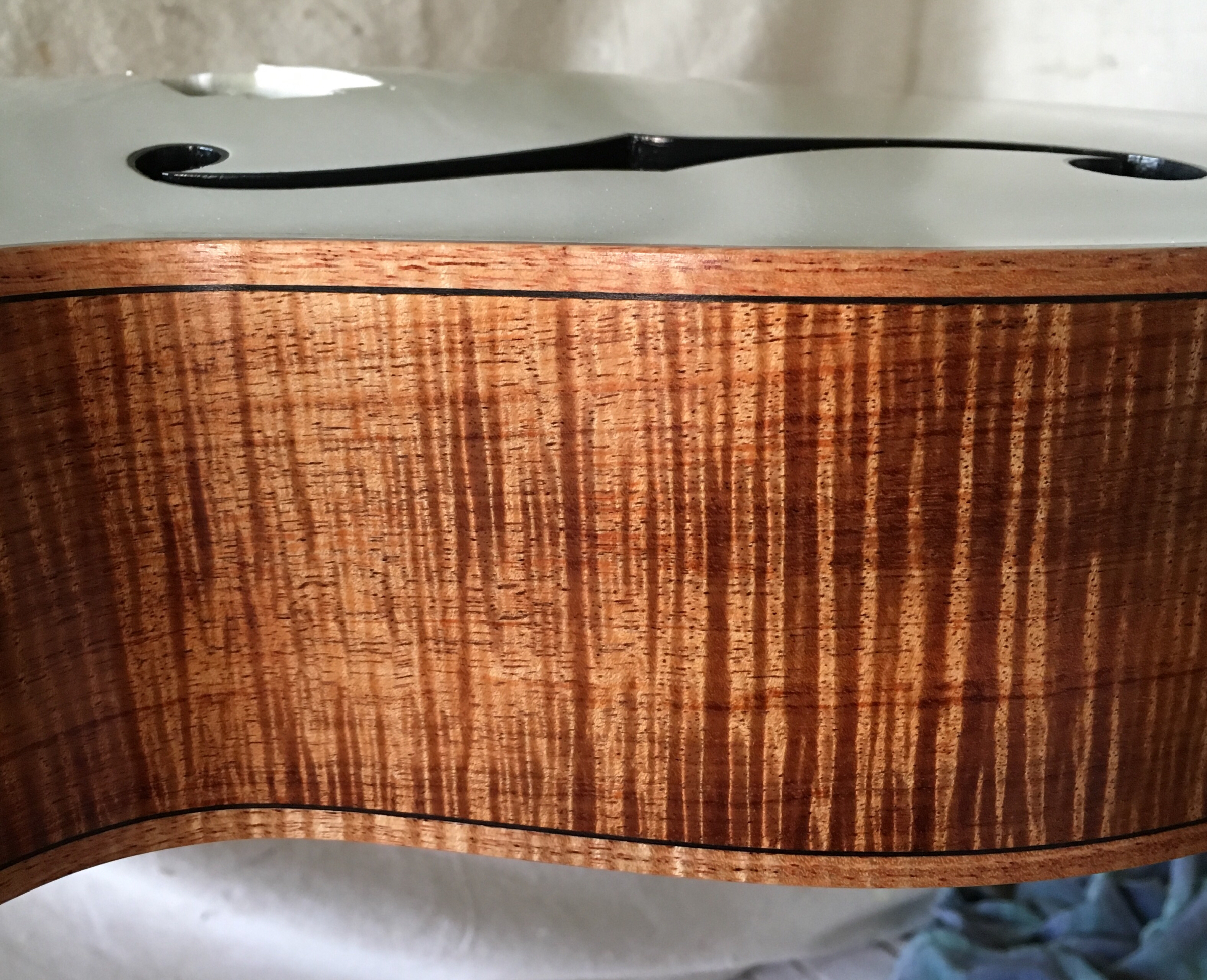

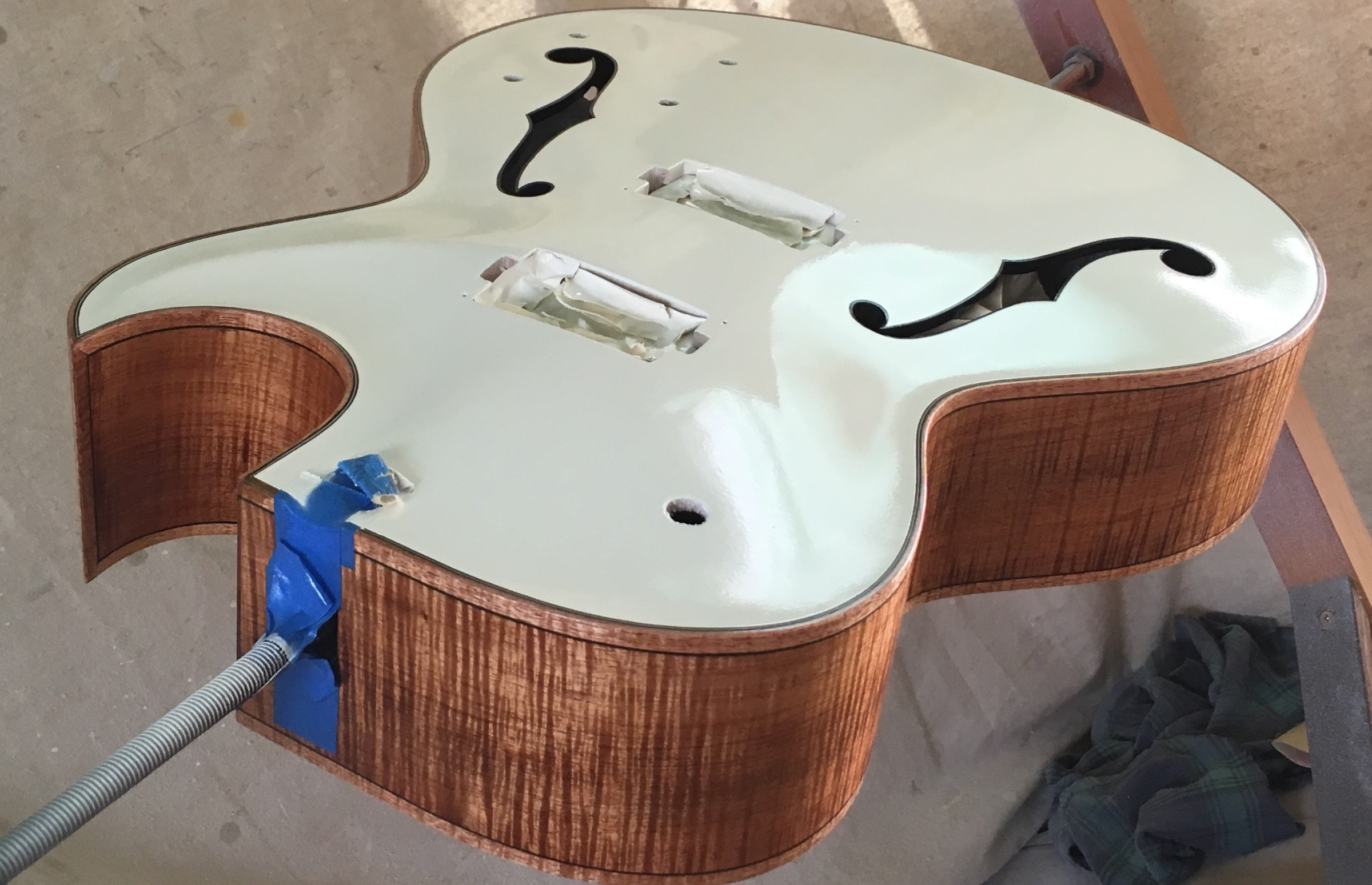

Post by rocket » Thu Sep 22, 2016 7:52 pm
So I managed to sort the finish out on this,
Mirotone nitro on the top and then go over the lot with 3220. Quite happy so far.

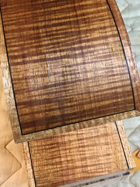

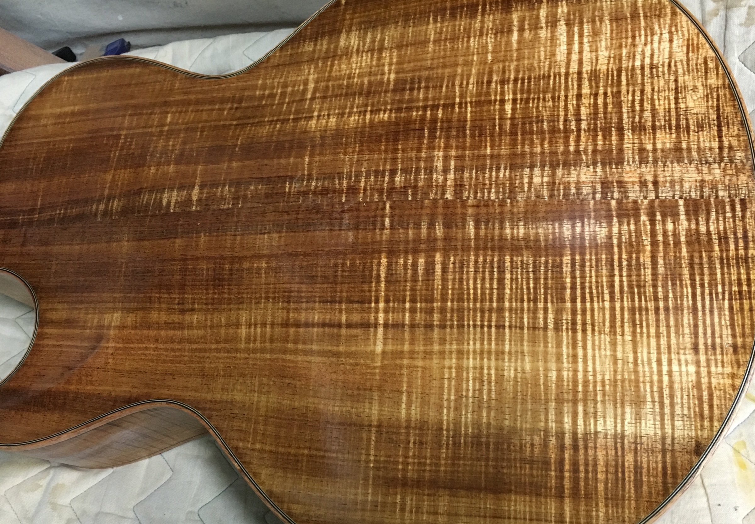

Post by rocket » Thu Sep 22, 2016 8:01 pm
A bit of Otways fiddleback Blackwood at its best

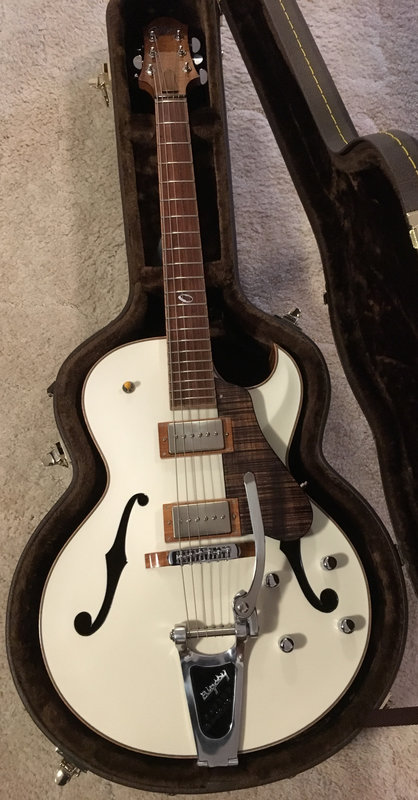

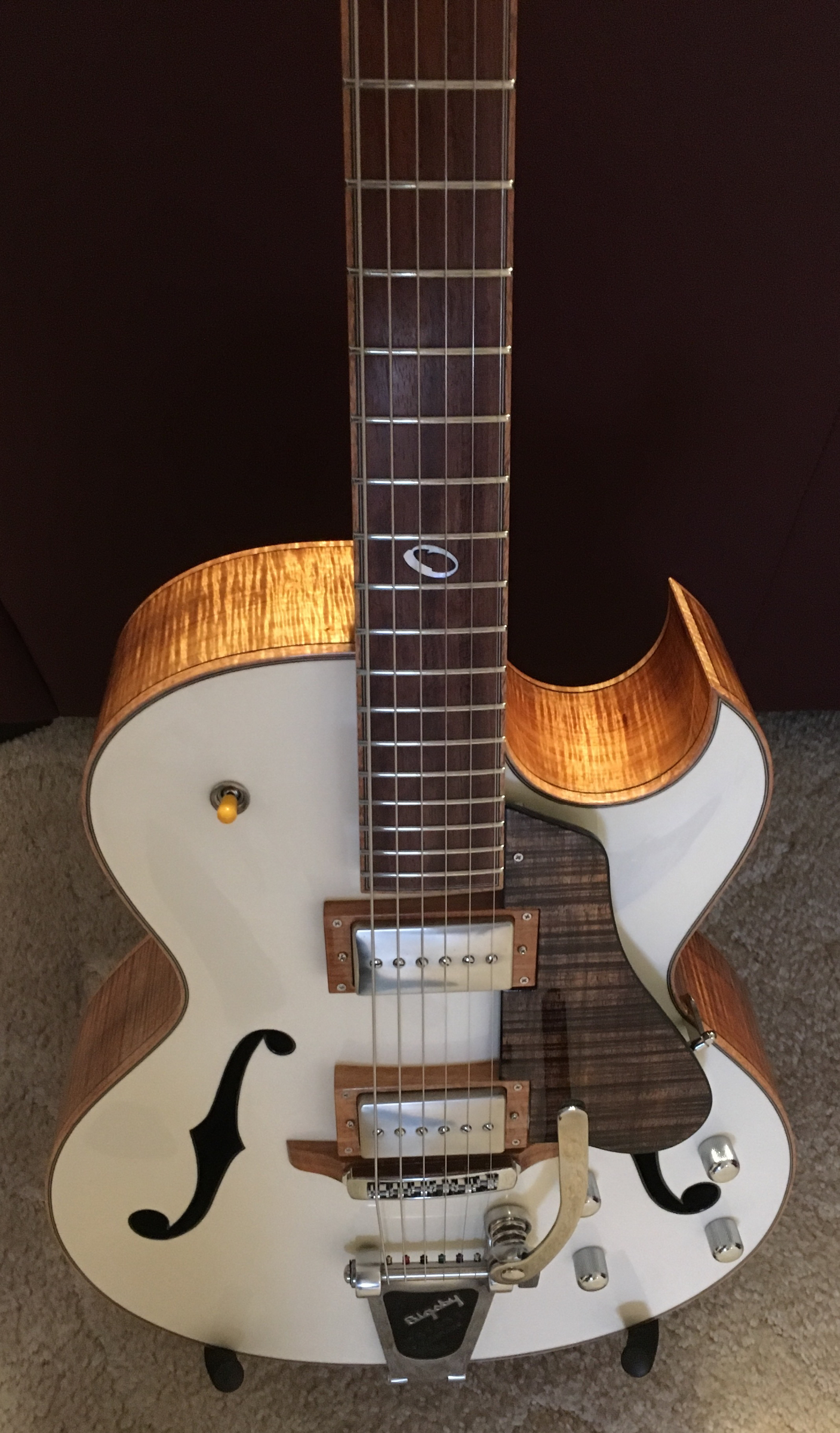

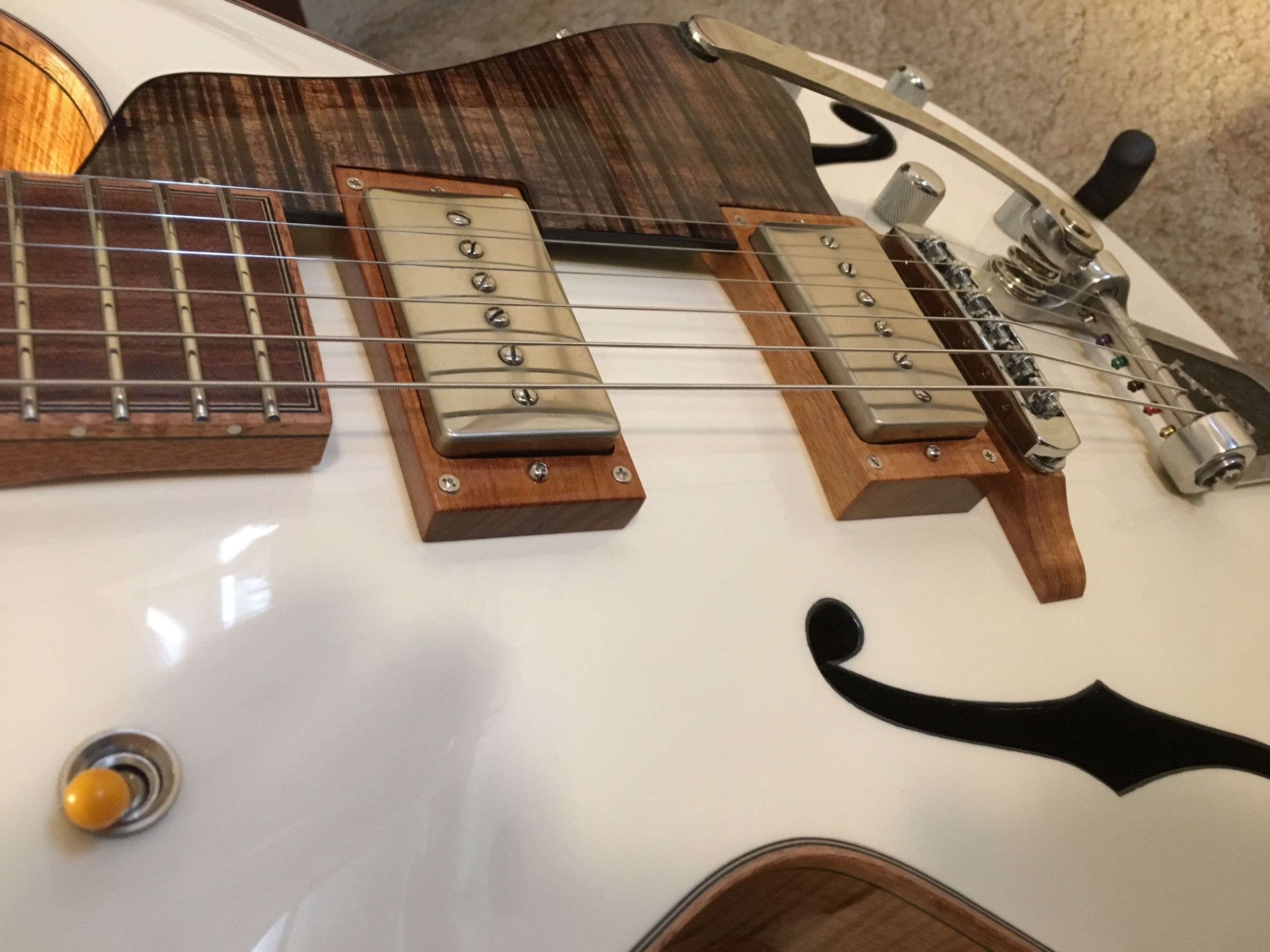

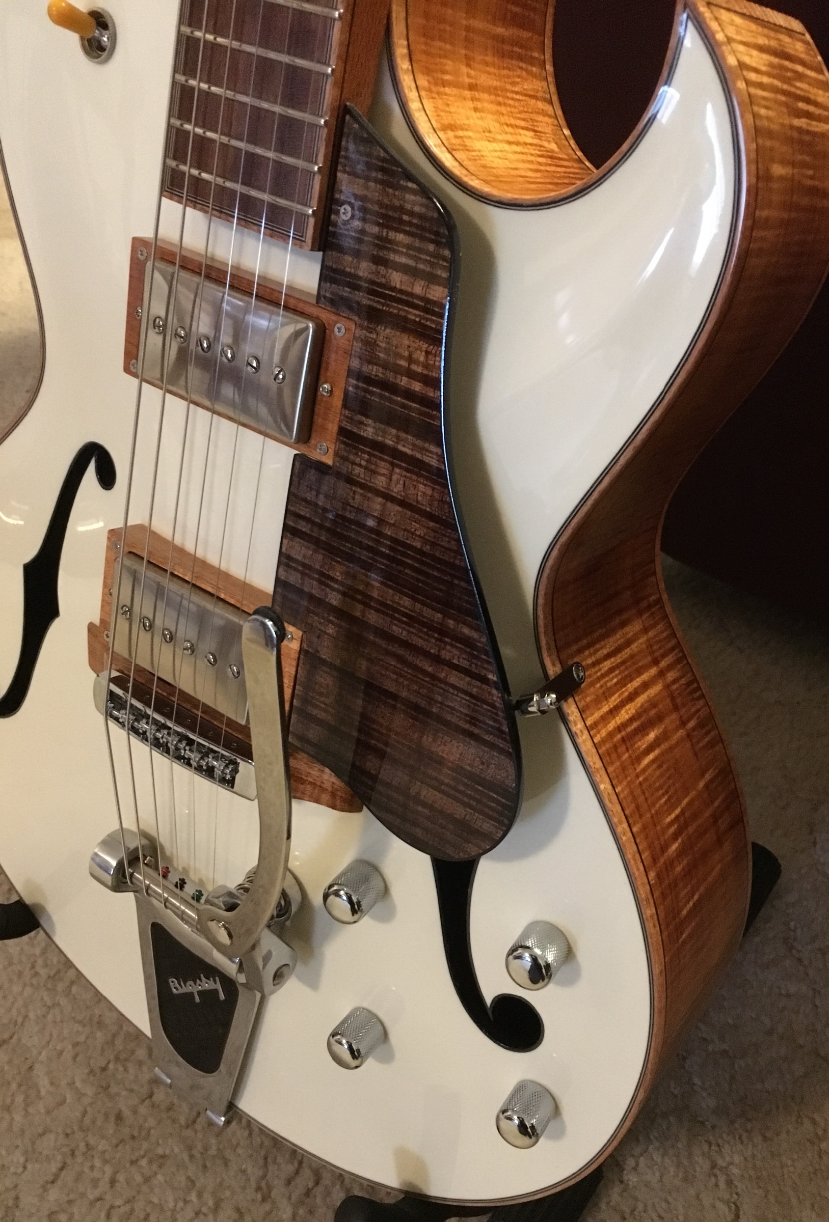

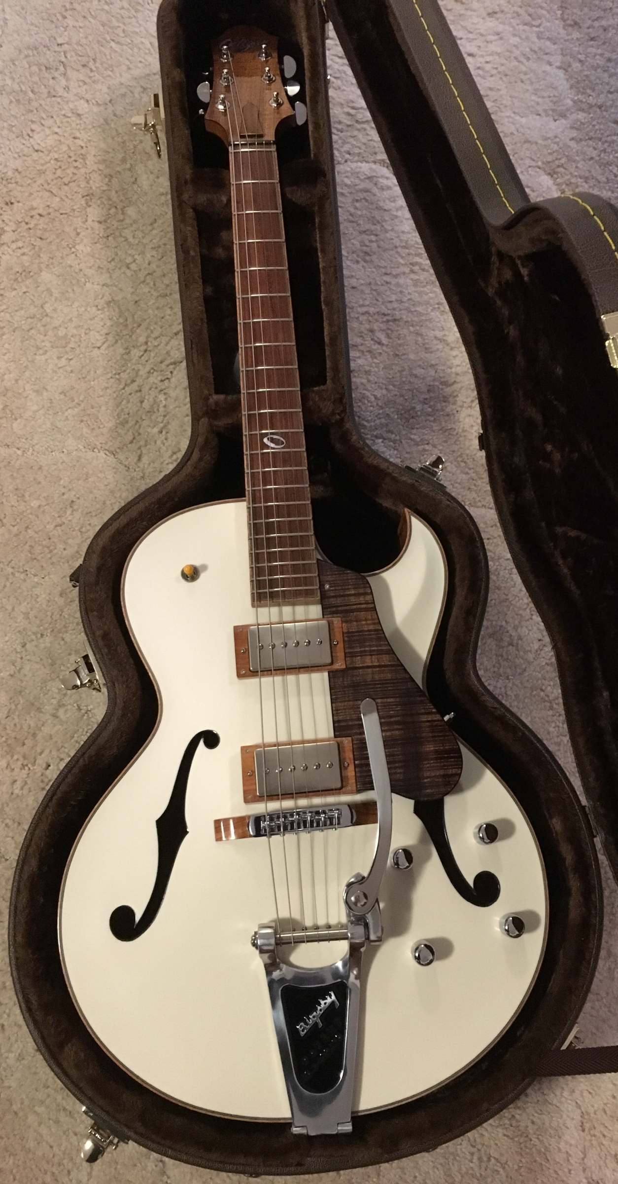

Post by rocket » Mon Dec 12, 2016 6:09 pm
Finished
56nortondomy
Posts: 717
Post by 56nortondomy » Mon Dec 12, 2016 6:25 pm
That's turned out great Rod, does it sound as good as it looks?
Post by rocket » Mon Dec 12, 2016 6:38 pm
Of course it does Wayne
