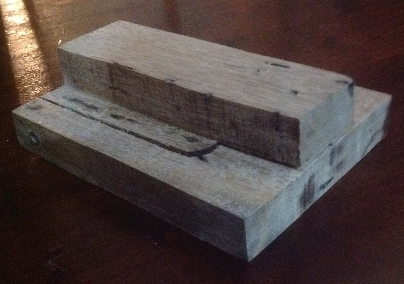

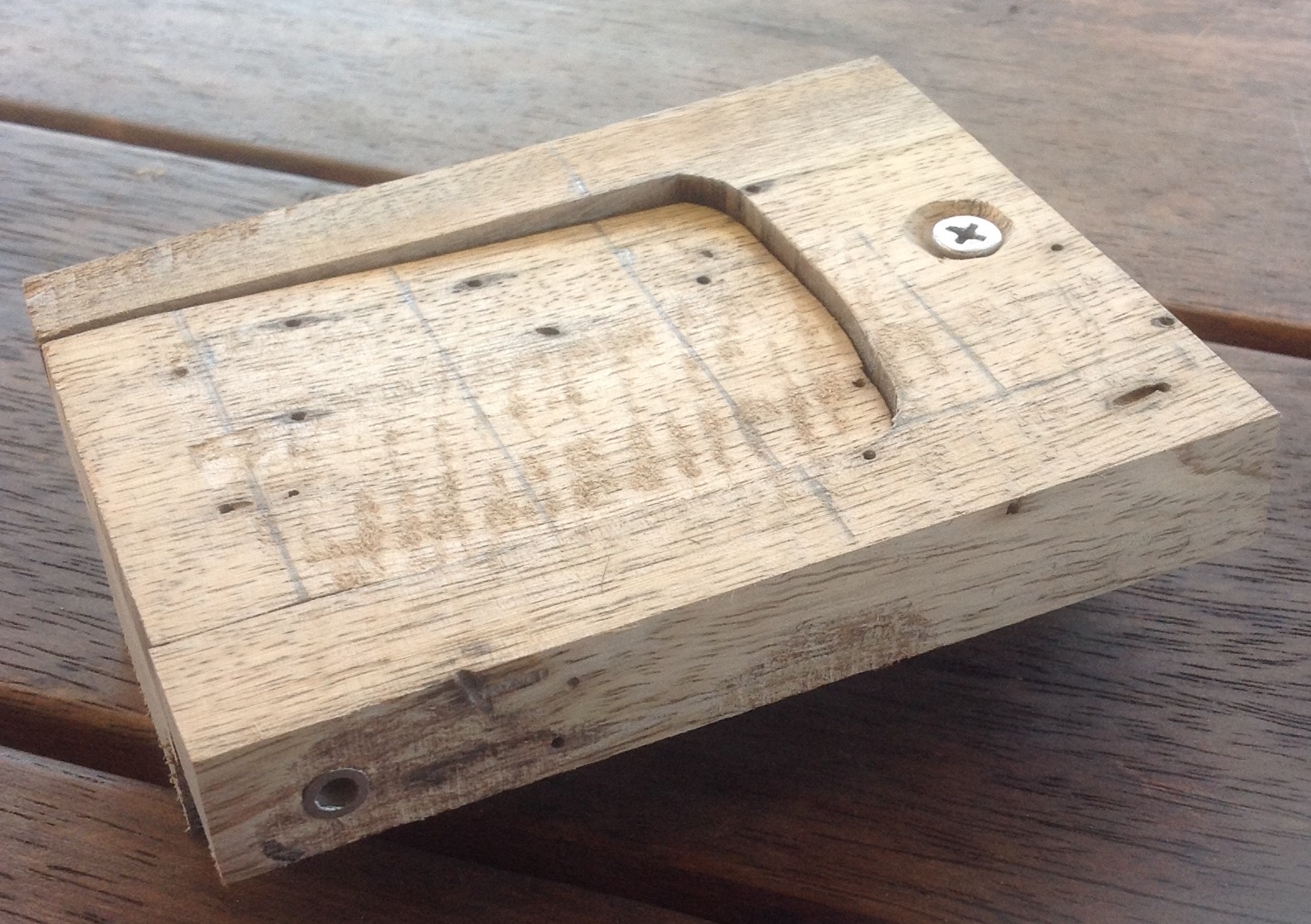

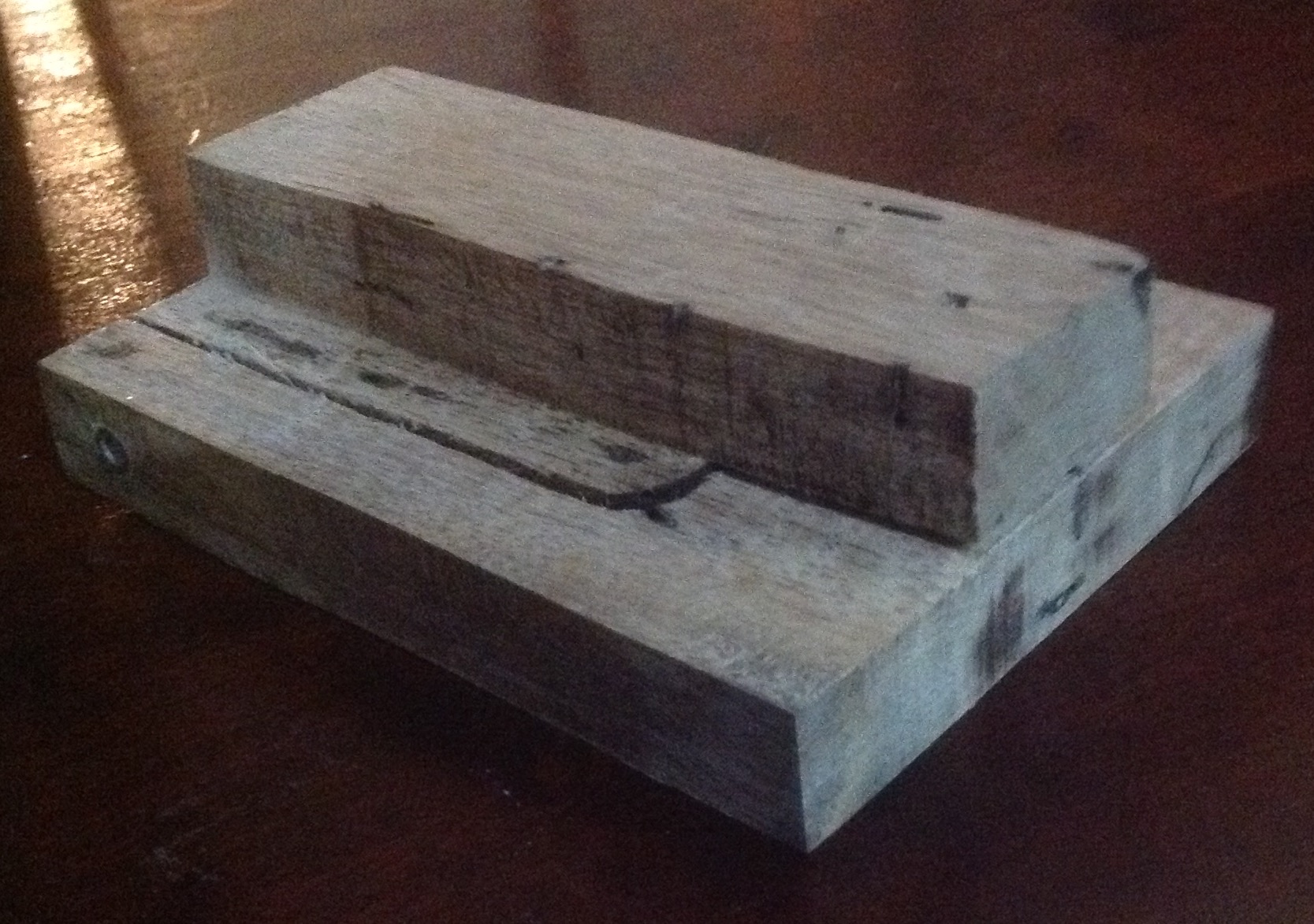

I make full size shims using 0.6 mm thick jarrah veneer glued like plywood to stop them cracking.
Depending on angle 2 to 4 pieces. Assuming 3 layers are used I do the following.
1 full size, piece, then 2/3 of a sheet 1/3. After clamping and glueing, I trim to shape of the pocket and drill the screw holes.
Then I drop them in this jig and use a sanding block to get it flat on the angled side.
I set the screw in the jig to set the ange, the hinge is a piece of pipe, but a bolt or dowel would work, the pic shows it opened more than I have needed
Re: making an electric guitar shim
Thanks Martin
This is the 3rd one I have made because I loan them and don't get them back.
I should have mentioned the underside has a block glued to it that the screw goes into into,
