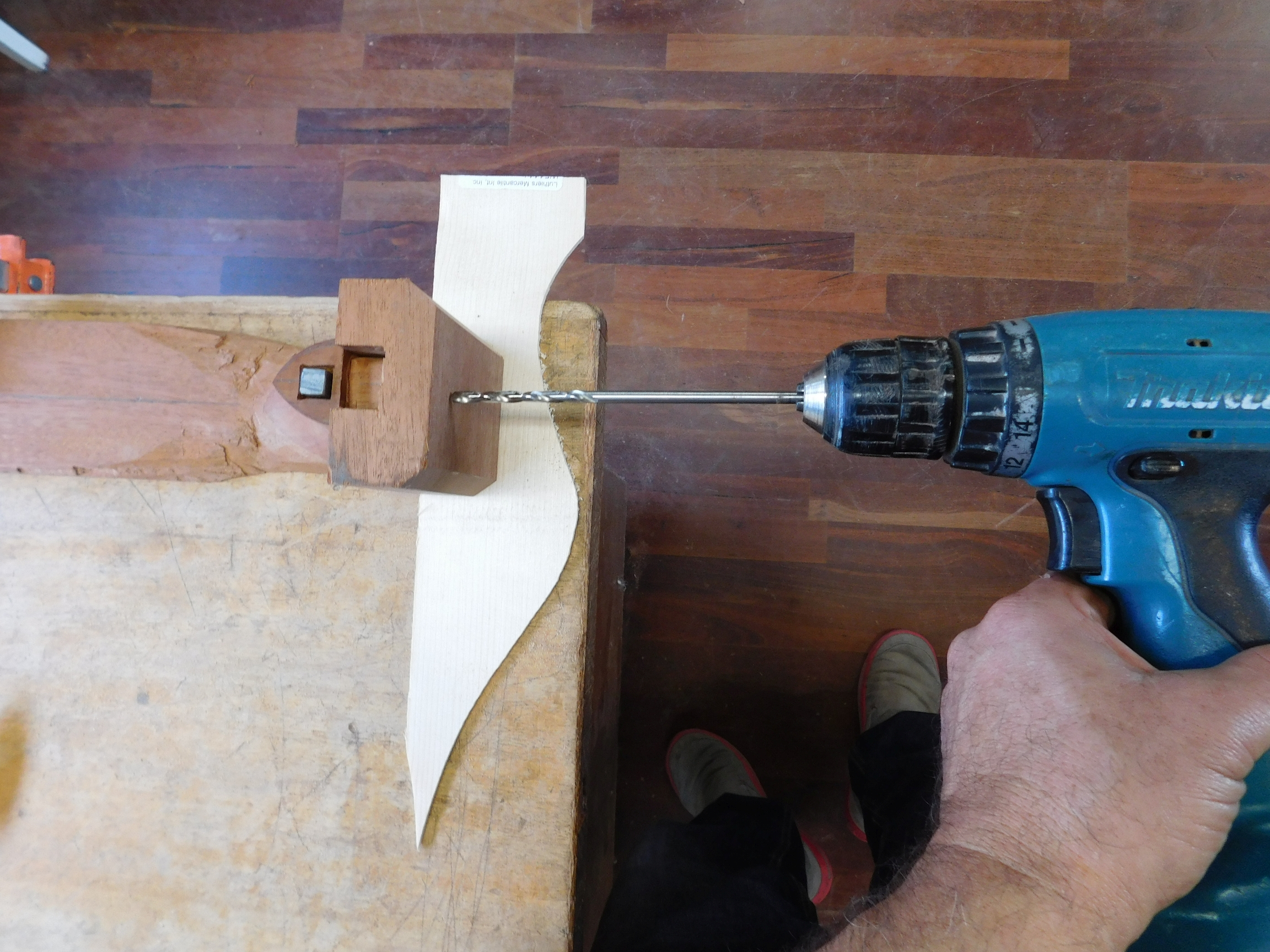

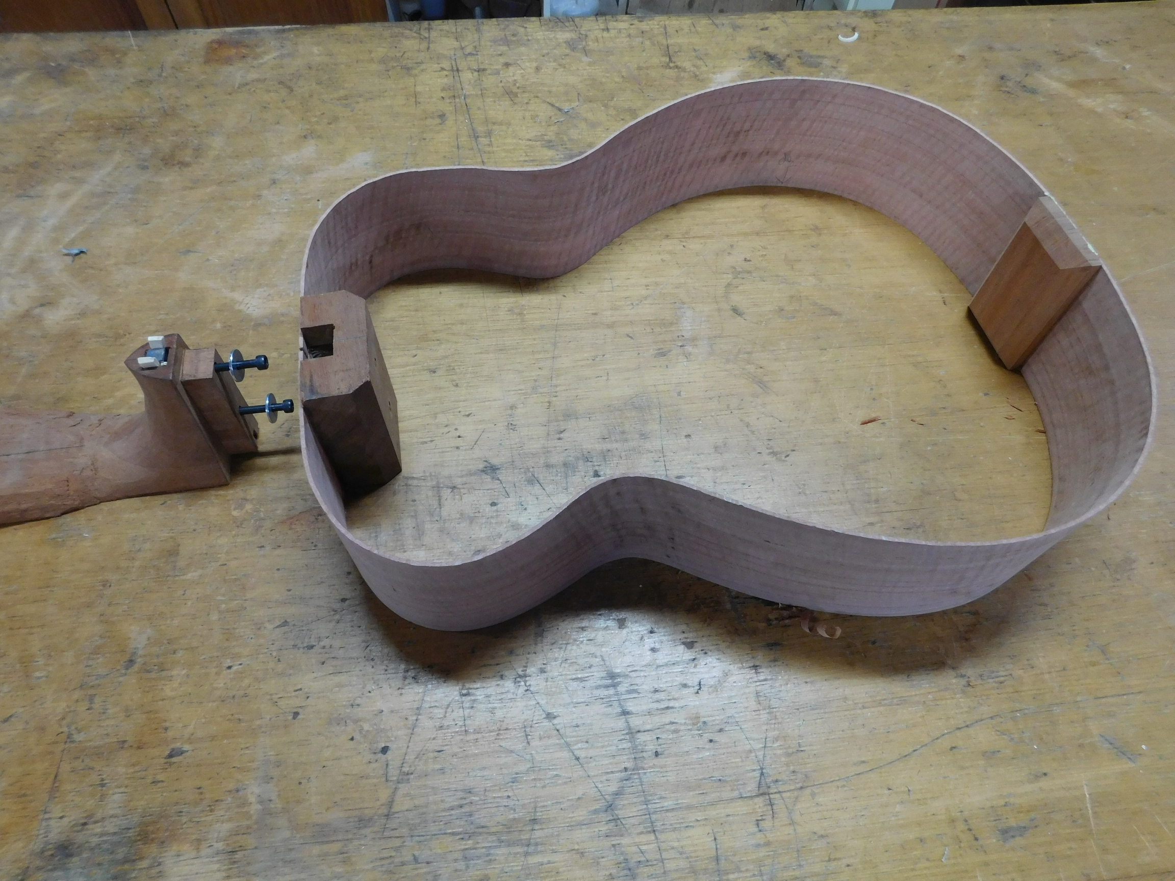

Early this year I was talking with Gerard Gilet about the frustration of trying to teach students the bolt on method for neck attachments to guitar body. He mentioned the idea of a Spanish heel type setup where the neck can be unbolted off the body. I took that concept and came up with the following procedure where the neck angle is built into the instrument. Its an easy alternative to the regular bolt on where you can spend quite a bit of time setting the neck angle to the body with some precision chisel work after you have used quite a complicated jig and router to create the mortise and tenon.
This procedure is a cross between the Spanish heel and bolt on in its construction. The neck angle is set in the construction and shouldn't need adjusting once the back is on. It can be unbolted and adjusted if need be.
Its an easy build and can be created without a router and routing jig if you prefer to use hand tools,

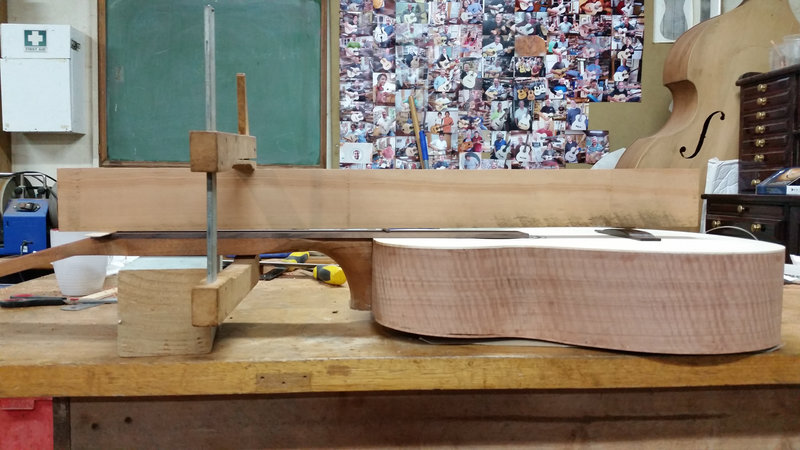

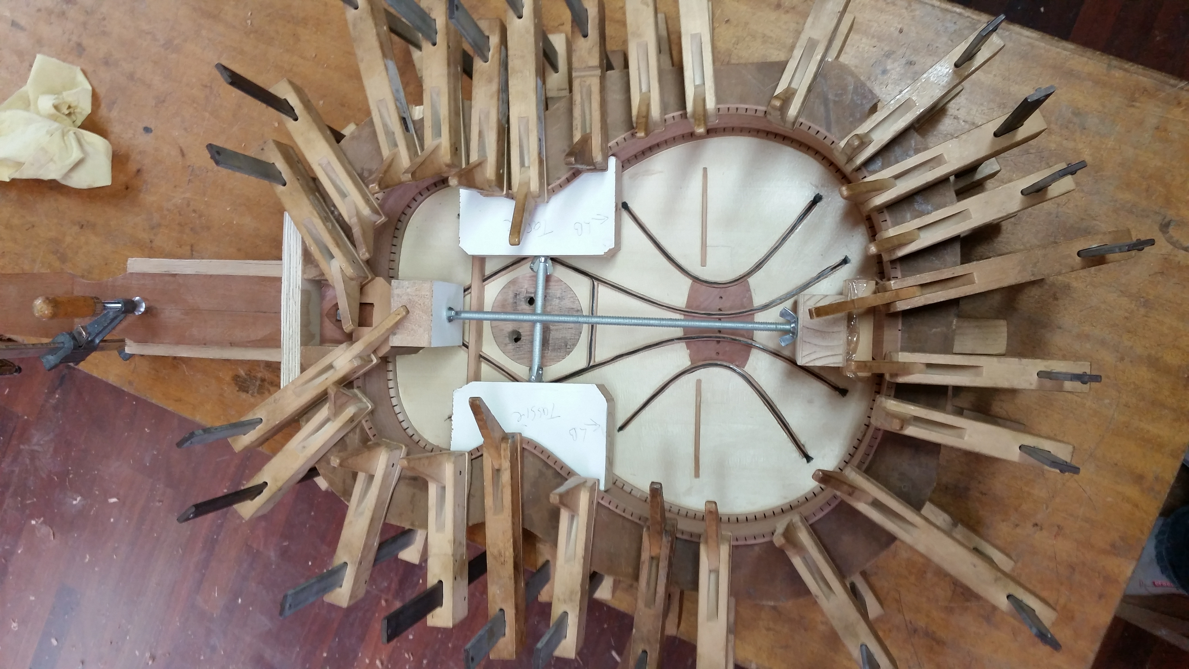

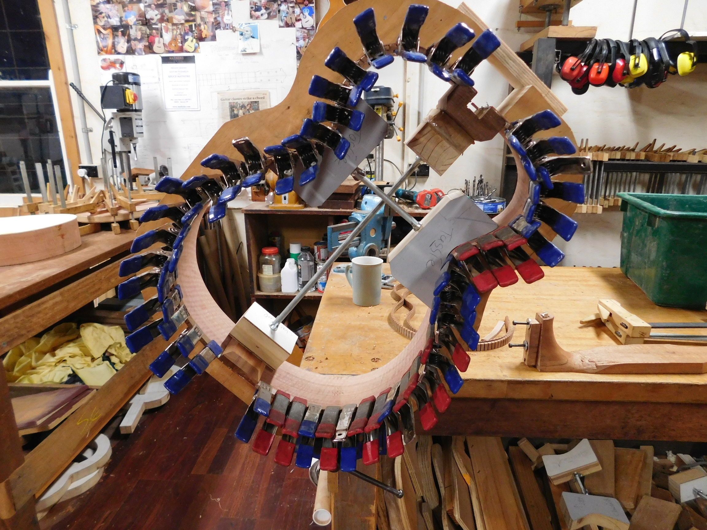

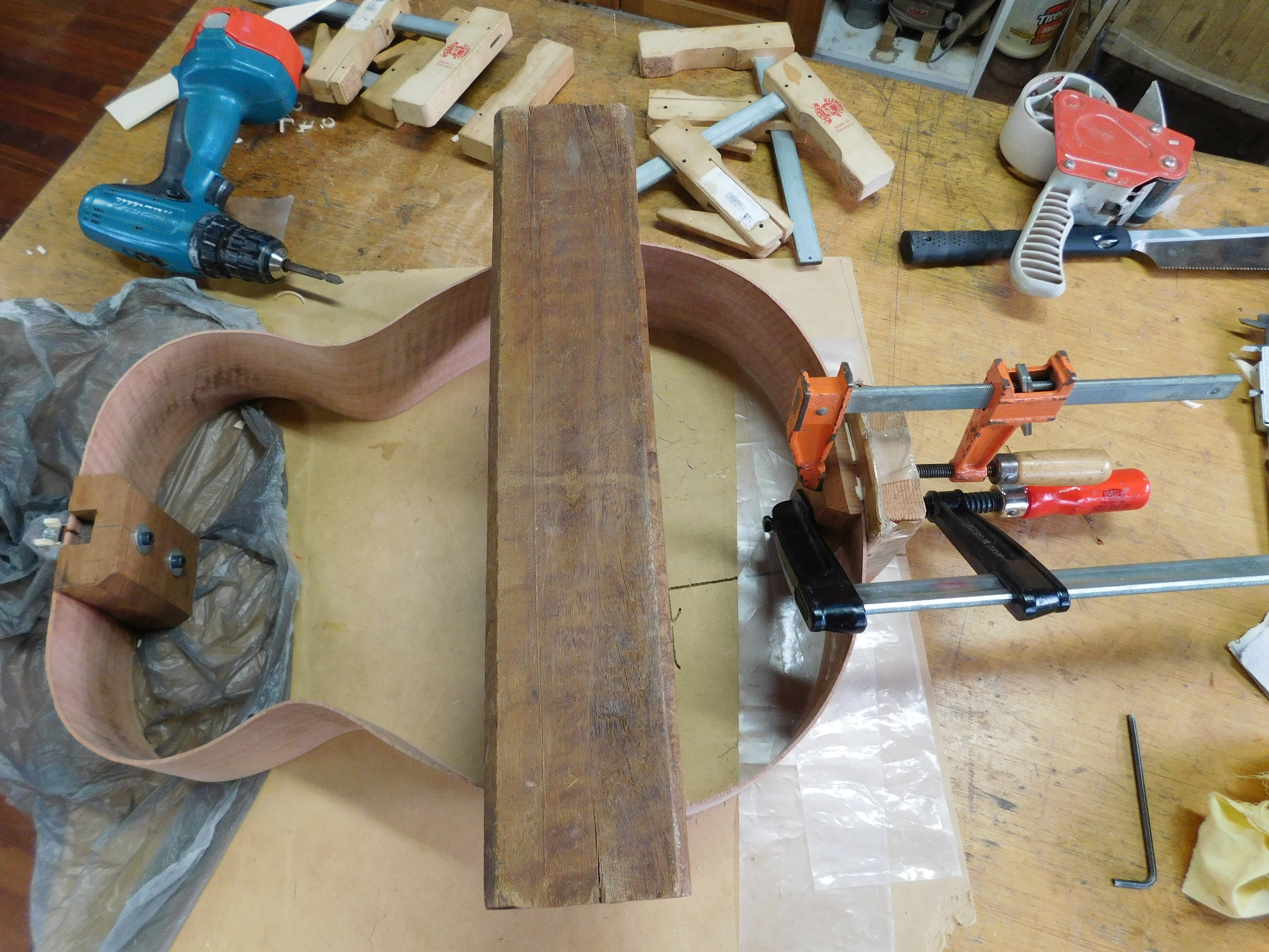

Thanks Jim. The first angle which is simply your center line is set when you glue the top on. I have 6mm dowels in the solera which sit in the truss rod slot and holds the neck straight with the top. The top can be clamped in place through the sound hole or in this case I actually left excess on the edges of the SB and screwed it in place on the Soleara. That way the top and neck can't move while you are gluing and clamping.

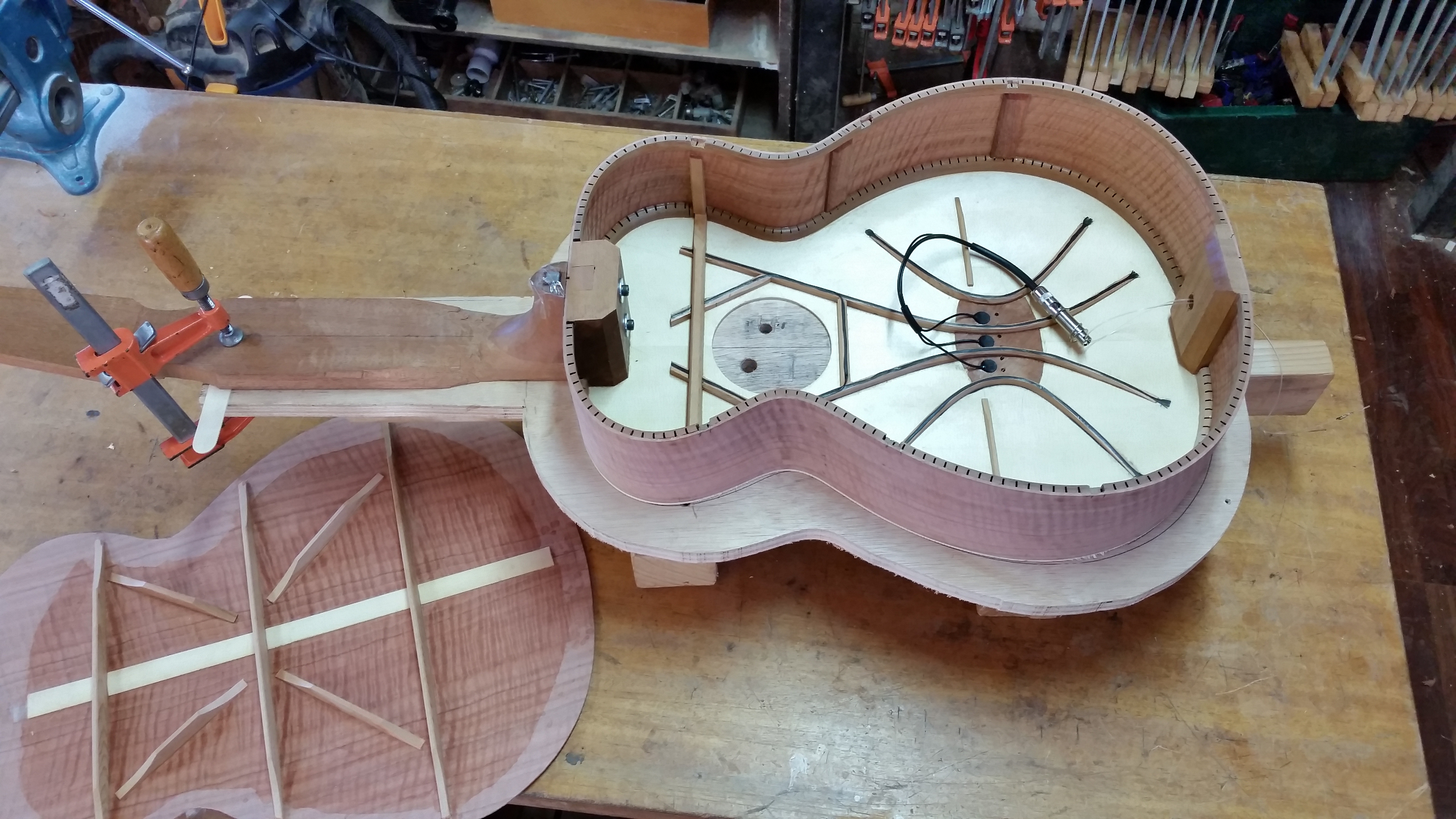

The second angle is set when I get ready to glue the back on. I lift the neck up at the nut about 1.5mm off the soleara with a tongue depressor and clamp it in position.This gives me about 1.5mm gap at the bridge position when I project the neck angle. The back gets glued on and that neck angle is set.
To check all my angels for saddle height I sit a bridge in place, sit a 6mm fingerboard in place, place the tongue depressor on the fingerboard at the nut end to simulate the string height there and a 4mm drill bit at the 12th fret position to simulate the string height there and then sit a straight edge on these 2 spacers and check the saddle height at the bridge. If it is a bit too high, I thin the fingerboard to achieve the 3-4mm off the bridge that I'm looking for. If it is alot too high or low then I can take the neck off and adjust the angle at the heel like a normal bolt on. I've only tried this new method once and the neck angle was right with a 6mm fingerboard once the back was glued on. I'm now ready to take the neck off and fit all the bindings. Tongue depressors have become my universal spacer! Also good for stirring epoxy glue.
