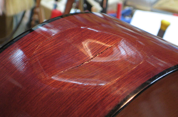

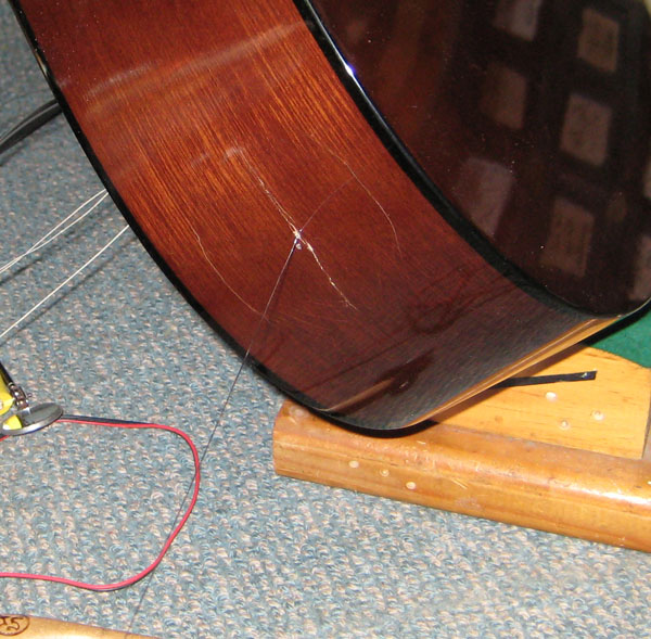

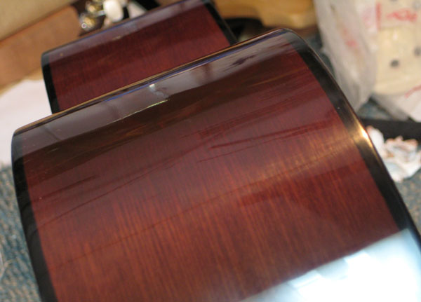

Repairing can be fun.There was a young girl exiting a bus and her Yamaha got caught in the door ,she was extremely upset and blamed herself .So the shop said what can you do fix it Yep I said, there is a curved piece of wood inside and a guitar string connected ,clamped on the other side under tension bingo there you go :lol: ,this was for free I don't charge for acciDents :D

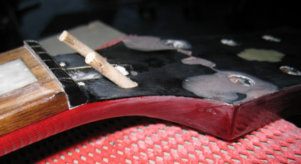

Yep most hit the floor and I guess strung there is plenty of tension to pop the top ,I have had good success with two 5 mm maple dowels on the angle through the crack then the back of the neck has just a hairline mark and the top get's a black coat.I should have documented a lot more stuff :(

Why the two dowels ?

Post by routout » Mon Nov 21, 2016 6:03 pm
One either side of the truss cavity ,and an optimum angle to the break and forces applied to the head stock .In the end you don't see anything but a hairline at the back,most i can blend in with a touch of color it's just my take on things not gospel been over 7 years . :D
