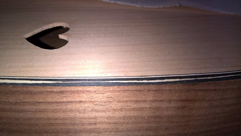

I've been making a couple of dulcimers with two young fellows and decided to try some black/white/black purfling as binding.
As you can see we left the binding a bit proud and sanded away the outer black in places.
We've managed to preserve the top edges so they still look ok from above.
I'm tempted to run a permanent marker around them before spraying but thought it wise to seek advice here first.
Any suggestions?

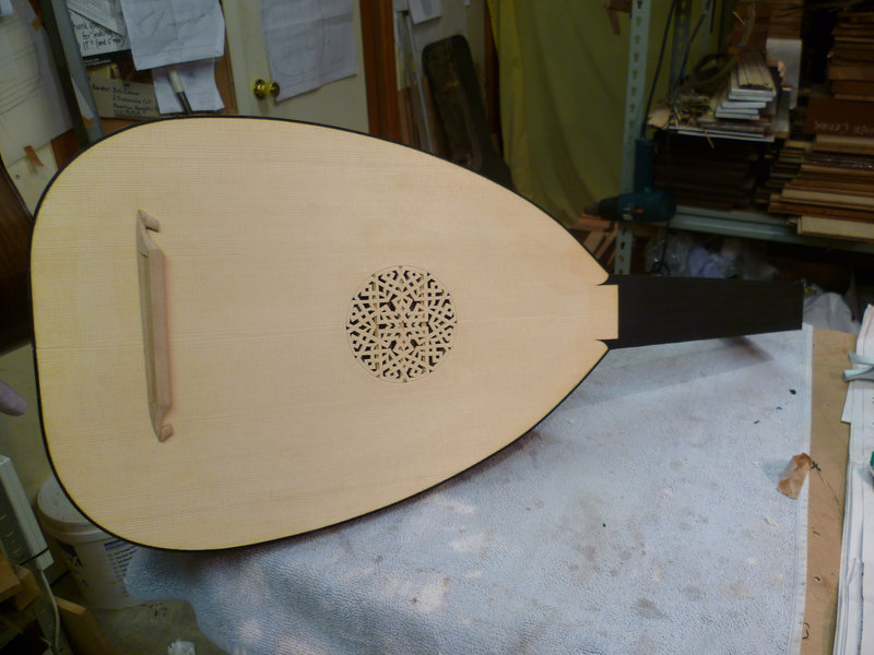

Here's the ebony half binding I used on my Gerber lute.
