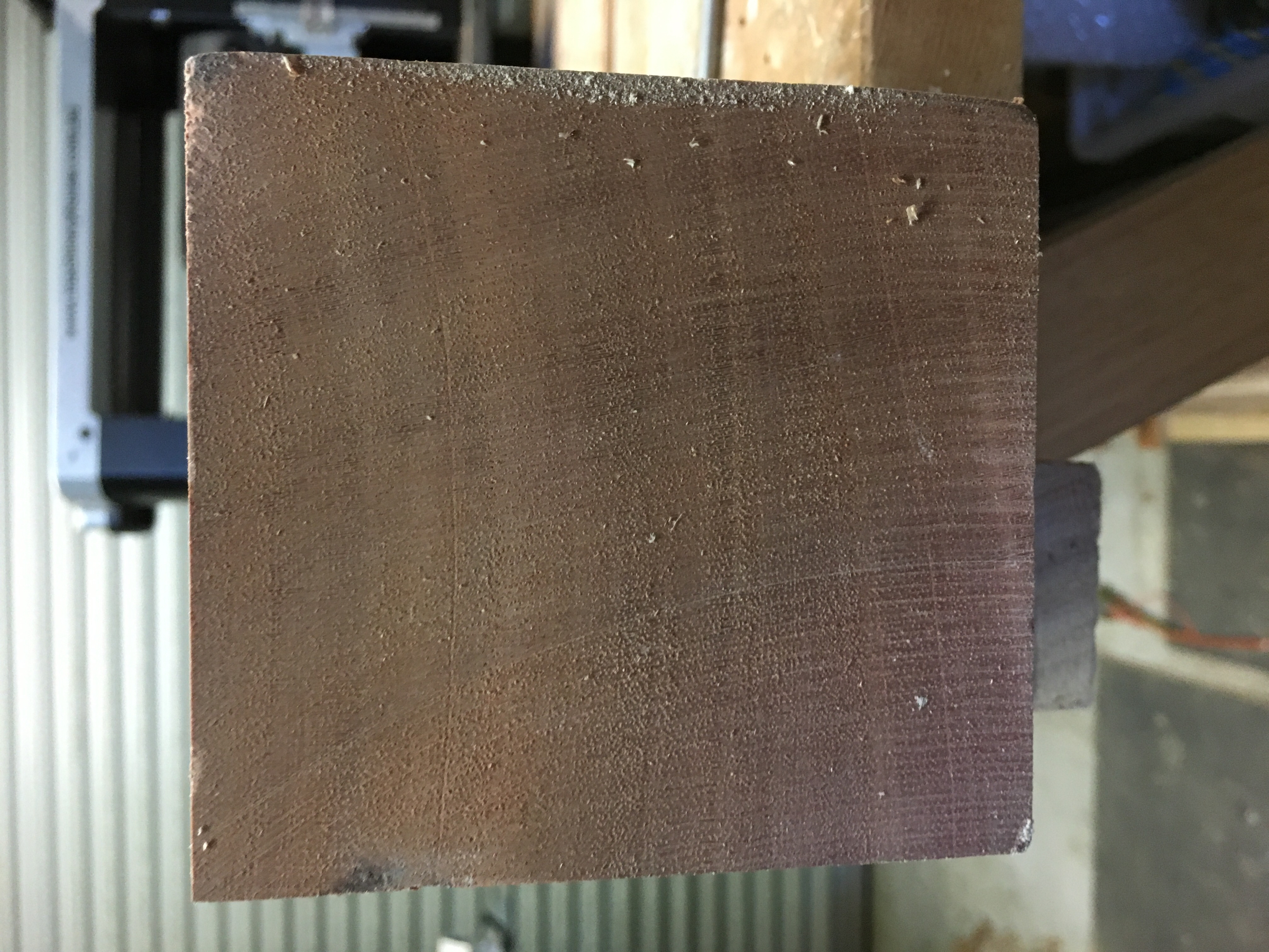

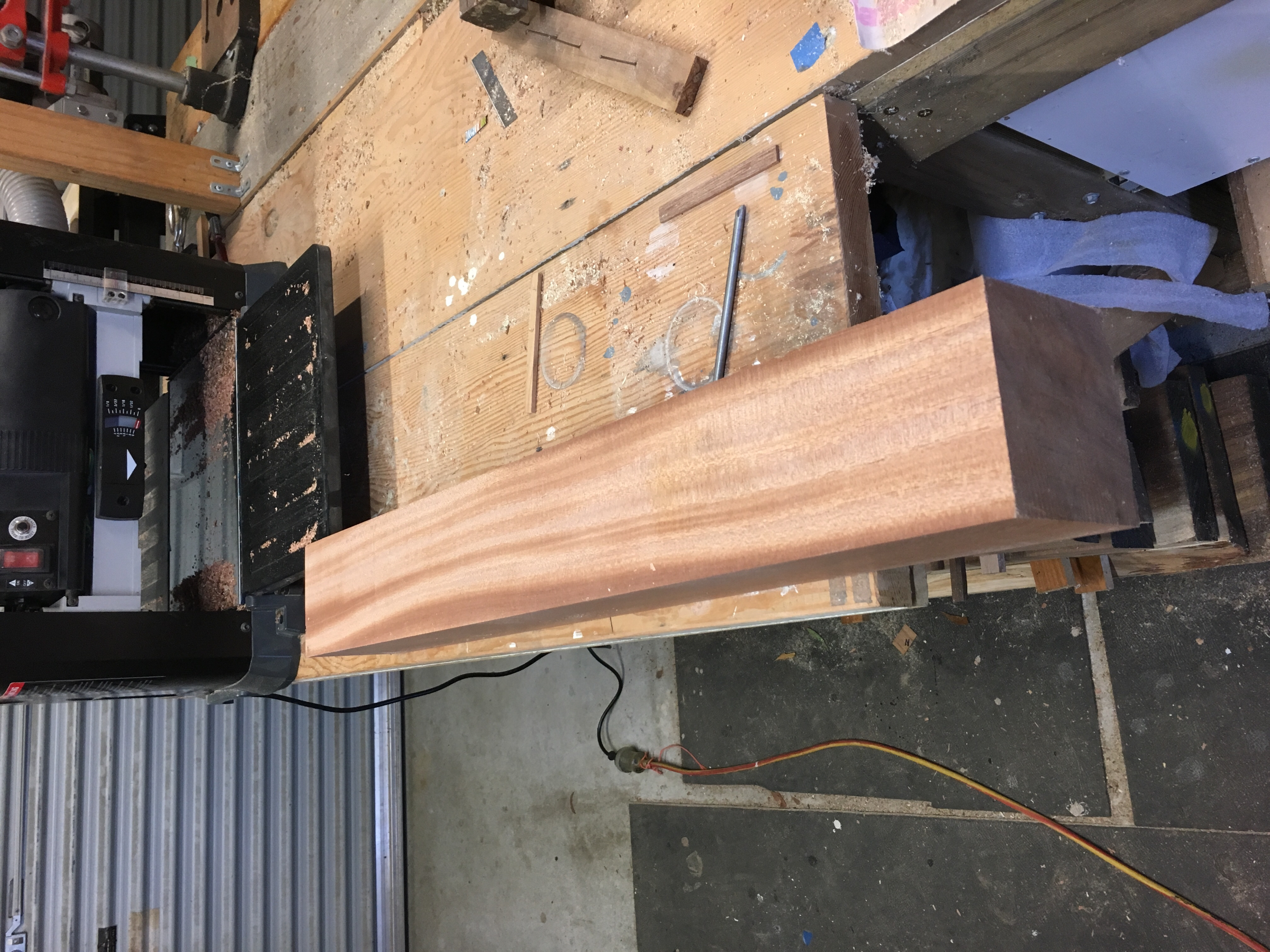

Surprise surprise, the free sample turned up today, although I haven't established the moisture content it seems pretty dry, much heavier than Figian.
Fairly quartered and clean, no blemishes so think I'll go ahead and order a few billets it will make some nice back and side sets and necks.
Check out the pics.

I was told 12-15% moisture is what they deliver at, so even though it may feel dry, it probably isn't usable for guitar purposes.rocket wrote: I haven't established the moisture content it seems pretty dry
I wonder if it's cut from the same trees as mine, as I received an email today that my order is ready and should be trucked next week.

???? if its not suitable for guitar purposes then why are we buying truck loads of the stuff??demonx wrote:I was told 12-15% moisture is what they deliver at, so even though it may feel dry, it probably isn't usable for guitar purposes.rocket wrote: I haven't established the moisture content it seems pretty dry

I buy a lot of green or partially dried timber and then store until it is ready to use.
At 15% and without "handling" it, I'd say one or two years of slow steady drying in storage and it'll be right to use.

Yep that's normal if you're buying ex mill timber, this stuff isn't being promoted as ready to use guitar sets but as recently milled timber that may be suitable for instrument making, the customer, and in this case luthier will need to assess moisture content, resaw billets to desired sizes and sticker for whatever period necessary prior to putting to use.
