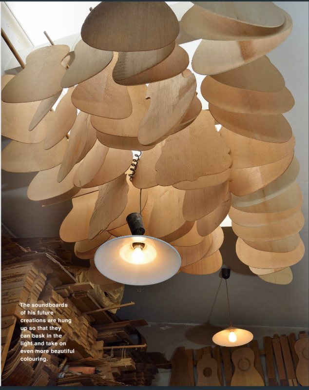

Here is a pic of Marcelino Lopez Nieto's workshop with tops hanging under a skylight.
Last year I saw one of his guitars ( spruce top ) it was brand new and I could not believe it.
The patina on the top looked like it was at least 50 years old.
Now whether this stiffens the top is a different question.
Credit for photo goes to Orfeo Magazine #3 Pg.55

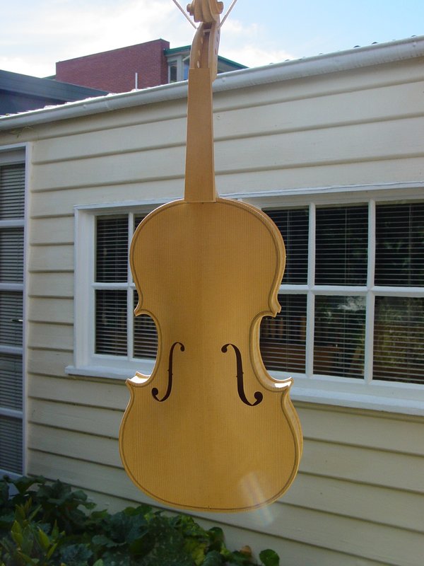

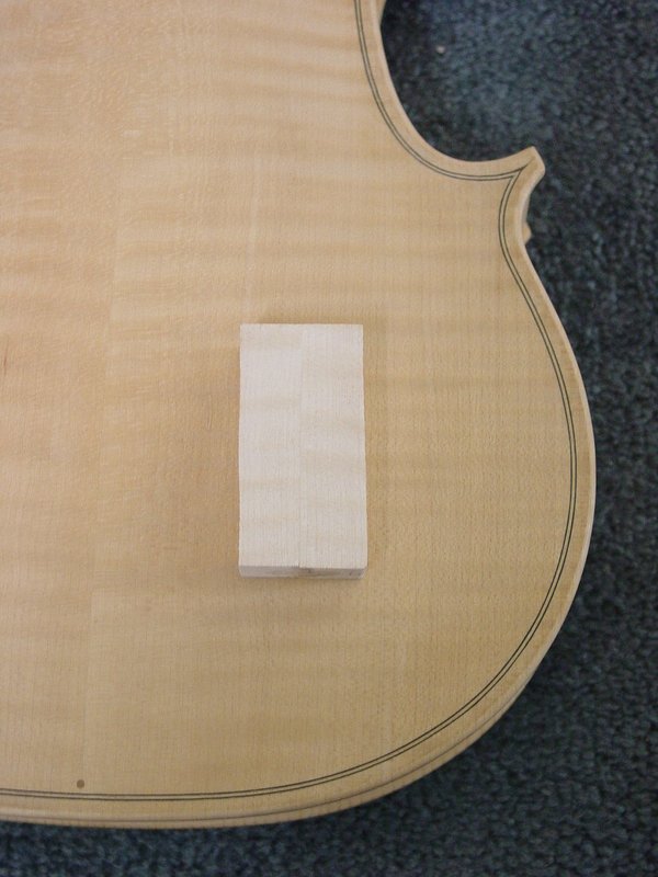

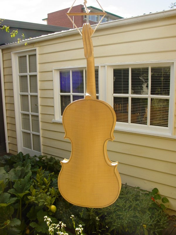

A couple of pictures of a violin I made a some years ago. I hung it out in the Hobart sun for a few days, purely to get some colour. The last picture shows the contrast between the tanned back and an untanned offcut from the same piece of maple. Quite a difference after only a few hours in the sun. This is commonly done by violin makers, largely to provide a more golden ground for the varnish. Whether it improves the sound of the violin is debateable, but it certainly appears to do it no harm.
