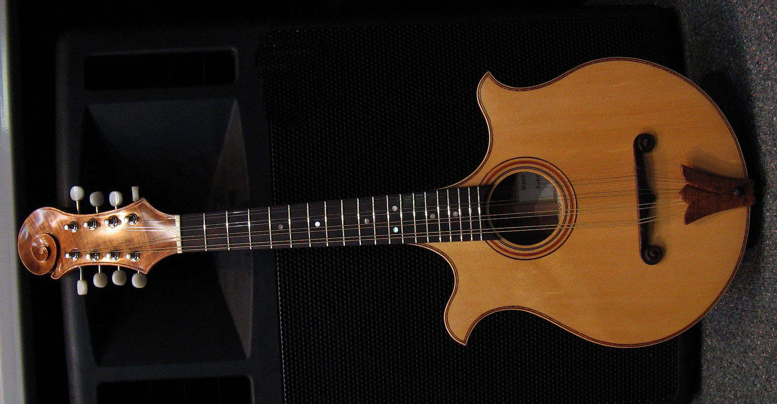

A few years back at a festival, Bob had a mando on show that was really just like a miniature cutaway arch top
, always stuck in my mind how nice it looked so since Bob has offered his pattern and specs for that i think i'll build that one, and an F style along side .
There now that should keep me quiet for a bit!

Keeping with the theme Mr Rocket here is my take on the F style Mando going back 10 years ,( how time flies ) thought I would have some fun with the head stock and tail piece who knows where it is now fire wood I guess .

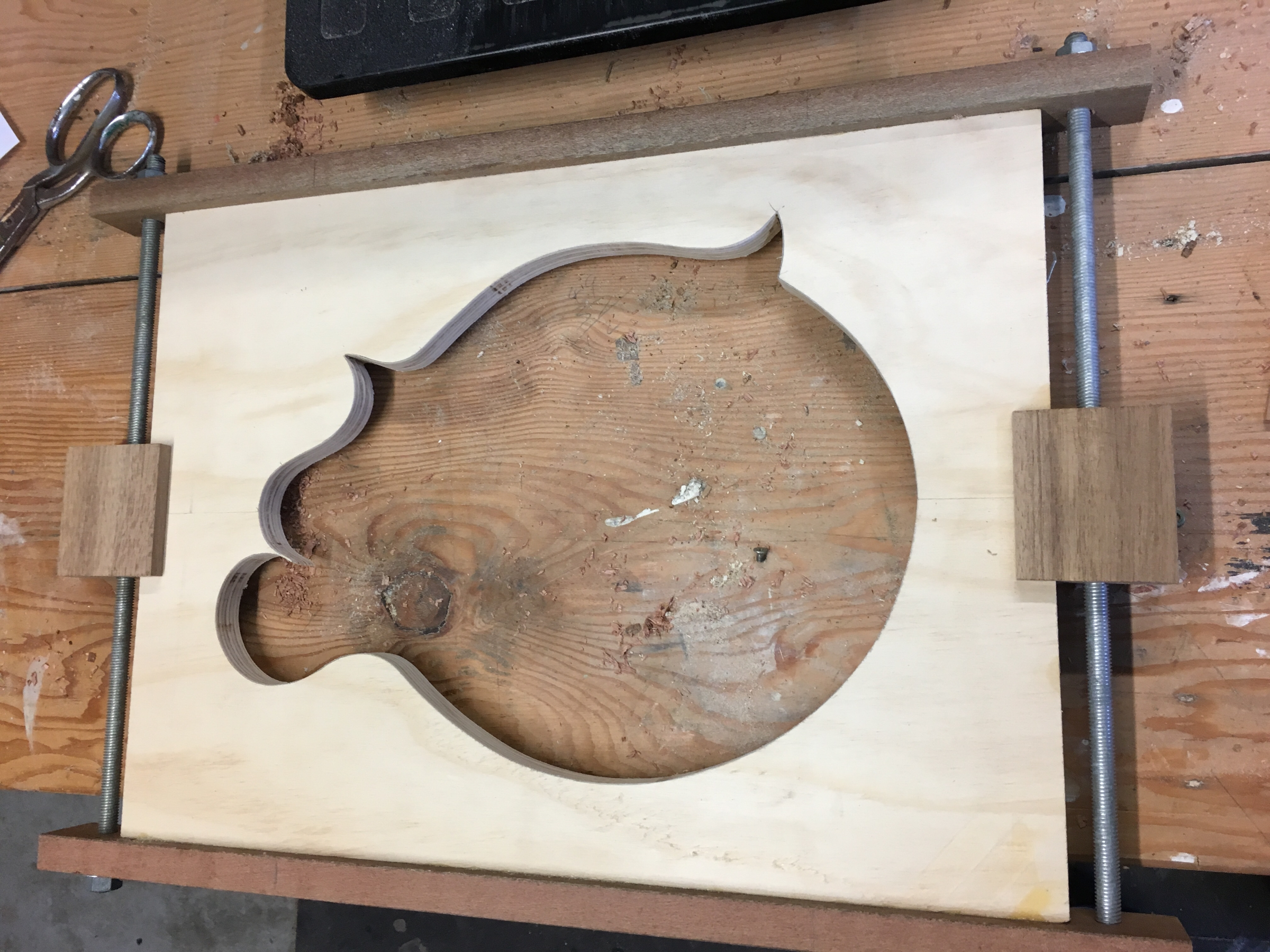

So far I've got the mould together for the F5, this will have maple back and sides , Sitka top and maple neck.

I like the mini guitar shape

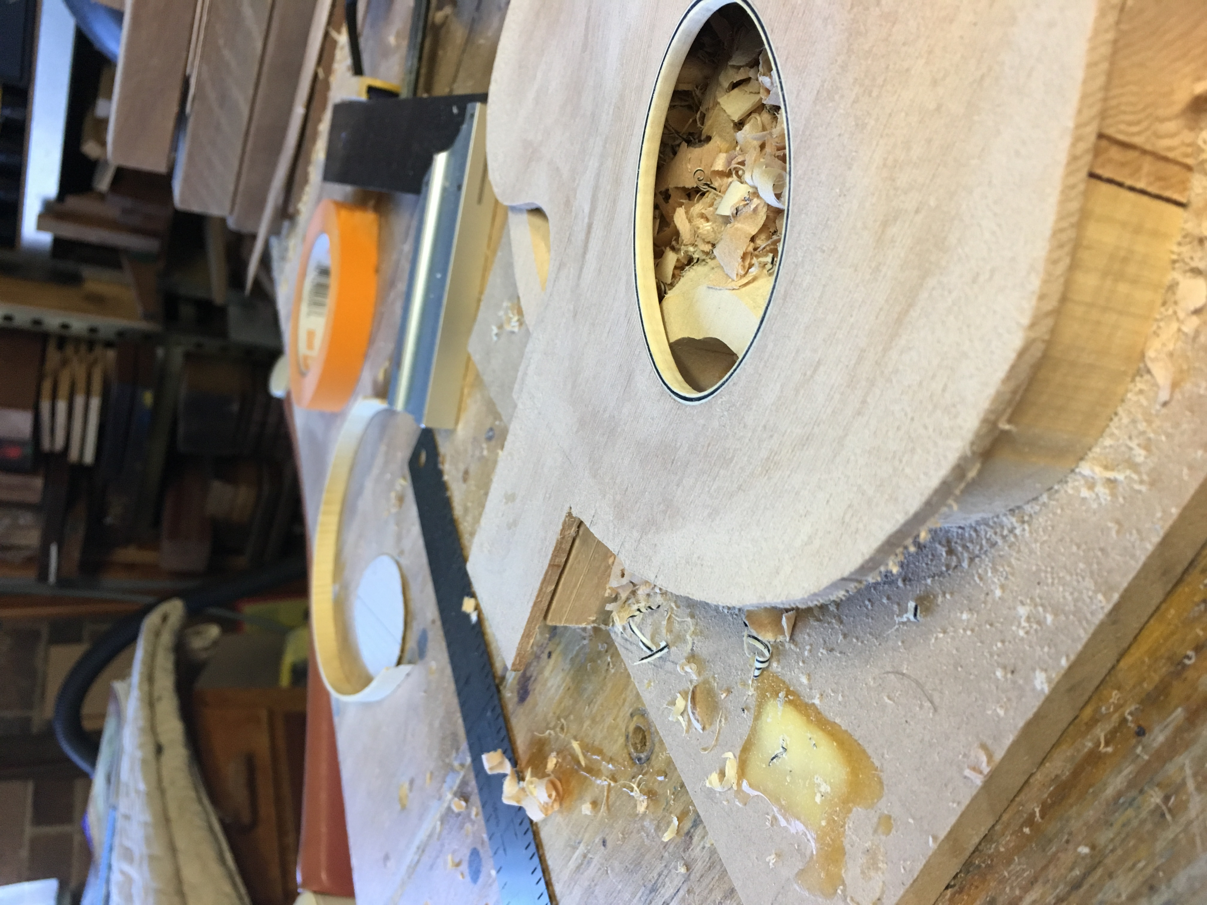

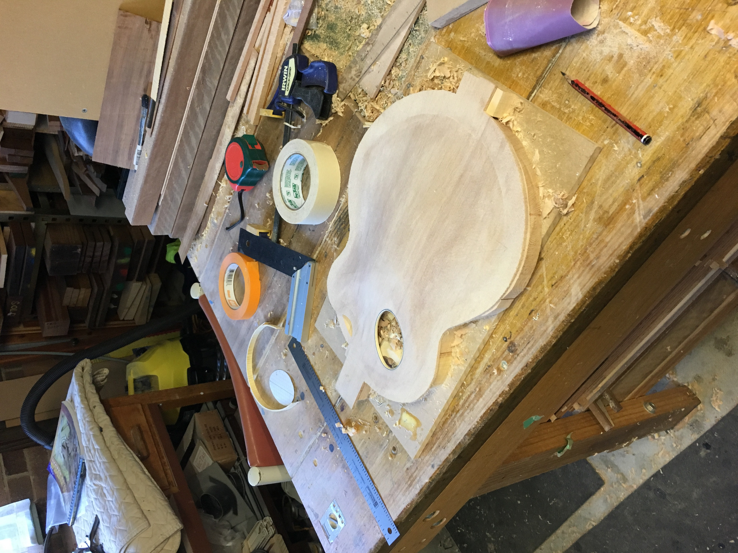

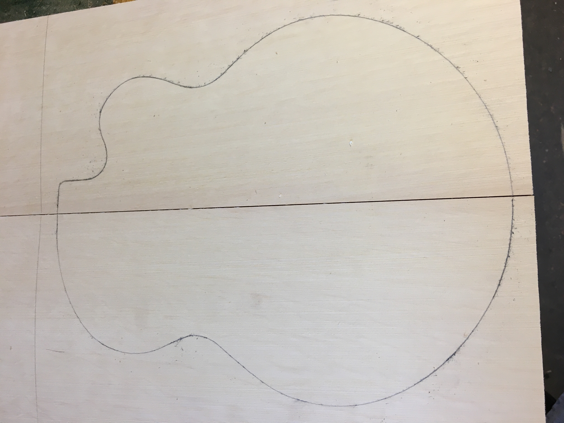

I stuffed the arching up on the Huon pine top so I've selected some Sitka I had on hand,just fitting the bracing at the moment but here's some pics of the arched top.

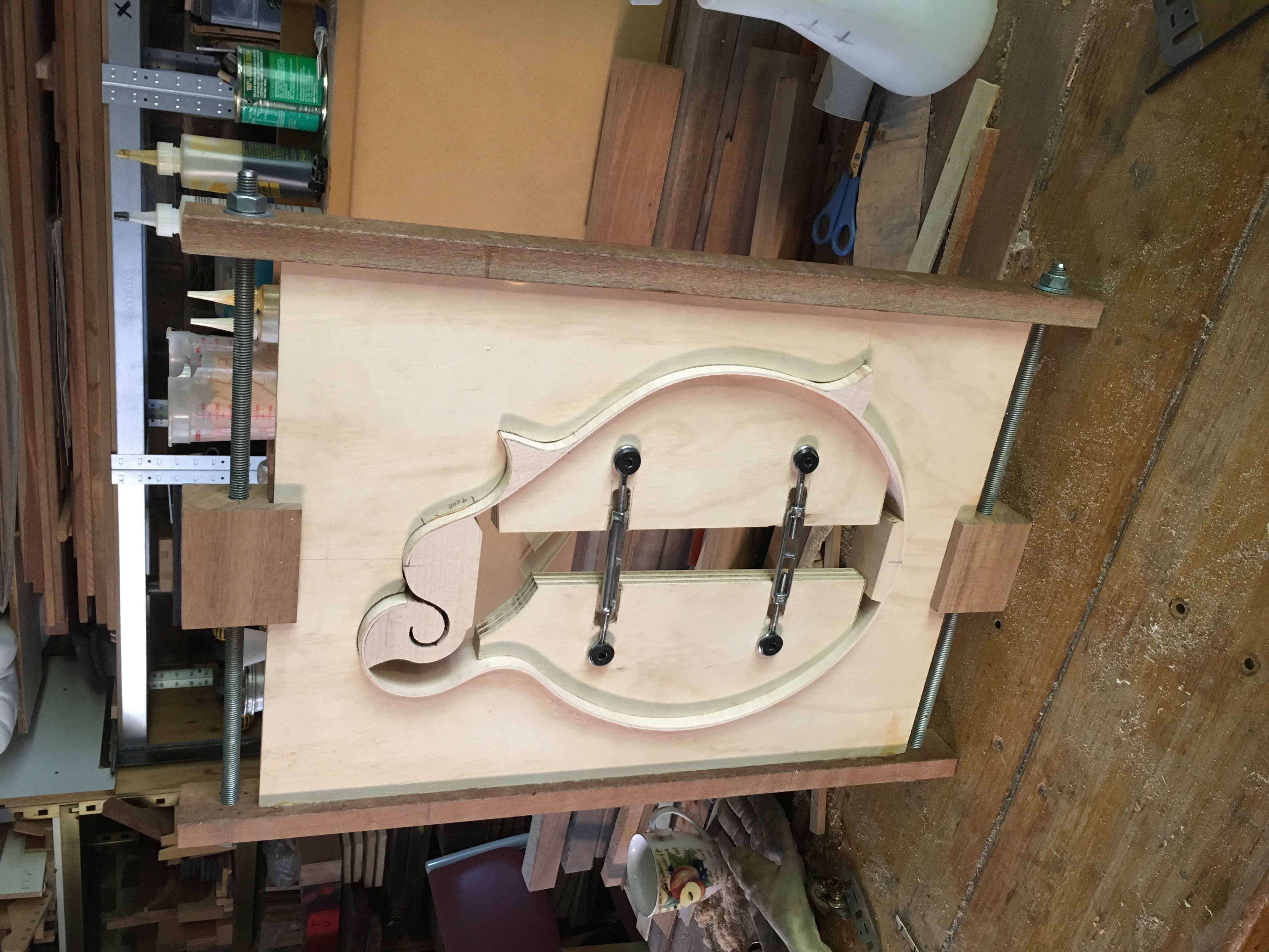

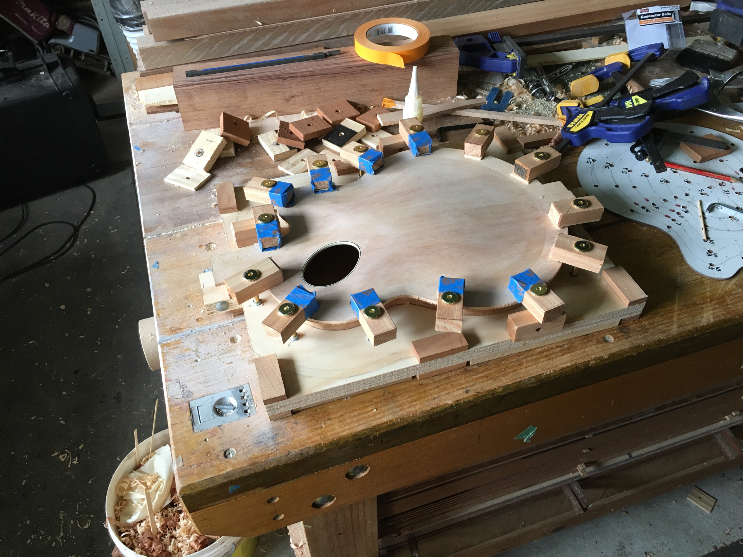

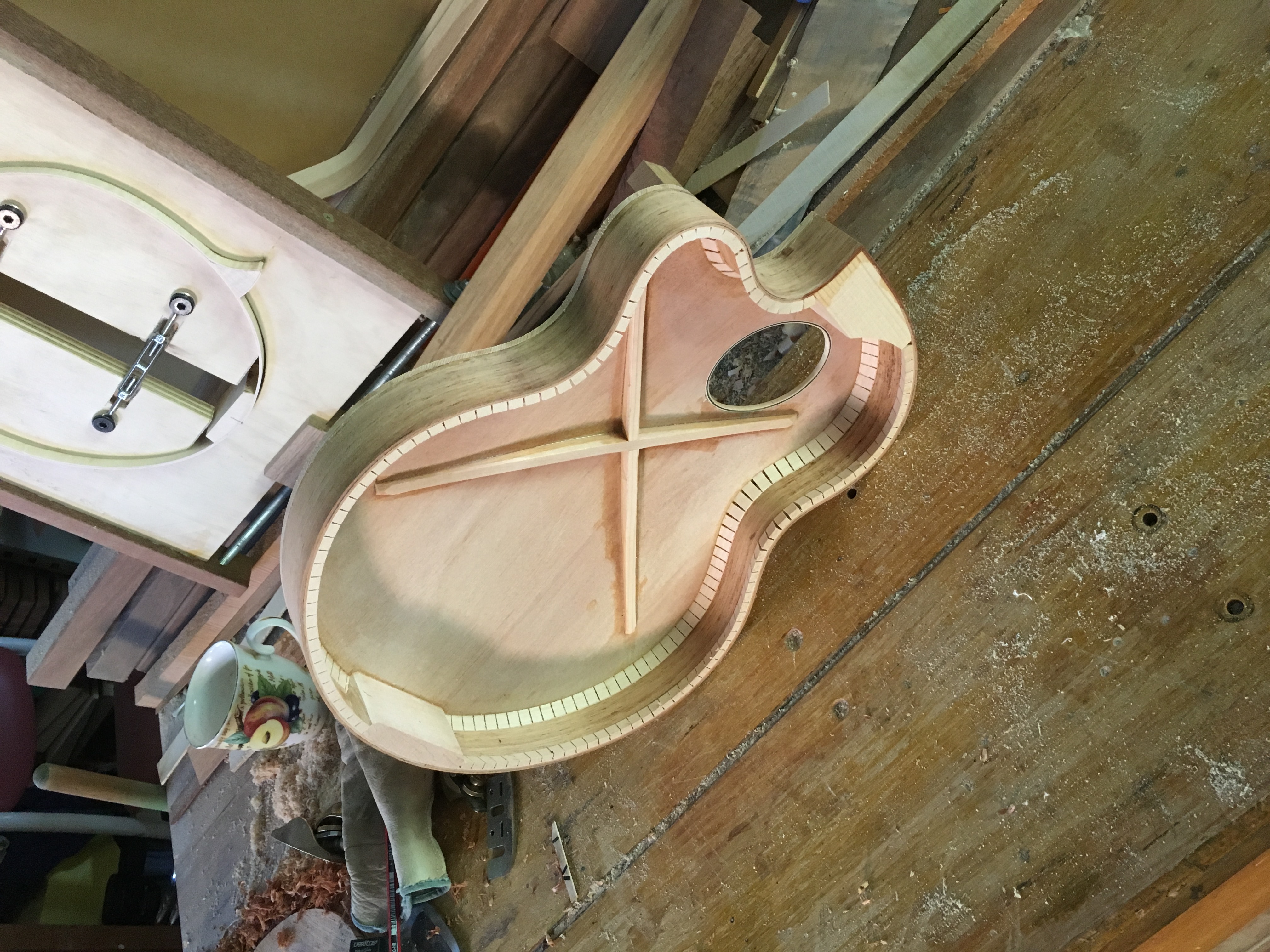

Got the sides in the mould and the top brac d and glued

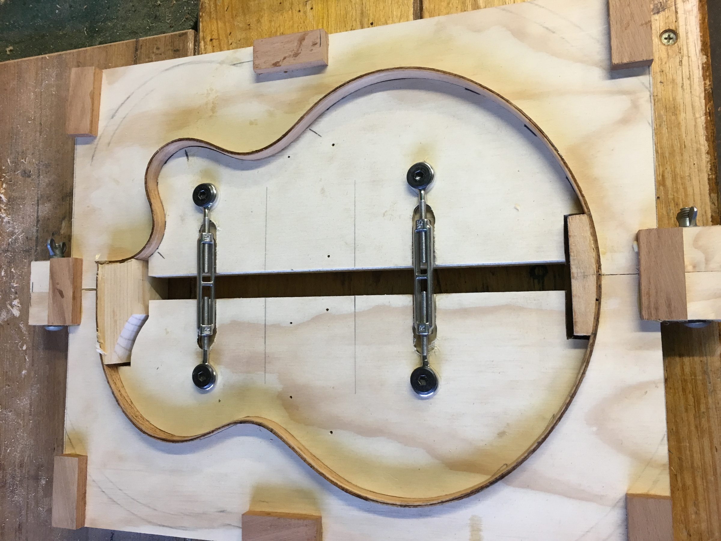

Back set ready to glue up

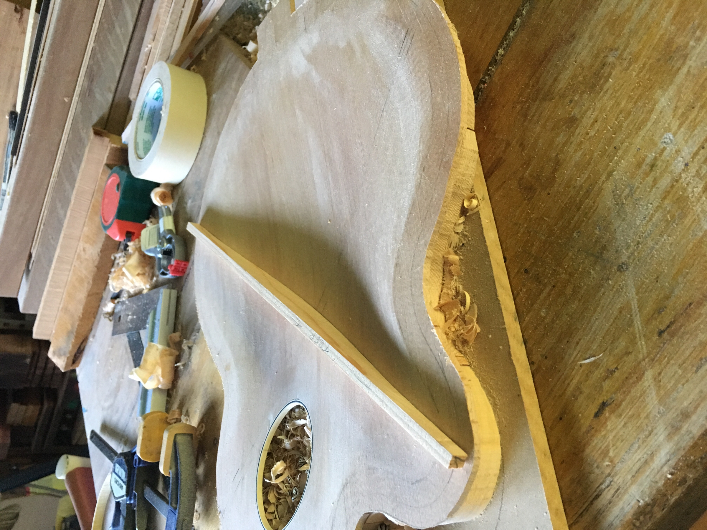

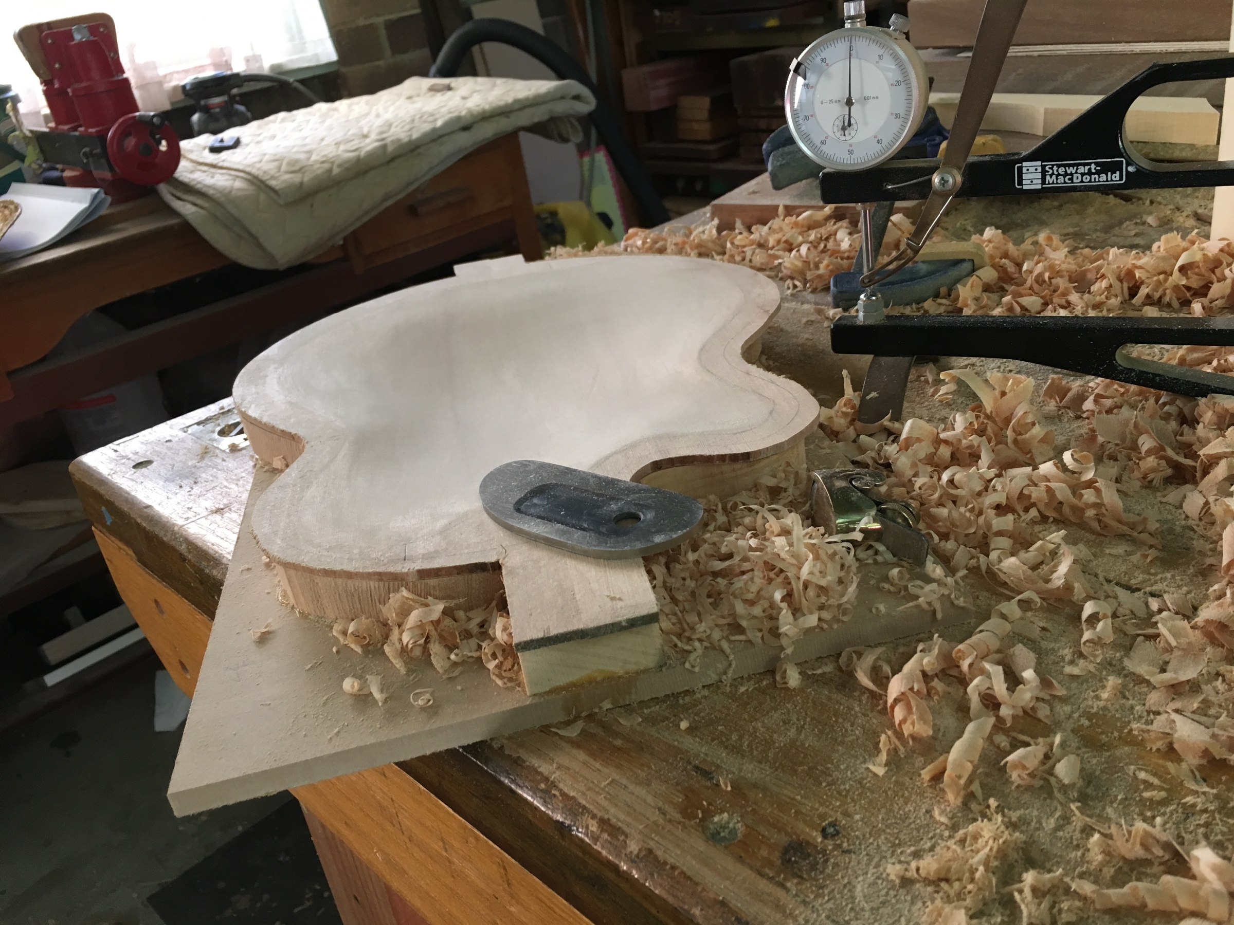

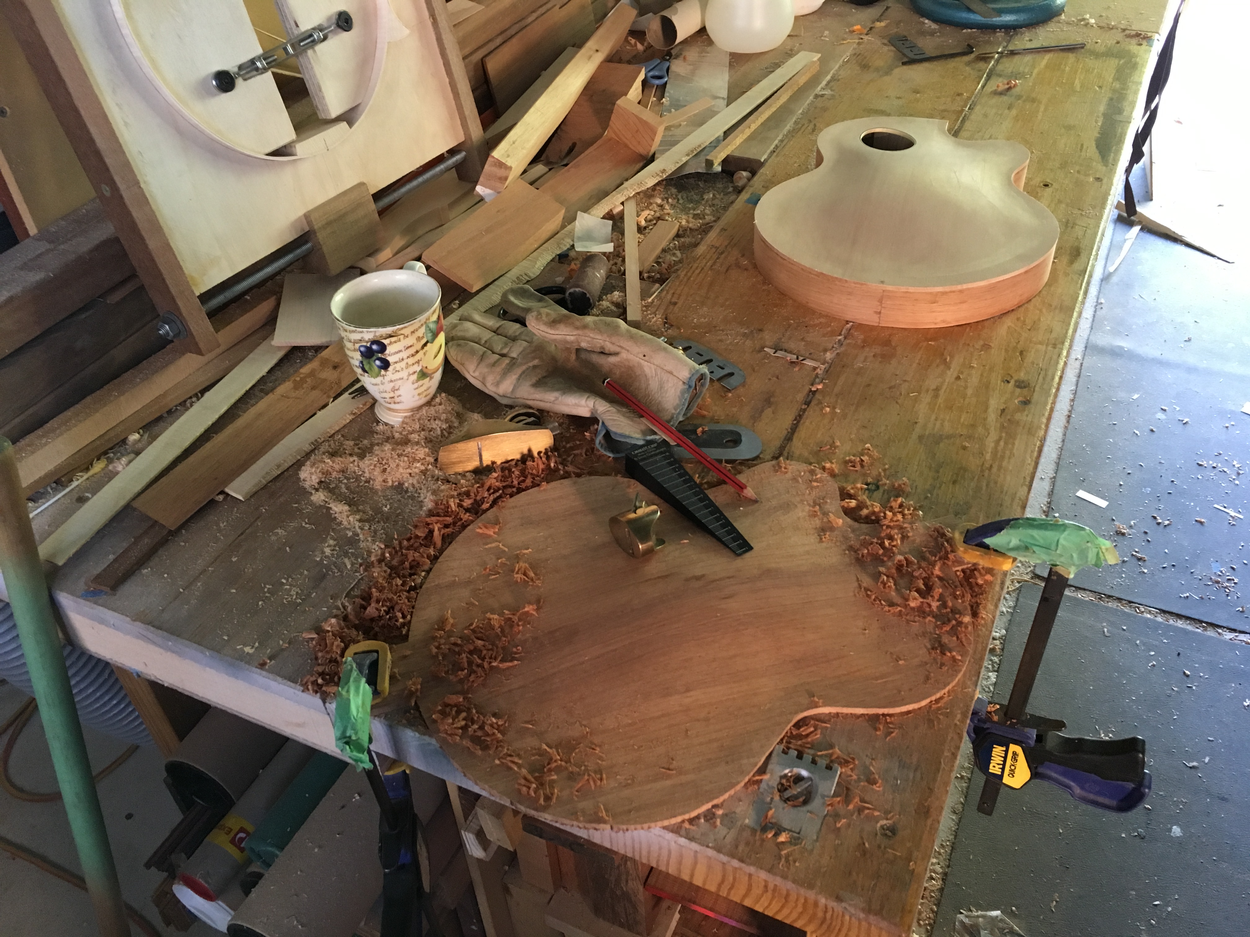

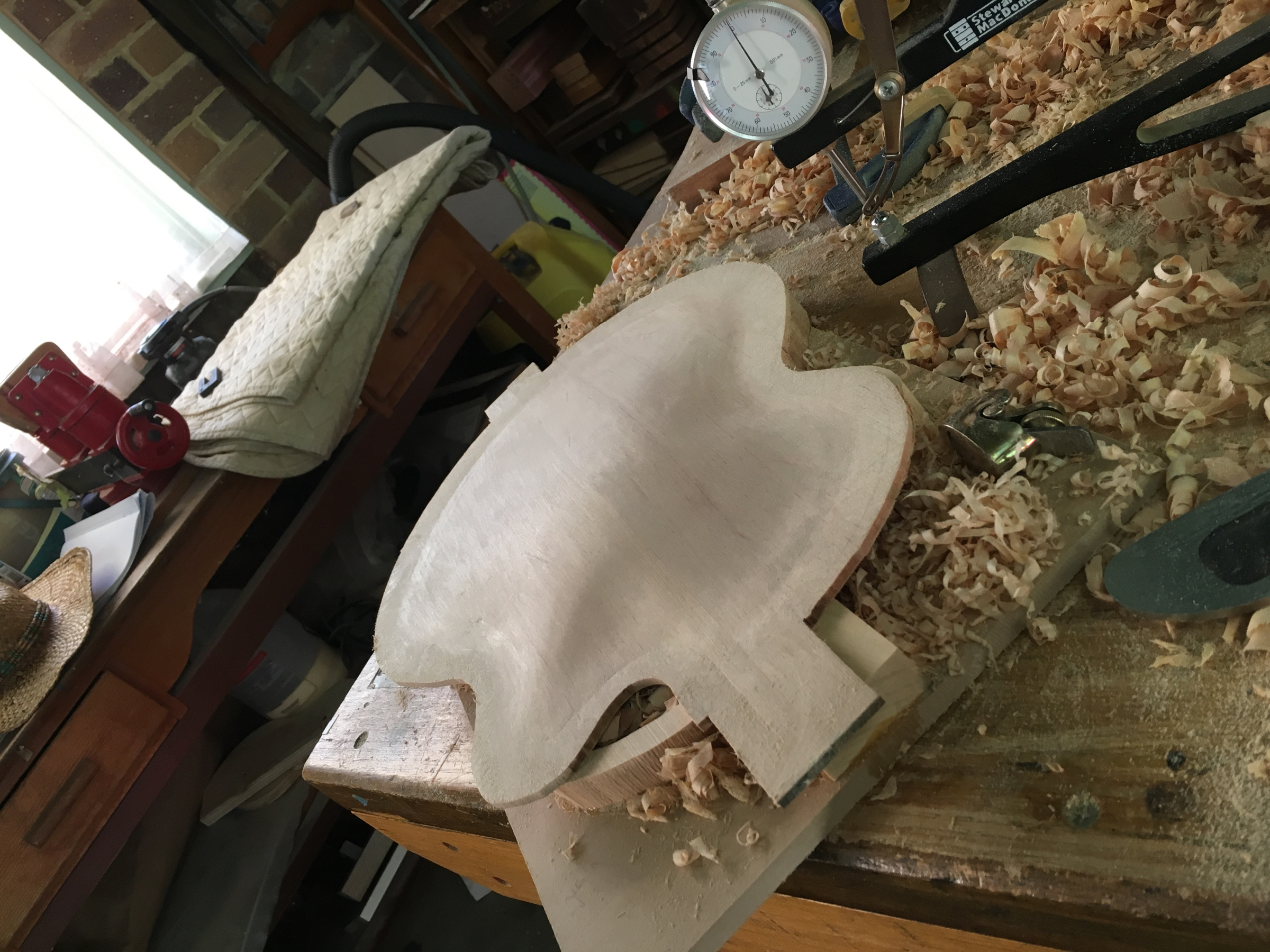

Got the top on the A and carving the back,started the F, pulling my hair out fitting the blocks but got there .
