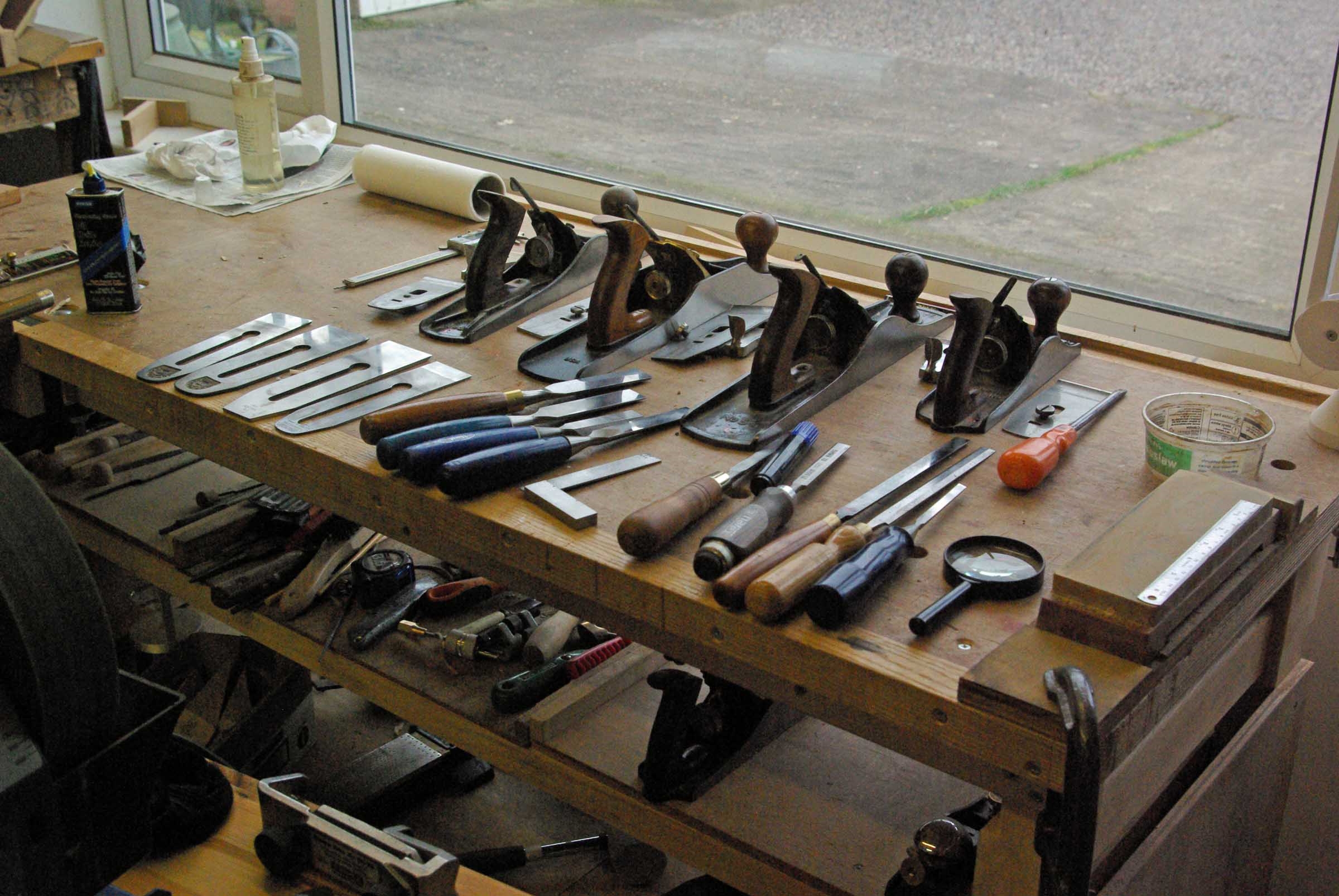

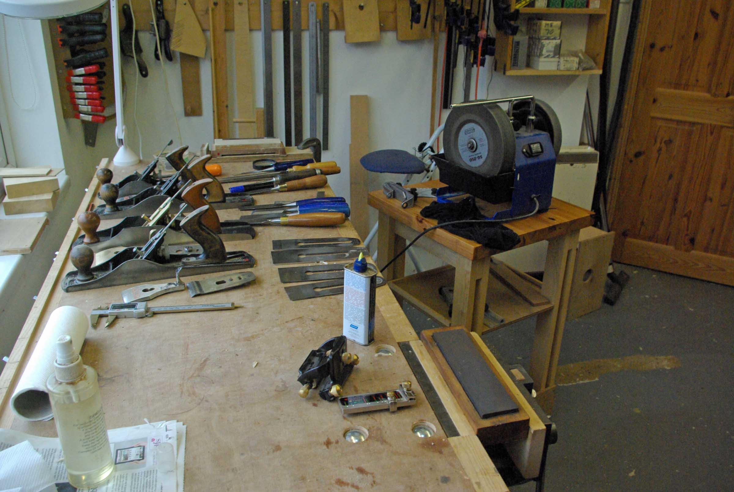

Well today was sharpening day.
I much prefer not to have to break off in the middle of a project to sharpen tools so I tend to have multiple chisels and planes of similar size. In between I really go for it and sharpen everything as well as I can. I even did all my scrapers yesterday which seemed to take forever honing the edges square and smooth before turning a burr.
I do have the posh Veritas honing guide which I use for plane blades but the simple Eclipse works fine as well and is much quicker to set. I have forked out the outrageous price for the well known water cooled grindstone, then with only a tiny bevel to hone use a traditional oil stone followed by a seriously fine waterstone both of which take only a very few strokes to give the edge.
Spraying with Camelia oil as a protective rather than WD 40 or whatever seems such a nicer way to go - and it is claimed will not stain the timber.
I wonder how others tackle this job? Can one simply rely on diamond plates...?

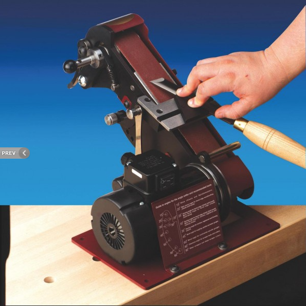

I bought the Robert Sorby Pro Edge sharpener a year ago and wouldn't give it up for anything after just one use. Incredibly easy and quick to put a razor edge. There are a few different grit belts that you change in seconds. I give everything a light strop wtih green compound after the honing pass with the 3000 grit belt.
I nicked this picture off of their website.
