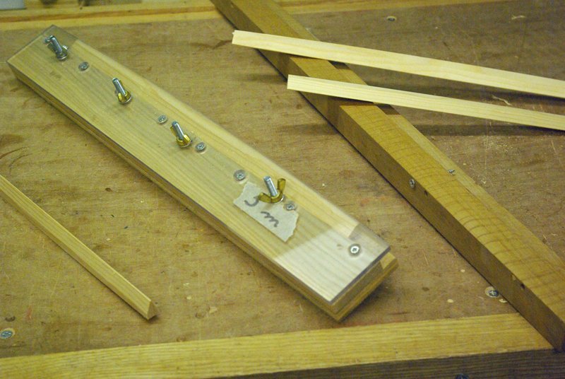

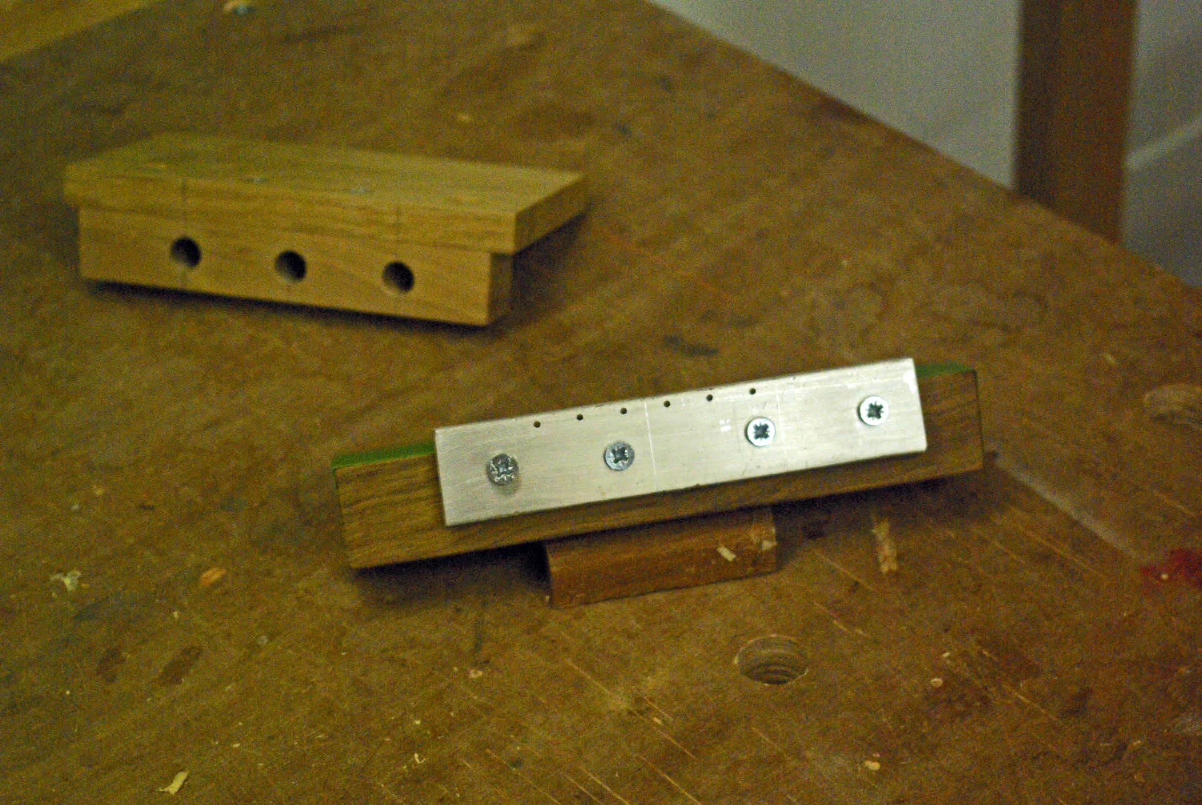

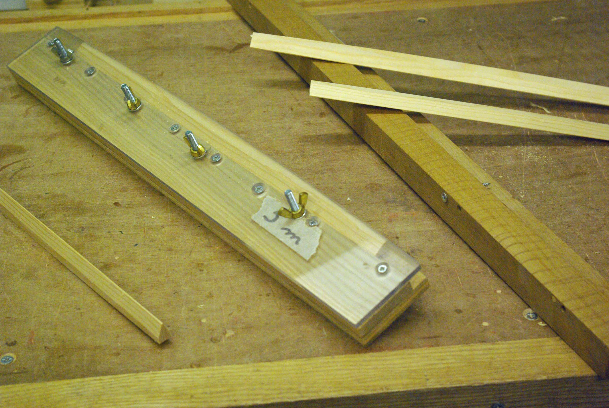

My first build was a classical with essentially no jigs other than the Solera, and it came out sort of all right. It looked like a guitar, sounded like one, but was certainly not true to the original design and was pretty rough round the edges. (Obviously this would be true in general for a first build)
But today I was making back braces for my new build and was so chuffed that a year or so ago I created a couple of jigs. First a support for carrying the brace blank so as to use a bevel cutter in the router table to create the tapers of the upper part of the brace, and second the gripping device with curved template for producing the bottom curve to fit the doming of the back. (These happen to be to GG's design but other brands are available).
Anyway I was so pleased that the not inconsiderable effort that went into, particularly the second of these, has repaid itself. I have been able to shape these braces cleanly and accurately in a very short time compared to hand methods.
The other jigs pictured while less exciting are for drilling the bridge string holes and the classical tuner roller holes. Maybe not exciting but essential for accuracy.
So I guess what I'm saying is that even for someone like me who is unlikely to be making tens of guitars it really is worth putting a fair effort into jigs to both improve accuracy and to speed things up.
