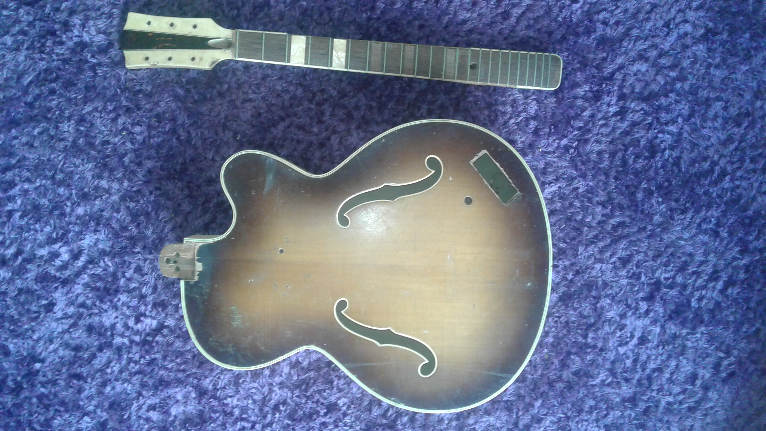

I was given this Hofner arch top recently
What I'd like to know is how to remove the heel without damaging the rib/front block glue. The varnish around the heel has been sanded of so I'm a bit loth to use a steamer.

Why do you want to remove the heel block? Is it damaged? Can you post up a side view of the heel?
Re: broken old hofner

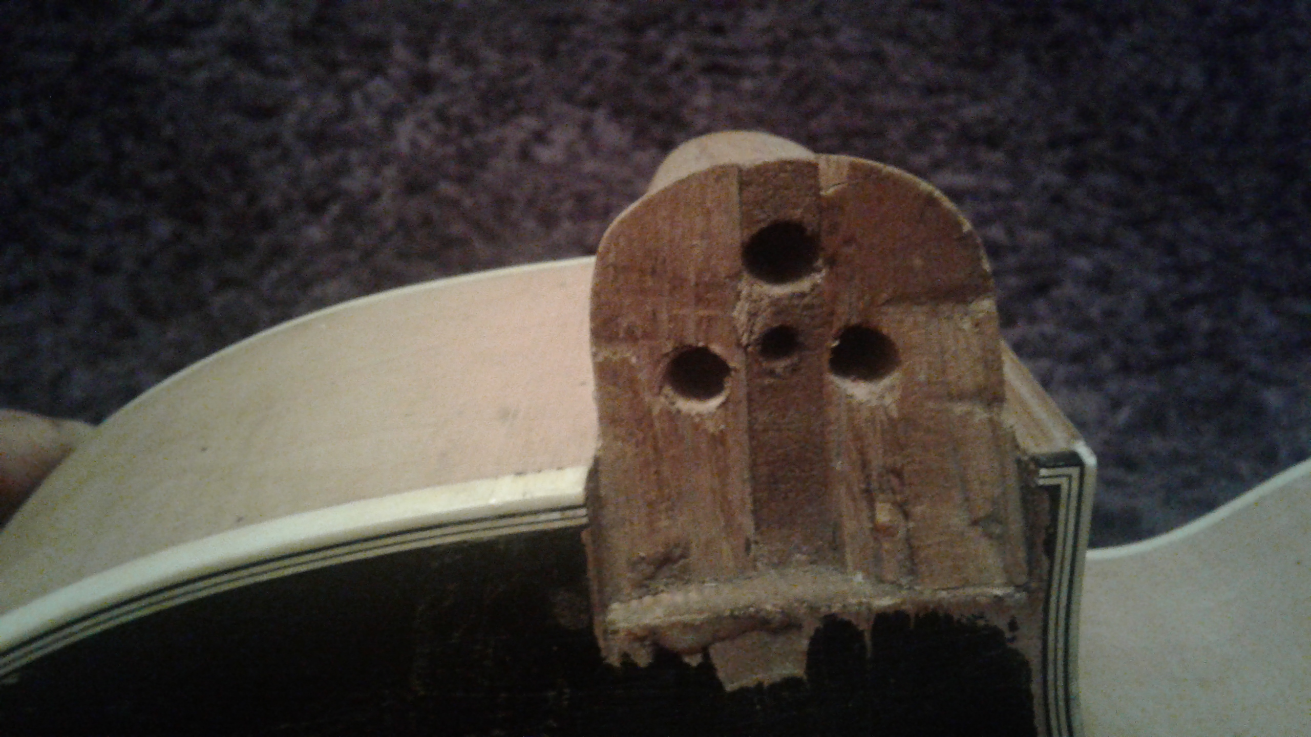

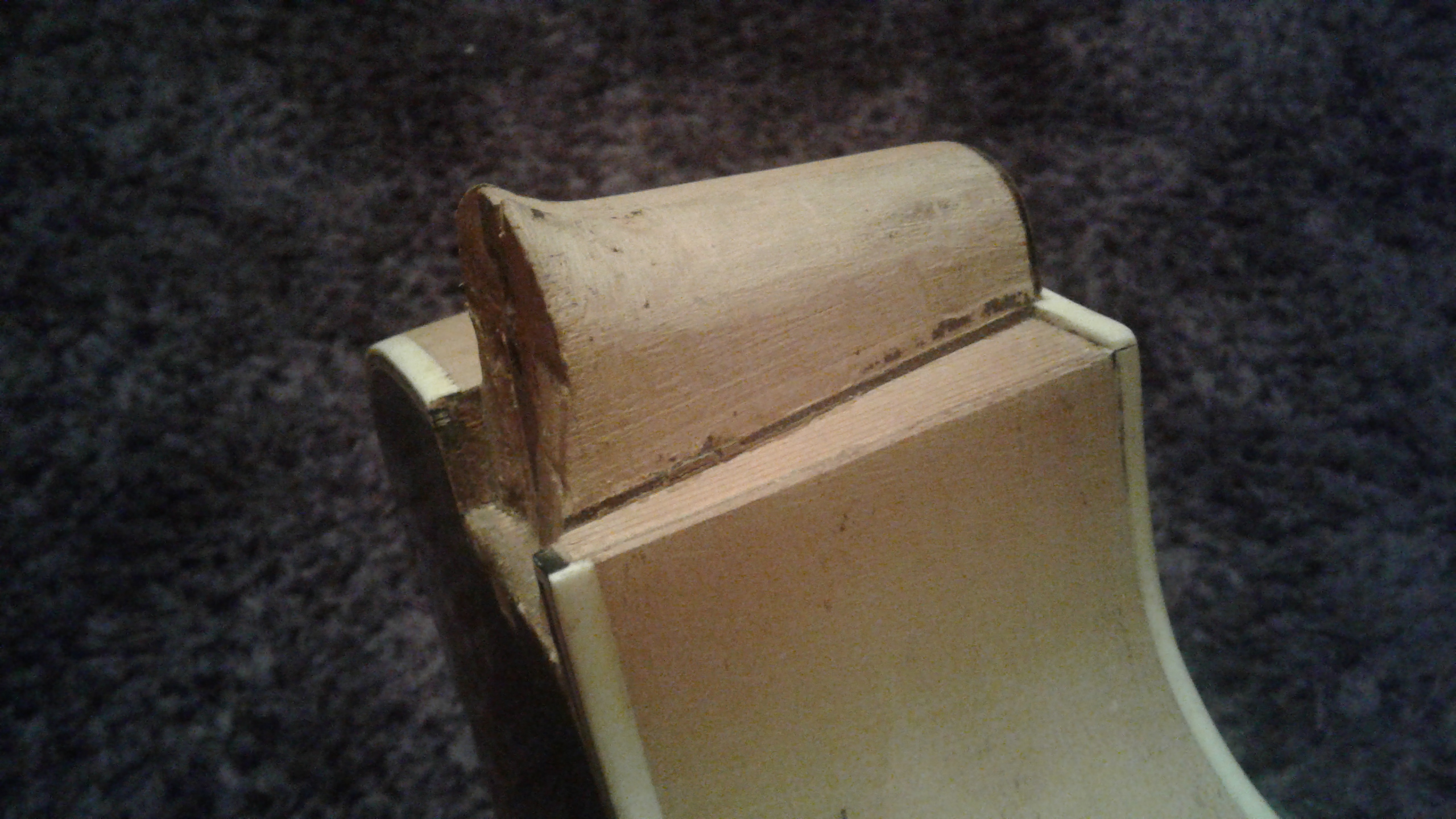

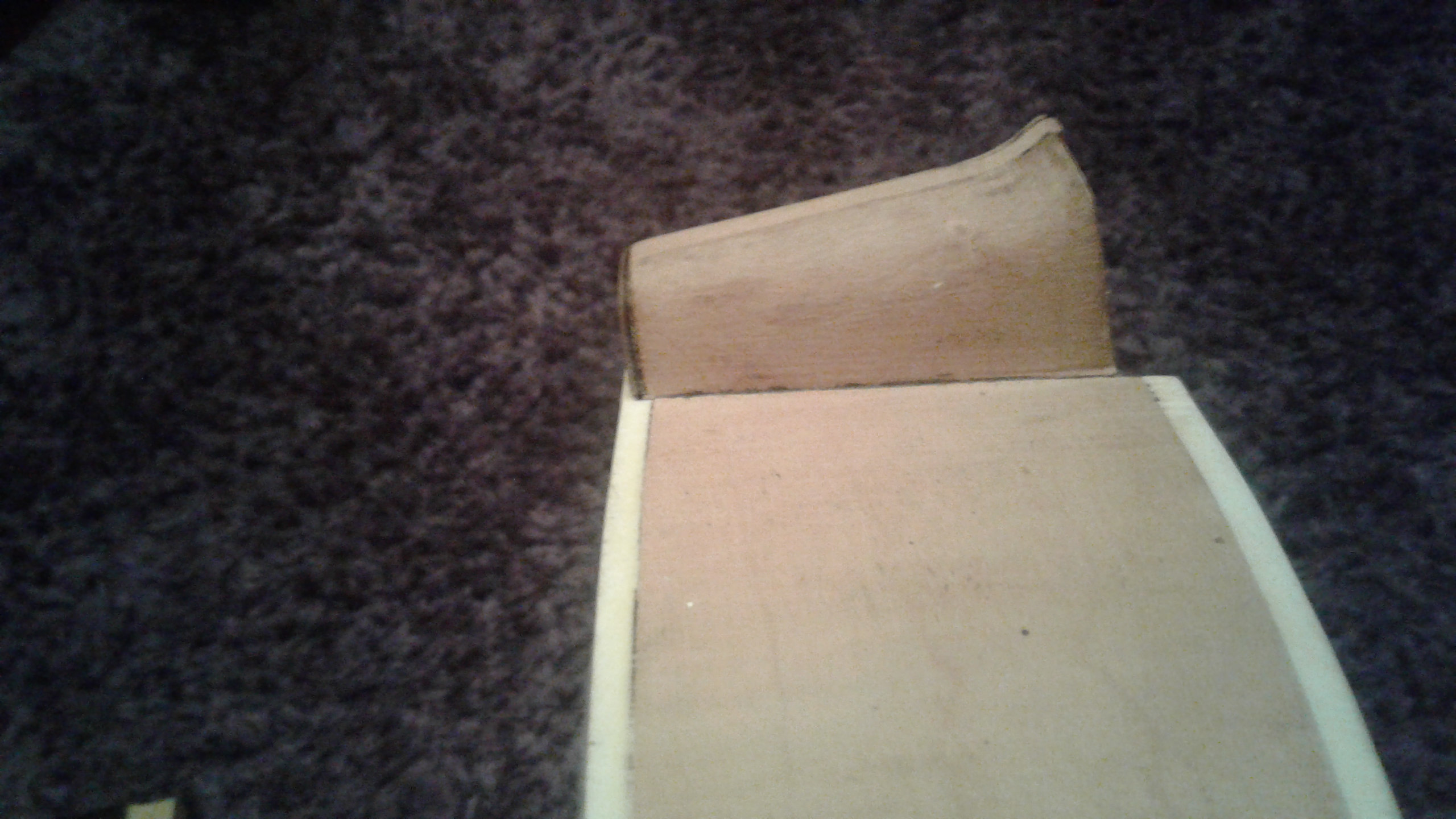

My mistake. I want to get the heel out of the block.

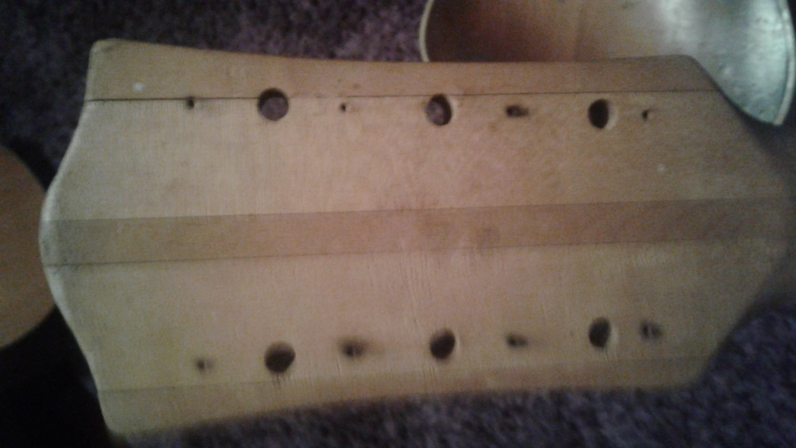

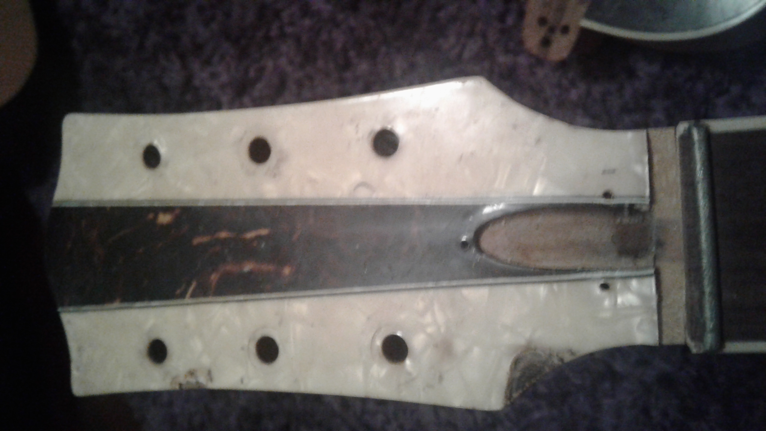

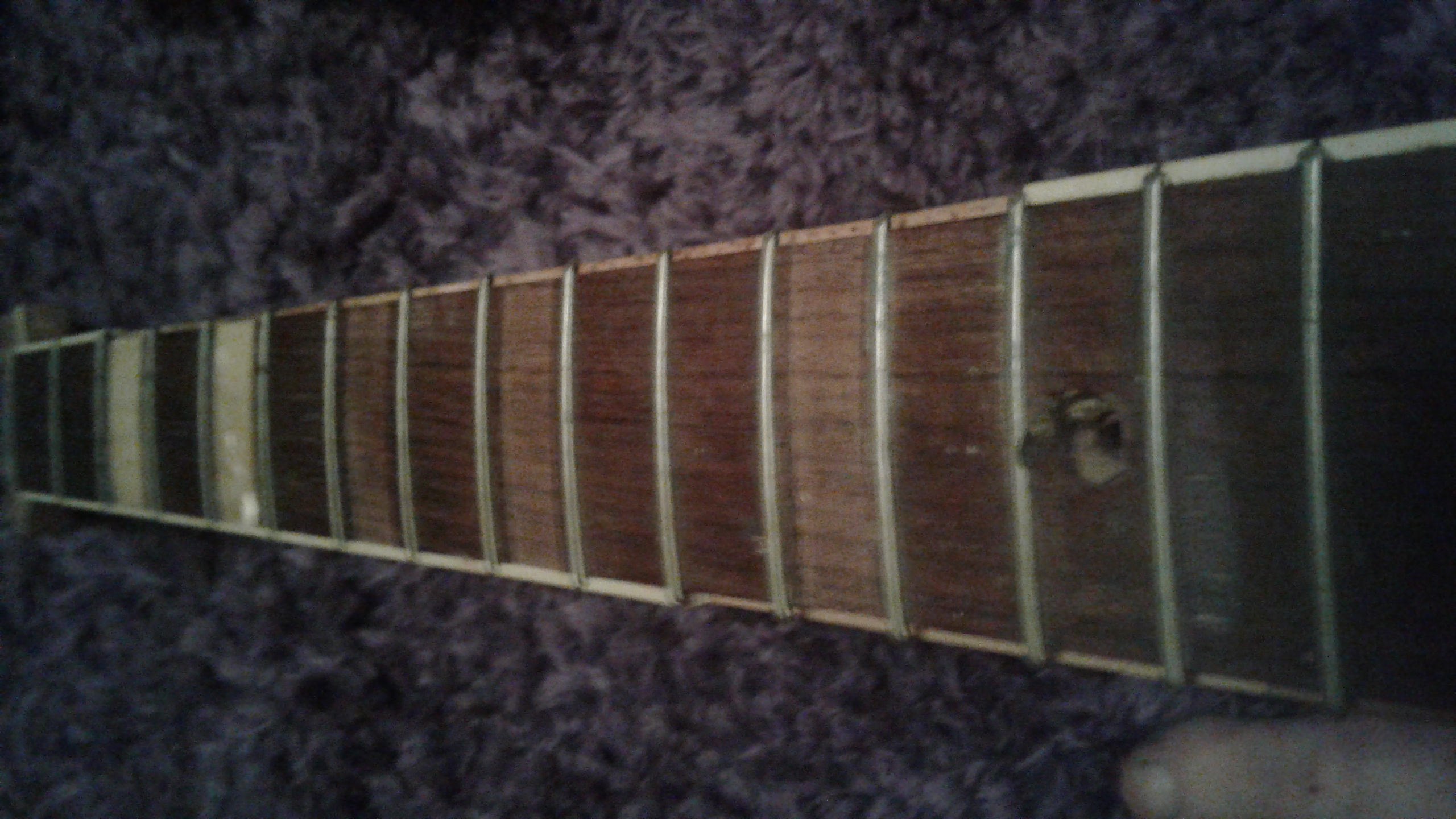

One of 5heu previous owners has had on go at doweling the neck back on. 3 dowels plus a screw through fretboard. Also the neck is in a bad way,the truss rod has rusted up and the head is delamination. I was going to make a new neck, but I'm open to suggestions on that.
The dowels were actually hofners idea of manufacturing. Very common to find two dowel holes on these.
The screw is clearly someone else's idea of a repair.
Seen many of these broken over the years.

Why remove the heel if it's solid or you intend to remake a new neck.
Good clean surface, some hide glue ideally, titebond if hide glue not available or comfortable with its use.
Then re-align and clamp up.
If you intend to remove regardless then just steam the glue to work the broken section out.
I have even removed sections of a broken hofner heel in situ to attach a new section of wood and create a flat glue shelf for the neck.

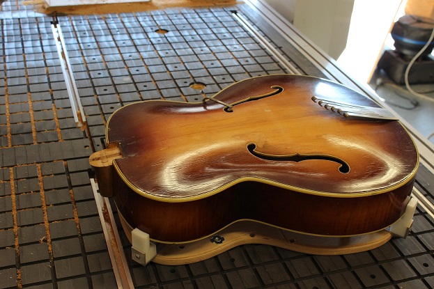

This one had numerous other neck repairs done, all of which had failed, so when it came to me, I decided to remove the middle section and graft a new piece in, did not even pull the heel on this one as the fit was good, clearly when it was finished that shelf was shaped and coloured
Another broken one
This is the first one being jigged up to flat machine a shelf to attach the wood too
And another broken one, getting an insert fitted
Internals of the hofners

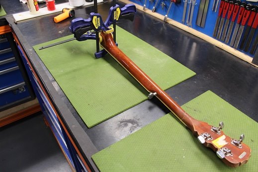

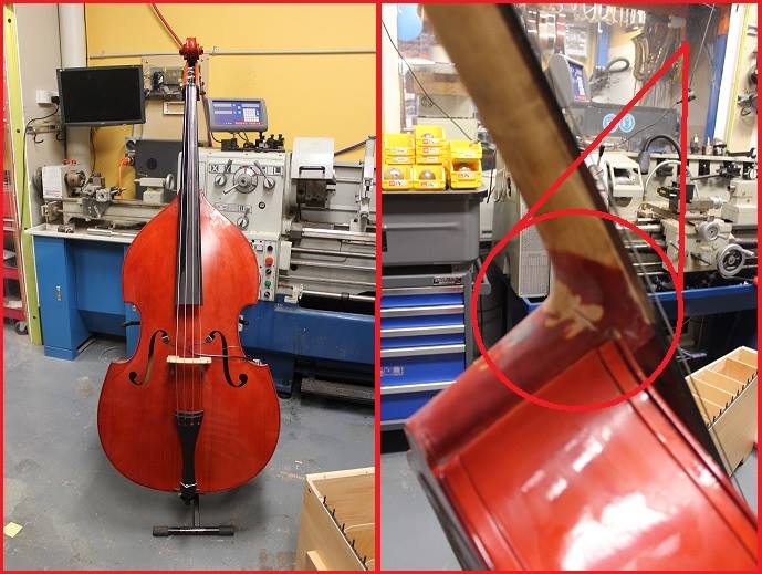

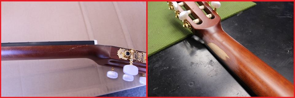

Some of today's repairs, not finished but prepped for Friday painting schedule.
One of them is a banjo heel similar to yours, I just made sure both surfaces were perfectly clean and mated together neatly and used titebond for the repair.
The dbl bass neck I used hide glue to put the neck back on as it's pretty weak joint.
The face plant break I used titebond.
The splines for the ovation I used fish glue as the customer wants a visible clear coat, not hidden
