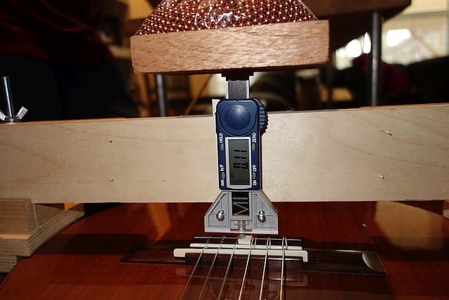

The monopole mobility rig went hi-tech, too, when we found we didn't have the right sensitivity in a dial gauge. This is a string height gauge, but I would guess many types of digital depth gauge would suffice.
