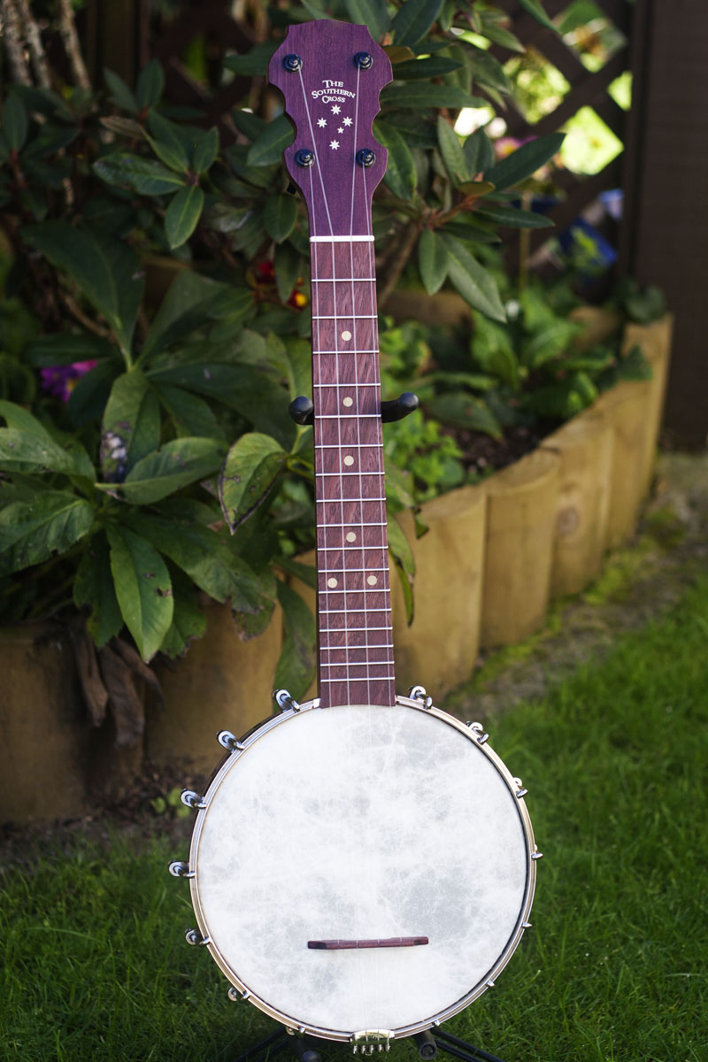

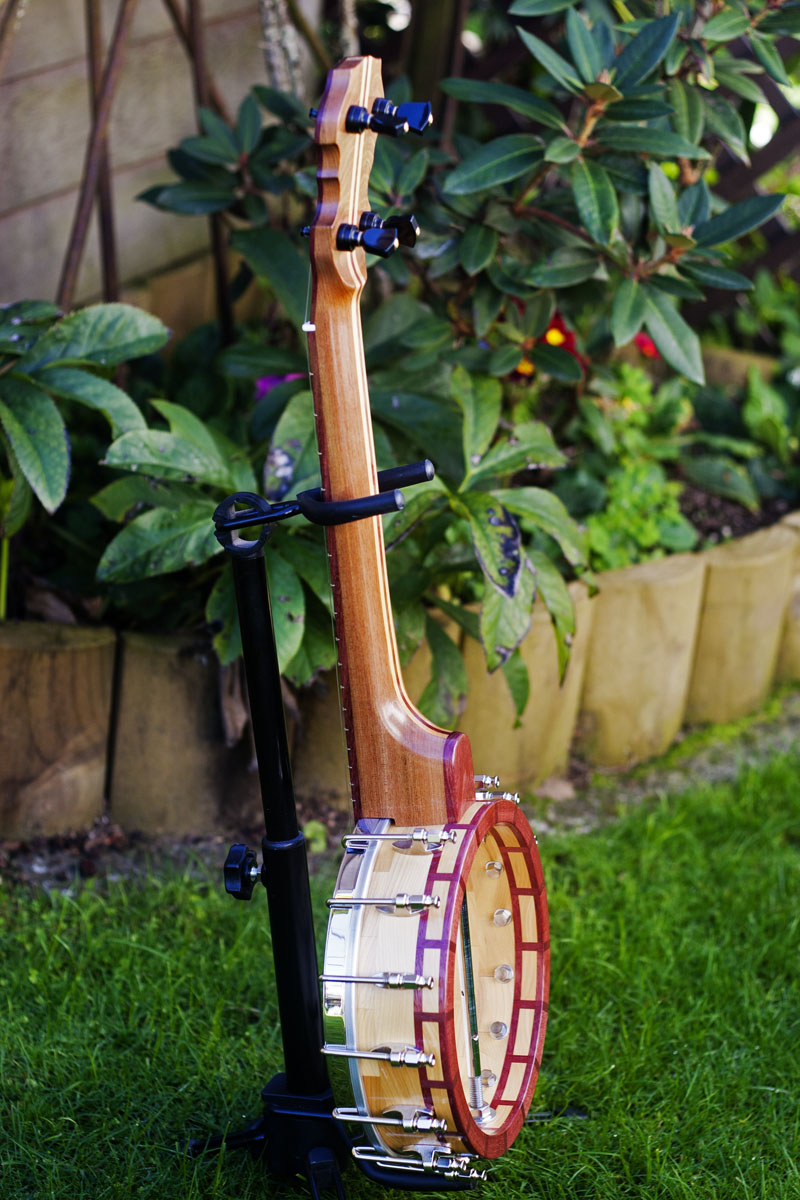

Southern Cross open back banjo Uke Tenor scale.

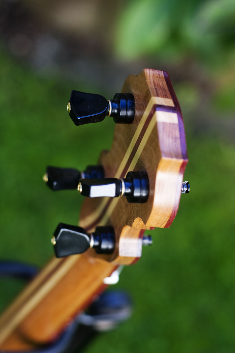

The neck is Heart Rimu with a Kahikatea and Purple Heart stripe.

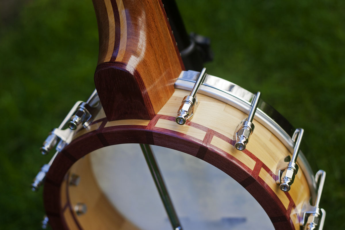

The body is a block construction using Kahikatea with a feature ring of Purple Heart, ninety-six blocks in all.
Fretboard Purple Heart with Kahikatea position markers, Gotoh planetary geared tuners.

That looks great Dennis. I have never been too fond of Purple Heart before, but there is something about the "out there" brassiness of a banjo that makes purple wood seem appropriate. The whole design comes together very well. And your building is obviously very good.

Yes I think the solid body build of banjos, banjo ukes suits woods that may suit guitars, ukes etc. I love Purple heart as you can see. Makes great fretboards.
