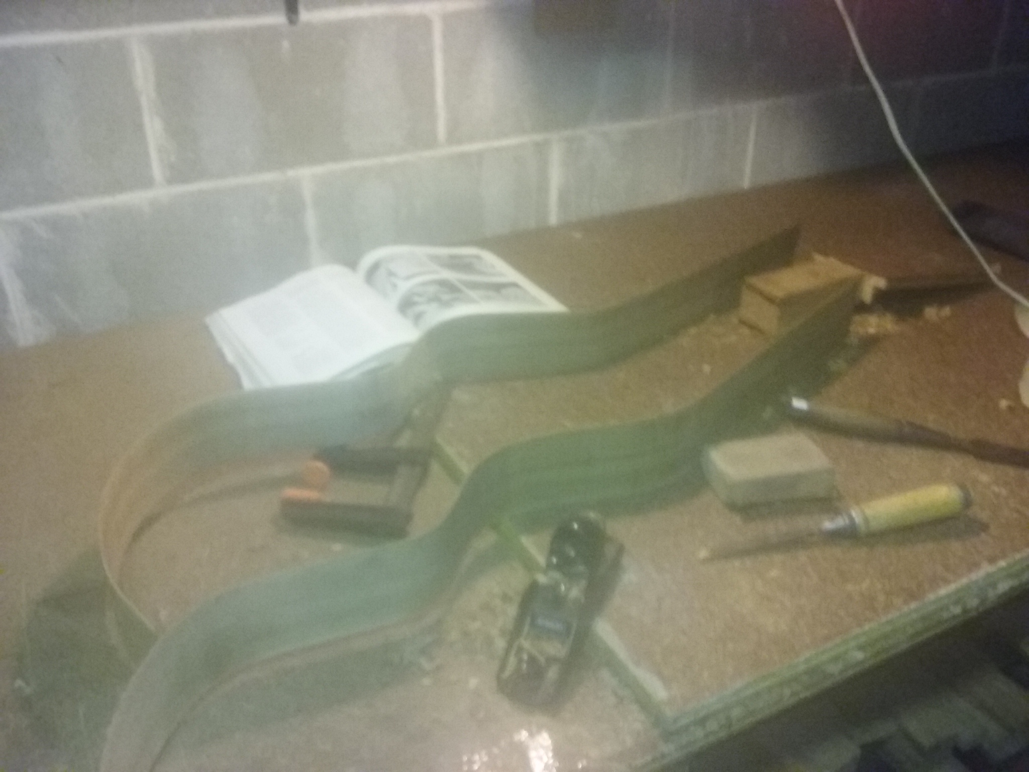

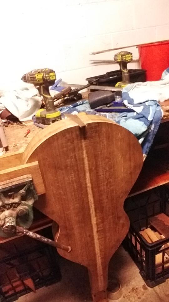

Todays plan is to prep the sides and mould for adding the tailblock and linings.

Re: Very slow weissenborn wip
Thanks Alan, im very taken with your builds!
This is in a similar vein as many of yours - all blackwood with sheoak trimmings.
Too many minor stuffups led me to put it on the backburner however, after a few years on the tools with other projects, hopefully i can remedy them, or just learn to ignore them instead.

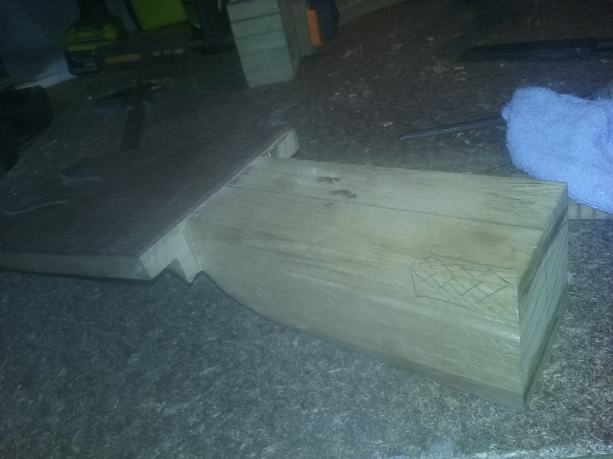

One question i do have for you though Alan is the way the back transitions to the taper in the neck. I am a bit concerned about bending a braced back down to fit the side profile without cracking it. Do you apply heat to assist? Or us it a non issue.... its a little while away for me anyway.
Anyway, one side now has linings and for the first time in too long the shed is tidy. Productive night.
No issues at all bending the standard ladder braced back to fit the taper. No heat or pre-bending required... just clamp it as you work your way down from the tail to the headstock.

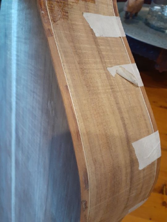

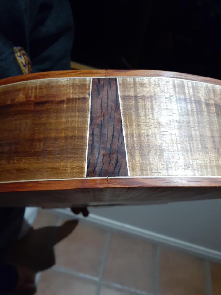

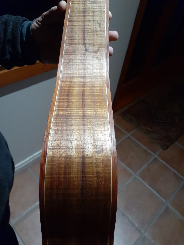

Bindings are now done, absolute black hole for time - probably 2 hours each edge. Used superglue which has left a bit of a glue line unfortunately but live and learn, guess I would consider them a B- overall. Still well off being clean enough to be proud. But for a first attempt they are ok.

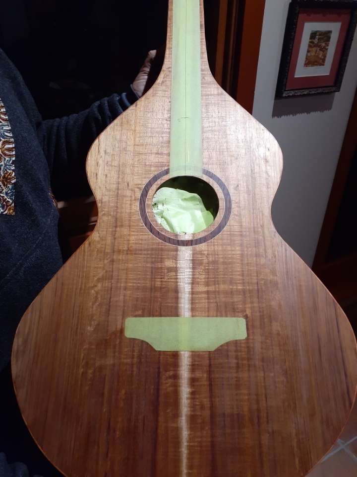

Sanded, masked and now pore filling by sanding in tru-oil. Fairly slow way of pore filling but I'm very impressed with tru oil as a product! Wax on Wax off for the next week or so.
Anyway, thanks for looking.
Cheers steve.
Cheers steve.

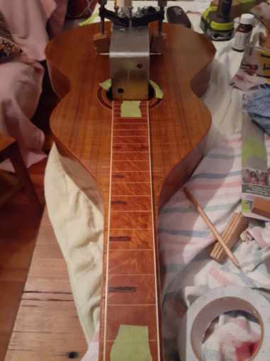

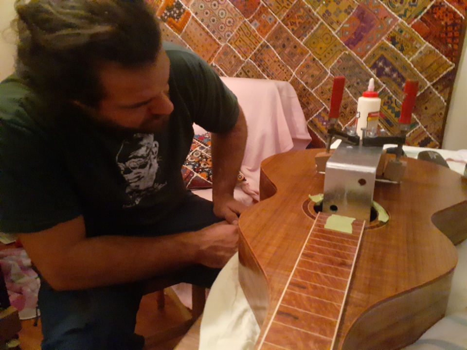

So a slow sprint to the finish line.
A week of tru oil has built a decent finish, still needs a little polish here and there but had a great run of humidity here in wollongong this weekend so fingerboard and bridge went on.

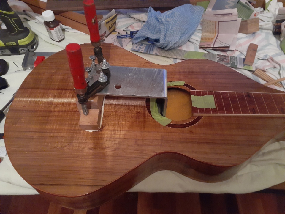

Bit of mucking about at bunnings to mentally design a deep throat clamp from a post stirrup then back to the shed to cut my first thread since year 8 metalwork
Probably a while before Stu-Mac stocks them, but it seems to have worked, guess ill find out when I string her up, wish me luck!

Looking good Steve. It's coming along nicely. But for the record, I think I have you beat by a decade. I started my first guitar about 14 years ago and had to put it a side to deal with life. The body is closed and bound. It needs to be sanded and finished. The bottle of Tru-Oil finally showed up Wednesday. While I was waiting, I carved the back of the neck last week.
I'll be cracking the bottle open here in a bit. If you have any insights to working with Tru-Oil, please share.
Your clamp looks like it will work just fine. Good job.
StewMac hasn't had any supply issues that I know of. I'm been ordering from them frequently enough that the wife cleared her throat and stared at me when I brought the last package in. I told her that I was just doing what I could to help keep a small niche business stay afloat in these troubled times. I got the look. I'll be having them send my future orders to work. It'll be safer for all involved, well for me at least.

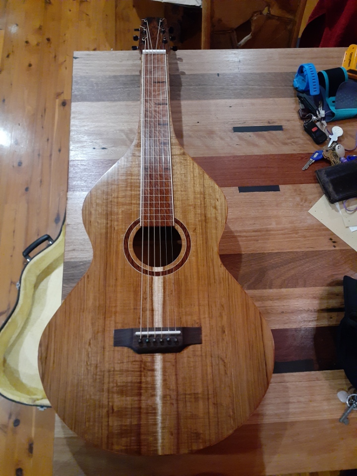

Hi Lillian
Look no really good advice im afraid, as i must admit I'm not 100% happy with the finish at the moment. Tru oil is certainly a nice product but i dont think i have it dialled in yet. Though I must admit i think i have higher expectations than most, everyone who has seen it reckons it's fine as is.
I initially wet sanded with oil and 240 to pore fill, then same again with 600 then had a few days of building 2 or 3 coats a day. But i think i built it too far, as I had lots of cutting back to do. I wet sanded with turps from 600 to 3000 which levelled it but left some dull patches which i assume is burn through/witness marks. They have mostly gone with a top coat of tru oil, but I would have been better off sanding between eveey second or third coat.
So ill have some work to come. Im waiting for it to properly cure, then ill probably do another cut back session followed with a top coat or two, give it a week then do a spit shine to try and make it pop.
But strings are on and this baby sings! Gonna be hard to put her down to make time to sort the finish, so perhaps this is the way it will stay
Steve.
Steve.

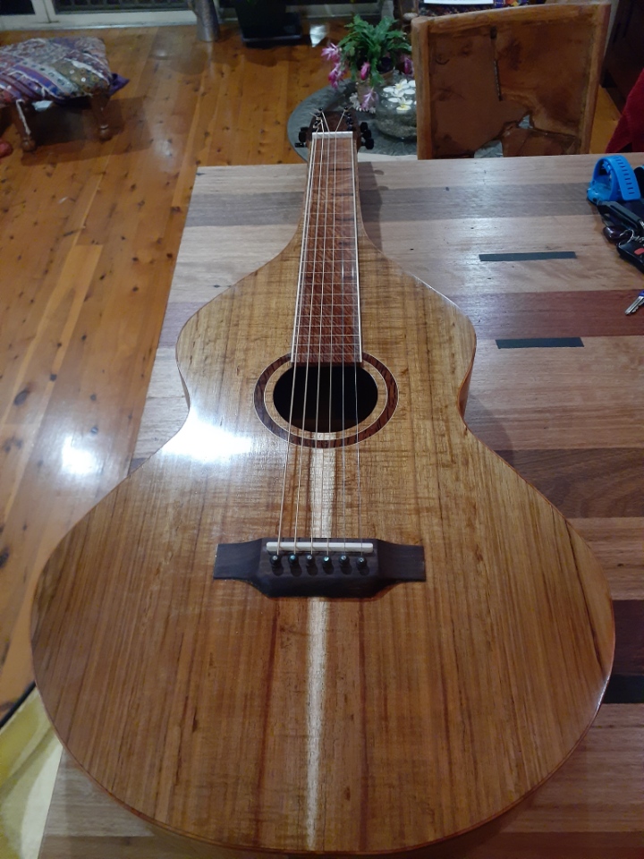

This is it so far. Fairly rough setup while things settle in, but will eventually give it some proper TLC.
Thanks again for looking.
Cheers steve
Cheers steve

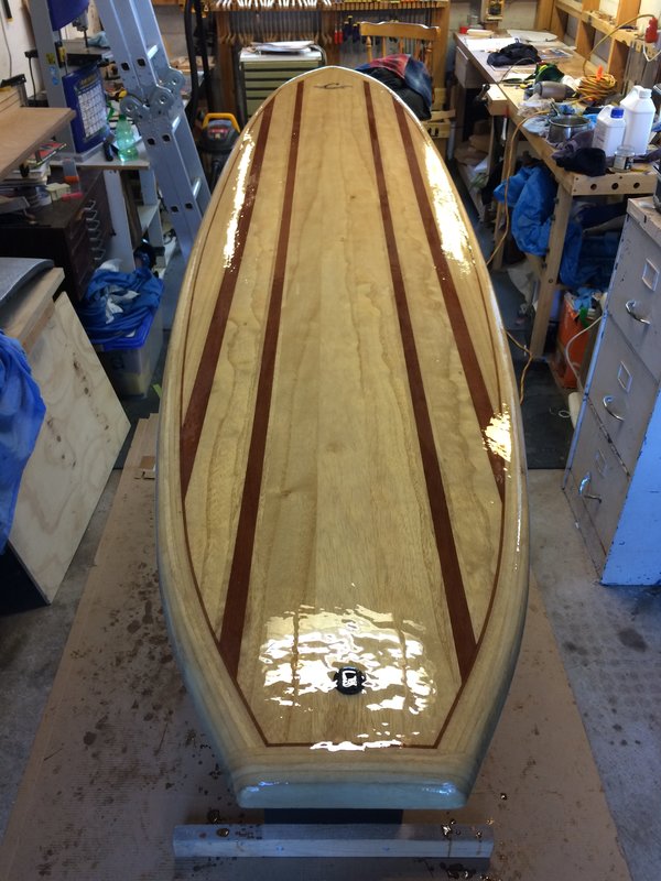

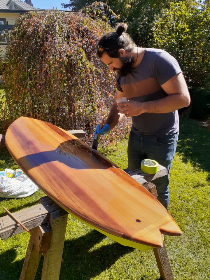

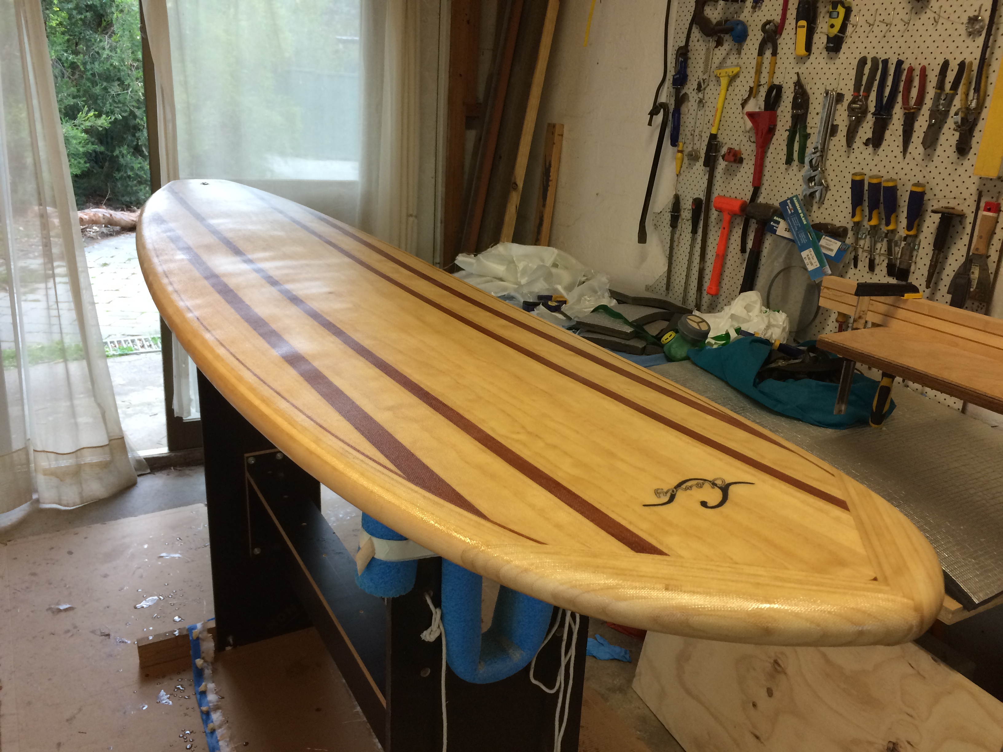

Just for something different here is my latest board getting a coat of fiberglass.
There is something about curves in timber that hools me

It turned out a treat Steve. Well done.sleake wrote: ↑Tue May 05, 2020 10:04 pmHi Lillian
Steve.
Thanks for the tut. I've never used Tru-Oil before. I appreciate you writing up your experience with it.

Nice weisse Steve

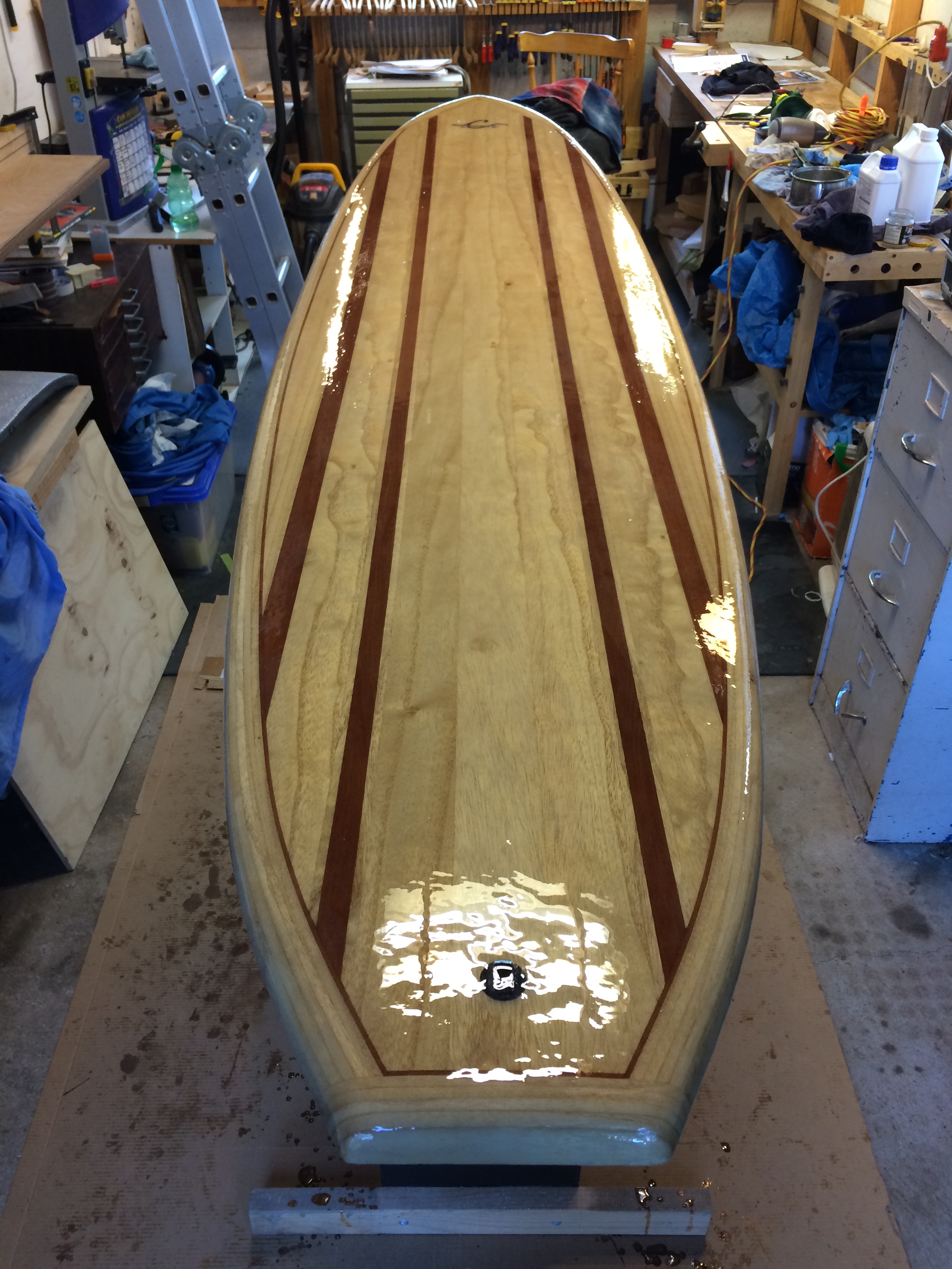

I'm just finishing up a hollow board as well - 8" mini mal in paulownia & recycled western red cedar.
The glass & fill coats went on ok
But the gloss coat didn't self level very well
Lots of sanding ahead of me......
And nice fish!

Nice pin lines!
Pity about the gloss coat, not that I have things dialed but have found the warmer the better for epoxy to flow nicely, sorry if that is old news.....
Guess nithing to do but grit your teeth and enjoy a bit of quality time with the orbital
Love the logo inlay up at the nose too!
Hope you can score it's first ride soon.
Steve.
Steve.
